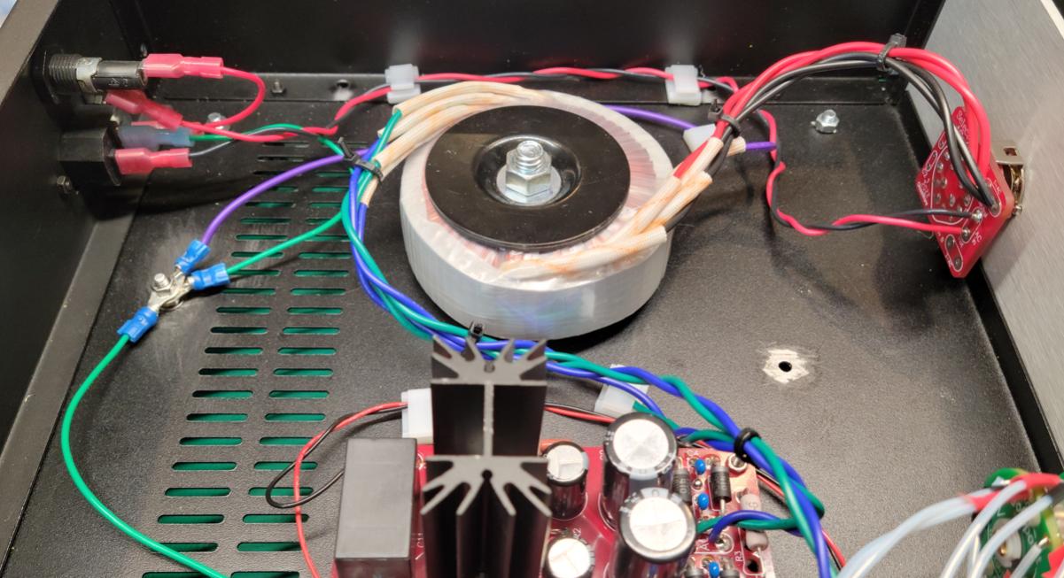

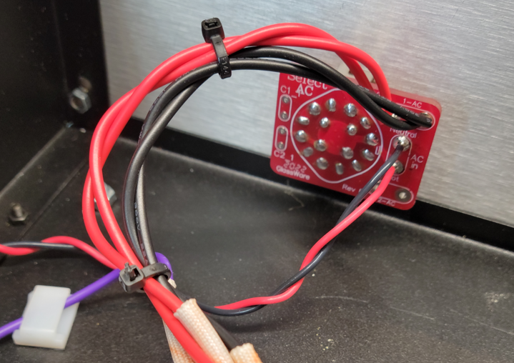

Months in the making, about ready to turn this on.

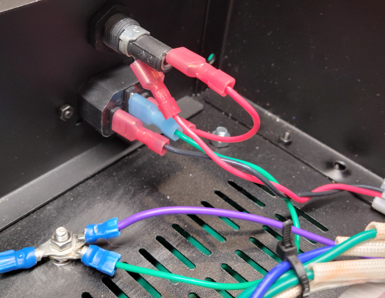

I think a 2.5 slow blow fuse is the correct one to use with a Antek AS--0520-50VA-20V transformer?

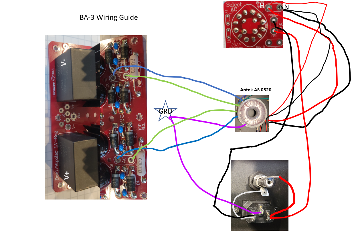

I've mapped all the wiring and have implemented accordingly. If anyone sees anything amiss, I'd appreciate it.

50VA Donut calls for 50VA/115Vac=434mA
so take any of these - 300mA-315mA-400mA
Fast, why not

That wiring guide is your old one with the fuse not wired correctly. I see that in your build your fuse is wired correctly.
If this is the first power-on test, you should first power up with a dim bulb tester. Also test in stages. Do not do your first power-on test with power supply and preamp boards all connected. Test your power supply first. If it works correctly then add one preamp channel. If that works then add the other channel.

and do not forget to bleed PSU caps, after initial PSU test
1K/1W is good enough for temporary bleeder
or even lesser power resistor, higher value - it'll just take more time to bleed

Always start with dim bulb or be one. Check.
No connections to preamp board. Check
I grabbed the wrong drawing.
