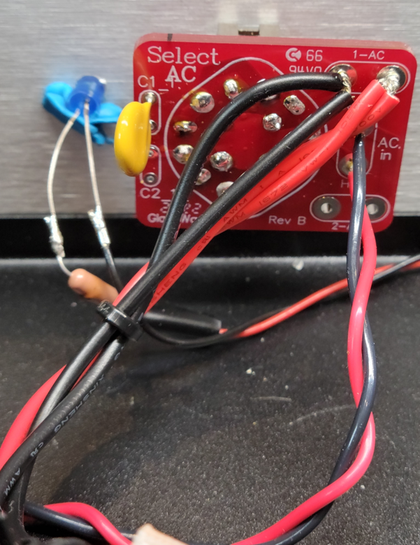

Are you SURE you have that switch wired correctly? I'm looking at budwiser's photo (post #2268)...his output wiring is the opposite of yours.
May not be the most robust switch in the world, but it shouldn't smoke under those conditions if wired correctly.

I agree with others that you should order a switch with a higher current rating. However if you chose to test the Glassware mains switch again, I would disconnect everything downline. Once you have your switch connections sorted then connect the power supply and test. Only after the power supply checks out should you connect the BA-3 boards.

I rewired current into the switch. The dim bulb fades and then come's back on.
I think I'll wait for the new switch.

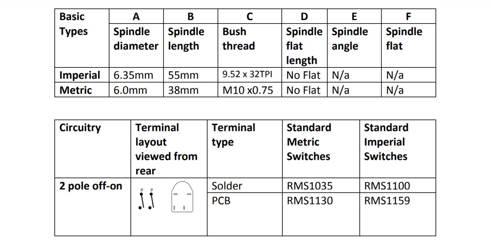

I received the Lorlin RMS switch, but I'm puzzled by how to connect up the wires. The datasheet doesn't indicate what's what. I'd appreciate your guidance.
thanks
From the data sheet (https://lorlinelectronics.co.uk/wp-content/uploads/datasheets/RMS-ROTARY-MAINS-SWITCH-GB-Iss-A-190917-1.pdf):
The diagram of the back of the switch shows two switches (double pole single throw). Connect the hot to one of the two switches.
You can use your meter to check for on/off before proceeding.

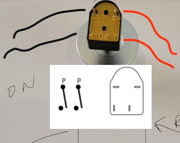

Use a meter to check the connections to see which connections go with which. There are 2 poles on this switch, so you have the option to wire hot only or both the hot and natural power coming into the pre. You just need to make sure that you identify which pole is connect to which. If you wire both poles and miss wire it. You can cause a short.
Use a dmm, measure topleft point against its left and bottom. If both are open, turn the switch and measure again, the pair indicating a closed circuit is channel one, the other pair channel 2…
Use upper or lower connectors for incoming (from the fuse/inlet), the other pair obviously to the next station.
Make triple sure you connected it correctly (in-out in-out, measure everything again—off state and on-state, and between the channels—after you connected the switch)…
Ah, of course this reply was way too late… 😀
Plus: the little image in the datasheet ben provided shows it pretty good: incoming on the switches’ round side, outgoing the other (square) side…

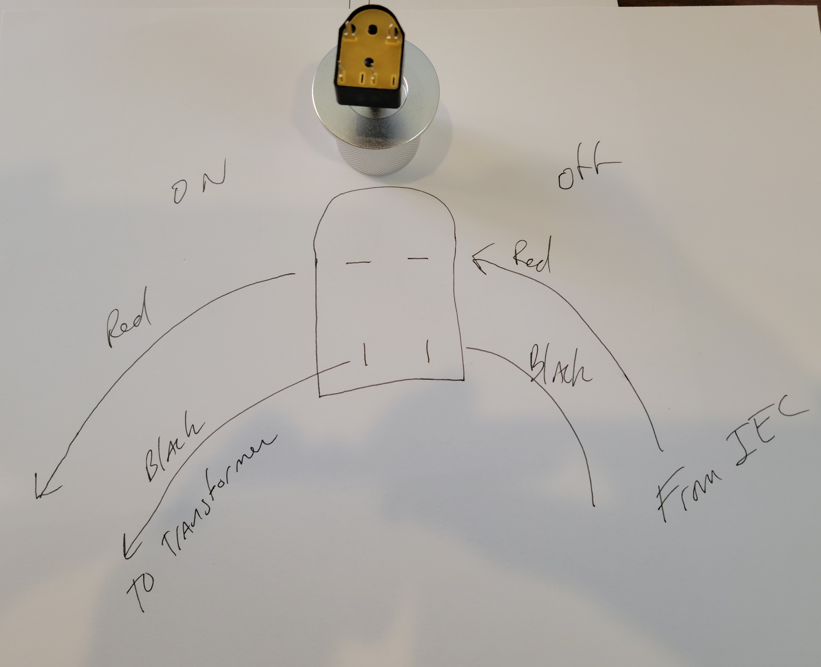

Thanks for all the great help. I've mapped out the wiring based on DMM readings.
Even though you measured it, I suspect this is not the correct way, and would produce a short-circuit.
Are you really really sure you got a closed connection (a reading like 0.2 Ohm and not "OL")?
Sorry if I got it dead-wrong... but better a blame than a cooked amp...
I appreciate your help. When using two DMM's, one connected on the off side and one of the on side, when I turn the switch to the on position, both DMMs show 0.1 or 0.2. When I turn it off, they show OL. That is what my drawing maps.
When I hook them up as you have indicated, the DMM on the bottom two connections remains OL in the on position, and the DMM connected to the top two connections shows 31.85 M ohms.
My drawing assumes current flows from one side to the other vertically.
A bit confused at this end.
