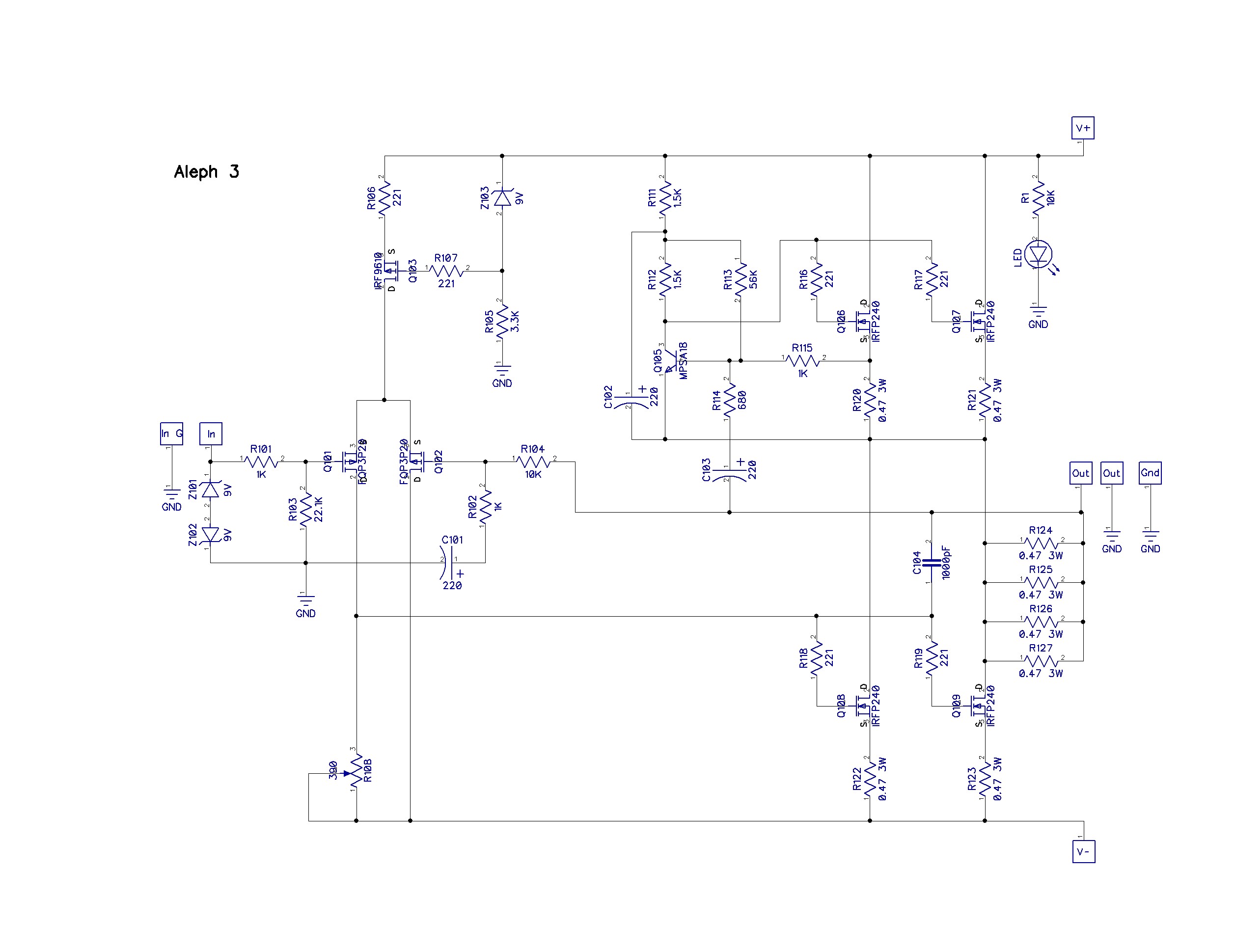

I designed a PCB to build an Aleph 3 clone. I transcribed the schematic Nelson posted early in this thread to DipTrace, which is my preferred software to design boards. I used the "Check Net Connectivity" and "Compare to Schematic" features in DipTrace to verify the PCB layout. No errors were detected.
I built one PCB and connected it. I can hear the music playing but it is distorted.
I measured only 0.31V across the source resistors. Removing R113 the voltage only increases to 0.42V.
The measurements I took while R113 (56K2) was still installed:
V+ +23.4V
V- -23.4V
Q105 Vce 3.8V
R106 5.1V
R108 4.3V
Z103 9.1V
Obviously I made a mistake somewhere, but I just can't find it. I have compared the transcribed schematic to the original, verified all transistor footprints to make sure they match the datasheets. As mentioned above, DipTrace does not indicate any discrepancy between the PCB layout and the schematic. Maybe the schematic has an error and I just can't see it. I am hoping somebody can help me spot it.

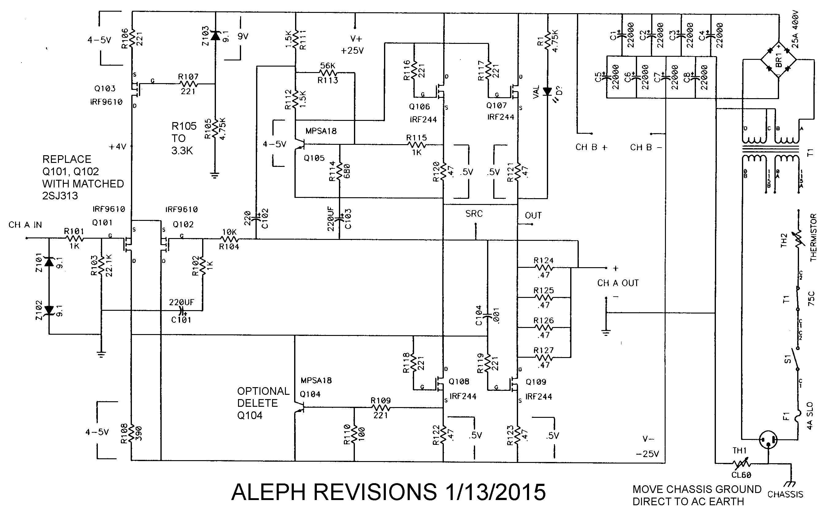

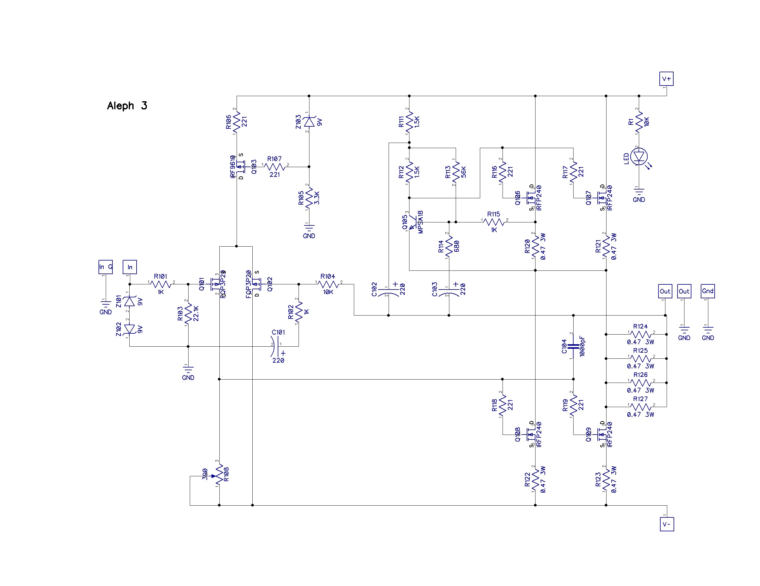

neg of C102 needs to be connected to Q105 emiter
Nelson usually offset the lines that connect to the same point. I did not see that in the schematic he posted. That means R104 and the negative of C103 are also connected to Q105's emitter, right?
Here is the modified schematic.
http://www.diyaudio.com/forums/attachment.php?attachmentid=663839&stc=1&d=1519172567

I recall one (more?) of the original Aleph schemes having a fatal error 😱
Boy, that drove me nuts
The good news is that Zen Mod confirmed my schematic transcription is correct.
The not so good news is that the change he proposed only moves C102 negative connection to the inner side of the output current sensing resistors, effectively bypassing the equivalent 0R1 series resistance.
The bad news is that after hacking the PCB to implement the change, nothing really changed. The bias is still low, which I believe is causing the distorted sound.
