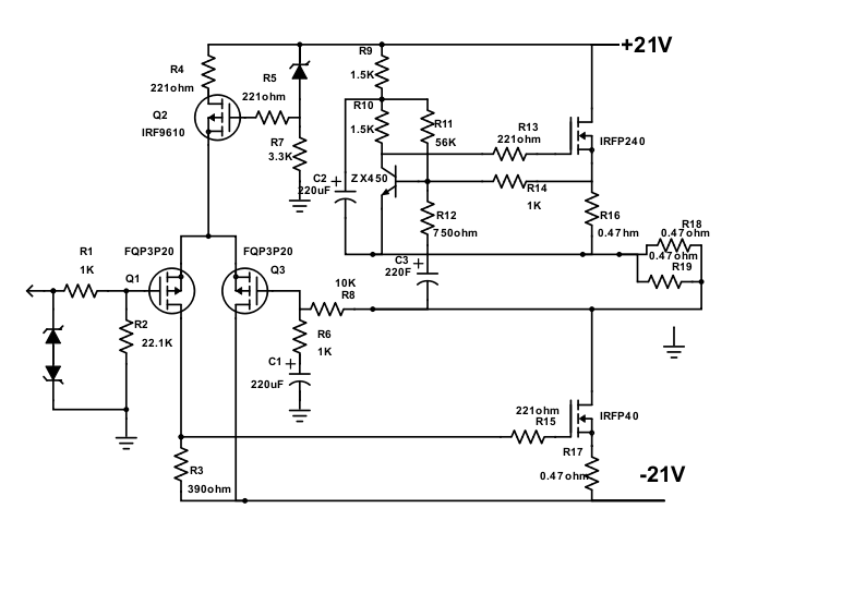

now , take your proper final schematic , measure everything important , at least in DC domain , mark on sch and post here

Yes. I am trying to achieve Below points to meet
1. My speakers are rated at 8ohm@20W. But ALEPH3 has 8ohm@30W.
2. ALEPH3 has 200W power dissipation. My required 8ohm@20W can lower power dissipation to 160W.
3. ALEPH3 has bias 1A in each output stage. And matching is required for parallel output.
I can lower components and can increase bias to 1.5A so it will reduce distortion and improve sound quality.
4. I removed protection circuit as it not required.
5. lowered zener diode series resistance as suggested by NP.
6. I replaced MPSA18 with ZTX450 as MPSA18 not available.
7. INPUT IRF9610 replaced by FQP3P20 as suggested(Toshiba but not available) by NP.
It is a mini -aleph with modifications suggested by NP.
I don't have experience in choosing R11 resistor value so I copied from another ALEPH circuit.
So please suggest if any modification is required to achieve above.

start new thread , and we will help you to determine details

Hi All,
I am looking for 20 Watt per channel aleph.
Can you please look into below schematic and let us know suggestion or improvements.
Thanks,
Nag.

Sure, but I’m quite sure the A3 won’t measure like this:
Thank you, But your circuit has more components than ALEPH3 and have capacitors in signal path. In many pass articles distortion numbers are subjective vs objective. I am fascinated about pass amps. Many times I (newbie,greedy boy do not know about input circuit) asked in this forum for replacement Toshiba jfets. Later suddenly ALEPH caught my eye with input mosfets. I strongly fixed in my mind to build ALEPH.
I am a newbie, and I am thinking capacitors in aleph3 are not directly passing audio signal.They are coupled for providing some constant dc voltage. Thank you for your valuable time to posting your circuit schematic diagram. But I already finished my circuit diagram which meets my requirement and it has less components. May be next project I will try to build.
C1 and C3 are in signal path
