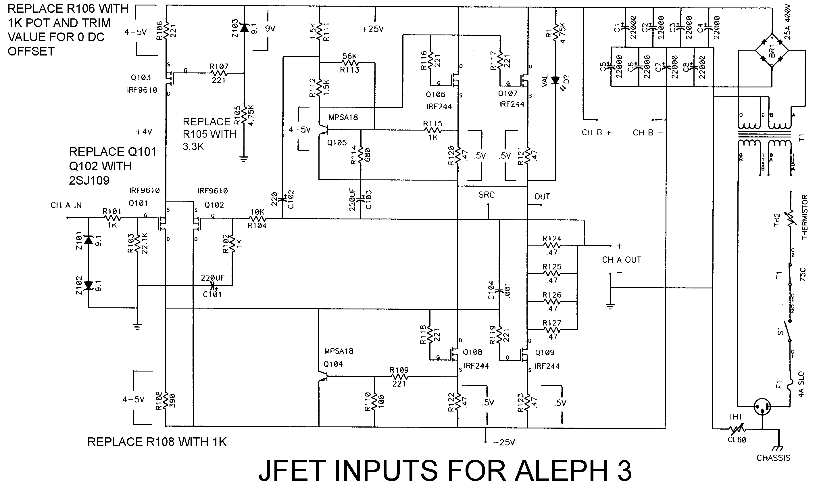

to play with the stock aleph 3 bias is it R113 to replace with a variable resistor ? what value 🙂 ?
thank you Zen 🙂 , if it"s the Pimp my aleph thread is it better to use a special fast/soft recovery bridge with simple C filter or leave the stock one ?

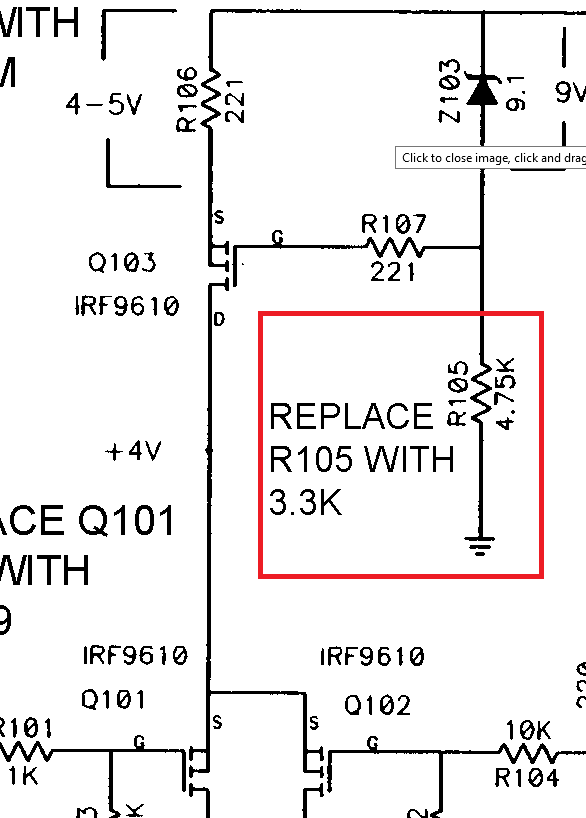

R105...is the change to 3.3K applicable to 2SJ313 inputs only, or can you use it with IRF9610 as well? Does the change to 3.3K from the usual 10K in Aleph schematics a function of the rails, or can you apply it to all Alephs? I've simulated various R105 (3.3K, 10K, 2K, 1K), and found there isn't much of a change in mA of the current source. Just trying to understand this partiular change.

you can do both
however ...... combined with whoknowswhich RC constant in PSU , up from some value of C , it can slow ramp up of CCS and induce plop! in speaker during powering on
so , try and tweak , if needed

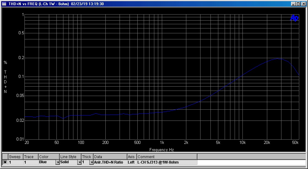

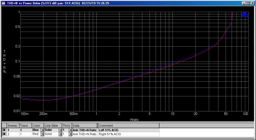

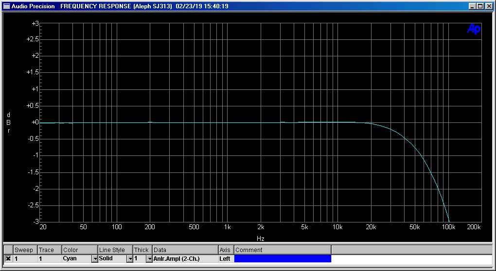

I've had a set of matched SJ313's sitting around for a couple of years. I've just been waiting for an opportunity to install them into the Alephs. I finally got that opportunity this week. In doing so I discovered an issue with the Alephs that I was unaware of. When I built them I used boards that I had procured through a group purchase many, many years ago. The boards were not the best design and it appears that the fellow that built them mixed some new & old features. I didn't know this and used the original Aleph 5 schematic to build my mono amps with. When I built the amps I didn't have a way to test them aside from a scope and DVM. I set up the AC current gain the recommended way and expected that they were correct.
A few years ago I bought a QA400 and I used it to test my Aleph mono's and I noticed some anomalies, but I dismissed it as my novice testing techniques. More recently I bought an AP System One and prior to beginning this upgrade I planned to perform before and after testing. Well the before testing showed some weirdness going on. Primarily in the THD vs Freq plots. I had a huge dip around 1 kHz dropping to close to -80dB and abnormally high noise on either side of that freq. I tried to check the ACIG and it was way off at 1kHz. I remember that I had set it up initially at 100Hz so I checked it at 100Hz and it was about where I set it up at around 55%. I checked various freq's and the ACIG was different at every frequency. I checked the second amp and it was doing the exact same thing, so now I know its a circuit or parts problem.
I finally pulled the predriver boards out and inspected and the boards were designed with the later feature of Q5's base tied to the collector with C7. I assembled these with the belief that they were as the original schematic with Q5 collector tied to emitter with a C7 value of .047uF when it should've been .001uF due to the change in position. So I was slewing the hell out of Q5. 🙂
I made the change to .001uF caps and that solved the problem. ACIG settings are now constant regardless of frequency.
Anyway, in all of the rush to fix my problems I forgot to run pretests while the 9610 diff pairs were still in, so I only have post tests with the SJ313's. 🙁
I've only had one afternoon to listen to the new Alephs, but based on the issues that were present I cannot give pre versus post Aleph Reloaded comments as my Alephs were reloaded massively. They do sound spectacular on the Vandersteen 2Ci's though. 😀
My tests of the amps with the SJ313's are attached. Unweighted S/N came out at -90.5dB left & -92dB right.
