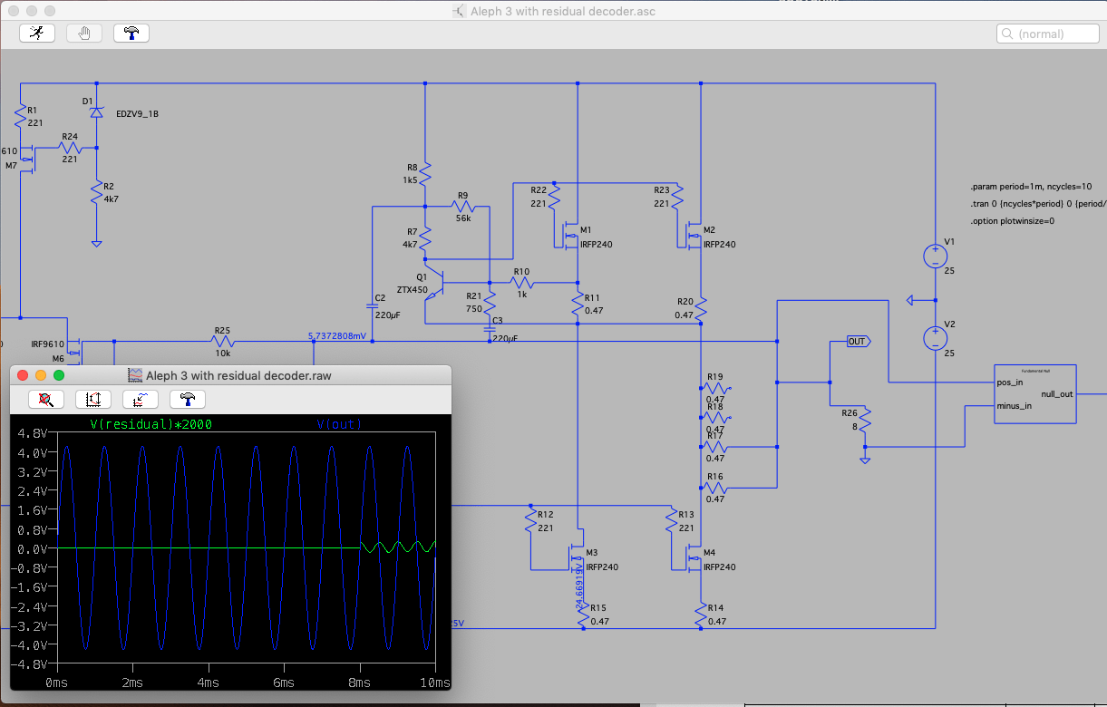

I can't agree with you. IMO, changing R18 from 4.75k to 1.5k puts things where they should have been all along. Changing R21 from 820 to 1k (which I have also done) is within the realm of personal taste. With both those changes in place AC gain is at right around 50% and amp sings very nicely.
sorry, I didn't understood in first moment your post ...... by habit , I was fixated on AC gain issue, usually taken care of with modulating resistor from output node
frankly, I never investigated effect of varied colector resistor there ...... always used lower value ( 1K5), presuming that more mA flowing there can only be good thing etc.
Inspired by the comments here I made the zillionst Spice of A3 and I got the H2 neg phase in Spice only by canceling two of the Aleph 0R47 at the output. With four parts I get always pos phase H2.
Nelson assured me many times that the original had neg phase H2.
So my question could there be an interdependence to the transconductance difference between the IRF240 in the original amp and the IRFP240 used in our rebuilds? The IRFP seems to have mostly a portion more transconductance.

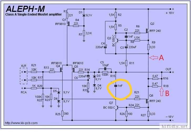

1nF在Aleph中,每个通道一个或两个电容器来抑制可能的接触
Thank you for your reply, but through the experiment, it is found that if you remove this 1nf bass, it will get worse, plus there will be enough bass. My friend told me that this is a feedback capacitor, not for stabilizing the circuit.
谢谢你的回复,但是通过实验,发现如果去掉这个1 nf的低音,就会变差,再加上会有足够的低音。我的朋友告诉我,这是一个反馈电容,不是用来稳定电路的。View attachment 1076605
In Pass A5, this capacitor is 681pf, not 1nf

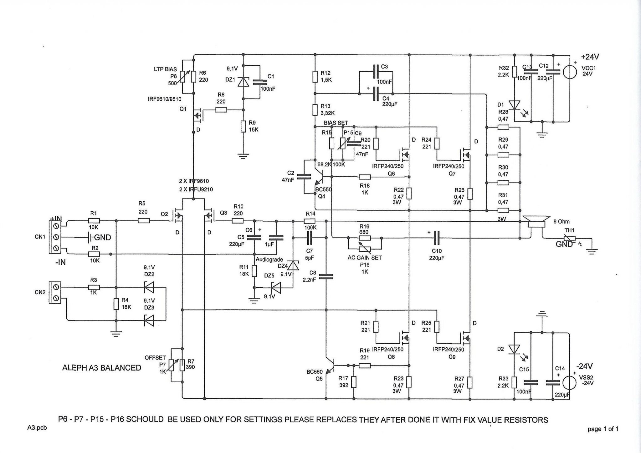

Hi guys! I would like to share this version of A3 with you.
It is the result of some information taken around by the various forums also by Aleph J from which I took the slightly different part of the bias from the A3.
Furthermore, this version also includes the balanced input, still in the Irf9610 version because the 2sj74 is much more expensive and difficult to find original.
I have provided several settings to be able to adjust:
1) LTP BIAS
2) DC OFFSET
3) BIAS
4) AC GAIN
I'd like to know your opinions/advice before having to make the pcb.
Thanks in advance to all of you and to Mr. Nelson Pass for his generosity.
