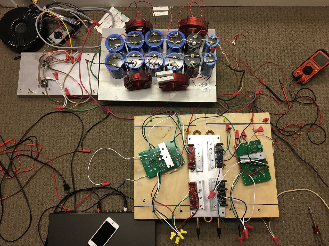

While not quite "reloaded", more of AlephInsane. Its an Aleph 5 biased at 5A, 42V rails. Next up, Aleph 2 config, biased at 8A, 42V rails. Never thought 12Ga Inductors would be too "small".
