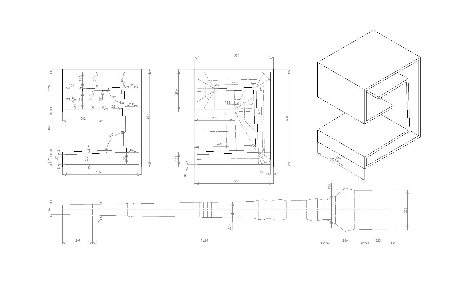

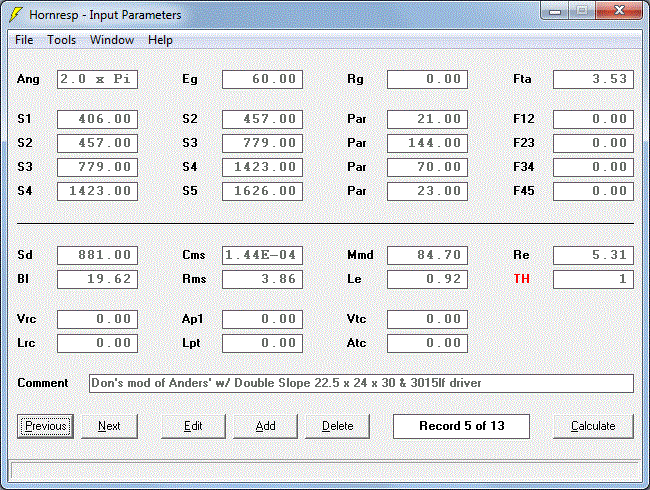

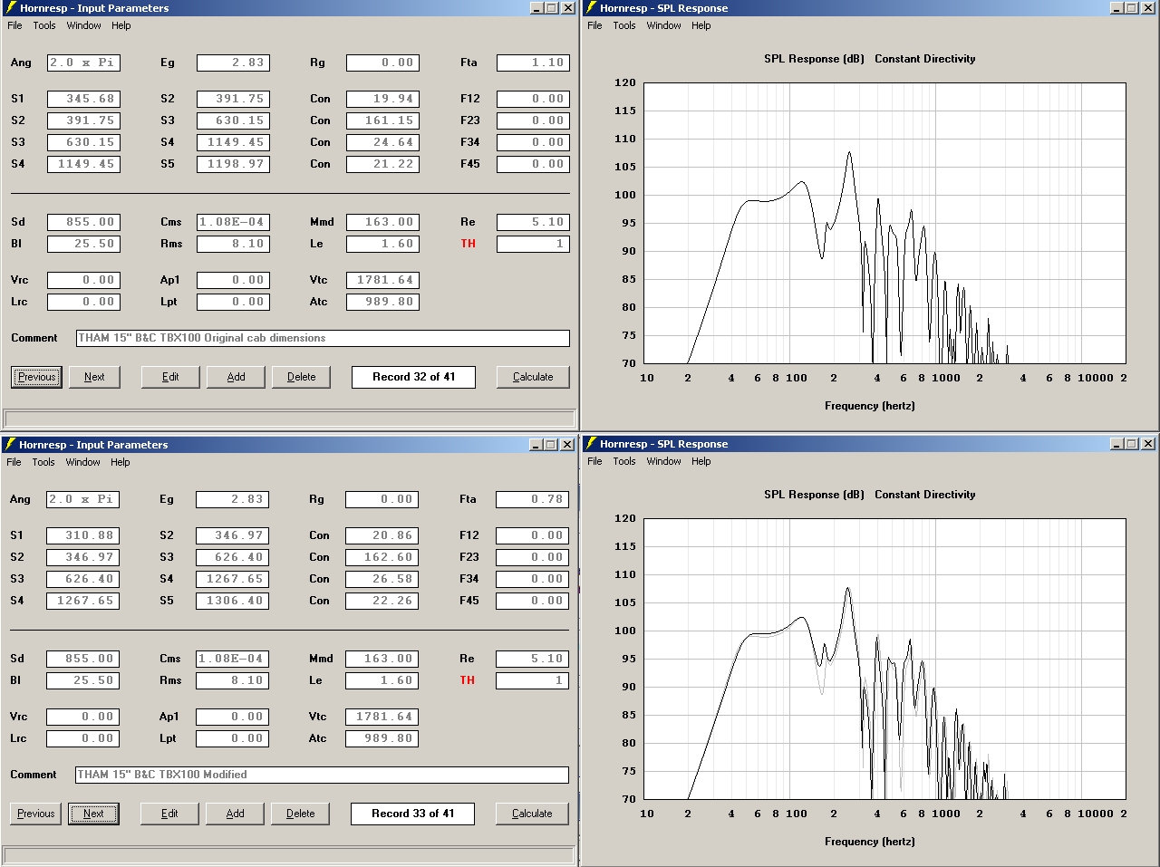

Way back in post 7......
I commented that the 135mm dimension close to the horn mouth seemed small in comparison to the expansion of the horn.
Martinsson replied in post 10 that this dimension was intended to keep a longer L23 length.
I did a best fit the horn as Martinssons original drawing, and inputted the straightened dimensional data into hornresp. This sim then shows a massive dip at 165-170 hz.
I then reworked to get a linear taper throughout the L23 section. I retained the 135mm dimension.
I did increase the S2 compression slightly from 2.18 to 2.46
This filled in the dip by 5db and made the dip W shaped.
Attached Hornresp sims and reworked dimensions
Hope this helps🙂

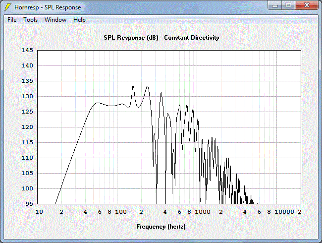

Where did the 160Hz dip go?
Nice. And no reflectors required either 🙂.
Maybe its something to do with going from a internal volume of 140 litres to 210 litres 🙄Where did the 160Hz dip go?
Bumping up the volume, different driver, dual taper ... I'm sure all had a part in this mod. All these boxes are about 21 inches wide, and

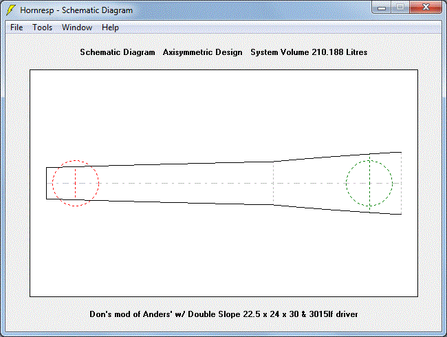

Brian: Hornresp sims the schematic layout ... we won't know what effect the folding has until we build one.

Following on on this, have a look at Don's suggested alignment. Notice the peaks @ around 160 Hz and again around 220 Hz? These will tend make any distortion generated by 40 Hz and 80 Hz tones, and 110 and 55 Hz tones, more audible, because this distortion will be amplified by the horn by it looks like around 6dB. How to effectively deal with this? Well, EQ won't work, unless you want to cut the frequencies that are causing the distortion too. So, what's the next best solution? Two Helmholtz resonators, tuned to 160 Hz and 220 Hz might produce good results here. In fact, perhaps even another one could be added - to deal with the other peak at 340 Hz or so.
Hornresp agrees with AkAbak on a generic straight horn, yes. When you sim an actual folded horn with corners, no. Neither can get path length differences right around the corners exactly right, but the builder should be checking for this.Hmmm.... seems like danley is saying akabak doesn't show you everything, and hornresp agrees with akabak.... hmmmm.....

Brian,
Simming the TH as shown in the schematic, peaks are evident at 160 and 230Hz. The "Q" of these peaks is very narrow. When the TH is folded, you will
no longer have a single, unique path thru the horn, and the "Q" of these peaks will be wider and the peaks will be much lower.
