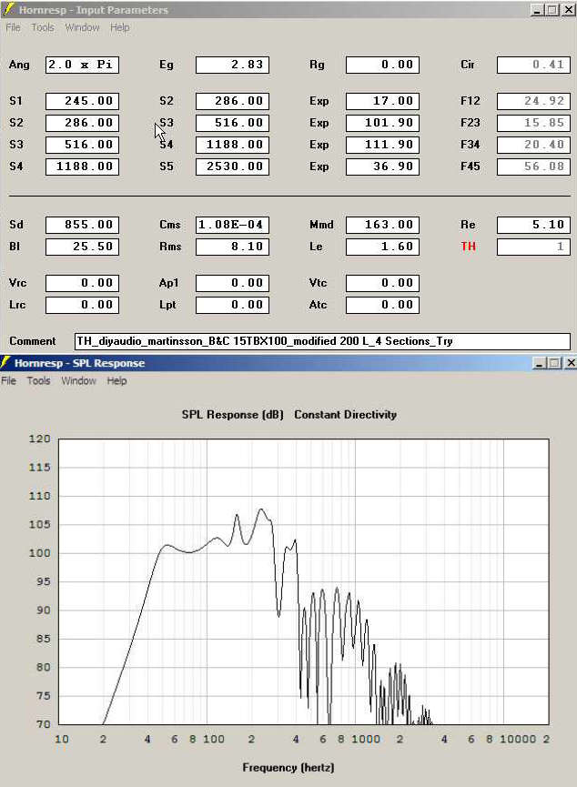

Now translate that back to your design. Your plots shows a very nice 36dB dip around 170Hz
Yes, and it also shows up in the HornResp SIMULATION. HornResp does not know and does not model how my horn was folded. The dip you're seeing is a product of the ALIGNMENT, not the box geometry. Your analysis of the horn's FR is incorrect, and therefore so are your conclusions.
djim, whats up with your interpretation? the simulation is clearly shown and its of the unfolded horn with a perfect expansion and no parallel sides (shown with dip). Brian's sim, measurements and graphs clearly support his conclusion.

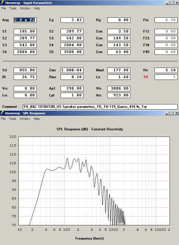

Maybe the problem is not so much in the details as it is in the design limitations. Looks to me, that the THAM 15 is designed to minimize volume and to maximize ease of construction, which is why it looks like the TD TH-MINI; as compared to the TD TH-115, which seems to be optimized towards extracting the best possible SPL response from the B&C 15TBX100. From my simulations of tapped horns with this driver I like a minimum of something around 200 liter_net in Hornresp.

Just for fun I'll attach two simulations, these have not been folded, and converted into drawings (in other words, just food for thought):

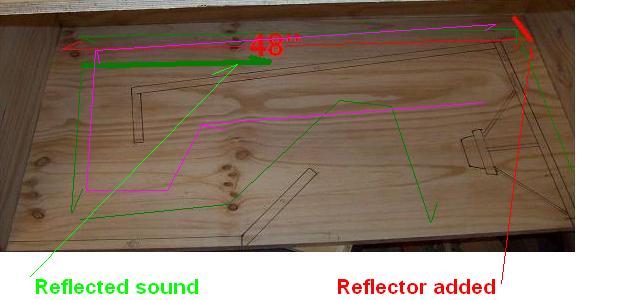

wow, step away for a bit, and I missed a bunch of discussion on this.
What's missing in my mind in the last couple pages of discussion is the fact that everyone is assuming we are talking about a SINGLE wave bouncing between 2 surfaces. we are not. There are at minimum 2 waves, and actually more than that in play. When a wave hits a blunt surface, less than 100% goes around the corner. What gets reflected instead of transmitted is now of concern. (in addition to the 2 waves, one from the front and one from the rear of the driver.) If you have 2 waves 180 out of phase, you get a cancellation. This is what I heard in my 2x2x4 cabinet without the bottom reflector. It was a muffled out of phase sound that was way down on spl. By adding ONE reflector, I was able to eliminate that. The one reflector was at the bottom of a 48" long path, which happens to relate very well to the 70hz issue that this cabinet had. Without the addition of this one reflector, this cabinet was destined for the burn barrel.
So... you can create nulls that hornresp doesn't predict, and you can eliminate nulls that hornresp does predict based on your folding and reflectors in a cabinet in my experience.
call it standing waves, call it phase cancellations, whatever you want -- it does happen.

Jim; Would that reflector been better at the end (IE the top) of that 48" path to reduce the reflectshons from the top? Andy
The only problem with that theory, and it's a BIG problem, is IMO that reflector is simply too small to have any significant impact on a 70 Hz wave.
My own tests have shown that those changes only occur ABOVE the frequencies predicted by 1/2L, where L is the distance between the two walls being considered. Seems to the the point at which horn geometry starts to make a difference. The frequency response chart I previously posted, which examines a worst case scenario, demonstrates this.
I'm not arguing that the change in response does not happen, JBell - after all, it's your observations. However, attributing it to "standing waves" or "phase cancellations caused by reflections" that can somehow be modified by small (relative to the wavelength being discussed) reflectors is IMO incorrect. The wavelengths of the frequencies being discussed are simply too long.

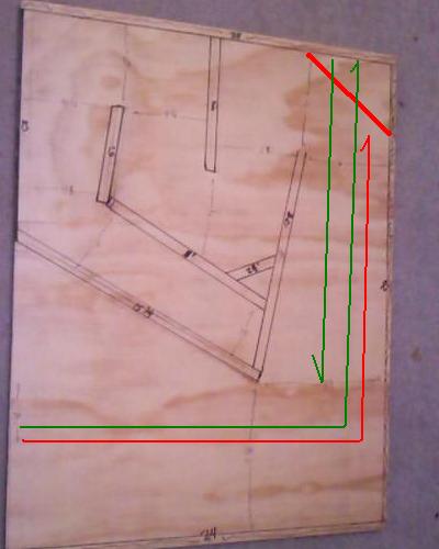

Here's an example. I know that If I put in a reflector in red where shown, it'll cut my overall response, and especially my 100hz area response. I have a theory that some of the wave traveling back down the horn gets reflected back, emphasizing the 100hz, and also reducing the 'back pressure' in the horn allowing the lower frequencies more total output.
It's a theory -- is it right? I'm betting not. Do I care? no. I know it happens, so all of my TH's lately, I make sure there is a place where there is an intentional lack of a reflector in this location just for this reason.
Another case... a solid rear brace along the long back of that design cuts 40hz by 2db. why? more bracing should be better, and louder -- less loss through panel flex. Hollow bracing or even my 2 braces as designed in the ss15 reduce, but don't eliminate that rear panel flex. But it's louder than a solid brace.
again, why? don't know, I don't have time to figure the why out... it's taken me too much time as it is just to figure the what part out.
