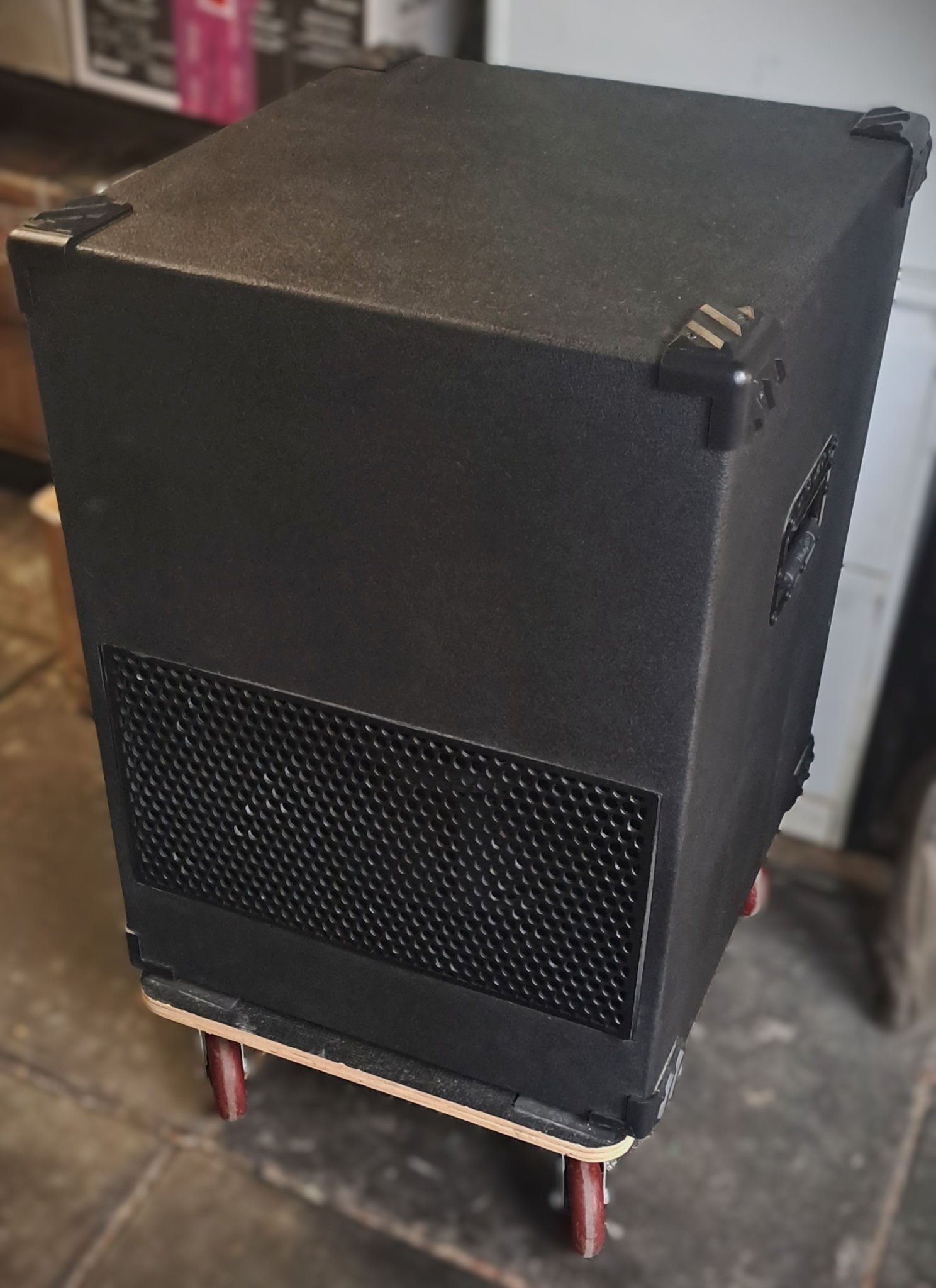

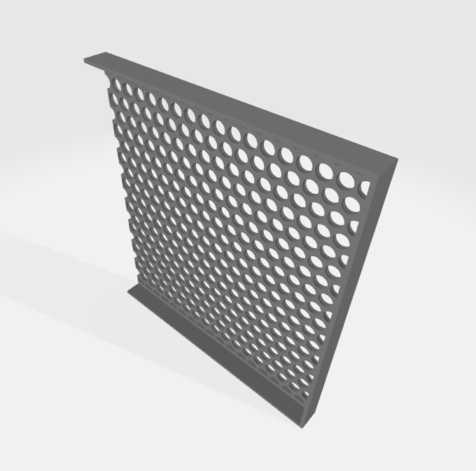

Just posting here in case it's helpful - I couldn't seem to find a model so I designed and 3D printed a simple grille while I work towards a perforated steel one. I made it to be interference fit with a strip of closed cell foam just inside the horn mouth - blocks in each corner to stop it pushing further into the opening. It seems reasonably rigid in PETG, but yet to test it for vibrations at full tilt. I suspect this may well be an issue which will require a redesign - there's a reason most PA speaker grills are steel I guess. But at least for now it's more difficult for people to stick their feet (or coats) inside the horn! I can share the STL if anyone is interested but it will require resizing as I think my horn mouth may not be the same as many THAM15 builds ( 460mm x 250mm).
looks nice, how do you secure it to the mouth ? did you install inside braces running along the lip seam inside ?
Currently just very tightly friction fit.... The foam stripping compresses and holds it quite firmly. I wanted to be able to remove it readily. There's small triangular block in each corner bracing it so i can screw it to those if necessary. We'll see how well it it holds though... Im not totally convinced it won't buzz at high volume.how do you secure it to the mouth ?
