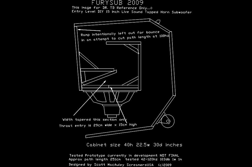

Here's an example. I know that If I put in a reflector in red where shown, it'll cut my overall response, and especially my 100hz area response.
If you're putting in the reflector exactly as shown, it's going to narrow the horn's path at that point. Not by much, but perhaps the narrowing is what's making the difference. I think that to avoid the constriction, the reflector needs to be a bit smaller so that the shortest distance from the edge of the internal panel to the reflector is somewhere between the distances of the edge of the internal panel to the two adjacent side walls. In any case, as we're talking about a bass horn, it's not really required.
Another case... a solid rear brace along the long back of that design cuts 40hz by 2db. why? more bracing should be better, and louder -- less loss through panel flex. Hollow bracing or even my 2 braces as designed in the ss15 reduce, but don't eliminate that rear panel flex. But it's louder than a solid brace.
What's the thickness of the solid brace? Perhaps the horn is sensitive to cross-sectional changes at that point.
That particular cabinet does a couple things that I don't have answers to... but again... I am just happy with the results.

Again Jbell says his “reflector” panel influence the area of 100 Hz. I see the length of the back panel is 29inch high. 29inch is = ¼ wavelengths of 116Hz. Is this again a coincidence?
Or can we really influence a signal in a horn with "reflectors" (sorry have no better word yet) at ¼ wavelengths between two parallel walls?
It’s not that I don’t believe in the Helmholtz resonators as a practical solution, I certainly do! But it is still fixing the problem afterwards instead of fixing the problem itself (that's why we try to find the right theory to treat problems in future on a predictable way)

Sanders himself seem to have influenced his Tham at 170Hz with reflectors. Jbell has given 2 examples of similar type. That it happens all around ¼ wavelength is not possible because of your theory of standing waves which is correct. But I’m talking about dips – out of fase signals. Standing waves are resulting in peaks not dips as you proved!
Now go back to my example in room acoustics of measuring at a ¼ wavelength in a full wavelength standing wave. You will see that the signal of a standing wave, that is reflected from a wall, at ¼ of its full wavelength is out of fase (look for the chapter in you books about nodes and anti-nodes)
So what theory tells you, you can’t influence a signal within a horn at ¼ wavelength???
And whitch of your theories says that anywhere in a horn, where two parallel surfaces ‘see’ each other, can't reflect a signal out of fase?
This also means you are right, you can’t influence a full wavelength with a reflector but you can prevent parallel walls that develop ¼ wavelength – out of fase – signals by the use of reflectors… And no we are not talking about standing waves we are talking about cancellation as the result of ¼ wavelength reflected by walls...

Use my tham suggestion as a guideline. Look at the grey lines from where the reflectors should start. About the steepness: Don’t make it to high cause it narrows the path. Don’t make it low cause it looses its efficiency. If two reflectors see each other it gives the maximum effect. But to many of them can make everything worse…
If you have detailed drawings it would be easier to show a suggestion.

Brian, before I ‘m going to share my reflector picture I want to make sure it’s still a suggestion (although based on improvement for room acoustics).
Any comments or ideas are welcome...
In the left part you’ll see a reflector suggestion for each 90 degree corner. The angle should be maximum 40 degrees for maximal efficiency and no less then 15 degrees for minimum efficiency.
On the right Reflector 2 and 3 have an angle of minimal 7,5 degrees and maximum 40 degrees each.
Try not to pass the blue line to much because the reflector will start to narrow the horn path from that point. Make sure that all reflectors totally cover the parallel wall. This is not possible with 45 degree corners without narrowing the horn path!
The overlaping area means where the reflector is crossing the ideal outline of the hornpath.
The reflectors hopefully work in two ways;
1.) lowering the expansion factor as result of the increased volume in a corner.
2.) minimising the reflection of 1/4 waveforms -out of fase - signals
