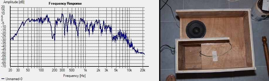

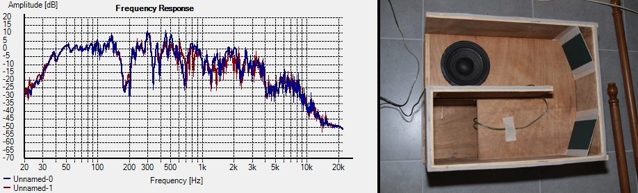

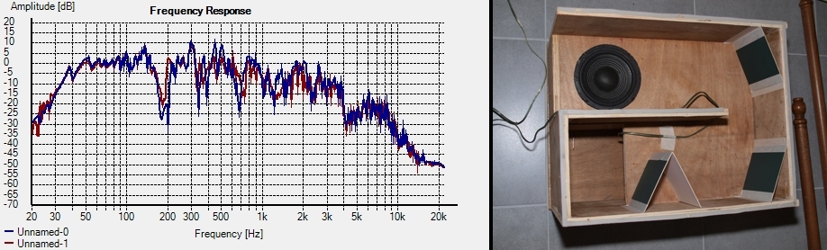

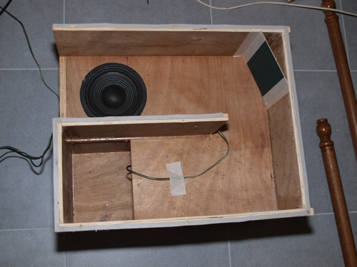

Background - the "reflectors" were sized to ensure that they would not reduce the cross-section d at any point below the constant cross-section used through the pipe. As I indicated, I used matt-board to make the reflectors. If you believe this is too thin to make a difference, I can repeat the test with something stiffer (perhaps sticking a few together to make a seriously stiff panel). I'll come back to this in a moment.
To make sure everything else remained constant, I taped the mic to the floor at the measuring position, the box was not moved while I changed its innards, and amplifier level and signal level (from HolmImpulse) were untouched throughout the test.
See images below. All raw response, measured via HolmImpulse.
The first image shows the FR with no reflectors.
The second image shows the FR with one "reflector" added as indicated.
The third image shows the FR with two "reflectors" added as indicated.
They both show that the major differences are occuring way outside of the passband (>400 Hz).
And before anyone says "Brian, you plonker, those "cards" are too thin and are not going to make any difference at lower frequencies no matter where you put them in the pipe", I did find one or two locations where they DID make a significant difference to the response in the "notch" area. I can provide more details if anyone's interested.

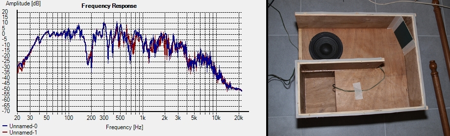

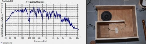

Here's one example of that effect. I basically randomly chose a place to put two additional matt-board cards to restrict the pipe at one point. The end result was that the "notch" got filled in a bit, with possibly a slight reduction in the response at frequencies at the lower end of the passband. Maybe this requires further investigation, e.g perhaps determining at which point in the horn the constriction would have the maximim impact on the depth of the notch, and the best height and width for the restriction.
Yep, you're right, although Anders told us an improvement in this area after he fitted his corner “volume optimisers” it isn’t projected in HornResp anyways. So what is the proper translation for the conclusion about the 170Hz dip?
HornResp probably can't model what he did because it does not allow enough sections in the model to do so. However, the observations that Anders reported seem to be exactly what would happen if you take his HornResp model and start altering the expansion characteristics of the horn. The "W" shape will show up in the notch. I don't think it's necessarily an improvement, as you're replacing one notch with two 🙂. What we'd like to do (if the intent is to extend the horn's passband) is to fill the notch in completely. If the results of my tapped-pipe tests are any indication (I will have to do more tests), it might be possible to do just that by inserting a properly-sized restriction in the path of the horn at the correct spot, and this "optimum spot" is likely not at one of the bends, but at a distance down the line that's determined by the center frequency of the notch.
