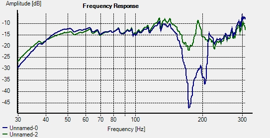

I've got a possible "fix" for the THAM15 notch. Well, my rough tests to attempt to fix a similar "problem" with my POC#1 shows some promise.
Here's a before/after FR graph from 30 Hz to 300 Hz - before in blue, after in green. Looks like a rough stab at the fix fills in a good portion of the notch, at the expense of a dB or so @ the low end of the passband (which you can likely get back by decreasing S1).
With some fine-tuning, it should be possible to smooth out the FR at the upper end of the passband, particularly considering the crude method I used to alter the FR that way.
The fix (1) doesn't require any major changes to the box dimensions, (2) doesn't involve any sort of "horn voodoo" that's not backed up by known theory, and (3) can quite likely be modelled by Akabak, but probably not HornResp (not enough "taps" along the line's path to model the effect).
For the moment, I'll call it the "Brian Steele's Dog Food" method. Just wish Akabak had a nifty realtime modelling wizard like HornResp to make the iteration process a bit easier.

Yup, saw that. My technique might work a bit better. His mod made a difference of 5dB in the notch, but still leaves a huge hole. If my technique works with the THAM15, it might produce a significantly greater response difference in that area.
