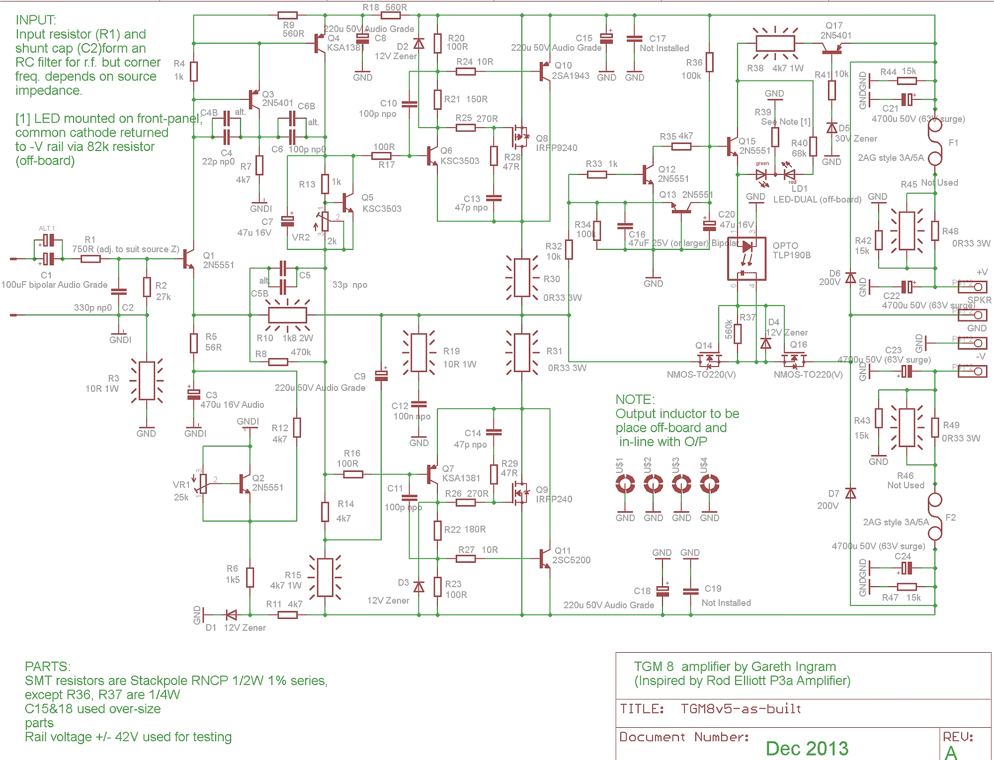

TGM8 - my best amplifier, incredible bass, clear highs, no fatigue (inspired by Rod Elliot P3a)
If I wanted to try two-pole compensation with the simple input stage...
R4 = 0R - correct
Q3 = unpopulated - correct
C4 = 22p - correct (empirical tuning maybe needed)
C6 = 330p - correct
R7 = unpopulated - needs to be installed, use between 1k and 4k7 (I used 4k7 in the end)
A wire link between Q3 collector and emitter pins - No!
Conversely, if I wanted to try the bootstrapped input stage with dominant pole compensation:
R4 = 1k - yes
Q3 = populated - yes
C4 = 68p - No
C6 = wire link - No
R7 = populated - Yes, 1k to 4k7 will do fine
For the dominant pole compensation cap you need to string a cap between the collector and base of Q4; a through hole cap tacked on the underside of the pcb will do it - value 68p to 100p sounds right.
It is possible to use nested feedback with either dominant pole or 2-pole compensation schemes.
Yes. It provides local feedback from the VAS, which has a few benefits and side effects - one of them though is to reduce the feedback around the output stage and with the simple input stage you have less gain to share around.

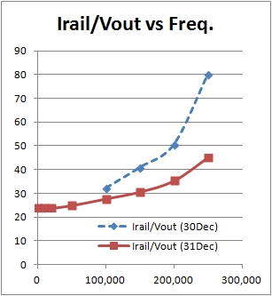

I went back and did some more simulations and more reading. I have brought the cross-conduction under control. I reduced the FET zobel capacitors C13&C14, to 47pF (I wouldh've used 33pF if I could have found them). I had to lift up one end of R31 to access C14!
Next, I increased the FET gate stoppers R25&R26, to 274R (200 to 300 will be fine).
The more significant factor is reducing the driver load resistors R20&R23 to 100R. This doubles the driver current to over 5mA (much better). In fact, if you want to heatsink the drivers you can reduce these resistors further to 56R and push the current higher - the cross-conduction in the simulation is then even lower than the P3A. I felt chicken so I went with the 100R load resistors.
I also made some adjustments to the compensation to reduce triangulation of the -ve waveform at very high frequencies (based on simulation only). I reduced C6 to 100pF and increased C5 to 33pF. I left C4 at 22pF and C10&11 at 100pF.
Powered up fine, green LED. The bias had to be re-adjusted for the new operating points to give me around 19mV across the 0R33 resistors. I noticed noise levels were lower today, only around 5mV p-p random fuzz on the output.
I ran the sinewave test again (into 7R8 load)and noted the rail current draw changing with frequency - the attached plot shows the new version (red) with much lower current than yesterday (blue dotted line). According to my simulations this is now on-par with the P3A. At 200kHz I noticed that the zobel was getting hot, but cooled immediately when I backed off on the frequency. Above 500kHz the rail current was not stable - started to increase while I watched the meter so I terminated the test.
At 1kHz the average rail current was 400mA with 19V p-p into 7R8 (simulated into 8R it should be 396mA). The power devices & heatsink got pretty warm doing this.
1kHz and 10kHz square waves were clean into 7R8 load. No h.f. parastic oscillations visible.

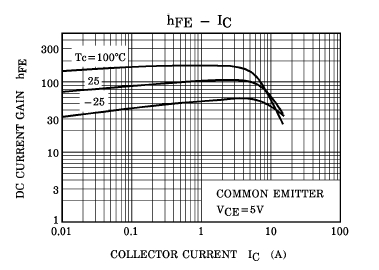

I consider the cross-conduction issue as solved now. I learned a lot more about it. With multiple outputs and single driver it gets worse - maybe explains some design choices made by others. What I want to do is listen to the amp in more detail but for that I think it will be easier to add the power supply and put it in a box. Listening will allow some fine tuning of C4 and R8.
For me, the priority was to make the P3a output stage. This means a BJT driver and BJT output device, single pair. I'm not claiming it to be the best and I would encourage you to experiment. The CFP driver and emitter-follower output I used in TGM3 and TGM5 might be worth your time too.
Look at the attached excerpt from the datasheet for the 5200 device. The beta is the same at 5A as it is at 10mA; if you use the MOSFETs the BJTs never see 5A so no beta droop, ever. With the new resistor values (posted above) the FETs kick-in at lower current now, around 1.8A in simulations (with no adverse affect on distortion). They also reduce the current draw through the drivers, which stay cooler; the amplifier is thermally stable. And no device matching is required even though I have two pairs.
