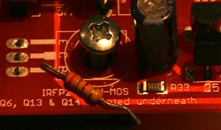

#768 - some photos and comments on how the power devices mount under the board and the use of some TO-126 transistors with legs removed are used as 'spacers'

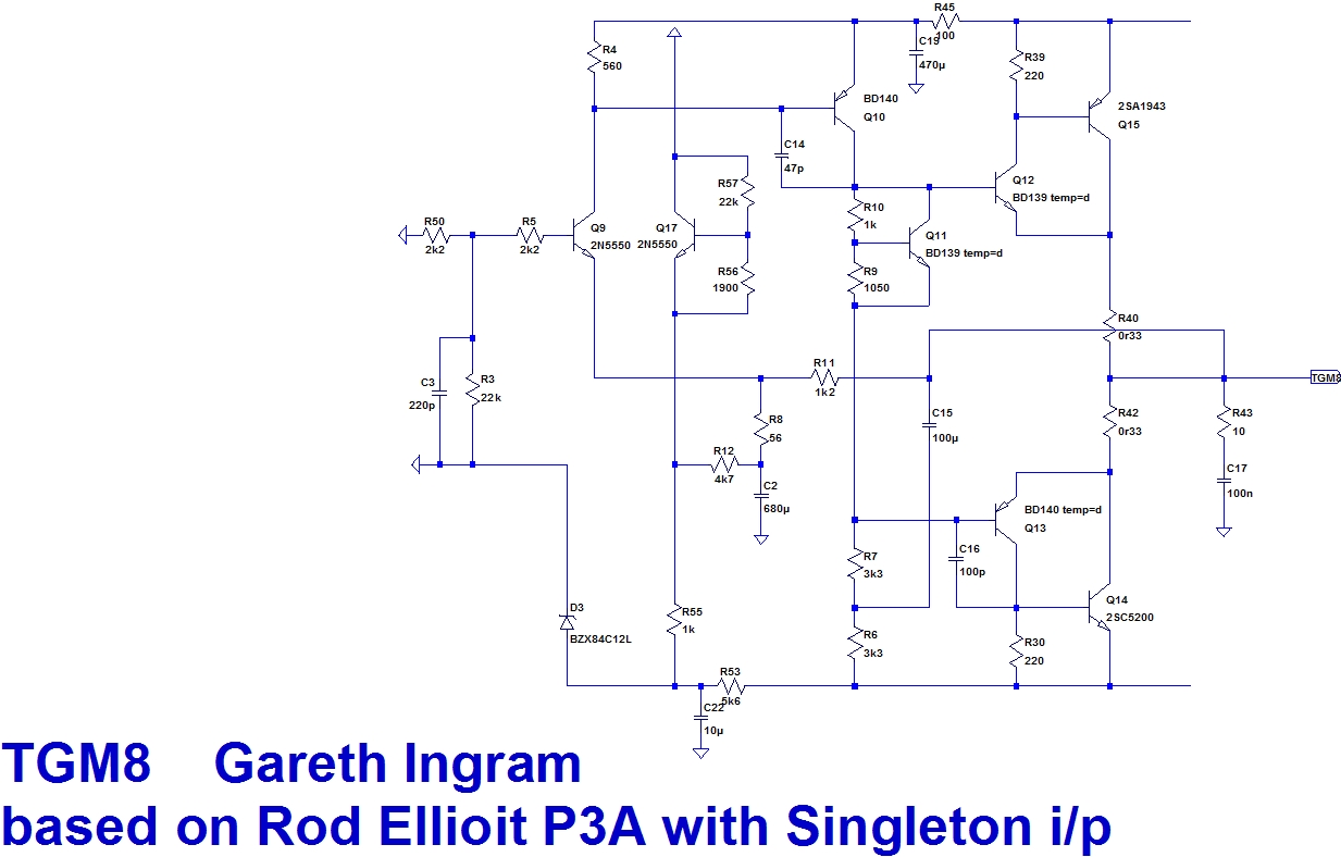

Also - I can not edit attachments to the first post, the schematic you see in this first post shows my initial scrawl - not to be confused with the schematic of the as-built amplifier.

I forgot to mention another key thing about the input stage. By controlling the d.c. level in the feedback network in this way, the feedback capacitor is quickly brought up to the correct bias voltage and doesn't create the turn-on issues normally associated with a Singleton input. There are other contributions to the turn-on behaviour of the P3a and this is something I still have to look at.
PCB ? --- I'm afraid my recent designs have been unpopular around here because I make use of a mixture of through-hole and surface mount. Some people really are still afraid, in this day, of surface mount. My plan so far on my TGM7 has worked fairly well. I use through hole for parts with 3 or more connections such as transistors and trim-pots. I use through hole parts for all large capacitors too. Where I have been using surface mount is for resistors and even then I use 1206 sized parts. These are parts are big enough to read their labels so you can read off the values of them. Have a look at the attached photo to see a through hole resistor lying on top of a pcb near a surface mount resistor. It's not hard to use at all, a pair of small pliers to hold it in place whilst you solder one end at a time. You end up being able to solder them in quickly and easily, with little solder. They allow for shorter signal traces and more compact design which can be very handy when your feedback amplifier has open loop unity gain in the MHz region. The only disadvantage is that you can't easily remove surface mount resistors unless you have two soldering irons, or be prepared to crack it and remove it in two pieces. I haven't decided which approach to designing the pcb to take with TGM8 yet.

Smd 1206 size resistors are quite easy to solder and desolder if one uses a magnifying lamp. I put some solder on one pad, then put the resistor in place and hold it until the solder cools, 1-2 seconds. Easy to do the other side as the resistor is held in place by the first solder. Desoldering with braid is pretty much the reverse of the above. It's possible to save a desoldered resistor, but they are so cheap that I usually use new ones.
For me, using the magnifying lamp is essential and I now use it for all soldering.

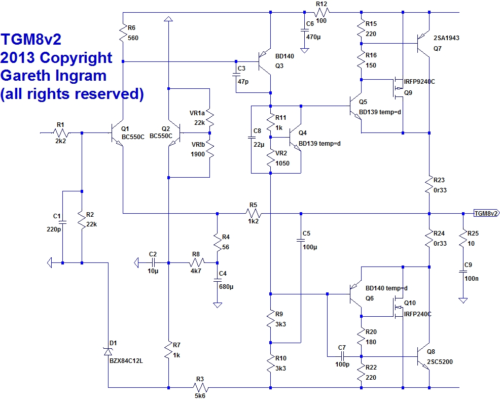

Output Stage - I want to preserve the sound signature, so we keep the simple CFP and most likely with BD139/140 and 2SC5200/2SA1943 pairings. I will look at alternative drivers but this is a good as any place to start.
Trouble is that with higher rails/powers and more difficult loads we start to run out of steam with a single pair of outputs. The input impedance of the power devices drops at high current (so called beta droop) which taxes the drivers. In the CFP the drivers feed the base of the output devices with their collectors - a high impedance drive. This is the worse case for driving power BJTs at high currents with beta-droop. Even the venerable 2SC5200's have some fall off in beta at high current. The other issue is BJTs are easily destroyed if over-stressed. The solution is usually to add another pair of outputs.
There have been CFP output designs with more than one pair of outputs, some use one driver per pair of power devices, others have a separate dedicated driver per power device so a pair of outputs needs two drivers. I remember Sakis saying that none were quite as successful as the single output pair. So I'm keeping to the single output pair.
However - by adding a pair of power MOSFETs that only turn-on when the power BJTs reach high current we can divert the extra load current away from the BJTs and cap the maximum current flow through them. Under difficult load conditions or peak powers the MOSFETs will take on the additional stress and protect the BJTs. These MOSFETs are more robust and do not have beta droop. Since the MOSFETs remain off during low-medium powers they do not contribute to the sound of the output stage for normal listening (whatever that is).
So we preserve the sound of the single output pair at low-to-medium powers but enable the amplifier to drive higher peak powers into more difficult loads when needed

Gareth,
Clever approach.
The mosfets saturate much further from the rail than the bipolars. You could be in a situation where the bipolar is approaching rails, but when the mosfet cannot turn off because the gate drive is too close to the rails.
How about substituting the devices so that at lower output the mosfet operates and at high output the bipolar chimes in to help? Would this work?
Hugh

I prefer the simplicity of the first version without the MOSFETS in the OPS. 50wpc is a useful amount of power.
I notice you have added R-C filters for the VAS and OPS, but omitted the filter caps and 100nF decoupling caps on the OPS rails. Was that intentional?

Hi All,
PCB - well I'm still deciding on the approach. It's primarily for my project rather than public use so I can't promise it will please all.
The schematic I posted is a simplified layout - there will be additional parts. I haven't looked at the VAS yet and if I stay with a simple VAS I will include footprint on the PCB for two-pole compensation and phase lead compensation along with bypass caps on the rails.
Hugh - I will give some proper thought to your suggestions for sure.
One thing to note, the pin-out for the MOSFET and the power BJT are almost inter-changeable (gate-drain-source usually maps onto base-collector-emitter) allowing a 'universal' layout and experiments to follow.

I also think that the circuit will work fine with higher rails voltage, two pairs of output BJTs and single drivers (if high power is really needed). The proof is LJM L12 amp that Ian Finch built.
Also, the circuit may be tried with only one pair of MOSFET outputs, but CFP output configuration should remain.
What about the VAS ? - is it important to leave this alone so as to retain the character of the P3a. We could allow for an option on the PCB for an enhanced VAS so that we don't have to change it, but we could still try an enhanced VAS and keep it only if we wanted. The penalty is space on the pcb.
What I had in mind, in the full spirit of the P3a, was a CFP based VAS. Why might we consider this ?
- It should be more linear, especially at lower frequencies and large signals. At higher frequencies the simpler single VAS device is partly linearized by Cdom, which takes signal from the collector and feeds it back to the base.
- The P3a does not have a class A emitter follower buffer driving the output devices, the drivers also switch off with the outputs which puts some switching noise right back at the VAS. A CFP VAS will provide a buffer.
- We could get fancy and use a CFP VAS to bootstrap the input, this would get us another 10dB of open loop gain (I did this in my TGM6 amplifier - thread around here somewhere) and it works well.
Thoughts ?
