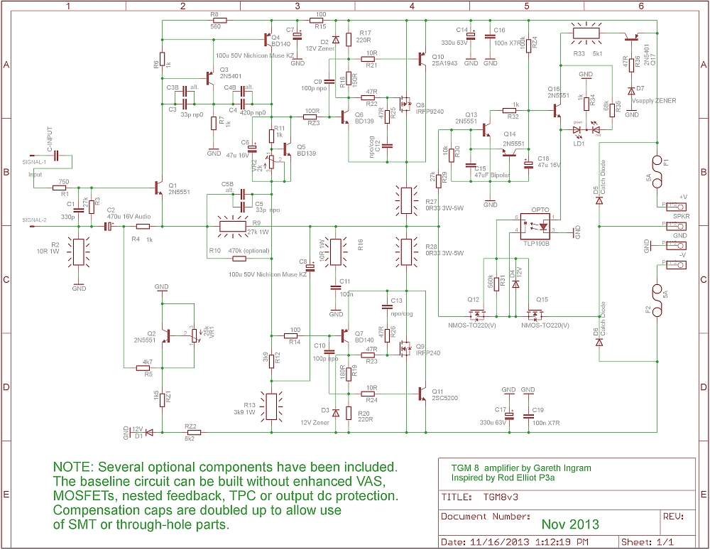

Thinking about this some more I don't expect there will be enough room for 4 bulk caps plus pi filters. Can you simply add a couple of pads - one per rail - and leave it at that? 30 or 35mm if there is room or 22/25mm if not. Of course there will need to be room for the fuse clips. It's going to be tight working in the constraints of a 100 x 74 board.
I also noticed in your schematic that you've added an RC filter on the +ve rail for the front end but not negative. Why is that?

Can you reconsider provision of the input cap, even if it a small pad for a film cap of 5mm pitch. There will be people who will want to install a cap and bypass the doc protection circuit, or vice-versa. There will be others who want the extra protection of both. It doesn't occupy much space, gives people flexibility, and is easily jumpered by those that don't require.

Hi, I'll give all these good ideas some thought as I work through some of the layout challenges.
The negative rail to the front end is also RC decoupled and it's there in 'plain sight' in the schematic. But you are probably not used to seeing it in this form, it's quite clever - give it a little more thought - can you spot it ? (Hint: the output can be thought of as 'clean' just like the power ground)
C2 appears to be serving double duty as the feedback capacitor and -ve rail filter cap. But I don't understand how or why, nor the rationale for the resistor values around it. Why is C22 necessary?

Well if we look at the -ve rail there are only two items once you get back from the output stage.
Referring to the part numbers in my schematic at post #23:
The nearest item to the output is the VAS, the collector is connected through R27 and R28 to the -ve rail. Connected to the junction between these resistors is the bootstrap cap from the output, which for the purpose of worrying about noise on the power rail is pretty much the same thing as ground since it connects to ground through the speaker. The combination of the boostrap cap C13 and R27 act to isolate the VAS collector from noise on the power rail. It's not as obvious as an RC filter on the rail where the C goes to ground, but it works pretty well all the same. This is what I meant by 'in plain sight' - but not so obvious on first look.
Of course there is also a connection to the -ve rail from the dc bias network (Q14 and surrounding parts) but this is also well isolated from noise on the power rail. First off, by the zener diode. Then you have the resistors R38 & R39 along with C22 which act to form an RC filter. And lastly there's the feedback cap C19 and R41 which also act to prevent noise from entering the feedback node. All this keeps the PSRR healthy.

Andrew, can you point me to a text that deals with the Singleton IPS? I can't find any reference to it in Cordell's book, and scarce material on the Internet.

One place with some introductory comments is here: Elliott Sound Products - Audio Power Amplifier Design Guidelines
If you dig a bit deeper you will find a lot more. JLH is a famous Brit that advanced the art of solid state amplifier design early on and was often to be seen using the Singleton input. Try searching for the jLH 1969 Class A amplifier.
Closer to your part of the globe would be Hugh Dean of Aspen Amplifier / ASKA fame. He has also built a lot of well designed amplifiers that achieve that distinction of being well engineered and also tuned and optimized for great sound - he also favours the singleton input these days.
You can of course take the singleton into the symmetric design realm, Jean Le Hiraga is well known for his Class A amplifier which uses this approach and there is a whole thread on this forum that is currently very active talking about 'CFA' - meaning 'current feedback amplifiers'. The singleton is a form of CFA to many people.
At the end, there may be only subtle differences between a singleton and the LTP. It's part of the fun of this hobby to explore these differences.

Hi Sakis - your English is very good - we are very happy to have your contributions here as you are an expert on the P3a.
Please don't worry about the MOSFETs, for purposes of understanding my design consider them not to exist - the amplifier assembled without them. Only real difference here is the Singleton... which makes you a little nervous I see 😀
I am impressed with your singleton VBE offset.Very very good thinking. I also like the way the feedback is injected into the current path of the singleton input. As the VBE sets the voltage, the FB current is modulated over the FB resistor, a good way to make a CFB.
Ah, now it becomes a little clearer. I mistakenly thought that Q17 (the Vbe multiplier) was part of the basic "Singleton" topology, which I've only seen referred to as a single transistor input.

If I have time I'll consider it - feel free to remind me later. The first version though will be split rail, it's likely to be too difficult to accommodate both on the same pcb.Bigun,

In the P3a and this TGM8 the feedback network has a capacitor to ground to ensure 100% feedback at d.c. This means that any dc offset at the input is not amplified. A small amount of dc offset at the input = small dc offset at the output which I don't worry about. As my source components often have output capacitors I already have a dc-block in the signal path and I hate to spend big $ on high quality input caps for an amplifier when there should already be one at the source. So I don't use input caps in most of my amplifiers anymore.
Well - I'm attaching the Eagle schematic. DON'T PANIC - it looks rather complex I know. This is because it includes ALL the options I have been thinking about (including an enhanced VAS you probably haven't seen before anywhere else and my design for a solid state output relay with delayed-on and fast-off you also probably haven't seen before anywhere else). It allows me to see what I can fit on the pcb and what I can't. Anybody interested in building TGM8 - YOU WILL BE ABLE TO ASSEMBLE THIS AMPLIFIER IN IT'S SIMPLEST FORM leaving many parts off the pcb and adding a couple of links where needed. I've determined which resistors need to dissipate reasonable power and have shown them as 'glowing resistors' on the schematic. I am going to favour through-hole parts for these resistors and SMT for the rest.
Now would be a good time for people to chime in with any errors you can see!
