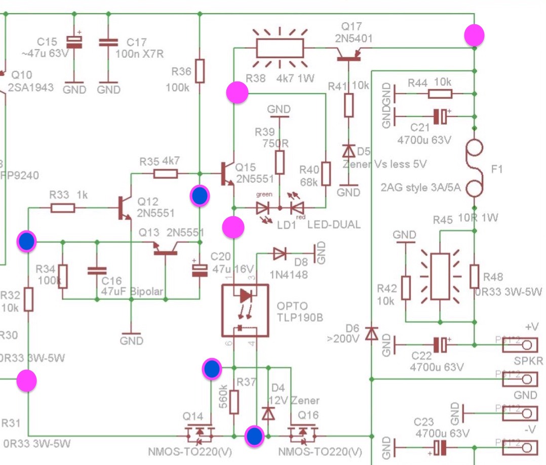

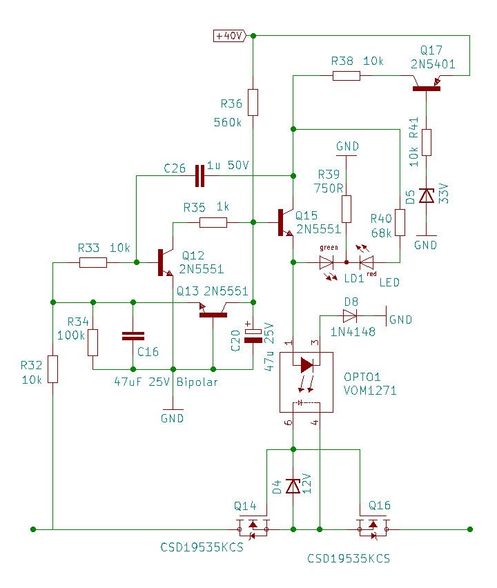

The 'speed-up variation' for the DC protection circuitry shown in the TGM10 thread seems like a worth while modification, however I want to use my existing TGM8v5B boards as is without modification so I was thinking of simply changing the following resistors and caps, and retaining the dual colour LED section.
(numbers on the original TGM8 circuit)
R33 - 1k to 10k
R35 - 4k7 to 1k
R36 - 100k to 560k
R38 - 4k7 to 10k
C20 - 47uF to 33uF
But don't use the green LED
Don't use the 1uF 'speed up' cap

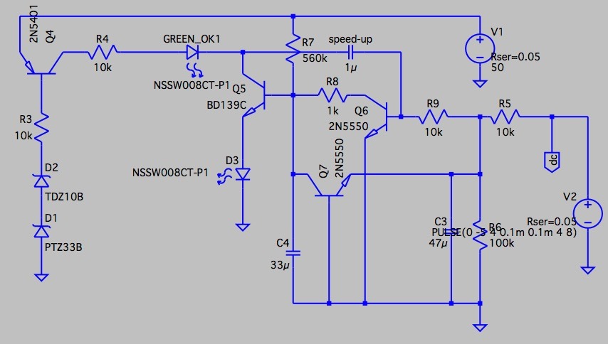

I've been simulating using the values proposed and found that the 'speed up' cap didn't contribute much so I am happy to leave it off.
My sim gives an approx DC fault trigger time of 13 ms.
My question is around the susceptibility to false triggering low signal freq. After all, an extreme low Hz, high voltage swing speaker signal starts to look like a DC fault. As Gareth explains it 'R32 samples the amplifier output and together with C16 forms a low-pass filter so that the circuit is sampling the average dc-level ' so I have been fooling around with different values here.
In my sim it looks like the circuit as suggested is great at lowish signal levels but once the speaker output at 20Hz is above 33 v peak (66 v p/p) the protection starts to trigger. At 15Hz I see triggering starting at 25 v peak. Yes I know that this is extreme output and there shouldn't be any signal below 20Hz, but it is with such low bass that the largest voltage signals will occur, particularly in home theatre situations.
So perhaps it is a non issue?
Have any builders of the TGM8 had any false triggers?
And finally, have any builders ofthe TGM8 had the protection trigger with a real live fault?
Caveat re my sim
I know that they are only a sim, not real world.

I just tested the behaviour of my TGM8: yes, it plays stable down to 20Hz with a 2V sine input (full power with my 40V rails) into a 8R load. Below 20Hz it starts to trigger the protection circuit, at 15Hz the portection tries to switch off after a couple of seconds but goes on again, at 10Hz the portections stays permanently on. The values are as in attached diagram which shows my TGM8 as built. Question: obviously I omitted R37, is that a problem?
Thanks JPK for checking this out for me. I can't see how the omission of R37 would effect the triggering.
One reason I was a little dubious of my own sim was that I found that leaving out the 1uF 'speed up' cap actually gave a faster trigger! ....but I can't imagine Gareth would have added it if this was actually the case. One reason I was concerned was that Rod Elliot's protection circuit works down to 5Hz and he usually knows what he's doing.
Anyhow, although a larger margin for the triggering freq at full output would be nice, that fact that it still works OK at 20Hz (and much less than that at lower output) may be good enough in the real world. So I will go ahead and use the suggested component values and suck and see. Probably never going to be an issue. 🙂
(For the record my sim was using 45v rails and C20=33uF)
Thanks again JPK ...and Gareth

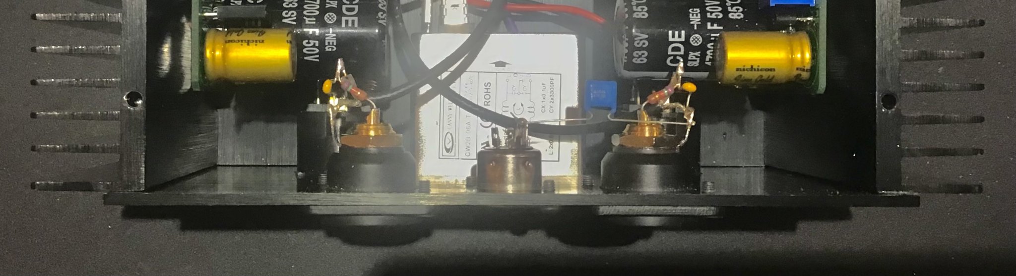

I have some questons about the TGM8: the big caps are rattling if I gently knock them with my finger. Each of the caps makes a noise as if something inside was loose. For the sound: as long as I play "tidy" music everything is incredible clean and beautiful. But with complicated stuff the amp starts to become "untidy", especially when the percussionist plays fast and uses a lot of high hats and cymbals. I tried to use an external PSU to feed clean DC to the amp boards (from a nice H+F 450VA transformer), but no improvement. Even dual mono transformers (2x H+F 450VA and 2 PSUs) didn't change anything. As an example, this kind of "busy" music I mean: that recording is borderline compressed and at the limit in every respect, but can sound extremely good if the system is capable (BTW I use this recording also to test for fatigue). This track from the same CD sounds fantastic! (Of course I have the original, online compression makes this recording almost unusable)...
What else can be done?

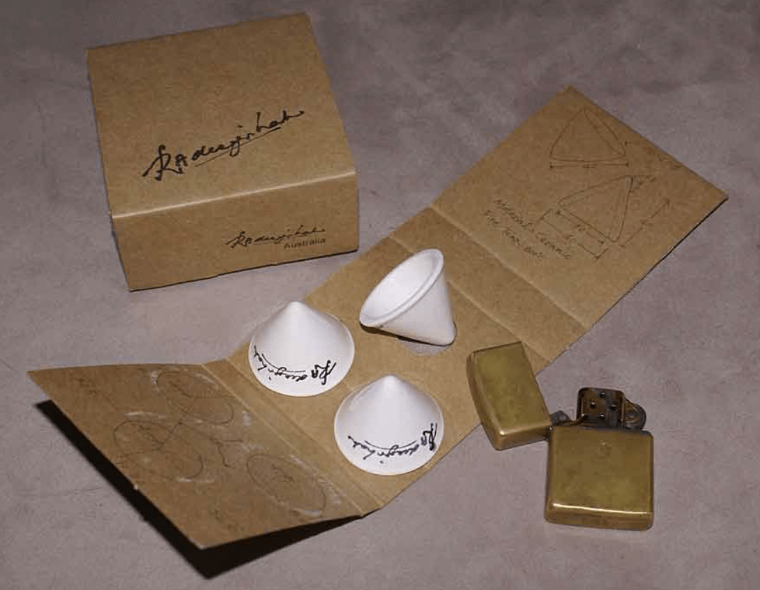

What case are you using? I had the same experience with my Aleph J at high volumes and specific frequencies (exactly as you described), which made the Modushop deluxe 5U case ring like a church bell... terrible!!! I could clearly hear this from my speakers. I fixed the issue by placing the whole amp on 3 hollow ceramic cones with a very thin "wall" (can't find a better word for it.... see below). The cones were great in completely killing the ringing, plus the space / 3D improved substantially. Give it a try...
https://www.martinloganowners.com/threads/report-on-new-isolation-cones.4336/
here as well... with a great photo: https://www.stereonet.com/forums/topic/598448-ra-design-lab-isolation-footers/
Here's something I learnt re captors... the cylinder sizes are standardised; the manufacturers will not make tiny cylinder size adjustments to fit the coiled/foiled aluminium "ribbon" to fit EXACTLY into the cylinder.
In other words, you may find that for the same nominal voltage (for example 50V DC), and the capacitances of 5600uF, 6800uF and 10000uF, the cylinder size is the same. In that case, go for the 6800uF because the empty space left inside the cylinder will be populated by a rubber ring (the space will not be left empty, like with cheap Chinese ripoffs). So, the 6800 uF cap in that case will have some rubber inside to dampen mechanical oscillations.
Give it a consideration, and definitely try what I suggested above - you'll be surprised.
Another option is to use large, heavy & expensive filter capacitors... like Nichicon Gold Tune 10000uF 50V. Their special construction and "heavy and inert" dielectric will make them completely immune to vibrations.

Oh, I did exactly the opposite and took the largest value cap in the same size can. It has 6800uF. Might be the reason for the rattling...?
My TGM8 is still without case BTW, but thanks for the hint about the cones!
And yes: I used Mundorf 22.000uF caps offboard. In my other amps they sounded so much better than anything else...
