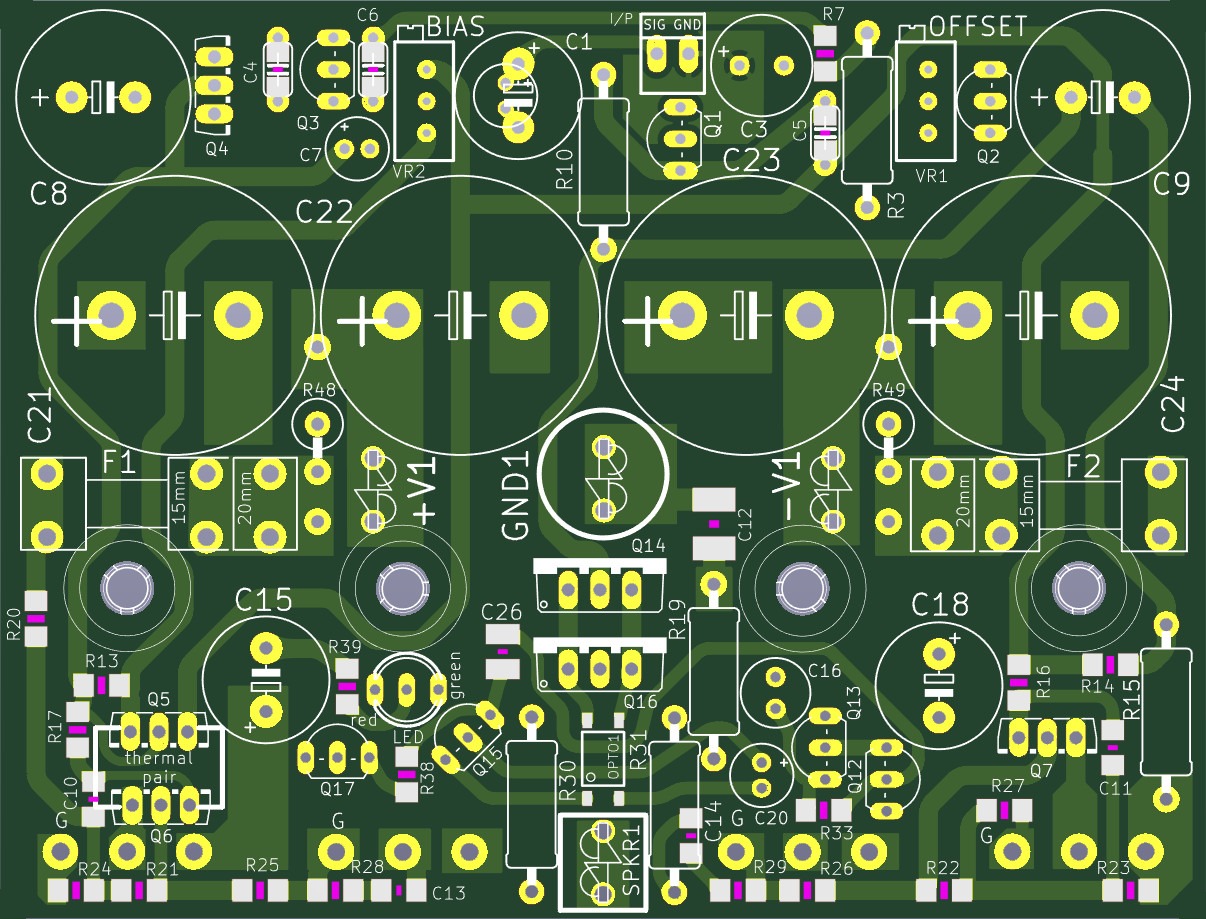

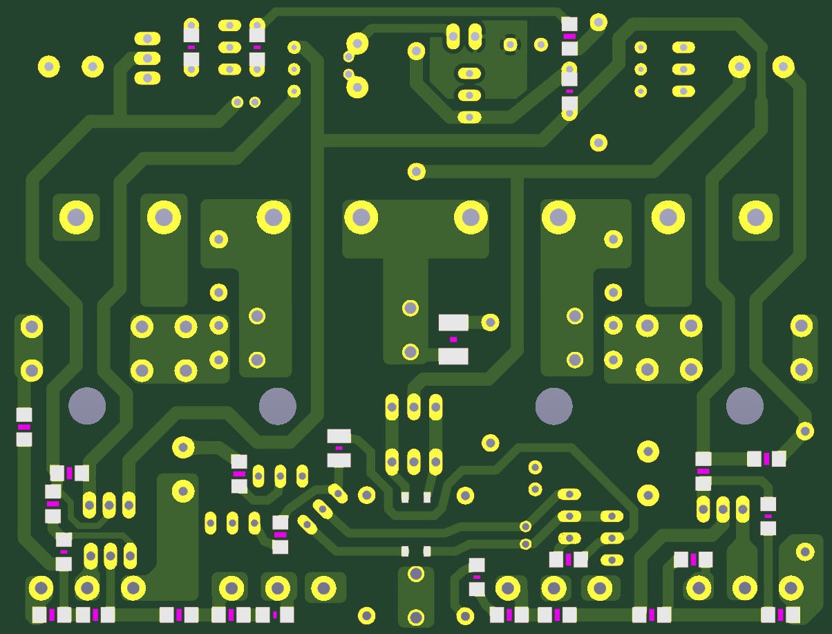

Attached the updated PCB: protection circuit as shown in #1169, and as the board is rather crouded I tidied up the silk print so that the reference of each part is visible. What else can be done?

I don't see a designation on the large TO-247 Fets and BJTs, would help so they don't get put in wrong spot. Also looks like you named the first leg on all 4 large outputs as "G", (2) should be "G" the FETs, and (2) should be labelled as "B" the BJTs. Changing one or both of these would assist with confusion on placement location.
Great job - appreciate all the work, I have two original boards, I'm still holding onto for future use.
EDIT - nevermind - I see you put them on the back silkscreen. Thanks.

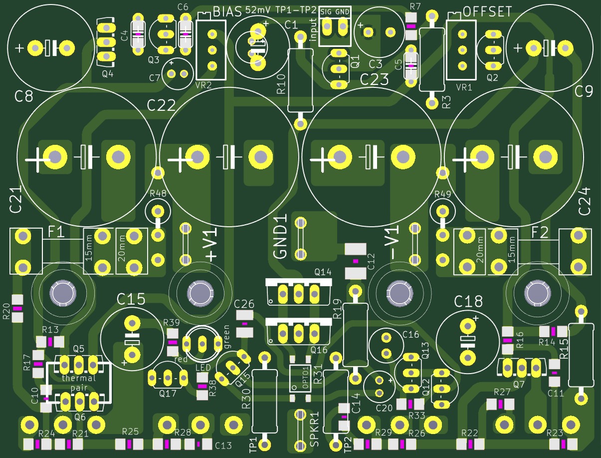

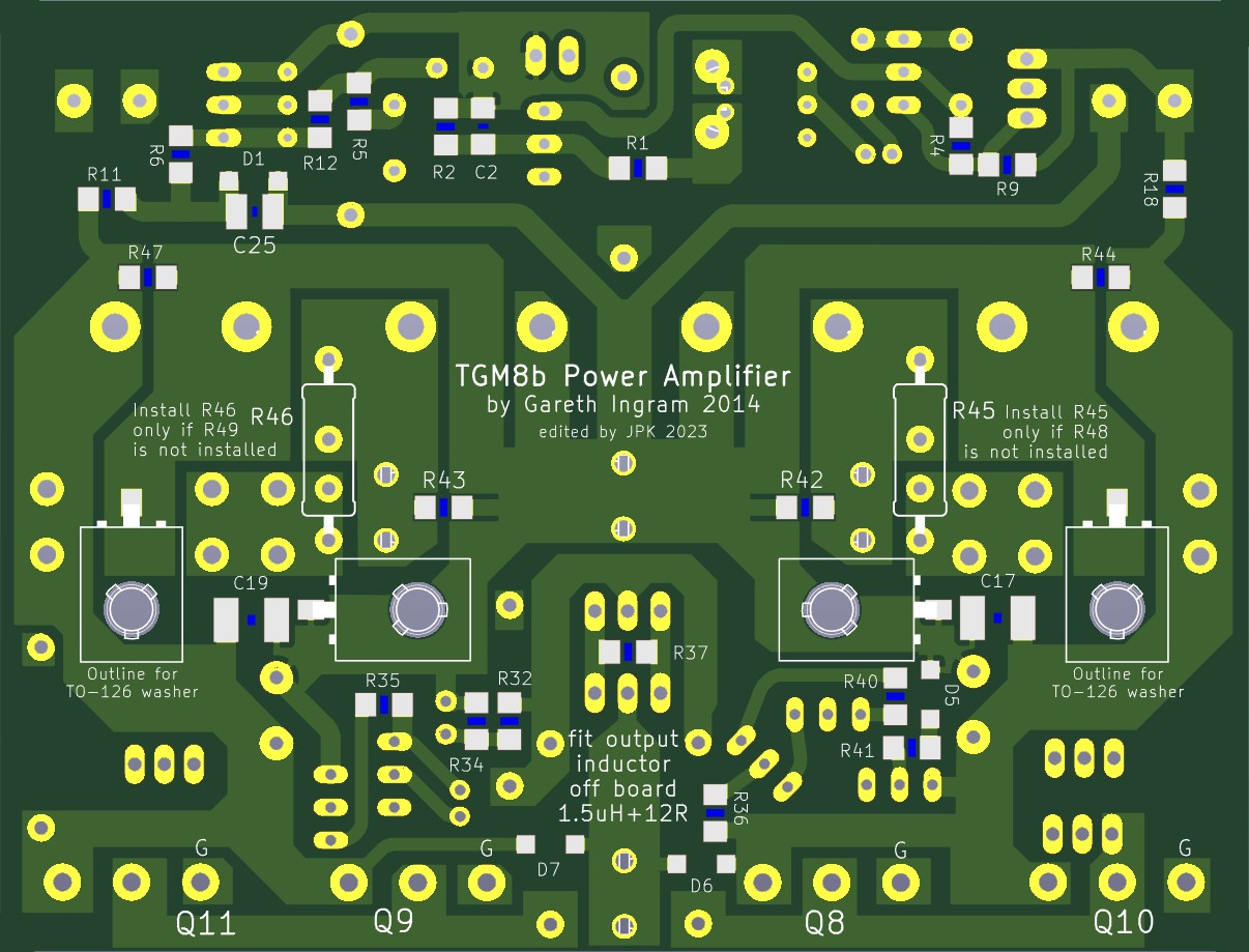

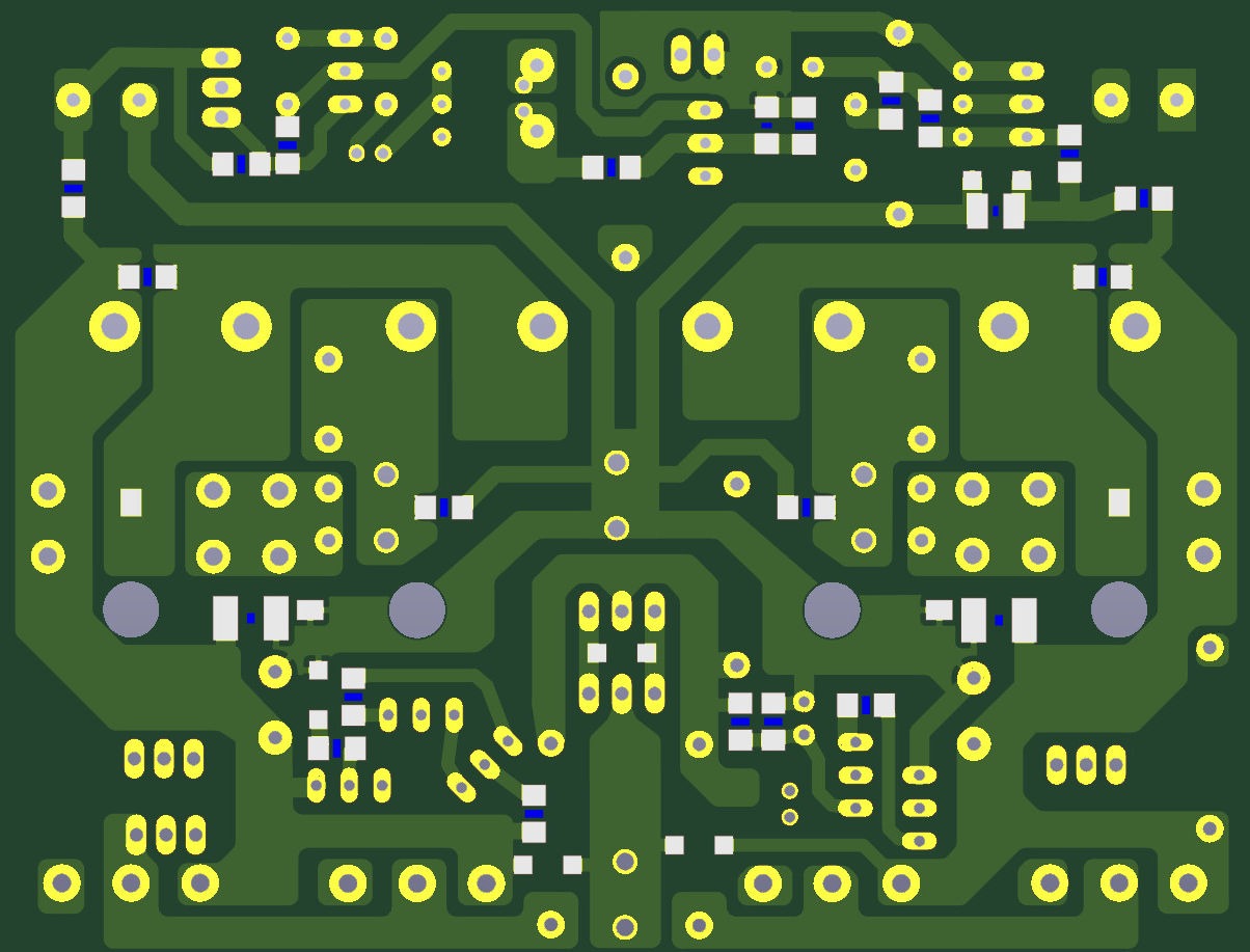

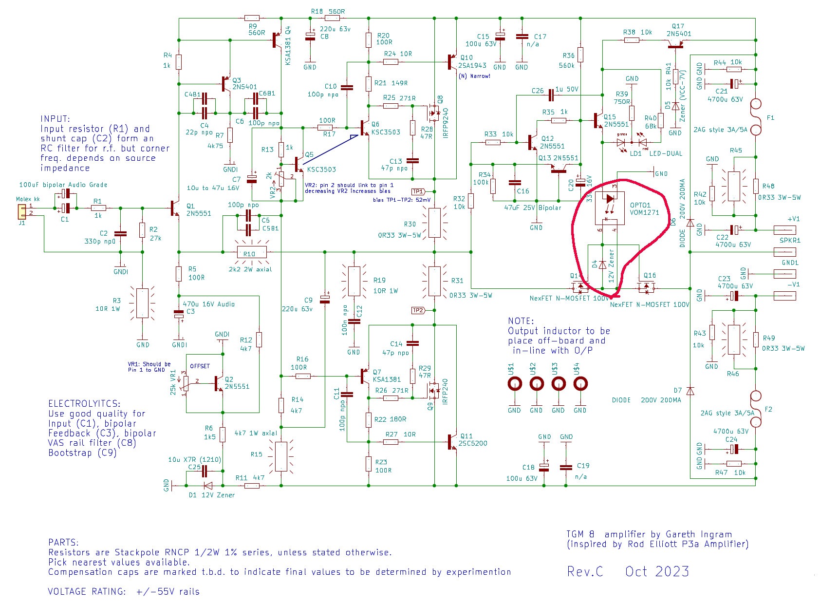

Attached the corrected silk print, I also rounded the corners of the copper areas, and the only small mod to the schematic is marked in red (because the opto coupler is not in stock at mouser):

Thanks! I will lable the output devices correctly (they go unter the PCB, hence silk print is on the back side).
Question: should we alter GND layout as suggested in #1122 and #1123?

OK, here are my Kicad files: I did a lot of small retouching such as moving SMDs which were sitting too close to each other, or improving thermal separation between pads and copper areas (all for better soldering), so no big changes, just a lot of small stuff that should make assembly easier. The snap-in hole size was fine BTW. GND layout in the input section is improved as well. Other than that I tried to keep as close as possible to the original spirit of the layout. @Bigun, you mentioned that you want to move from Eagle to Kicad iirc, so I hope you can use my work as a starting point for your future plans with the TGM8 (if there are any).

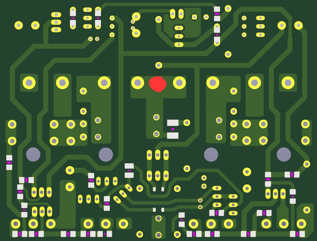

Actually the power-GND layout is still not good, I will rework it again. The wire coming from the rectifier should connect between the main caps (marked red in attached picture), and from there T'd away the cleaner GNDs should be connected. Otherwise these other connections "see" the dirt on the 0V line between caps and rectifier. I guess the solution is to isolate the connector from the star point...

Looking at your posted images I don’t see traces narrower than the pads which is fine. I prefer fat traces, even if the thinner traces are good in terms of current handling I feel that fat traces are more robust and less likely to get damaged or lift with a hot iron. I haven’t started using KiCad yet, maybe it has some built in tools or design rule check where you can set a minimum trace width and it’ll warn you if there’s a concern. In terms of current, it is often possible to order pcb’s with thicker copper for an extra fee.
Depending on your skill and experience, you might like to use larger - elongated pads for the SMD opto device so that it’s easier to install by hand.
Thanks for the hints! OK, I will use an improved footprint for the opto. Kicad has a nice check tool, and I will use 2oz PCBs, so I hope it will be fine like that.
Kicad is easy to work with once you get used to it. Only at the beginning it can be confusing how everything is linked together in that software package - but now I appreciate it a lot, even editing the schematic or PCB files with a text editor and use search/replace to batch replace parts etc. is possible...
