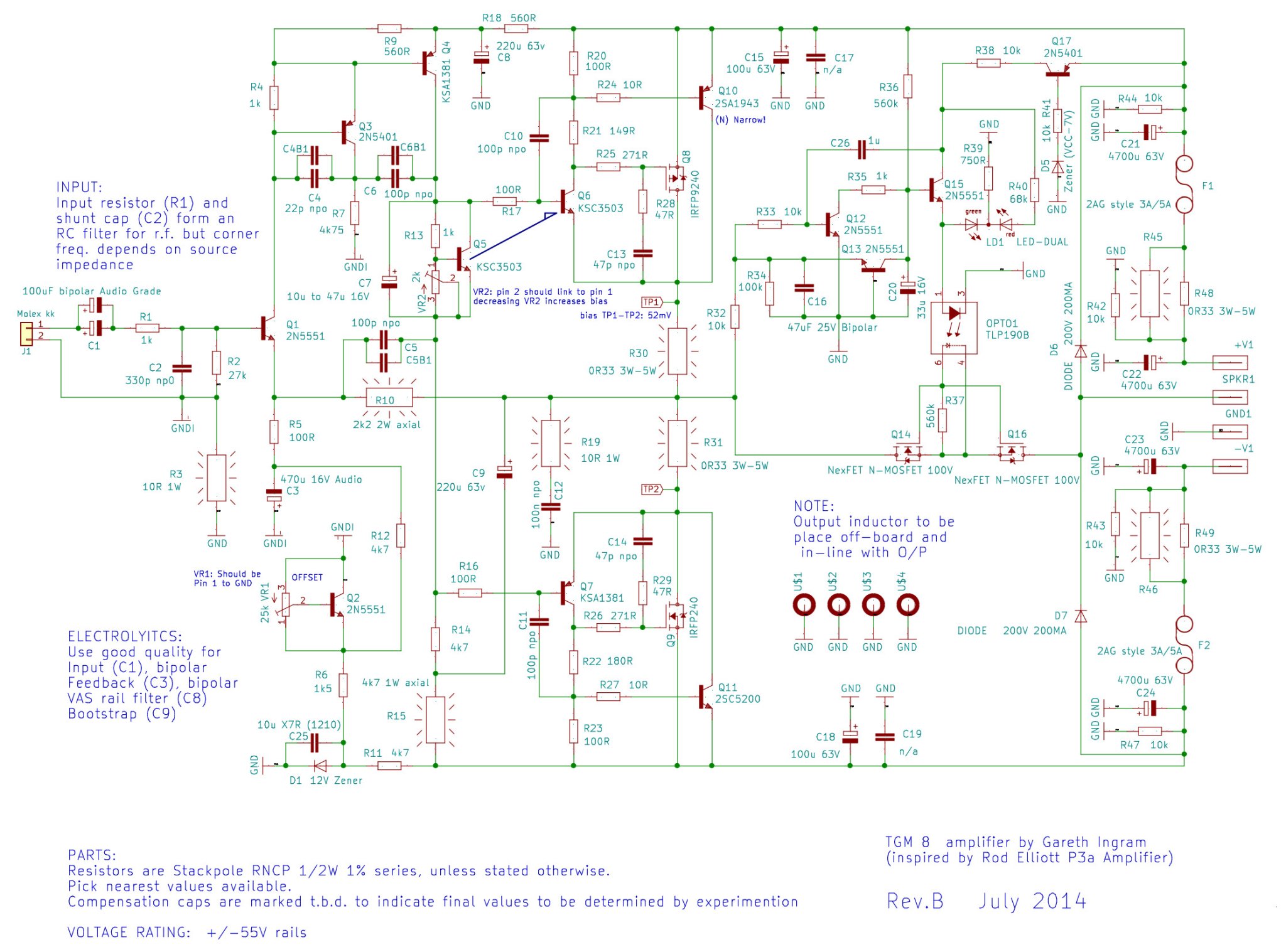

Hi, I built a Naim clone and thought I want to try something different, so I read through this impressive thread. I used the Kicad files posted earlier to add some small updates, please see attached screen shot. The diodes on the drivers are removed as @Bigun suggested and the protection circuit is updated as discussed in the TGM10 thread. Please let me know if I got it right!

Just a quick look - don't see any issues. It's been awhile since I looked at this design but I can tell you that this amp is still in use as my main SS amplifier. As it's been awhile I would check carefully on parts availability. There are not likely to be any issues as there are good (or possibly better) alternatives to all the parts I've used. In fact, you should avoid going to any extreme lengths to obtain the specific parts I've used as I don't consider these specific choices to be crucial for the performance and sound quality. Of course they have to be equivalent.
I do find that a careful-hand is required to set the dc-offset. If I were to re-design I might try to improve this situation. One obvious option is to add resistors in series with the potentiometer so that you can reduce the value of the potentiometer (maintaining the same total series resistance) so that it's less sensitive to the rotation angle of the adjustment.
You might hopefully improve on my pcb layout so that it's easier to assemble - there are a lot of parts and it was dense. Of course, short path lengths are needed in some areas (e.g. the RC snubbers on the power FETs).

Read first post, it has a contents list. If everything is working, you can download files etc. This includes Gerber files which you can use to order PCB’s without ever having to learn the layout software.
I no longer design pcb’s using that software and I will use KiCad in the future. However, I’ve yet to learn the interface for KiCad so I’m not going to be able to offer assistance on layout.

Ok, I will walk through the BOM and post the final KiCAD files later on.
@Bigun, what voltage rating does the speed cap for the protection circuit need?

I’d want to run a Spice Sim as the lazy way to figure out voltage rating for that cap but off the top of my head, the end near the output could presumably swing + / - the full rail voltage (i.e. twice that of one rail) under a worse case fault condition but by then your priority isn’t the life expectancy of the cap! In normal operation it’ll never experience d.c. at the full (single) rail voltage so if you rate it close to the rail voltage you’ll have some headroom. e.g. for +/- 42V rails then 50V is more than plenty and 35V likely OK. A quick look at Digikey and there are lots of 50V 1uF electrolytic, through hole 5mm dia caps for less than 50c.
Thanks for clarification! I will have a spare +12V rail in my amp and might want to use that for the protection circuit - would that affect part values / ratings?

Would you be so kind and help me figure out the values? I guess I need to reduce R36, R38-41 and D5...?

Not easy right now due to busy with the day job, but I'd encourage you to understand more about how the circuit works as then you'll be able to do it yourself. Off the top of my head, referring to the schematic in post #1,169 -
Let's talk about the Zener diode first. It is there to provide a reference voltage to the base of Q17 that is a few volts below the power rail. When you turn off the power and the power rail collapses the voltage on the emitter of Q17 will eventually (it happens fairly quickly) fall below this reference voltage at the base and the p-type emitter-base junction will no longer be forward biassed so the transistor turns off - which stops current flowing through the solid state relay and hence disconnects the output from the amplifier. We want this to happen in order to avoid any audible noises or sub-sonic excursions of your speaker woofers when the amplifier powers down. So first off you can see that you'd need to reduce the Zener D5 voltage to around 12V - 7V = 5V. It doesn't have to be exact, the idea is to catch the supply rail falling.
But note: If you power this circuit from a separate 12V supply which doesn't collapse at the same time and rate as the main amplifier supply rail, the circuit may not turn off the amplifier output soon enough to prevent shut-down noises. That will depend on your power supply implementation and to keep it simply why not just follow the circuit as I've published and forget the 12V supply ??
