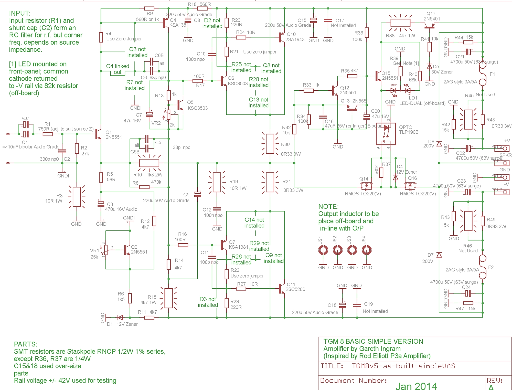

I've corrected it in the schematic at least, shows current as-built status.
It is nice innovative artwork, and looks like sounds very good.
What I am wander about is protection circuit. Have you tested it? Something is not clear to me.
There is no difference between published ESP P3A and actual pcb schematic. PSRR comparison is possible using simulation.
I think that one worthwhile improvement would be to use simple cap multiplier on the pcb for VAS and input stage. Example on the schematic of Bora's Studio SE.
Bigun, can you publish corrected schematic for "simple basic" TGM8, one without enhanced VAS?
Hi overallfeedback,
You are right that the protection circuit hasn't been fully tested yet, but we have quite a few positive indications so far that it works as planned. Note that I did publish some new resistor values (post #245) and the LED needs to be taken off-board to make it work as intended. What we know so far:
a) The circuit does turn on and connect the speakers so we know the solid state relay works. It doesn't audibly distort the sound when the ss relay is 'closed' so we know the quality is good
b) There is no sound when the SS relay is 'open' so we know it is capable of protecting the speaker if it is triggered properly
c) There is a delayed turn on when you first power-up the amplifier, the indicator LED is initially Red and then turns Green. It happens fairly quickly, consistent with the simulated time (R36 & C20) plus I don't believe anybody has heard a turn-on thump. So we are pretty sure the delayed turn-on works.
d) I blew a resistor (R18) when the amp was powered up, which resulted in a fault condition that put the -ve supply rail voltage on the amplifier output. There was only a small thump in the speaker and the LED was Red and the speaker was disconnected. So we know the protection works with a large -ve dc-voltage fault on the output and we know it works fast enough.
I haven't tested the circuit with +ve dc-fault or for nuisance tripping yet.

Hi,I think that one worthwhile improvement would be to use simple cap multiplier on the pcb for VAS and input stage.
I've never used a cap multiplier on the front end of an amp before. I see it being used by others though and I trust it would work as advertised. I can look at including it on the pcb if you want to make a new pcb ???
I've made a 'basic simple' schematic - although some things may still change I think it captures what has been learned so far. Is this what you need ?can you publish corrected schematic for "simple basic" TGM8, one without enhanced VAS?

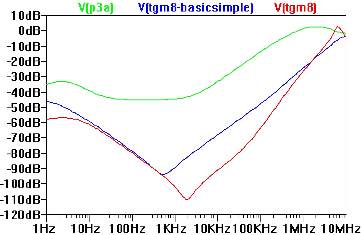

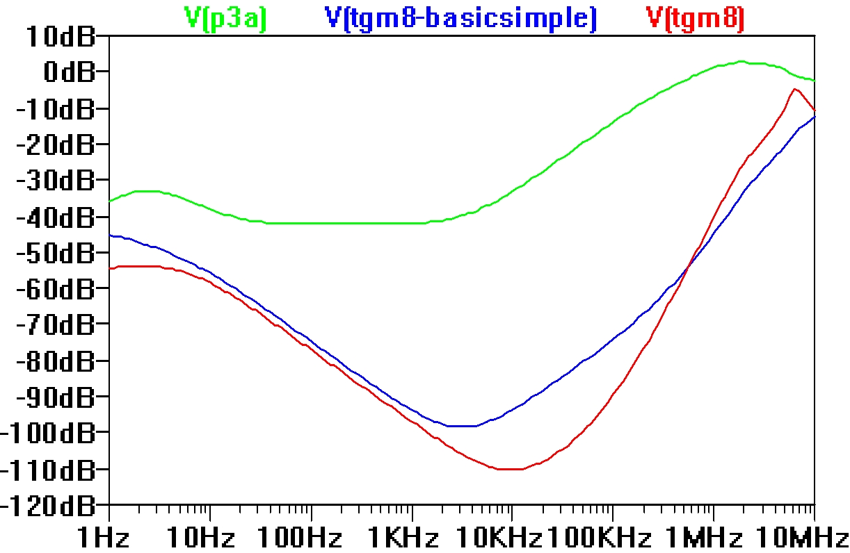

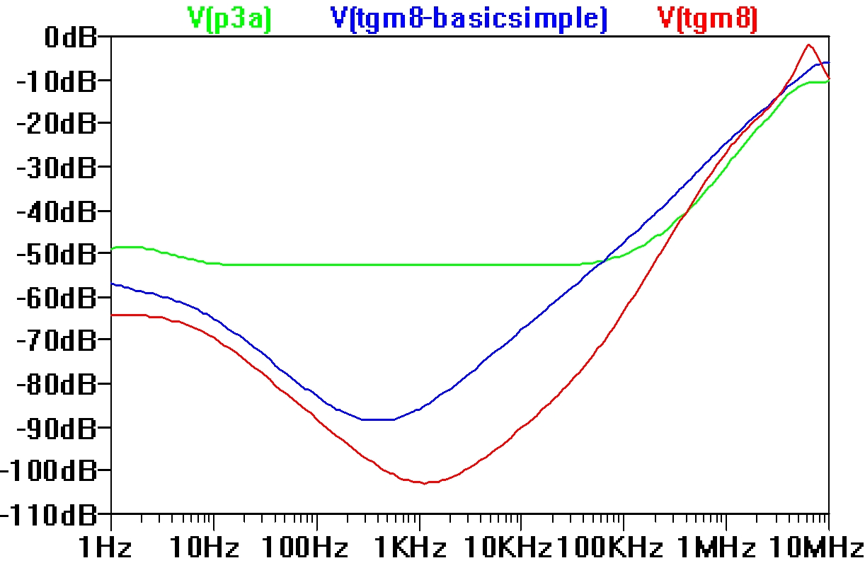

Probably true up to a point, but the results of the simulation do depend on the device models being accurate and they do not allow for capacitive and inductive coupling from the power supply into the circuit as well as a host of other parasitics. I assumed 'perfect' passive components in the simulation too.
Here are my simulation results (attached). I removed all rail caps, just left 100nF rail decoupling in place. This allows a better comparison between amplifiers. All at +/-41V rails too. I used R18 of 560R and C8 of 220uF. Higher values of C8 will improve PSRR at low frequencies for the +Ve rail.
There are 3 plots, one for 'noise' on +Ve rail only (left plot), one for -Ve rail only (centre plot) and one for both rails simultaneously (right plot).
No wonder the P3a sounds better with MrEvil's regulator. But does TGM8 sound better with MrEvil's regulator ?

Yes, that's the schematic that I need, one with changed resistor values to allow proper offset setting.

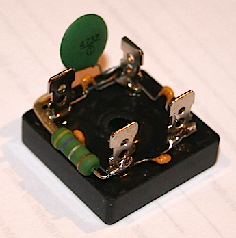

I've installed four 4,700uF 50V (63V surge) Cornell Dubilier Electronics caps into the pcb and I'm trying to put together a lash-up of parts to make a regular power supply.
Photo shows a 35A bridge rectifier (cheap) with some 10nF ceramic capacitors (found in junk box) soldered between each connector. Then I added a 0R47 resistor in series with 470nF ceramic cap between the +ve and -ve pins. You need a hot iron for this as the pins suck heat away quite fast.
I'm not a big fan of wiring up the chassis and so doing a lash up now might be a good idea as it helps work out the wiring (and grounding) before I get some a new box for it. However, I managed to drop a hot blob of solder on my foot and my foot told me it was hot so I'm taking a break...!
I'm not sure you will get the voltage you think from that transformer ? 25a.c. x sqrt(2) - 1.4 (two diode drops) = 34V with infinite capacitor, but realistically less than this. However, you can still use it for the amplifier.

Yes, I installed the 0R33 on the pcb so as to make the CRC. But I think the other components I mounted on the rectifier are also important.
Another factor affecting higher frequency noise is how clean your mains is and how much of it gets through your transformer. An EI transformer has less inter-winding capacitance than a toroid, unless the toroid has a shield between the windings.
Of course you also need to avoid hum by using proper grounding. I used a pair of diodes wired in parallel but facing opposite directions to isolate the amplifier star ground from the temporary chassis which my safety earth is connected to.

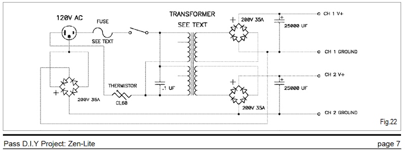

I also isolate my star ground from chassis ground (safety ground) the same way you describe, except I run it through a 35A bridge rectifier, with the 10R 5W resistor and 100n ceramic wired across the terminals, per the write up on Rod Elliott's page here:
Earthing (Grounding) Your Hi-Fi - Tricks and Techniques
I suppose it is wasteful to use a 35A bridge in this way, but I find it very convenient to have something that bolts to the chassis, that I can hang the components off, and will accept fast on connectors.
