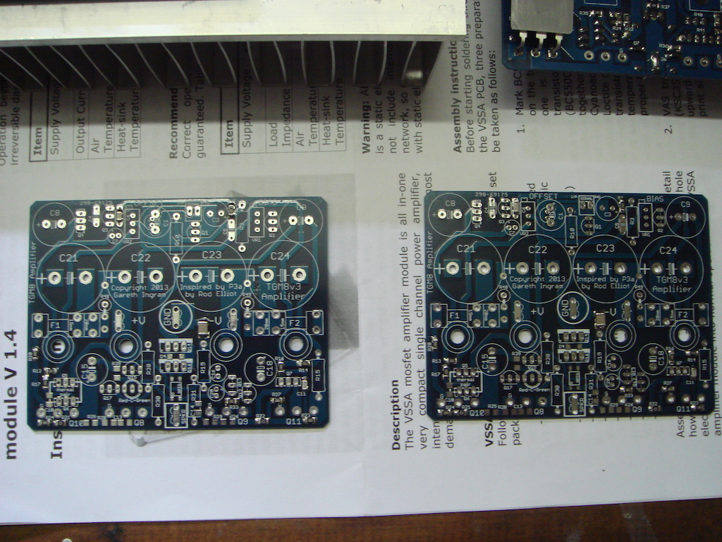

A few days ago I took a TGM8 board, power supply and bundle of wiring to my dad's house to test it with a pair of high end loudspeakers, and to get an opinion of a second set of ears. After 90 minutes of critical listening with a range of music we both agreed it sounded very good indeed, in all its monophonic glory 😀 All testing was with the capacitor multiplier.
So I've decided to assemble a pair of new boards and make a "proper" enclosed amplifier for my living room (the P3A is now relegated to my daughter's bedroom...)

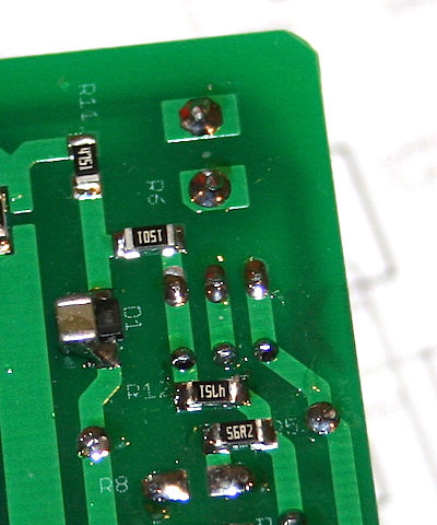

While I wait for an order to arrive with essential parts, I started soldering the SMT components with the surplus from the previous order.
Progress kinda stalled a couple days ago when the replacement VAS transistors arrived for my VSSA that's been on hold for a while. With the new transistors in and the heatsink drilled and tapped, calibrations made, I wired it up to a power supply for a quick listening test. Too early to draw any definitive conclusions; however, my initial feeling is that, in terms of sonics, the two designs have a lot in common. I suspect the VSSA has even more detail and depth in the midrange, while the TGM8 definitely has more body and depth in the bass region. They are both exciting and dynamic amplifiers that turn a brief 15 minute listening session into an hour long one. To my ears the TGM8 retains the P3A's smooth character in the upper octaves that matches nicely to the ribbon tweeters in my living room speakers.

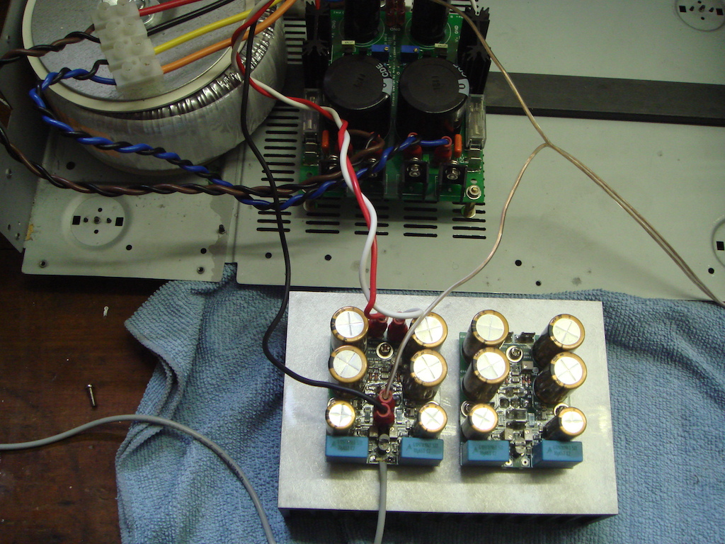

Very interesting. Looks like LC's modules? Surprising that the bass is better on the P3A. Both my VSSA amps have great, punchy bass. You have piqued my interest in the P3A.
I have those Cap Multipliers in three of my amps. Great little PSU.

I also noticed the bass was good on the TGM8, in fact I was a bit suspicious it might be better than on my TGM7 (SKA GB150 clone).
It would be interesting to compare the P3a with multiplier vs the TGM8 without - does the TGM8 benefit from it ?
From what I have learned from Hugh, I believe the mid range can be affected by the nested feedback (R8) as he included it on some of his designs because he liked what it did for the mids. Do you have R8 installed ? you could try removing it, and you could try halving it's value.

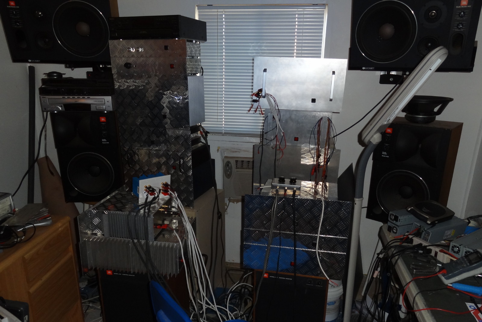

Gareth,
Those are very nice cases. Are they the Modushop ones? My living room P3A is in one that looks very similar.

Hi Terry - you have quite an impressive collection there !

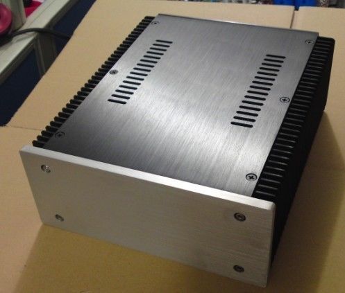

I found this box on eBay: 2109 Full Aluminum Power Amplifier Enclosure | eBay
I decided there isn't enough to warrant a pcb change so I kitted the parts for another TGM8 channel and spend this afternoon building it. Building the 2nd board was nice as I could incorporate what I learned from the 1st board which made it easier and better. It's not quite finished yet. See attached photo. I will eventually use it to try a different R8 and for that I want two channels so I can compare side-by-side. The BOM I followed is attached.

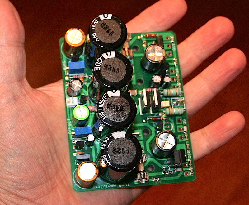

Hi Christian,
Kevin sent me the Gerbers just before he uploaded them to his website. I ordered some boards from a PCB company. I should have them in a week or two. I ordered extra since they had a minimum. Once I build on eof the boards and know they work I will probably sell the extras to anyone interested. I wasn't going to build any more high powered amps but I have a 67-0-67vac transformer from an old Soundcraftsmen amp so this will be a chance to use it. Anyway, I don't want to take this thread off track. Looking forward to hearing more about the TGM8.
