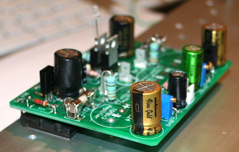

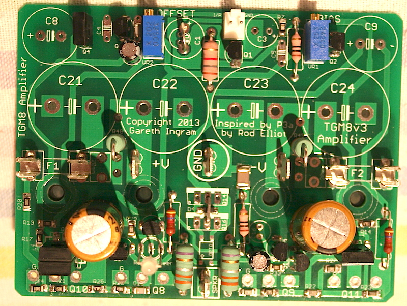

Progress - I've been adding parts to my first pcb today. It's coming along well. However, I found that I have some wrong parts in my order. The BOM I used doesn't have R41 (I substituted a 27k resistor) or R42,43,44&47 which are only there to 'drain' the rail capacitors when there are no other paths for the current to leak away so I left them off. I also ordered a regular electrolytic for C16 when I should have ordered a bipolar device. And my C15&18 were also ordered wrong, their diameter is bigger than I designed for so not sure if I can fit them yet. Clearly I was in a bit of a rush but nothing bad enough to prevent me building a first channel. I am going to jump ahead and build with the enhanced VAS since you have already shown the basic design functions 😀
Joined 2009
Here's a quick no-flash photo of work in progress.
You can see the two large orangish caps - they aren't soldered in yet, but are over-sized and very close to the TO-126 transistors. But they do just fit and it might work if the transistors don't get hot.

Bigun said:Progress - I've been adding parts to my first pcb today. It's coming along well. However, I found that I have some wrong parts in my order. The BOM I used doesn't have R41 (I substituted a 27k resistor) or R42,43,44&47 which are only there to 'drain' the rail capacitors when there are no other paths for the current to leak away so I left them off. I also ordered a regular electrolytic for C16 when I should have ordered a bipolar device. And my C15&18 were also ordered wrong, their diameter is bigger than I designed for so not sure if I can fit them yet. Clearly I was in a bit of a rush but nothing bad enough to prevent me building a first channel. I am going to jump ahead and build with the enhanced VAS since you have already shown the basic design functions 😀
Sorry Gareth, C16 was incorrectly specified in my original BOM, which I rectified in the December 16 update, after I realised having received the incorrect part in my order.
For some reason R41+ are not in my BOM. I noticed this too when I assembled my first board, but I didn't worry much, especially since I wasn't adding onboard filter caps. When I built the second board I substituted a 8.25k for R41. I'll rectify the BOM soon.
What did you order for C15 & C18? I used Nichicon HE 100uF here (the same part for C8 & C9 also) and had no problems. Please let me know if there are any BOM changes required.

BOM - it's a work in progress based on what I have mis-ordered, my junk box and circuit changes we have found necessary; the quick list of changes from my rough notes:
C15&18 - I bought, by mistake (trying to optimize), high quality Nichicon fine gold 493-10876-1-ND which are a bit too big. If building again (for less than 50V rails) I would specify 493-10919-1-ND as the high-end option. Anyhow, being that the fine gold are so nice I decided to use them for C8 & C9 as I think they will provide the most benefit in these locations. C9 is the bootstrap for the VAS and C8 is the rail cap that the VAS current uses as a return path to ground. For C15&18 I'll probably shoe-horn in the caps that I bought for C8&9 (493-3195-ND) even though they are too large as they are also Nichicon muse and are the 'last caps' in the supply rails so are the caps nearest the output.
For Q4&7 - I went straight for the higher voltage devices, but ended up with KSA1381ESTU-ND (as equivalent to the other high power options we identified) and for Q5&6 with KSC3503DSTFS-ND - I think they are all much the same.
My D5 is 30V so I have some flexibility to use lower rails - I have a nice transformer for 42V good for a stereo although this is lower than my design target of 50V rails.
C16 - I will use a temporary solution and replace it later.
C21,22,21&24 - for use with 42V rails I found some nicely priced CDE caps 338-1626-ND
R41 - I found some 10k parts in my junk box.
R42,43,44&47 - I found some 15k parts in my junk box
R37 - I used P560KFCT-ND as the one on my BOM was out of stock
For some kind of simple economy I made all of R11, R15 and R38 the same 4k7 resistor although I'm not sure if this was wise!
That's it so far....
p.s. thanks for you help, you have made the whole project much more pleasurable by being a great partner for this experiment!

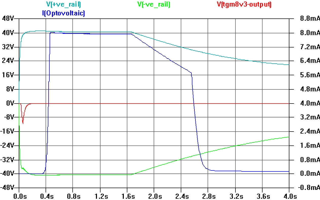

If you want to see how the TGM8 circuit works in sims, see the attached plot. You can see the power rails coming up - the light blue and light green lines (42V version). They reach peak voltage after around 0.2s. After 100 mains cycles the power is off and the rails discharge with a long nearly-exponential decay.
The dark blue trace is the current flow through the optovoltaic that powers the solid state relay. With delayed turn-on provided by R36 + C20 it turns on around 0.47s.
The red trace is the output. Notice the turn-on spike (negative going) and how the solid state relay will keep the output disconnected until the output has settled. There is another 'blip' in the simulated output around 6 s later.
When the power turns off and the rails start to collapse the opto current declines too, also a kind of exponential decay. But then around 2.5s or so the +ve rail voltage drops too low for the breakdown voltage of the zener D5, and Q17 turns off. The opto current declines rapidly and cuts off the output.
I've never seen an implementation like this so I'm feeling like an inventor (just have to make sure it works!) 😀

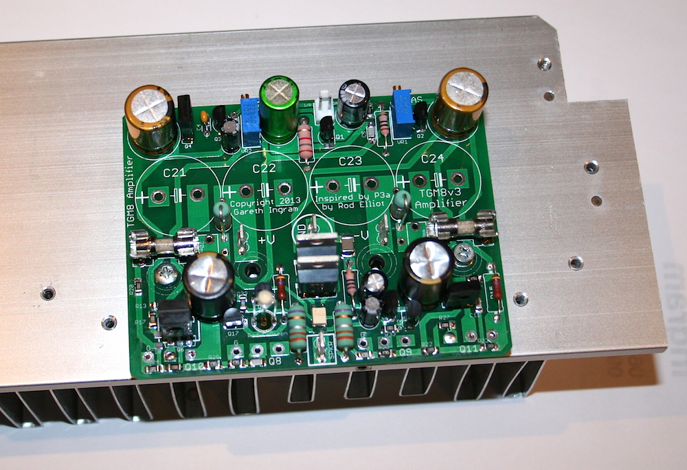

More progress. I've completed assembly as far as having the power BJTs mounted on the heatsink. Not installed are the big rail caps or the MOSFETs. It's a tight layout, some of the parts will be very hard to remove if I blow them up...
I found a cap to use for C16, robbed off my TGM7. And for C15&18 I went with the over-sized caps as I couldn't find any alternatives in my junk box.
The LED is out of focus in these images because I installed it with the leads still long and the LED sitting up high above the board. This is temporary, it's to make it easier to remove it if later I want to move it off-board, say to the front panel.

he he he... patience now...well I have made some progress...
Yes, you have to build this board in a certain order. I completed my first board, leaving off the MOSFETs and C10, both are relatively easy to add later.
My bench supply goes to +/-20V and using this I powered it up fine. I then found another old supply and wired up the two supplies together to allow me to go to +/-41V and still with some overcurrent protection.
I found I could set dc-offset to a few mV with bias set to 19mV across the 0R33 resistors - it was stable for 15 minutes but the heatsink was still cool.
The voltage at Q1 emitter was -0.8V, a good match to simulation of -0.8V
The voltage at Q2 emitter was -5.6V, also a good match to simulation of -5.7V
The voltage at Q15 emitter was +1.3V, a bad match to simulation of +2.9V
On cycling the power I could see the LED flash red - as expected since it should start-up with the SS relay 'open' and then close after about half a second.
I found two issues:
1) the silk screen is wrong, 'offset' and 'bias' which were printed near VR2 and VR1 to make it easier to set it up are transposed. Dissapointing to make such a silly error.
2) the circuit design is wrong with regards the LED, preventing it glowing green when the SS relay is 'closed'. I missed it in the simulation because I used a regular LED in place of the Opto. The opto has a much smaller voltage drop - it's in the datasheet but I missed it. As a result, there isn't enough voltage to light up the green LED. I am exploring 3 possible options to fix this.
I found two issues:

1) I didn't even notice the silkscreen writing to be honest. Looking at the board now I see what you mean but I doubt anyone would really notice unless you pointed it out. An easy fix for MkII.
2) I can confirm mine flashes red momentarily on start up but never turns green. I was wondering why it isn't 'green', was going to enquire with you about that, suspecting a small error in the schematic.

Well more progress.
Compensation: I'm using 22pF for C5 lag, 330pF for C6, 22pF for C4, 4k7 for R7, 100pF for C11, nothing yet for C10.
There isn't an easy fix for the LED without surgery. It's an easy fix if I re-spin the pcb but I'm not sure it's worth it unless there are other things worth changing. There are two options i) Insert a resistor in series with the opto isolator so that there is a higher voltage at the emitter of Q15, sufficient for the green LED. Simple fix but would need surgery on the current pcb. OR ii) take the grounded side of R39 to a -ve voltage instead. Again, this requires a new pcb or you could remove R39 from the board and then run a fly-wire from the common cathode on the back of the pcb with a series through-hole 82k resistor to the -ve rail. It can be done and it would be out of sight but I don't like it - feels messy.
What I did was to take the LED off the board, figuring that it would be nice to mount it on the front panel as an indicator. I took a piece of dual-core wire and soldered it to the pcb where the LED normally goes and put the LED on the end of the wire - I used two-core wire and didn't connect the common cathode. Using a separate wire I connected the common cathode of the LED to the -ve power rail via an 82k resistor. This makes it work fine. Now you turn it on, get a flash of red and then green. It stays green whilst running.
I installed the MOSFETs. Not so easy because you need to ensure all 4 power devices will lie flat on the heatsink - I kind of botched it in there but I think there is a smart way to do this using a small jig (flat piece of material, holes to match the mounting holes and all the devices bolted through it and the pcb) in order to hold all the devices parallel before you solder them in. I strongly recommend you do that and don't do it by hand-eye coordination like I did.
On powering back up, the dc-offset had drifted by around -30mV. It took me a couple of minutes to realize I had forgotten to plug in the input connector which is where the signal ground finds it's way back to the power supply ground. After plugging in the connector the dc offset returned close to zero.
I soldered a short length of miniature coax to the input and put an RCA socket on the other end. I plugged in an RCA cable to allow me to feed signals to the amplifier.
Oscilloscope: I hooked up the scope to the output and grounded the input. I saw random noise on the output, I measured it at around 20mV p-p. I don't know if this is good or bad but this is on the bench with wires all over the place.
With no load I connected the input to the square wave output on the front of the scope (it's a 0.5V p-p 1kHz square wave with 50% duty cycle for calibrating scope probes) and observed a very clean square wave on the output. The output had an amplitude of around 15V p-p which is a gain of 30. Which is within 10% of what you'd calculate for the amplifier (and within the error margin of my rough measurement).
I then wired the output through an inductor to a speaker binder posts and then wired up an 7.8 Ohm dummy resistive load to the binding posts. I re-applied the square wave and immediately had to increase the current limit of the power supply. Square wave was clean, slight rounding of the corners with no ripple or overshoot (haven't tried adding capacitive load yet). Power supply was sourcing around 1/2 Amp per rail which is about right. I didn't run the square wave for long - nervous about causing some damage, nothing got hot.
I decided to try a real speaker, so I wired one up. When I turned on the power there was a small 'bump' from the speaker and the LED was red. I found -40V on the output (before the SS relay, which was doing it's job and cutting off the speaker from the dc at the output - it Works !). However, it means I've managed to blow up the amplifier somewhere. Nothing hot, no smoke and very little current draw.
I was so hoping to hear some music, but I think it's time to call it a night and find out what I've destroyed tomorrow. Not sure what I did wrong, I suspect I turned on the power asymmetrically, one rail before the other, but don't expect this would have caused damage.

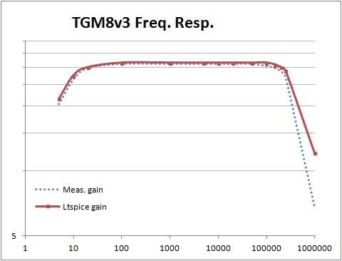

I hooked up a sine wave generator and 7.8R dummy load to measure the frequency response. My sine wave generator is refurbished, it has some nasty artifacts at the peaks of the waveform at high frequencies but otherwise does the job well. The measured results, compared with the simulated freq. response is attached.
At high frequencies I saw some signs of trouble - I could not take reliable data in the range 300kHz to 500kHz without exciting the amplifier into wanting to draw a lot of current. I don't know why this was - didn't have time today to chase it down. Could be a wiring related oscillation (wires all over the bench) or it could be design related. There was no sign of any high frequency oscillations riding as parasitics on the signal, the sine wave looked very clean and the zobel remained cool. I also don't know how well behaved the power supplies are, the +ve rail is a modern unit, the -ve rail was a unit recovered from the e-waste and looks old. They are both regulated. I fitted 100pF for C10 but this didn't make any noticeable difference.
I tried to heat up the dummy load but I didn't get past luke warm. I found the amplifier heatsink was getting pretty hot by the time I was running a continuous 1kHz sine wave at 20V p-p. The +ve rail was drawing on average 440mA. There were no signs of any bias instability. I measured the idle current whilst the amp was hot, it was around 23mV/0.33R, about 15% higher than cold. The drivers were only warm (although they got warmer when running at 100kHz+); the VAS remained cool.
I'm not comfortable with how hot the output power BJTs got, but I didn't find anything wrong otherwise.

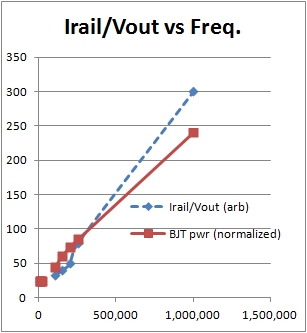

The heating that was bothering me before - I realized what it is. And it isn't good. I believe it's cross conduction. This is where the outputs don't turn off fast enough and so the overlap region where both the NPN and PNP devices are conducting is larger. It is worse with CFP output stages than double EF because you can't install a 'speed up capacitor' to suck the minority charge carriers out of the bases of the power devices.
I measured the current draw from the power supply as a function of frequency. Classic increase in current showing evidence of cross-conduction. I never ran the simulations at such high frequencies but running it this evening, I can see it there too. Attached is the measured and simulated cross-conduction current increasing with frequency. It's a very interesting thing - it appears to be greatly exacerbated by the FET gate capacitance. Even thought it occurs only at high frequencies it is far worse than the native P3a and I want to address it with some changes. I have some ideas!
Plot: the blue dashed line is the measured supply rail current (divided by output voltage to remove the effect of the falling frequency response). the red line is simulated output device power dissipation normalized to the blue line so they can be plotted on the same chart. What you see is the cross-conduction current (& BJT power dissipation) increasing (vertical axis) with frequency (horizontal axis).
