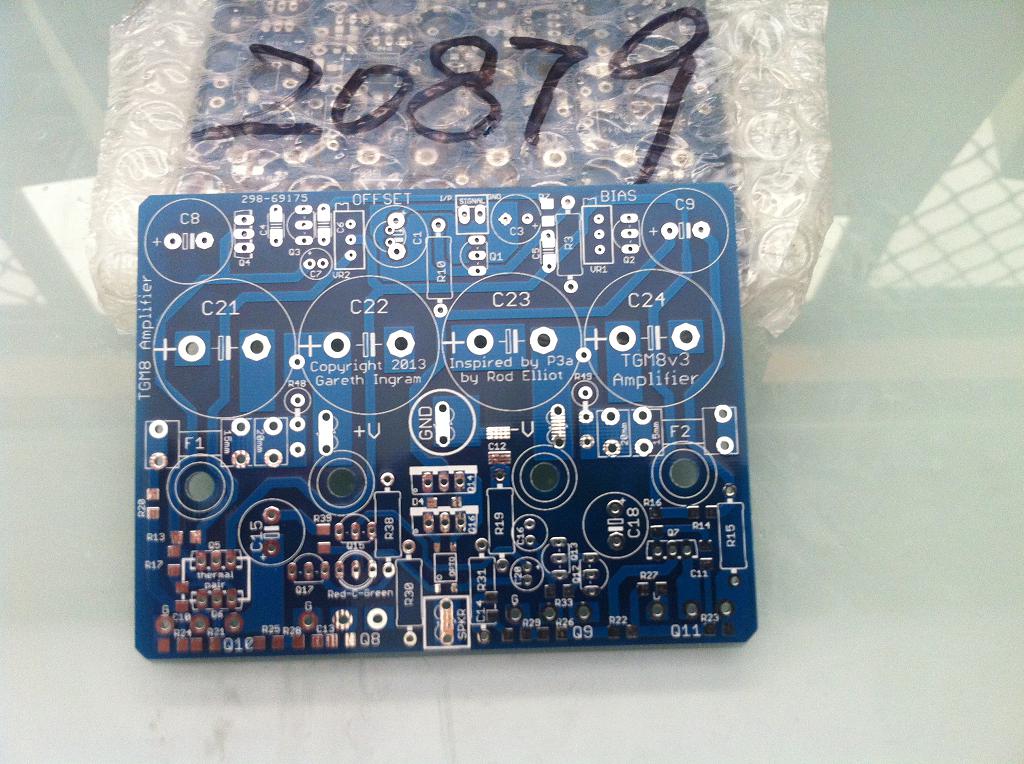

Look what came in the mail...
Fantastic !!!!
I feel nervous already - I hope we can get this working without major surgery.
Looking at the pcb reminds that the plan with the axial power resistors is to mount them half a centimetre or so above the board for better air circulation and to allow you more space to squeeze everything in!

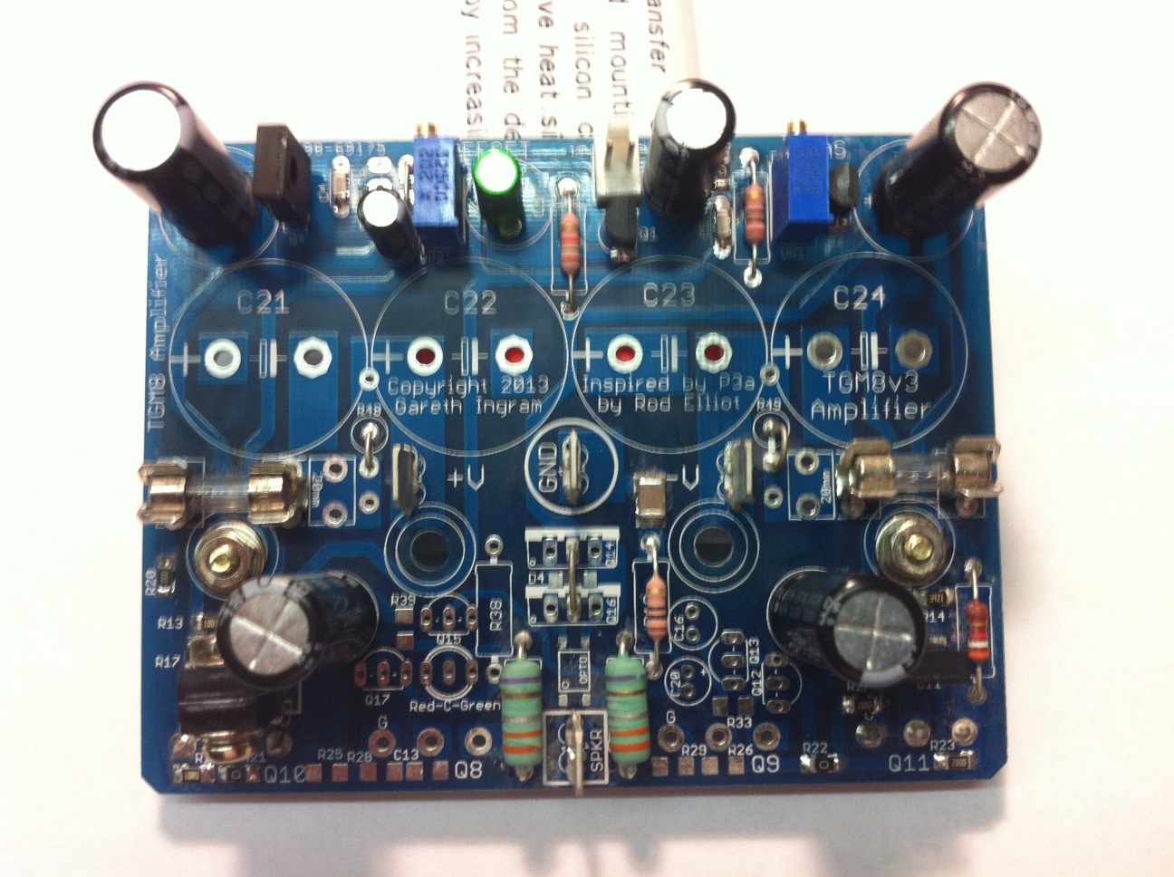

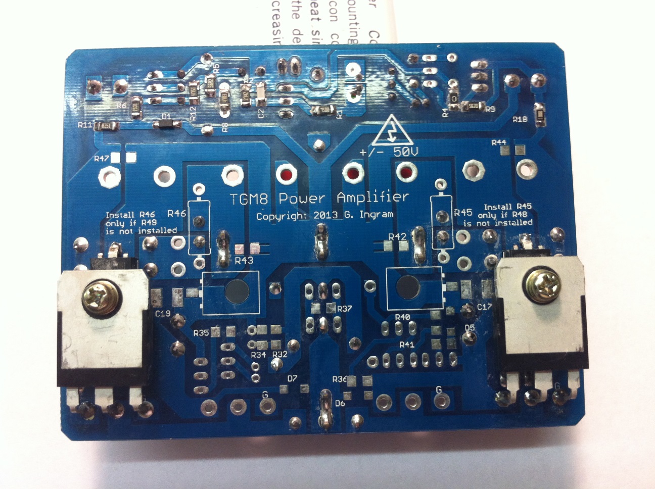

Okay... first board is stuffed.
Excuse the poor quality iPhone photos. The residue you see was left after I cleaned the board with PCB cleaner.... and I realised afterward the brush was contaminated with silicon grease. Grrrr :)
Anyhow it went together quite easily and the board didn't feel too cramped at all - nothing to worry about! I mounted the 1W resistors against the board and the 3W resistors with a ~1/4" air gap.

Hi Gareth
You say in post #179 that the driver compensation cap (C10) is optional. I assume then that C11 is also optional since it also appears to be a compensation cap on the complimentary PNP driver.
Can I assume both C10 & C11 (driver compensationare optional?
Is there anyone in the Brisbane area with a sine wave generator and 'scope who would be interested in taking some measurements with the board?
Looking at the P3a Rod finds that a comp cap is only needed on the one driver and only on the 'negative' side of the amplifier. I've heard this said before about the CFP output. I included one on the other driver in case I need it. Rod didn't use base stoppers either - they help ensure that the signal going into the base doesn't see a negative resistance which can happen depending on load conditions.
Have you applied power ? - it should be possible to see if it's completely mucked up or not by looking for sensible current flows and sensible voltages. Setting the idle current may be tricky, if it's too high it will get hot fast, if too low the CFPs tend to switch on an off harshly.
Safest way to start is to put some resistors in the power lines to the amp, or use the infamous 'bulb' or a current limited bench supply. You could take out the fuses, and 'wire wrap' a 100R power resistor in place of each one - at low idle current they shouldn't bake too quickly and measuring the voltage drop across them gives you an indication of the current flow in each power rail.
Thanks Gareth, I took a guess and omitted both C10 and C11 caps and I think that was the right decision for the time being.
I haven't applied power yet (only just had time to finish off the board). I probably won't another chance to spend time in the workshop until the weekend.
In terms I quiescent current, I was just planning to dial in around 50mV across the output collectors. But the Vbe offset - any suggestions?
50mA sounds reasonable as a starting point - check what the P3A is set to.
Without C10 you may have oscillations - so tread carefully, look for unstable idle current (it will be sensitive to Vbe adjustments and hard to get it to stay stable), the zobel resistor might get hot, or the power devices might get hot. I think it's best to install C10, you can come back later and fine tune if you think a lower value than P3A will be better.
