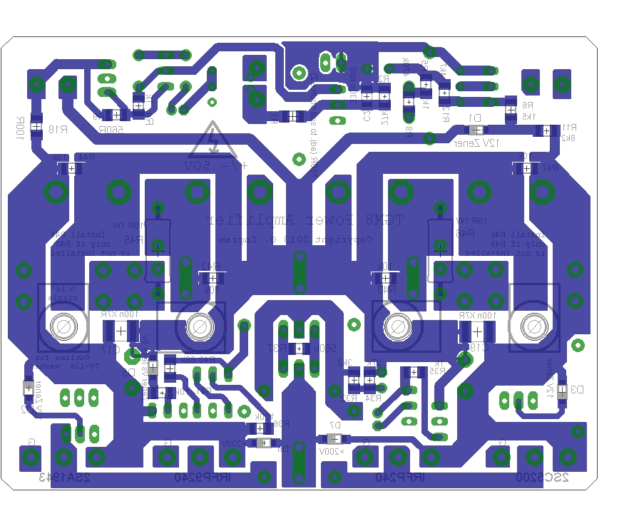

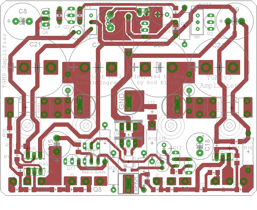

I find the two layer layout too difficult to follow/read.
If you could post layout with top turned off and another with bottom turned off, I may have time to work my way through it.
Attached...
I'm quite happy to see better parts recommendations - so the WIMA is good with me (if they fit).

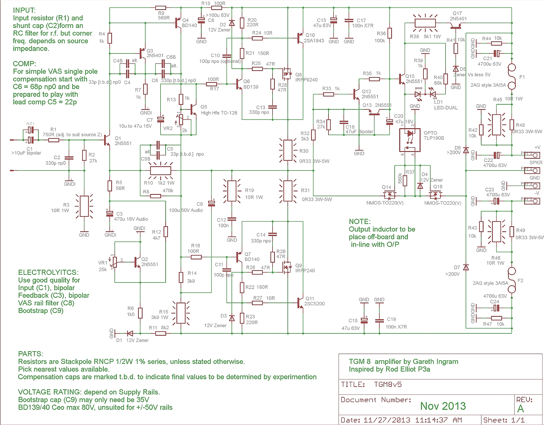

I noticed the resistor values for the feedback network were wrong, they were P3a values which has an LTP whereas this amplifier with current feedback should be low impedance. I've updated the schematic and BOM.
Christian, you might consider that even the low power version with a feedback resistor of 1.2k would be better if it had 1.5k for higher gain. And I suggest you seek out a better quality feedback resistor than I just put into the BOM. It needs only be 1W.

I'm ready to arrange for a batch of pcb's to get shipped to Ranchu32 and I will likely order a batch for myself (10 boards in a batch if I remember).
Any desire for further error checking - Andrew ?

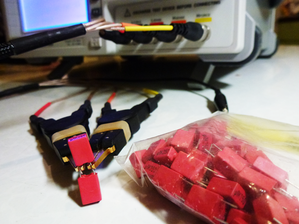

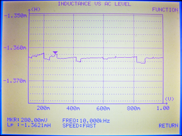

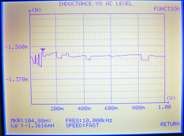

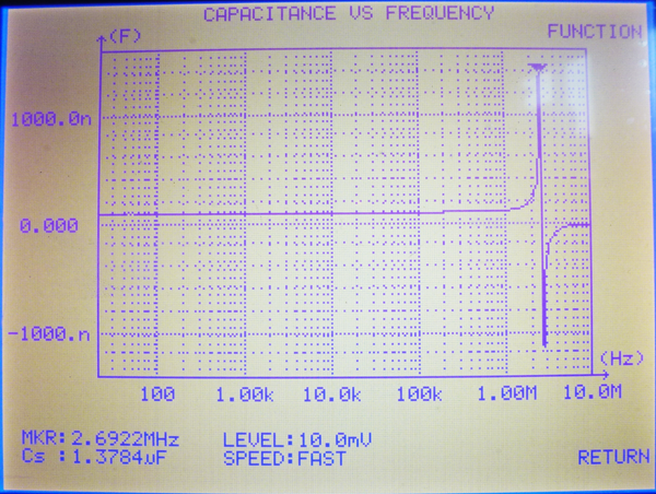

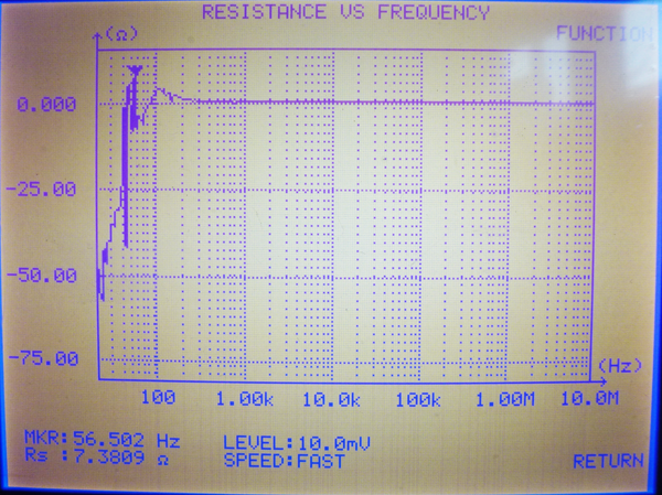

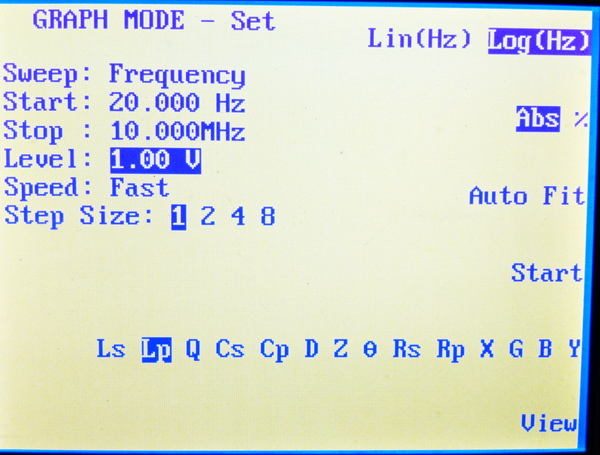

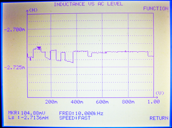

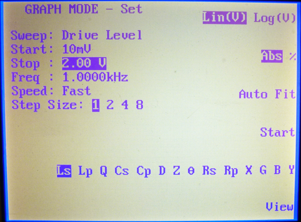

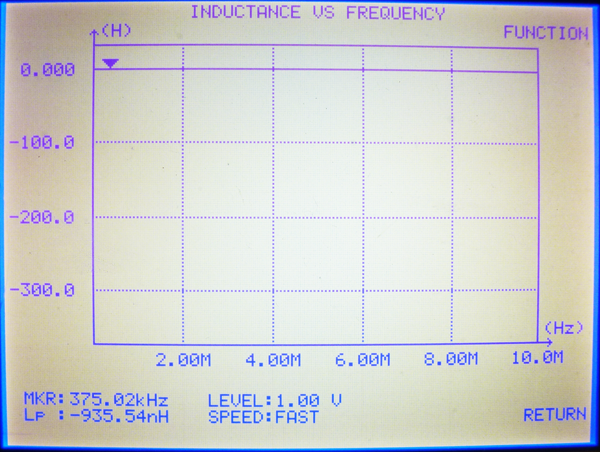

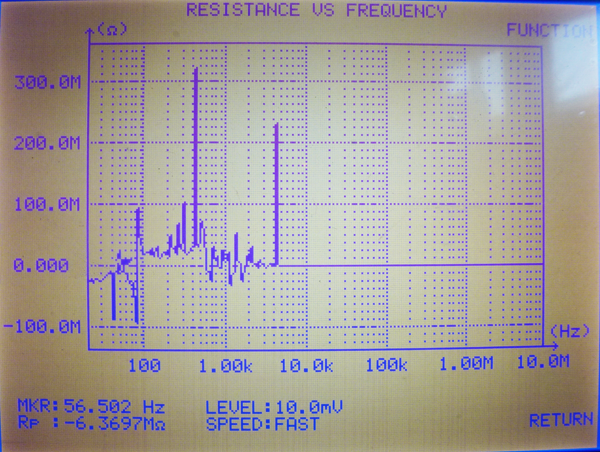

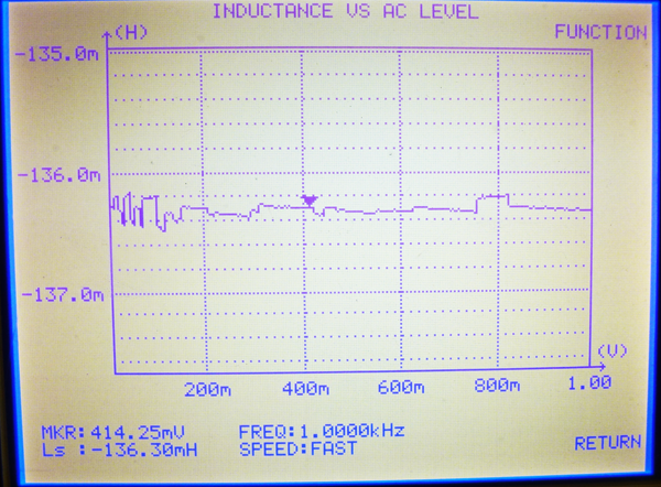

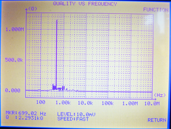

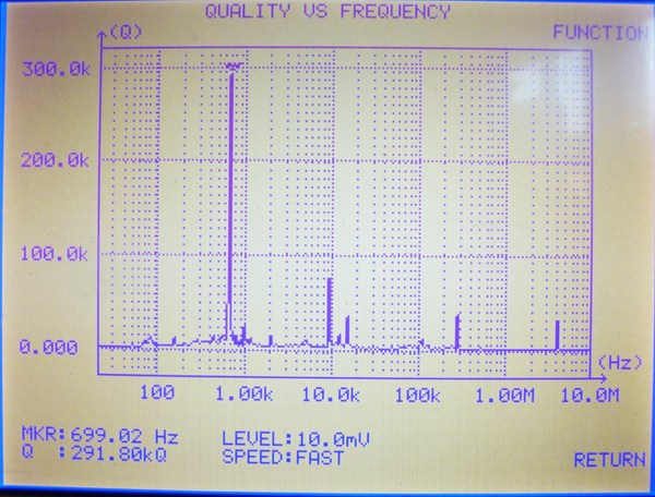

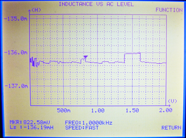

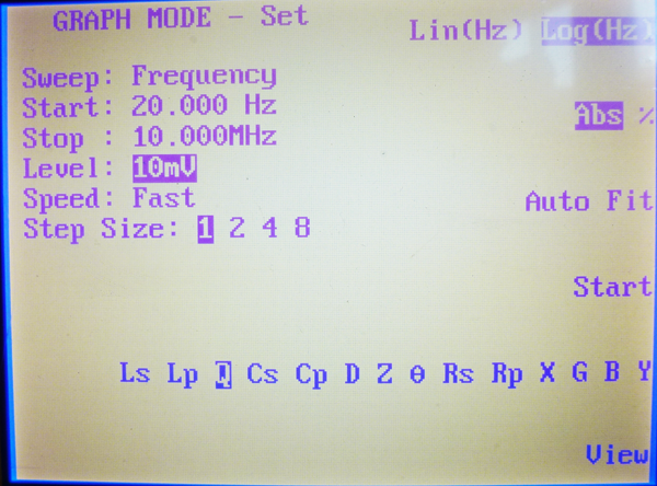

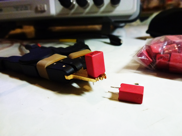

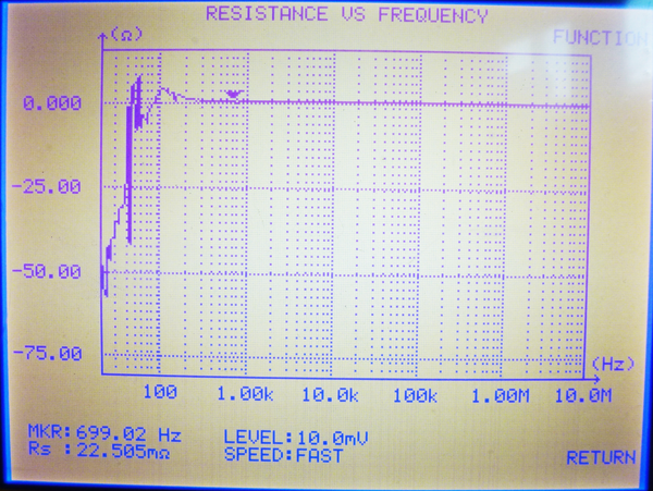

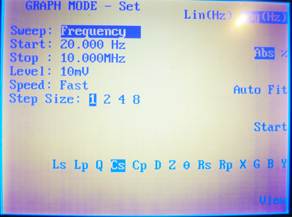

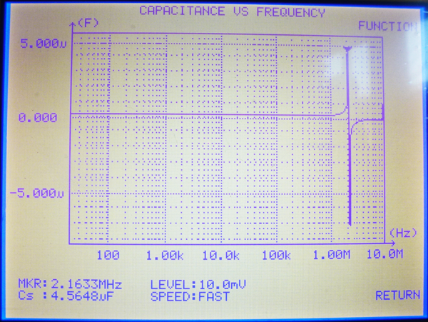

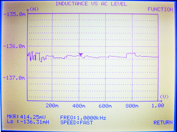

Hi, Gareth, R.Cruz,

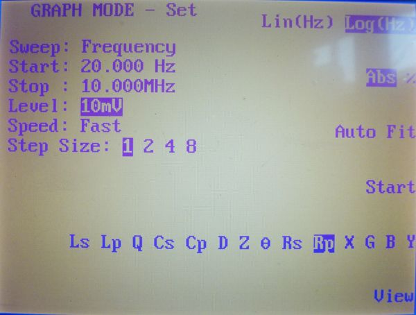

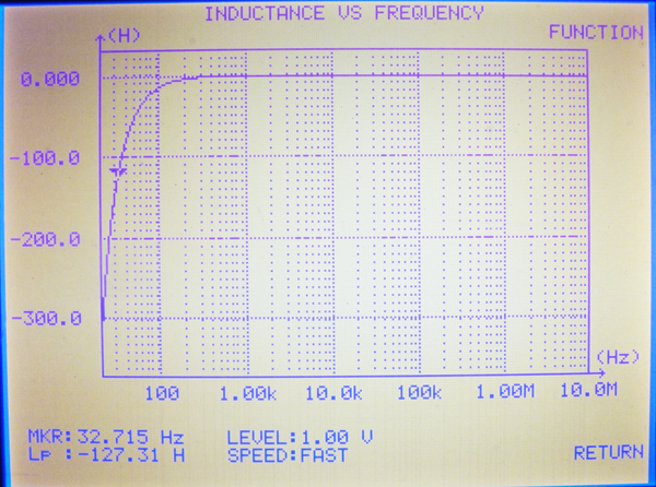

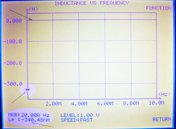

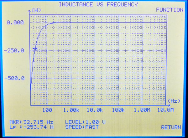

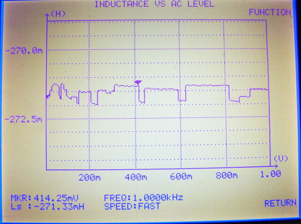

Maybe a little off topic but I did some quick measurements in my job lab and here are the very quick results. If You just try to each image save as - You can read the short info of each image meaning. As You can see from images with a little trial measurements it is possible to select really very good ''TANDEM CAPs'' values needed with almost eliminating or at list halving the most disturbing parasitic effects which do the most unexplainable effects to the circuits when they're used, thus designers and diyers to blame theirs circuits of a strange oscillations, phase shifts-bumps etc...
The graphs are captured with my phone and the images are with limited resolution but they're also all SELF EXPLAINABLE and were measured with fast sweeps from 20Hz to 10 MHz just to quick get a basic info of the DUT, it is also possible to get 10x higher resolution with higher bandwidths but it consumes a lot of time and is intend only for serious job analyses.
Almost all the same parasitic are present also in resistors, coils, PCB Traces, active semis BJTs Fets measured in live circuits from pin to pin incl. PCB traces within + - 10V, etc....
When observing this way a whole new picture of a particular Element, circuit, is arising and explain a lot of new why and how... to proceed.
With my best regards,
09_CAP_L_SERIALL_AC_TEST-4_2x50nF-MKP'2-(250V)--(DUAL--AC--INDUCTANCE-CANCELING-CONFIG)'.png425.4 KB · Views: 155
08_CAP_L_SERIALL_AC_TEST-3_2x50nF-MKP'2-(250V)--(DUAL--AC--INDUCTANCE-CANCELING-CONFIG)'.png419.6 KB · Views: 159
07_CAP_L_SERIALL_AC_TEST-2_2x50nF-MKP'2-(250V)--(DUAL--AC--INDUCTANCE-CANCELING-CONFIG)'.png435.9 KB · Views: 169
06_CAP_L_SERIALL_AC_TEST-1_CAP-1x100nF-MKP'2-(250V)''(SINGLE_CAP)''.png444 KB · Views: 165
04_CAP_L_PARALELL_AC_TEST-2x50nF-MKP'2-(250V)--(DUAL--AC--INDUCTANCE-CANCELING-CONFIG)'.png441.4 KB · Views: 798
03_CAP_L_PARALELL_AC_TEST_1x100nF-MKP'2-(250V)--''(SINGLE_CAP)''.png465.6 KB · Views: 835
01_GOOD-MATCHED-2_2x50nF-MKP'2-(250V)--(DUAL--AC--INDUCTANCE-CANCELING-CONFIG)'.png423.3 KB · Views: 918
CAP_C_SERIAL_AC_TEST-2x50nF-MKP'2-(250V)--(DUAL--AC--INDUCTANCE-CANCELING-CONFIG)'.png480.7 KB · Views: 170
CAP_C_SERIAL_AC_TEST-1x100nF-MKP'2-(250V)--''(SINGLE_CAP)''.png469.6 KB · Views: 175
It seems these "builds" are able to mimic some "supercap" characteristics at a 1/10 price 🙂
Ricardo,
From my own experience I can tell You that this bar can be rise even
from 1/10 price to 1/100 price and even much higher .....
BTW if just mouse is pointed over each image
there is arising the explanation of it's meaning very useful...
A.

Thanks Andreas. I'm not sure I have understood all the data presented - you have a nice piece of equipment there, I'd love to get my final pcb checked out on that thing for parasitics. Anyhow, It looks like you have shown a fair bit of parasitic inductance which gets shunted by the capacitance at higher frequenices. Your data is also a good reminder that capacitors have a resonant behaviour up at high frequencies, in this case several MHz. When looking for caps for compensation these 'features' are important and they become most important when the open loop unity gain frequency gets up past 1MHz and the stability of the circuit becomes dominated by parasitics that are often neglected in simulations. If using the 1206 npo ceramic caps, the parasitics are reduced and the resonant frequency is pushed up a lot higher.
PCB - I would still appreciate extra error checking if anybody has the time. The circuit 'works' in spice but the schematic is then manually transcribed into Eagle. If there are errors in the posted Eagle schematic then we have a problem - I have checked it over but an extra pair of eyes is welcome here. The Eagle layout software will ensure that the pcb layout matches with the schematic (it has built in Electrical Rule Check) and it will also flag a lot of common errors (it has built in Design Rule Check) but it's not perfect and it doesn't know about parasitics, or about separation between traces for high voltages or about trace width for high currents. So I'd be grateful for any input on these potential errors in the design.
To get boards in time for the holiday break I believe I need to order them very soon so I'm proposing a deadline of end of the month - meaning I should place my order this Sunday.
