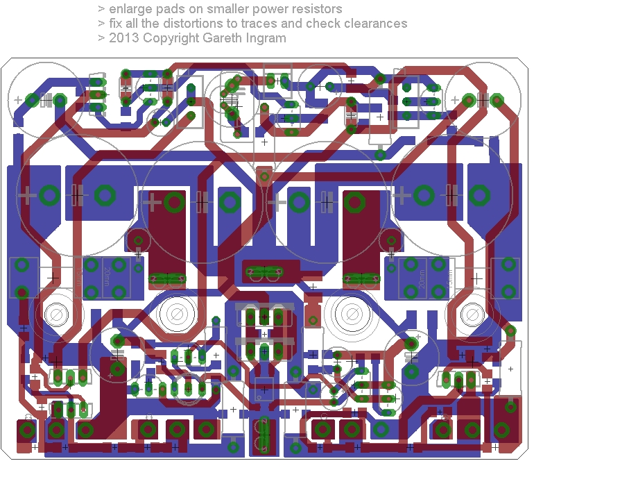

I'm taking a look at the BOM and have a couple of questions...
Input cap pin pitch is 5mm and it's proving problematic finding an electro that size without ridiculously high voltage for this position. I can spec a bipolar Nichicon ES 10u 16V that has pin pitch and can diameter of 2mm and 5mm, respectively. If you want to keep the option for film caps (5mm pitch) then I suggest you lay down 3 pads spaced 2.5mm each to accommodate either option properly.
Are the zeners TH or 1206? Hard to tell from the diagram.

I just did a quick look on Digikey website (.com), I found 20 choices of bipolar caps that are 10mm diameter with 5mm pin spacing. Anyhow, it's a good suggestion to generate a footprint that allows for some different options for pin-spacing.
All diodes (except the LED) are SOD123 which is a fairly standard and common surface mount package size.
I can generate a parts list directly from Eagle. I've uploaded a preliminary list as an example - let me know if this is helpful as I can add more detail within Eagle so that it is relatively easy to generate an up to date listing.
You mean like this ? 😎

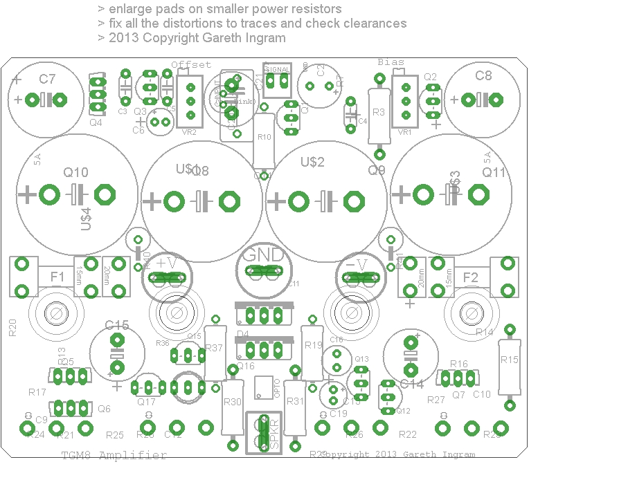

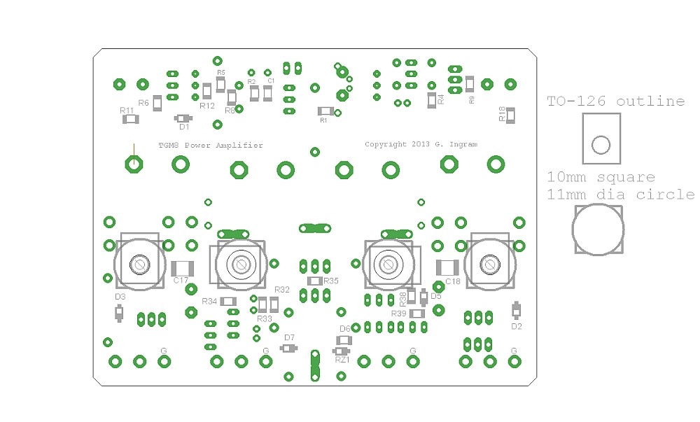

Hello Bigun,

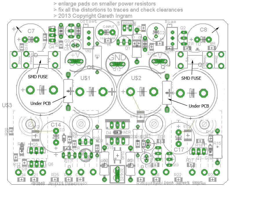

I do quick reposition of the Caps. fuses, resistors as I made a suggestion in my post #98.
Pls. see att. img.
I'd keep the OP TRs Decouple caps as near the TRs pins as possible.
With my best regards
A.
PS. The SMD Fuse + Holder in att. PDF

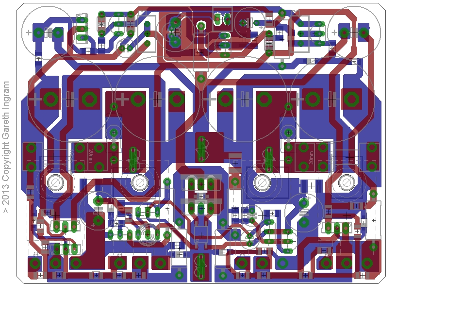

The attached shows you where the traces are so you can get a better idea of why I didn't move things as you suggested - I did look at some of the options but there were other compromises needed. Please look for errors.
Mounting holes - the outer ones are sized so that the screws will secure the pcb to the heatsink through the power device, the inner ones are to clear the screws and will not contribute to holding the pcb down. This is what I did in TGM7 to allow more tolerance on drilling holes in the heatsink but as this board is larger perhaps all 4 holes should be small enough to allow the screws to hold the pcb down ?
Anyhow, I'm starting to get the feeling that this layout needs to reach a conclusion - I'd started out with the intention that it would be finalized this week in order to contain the scope of work and Friday is fast approaching...

Perhaps decide on a few details such as size of mounting holes, whether the big caps are to be snap-in type etc.
Hello Gareth,
You made very elegant and really versatile PCB Board, nothing more to add.
Maybe to put on-top on each OP TR same 10 mm x 10 mm x 2 mm kind of plastic pads to little distant the PCB from direct contact to the OP TRs to reject heat transfer onto PCB and still provide enough physical contact to firmly secure board via M3 screws from the top true the PCB board with an additional support of the 10 mm x 1mm round metal pad on-top of the outers screw PCB fixings to firmly fix the PCB on top of OP Trs.
Congratulations on Yours Great will to make this little AMP a new bright light to all Diyers.
With my best regards,
A

Hi Smiley, a small picture of what you describe might be helpful but I think I know what you are suggesting. These plastic pads sounds like a great idea - do you know where to buy them from ? I was thinking that TO-126 transistors are so cheap now that we just cut off their legs and use them as washers !!!
Do you think it's OK if all 4 mounting holes are used to hold the pcb, it will require accurate drilling of the heatsink which is harder for some people - or if I just have 2 of the mounting holes for pcb and the other two just clearance to fit a screwdriver through ?

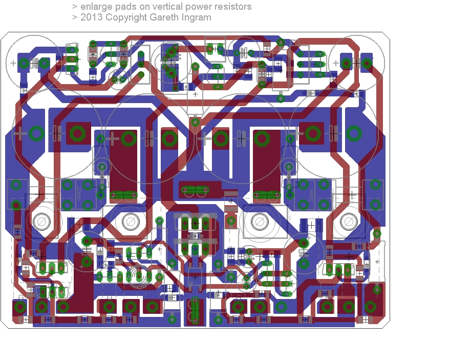

Here's an image of the underside of the board. Still a few items to clean up. But I've placed some outlines to show you how much room there is around the mounting holes underneath. It's a very crowded board and you don't get a lot of space for washers to be in contact with the underside of the board before they interfere with through-hole parts and SMT parts.
Edit: uploaded revised layout with option of installing the resistors from the CRC filter under the board as Smiley suggested.
This sounds far more interesting than amplifiers !I did a laser measurement on one of my amps with the tool we use for vibration analyses of the racing engines and gearboxes and ...

Thanks for passing that along. Only thing is, the learning curve can be pretty steep and now that I am familiar with Eagle I'm reluctant to change. But it's OK - we're limited by heatsink size here too so a bigger board would only be of interest if making a stereo version.
I turned the Quickfit connectors around 90 degrees as this may be easier to access when they are close to the big cap.
Keep looking for issues.

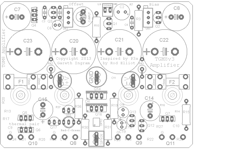

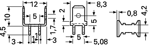

Hello Gareth,
For the TO126 stile PCB board spacers I fully agree wit Yours latest reposition as the space is really tight. The spacers should be cut from any kind of material at hand to survive some 150 deg C temp.
Can You add another GND Quickfit connector beside the current one or a Dual one should be used also for SPKR GND connect This way both SPKR OP wires should be twisted from the PCB and routed this way to the OP connector on the chassis.
The PCB is become really neat and compact.
Congrats,
Best Regards,
A.

Hi Andreas,
Well I like the idea of keeping the wiring simple as you suggest. But where to fit the extra quickfit ? if you look there isn't an obvious place since it must not short front to backside of pcb and there is very little space to fit your fingers in there to push on and pull off the connectors - note how the connectors are crowded by the large capacitors and the solid state relay TO-220 devices. Anyhow - open to suggestions as to how to do this. Otherwise it isn't too bad, we just have to connect two earth wires to the one quick fit connector for gnd.
Hi Gareth,
I mean at the same place as this one, it'll use almost same space, later with a little help of a small pliers or with little tinner fingers could be managed.
