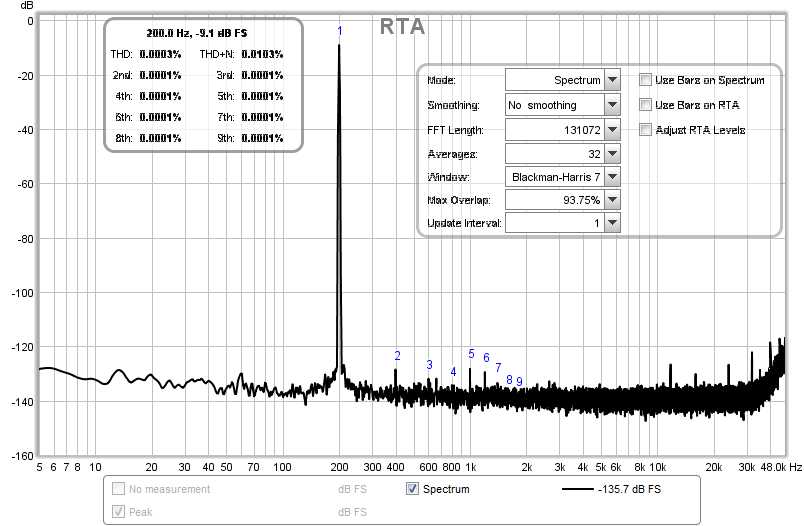

Looks good all the way through. Can't get measurements like that with D10 and D12 in place though :/ Without that, the interface loses a bit of its benefit. This is using a 2i2 for audio interface.
Which measurement software are you using?

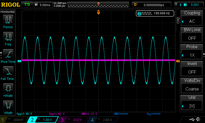

Its not the diodes at the input that have been removed but the diodes before U8 (the output line driver) that are discussed these are sized to clip just slightly above the meter range causing not quite ideal use of the dynamic range on some soundcards.
I suggest that instead of removing D10/12, D11 / D12 be replaced by a string of 1N4148 diodes the number of is suitably selected to put the protection limit closer to the full scale voltage of the soundcard YOU are using.
Note: I got better THD (flatter increase) vs frequency by using THAT parts for the line recievers/drivers) (see posts a few pages back)
Did you mean replace D11 / D13?
Hm, 200mv has noise floor at -142db, 2v at -125db, 20v at -129db and 200v at -143db... wish this was more consistent :/

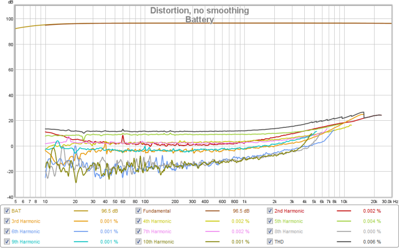

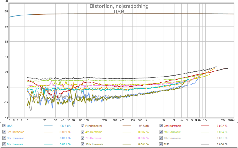

Here are some amp measurements before I static shocked my 2i2 to death :/ This is an emotiva Mini-X A-100 at -3db from max output, about 26 WPC @ 8 ohms
USB vs Battery power

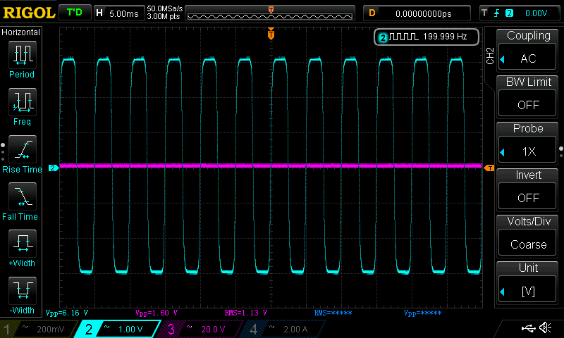

I added two more diodes inline with D11 and D13 and put D10 and D12 back. This causes the output signal to get clipped around 12Vpp
