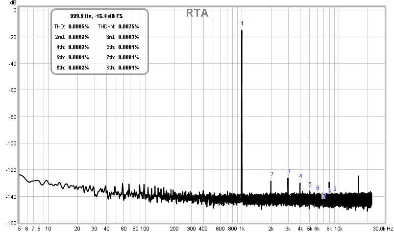

Able to measure down to 0.0005% THD on the 200mv setting now with the D10 and D12 diodes disconnected. A loopback of my soundcard can manage 0.0003% THD.
That looks very good NYT. Have you looked at sines at lower and higher frequencies?

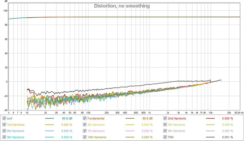

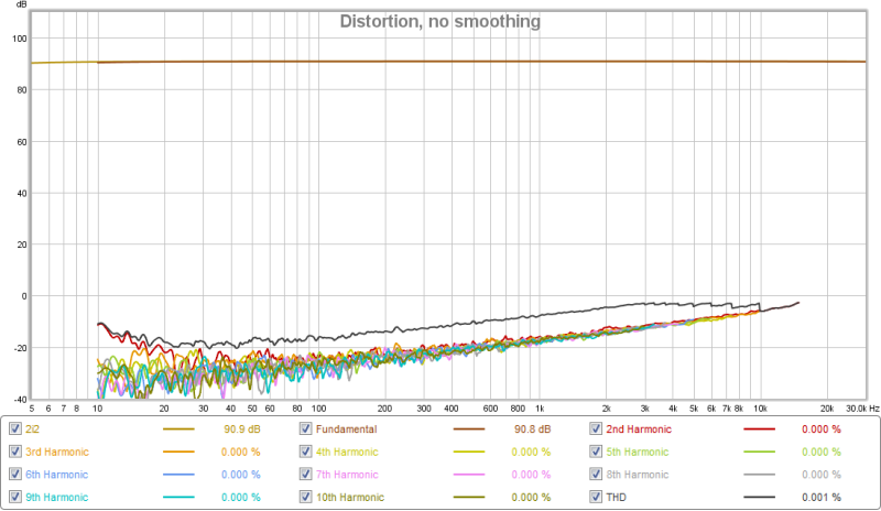

Looks good all the way through. Can't get measurements like that with D10 and D12 in place though :/ Without that, the interface loses a bit of its benefit. This is using a 2i2 for audio interface.
SC loop
SC + IF loop
