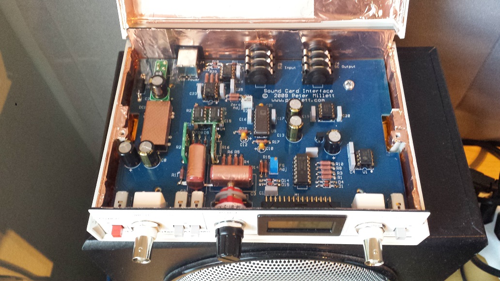

Here are a couple of internal pictures ... should clean off that flux residue...
Hi Tazz your results are fantastic, can you please elaborate on the mods you've made and the pictures that you've posted; like what have you soldered onto the underside of the 6mm sockets etc. I've recently finished one of these interfaces and I'd like to get it performing as well as yours.

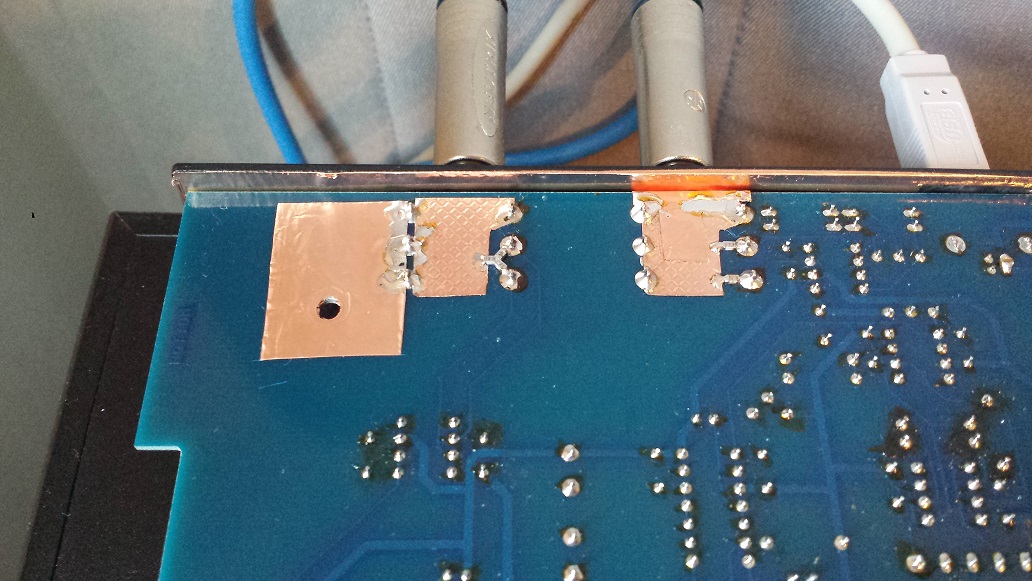

Those are RFI filter capactiors as described in the apnotes for the THAT parts. The green PCB's are back to back depletion mode mosfets for the input protection and an additional common mode filter for the isolated converter.

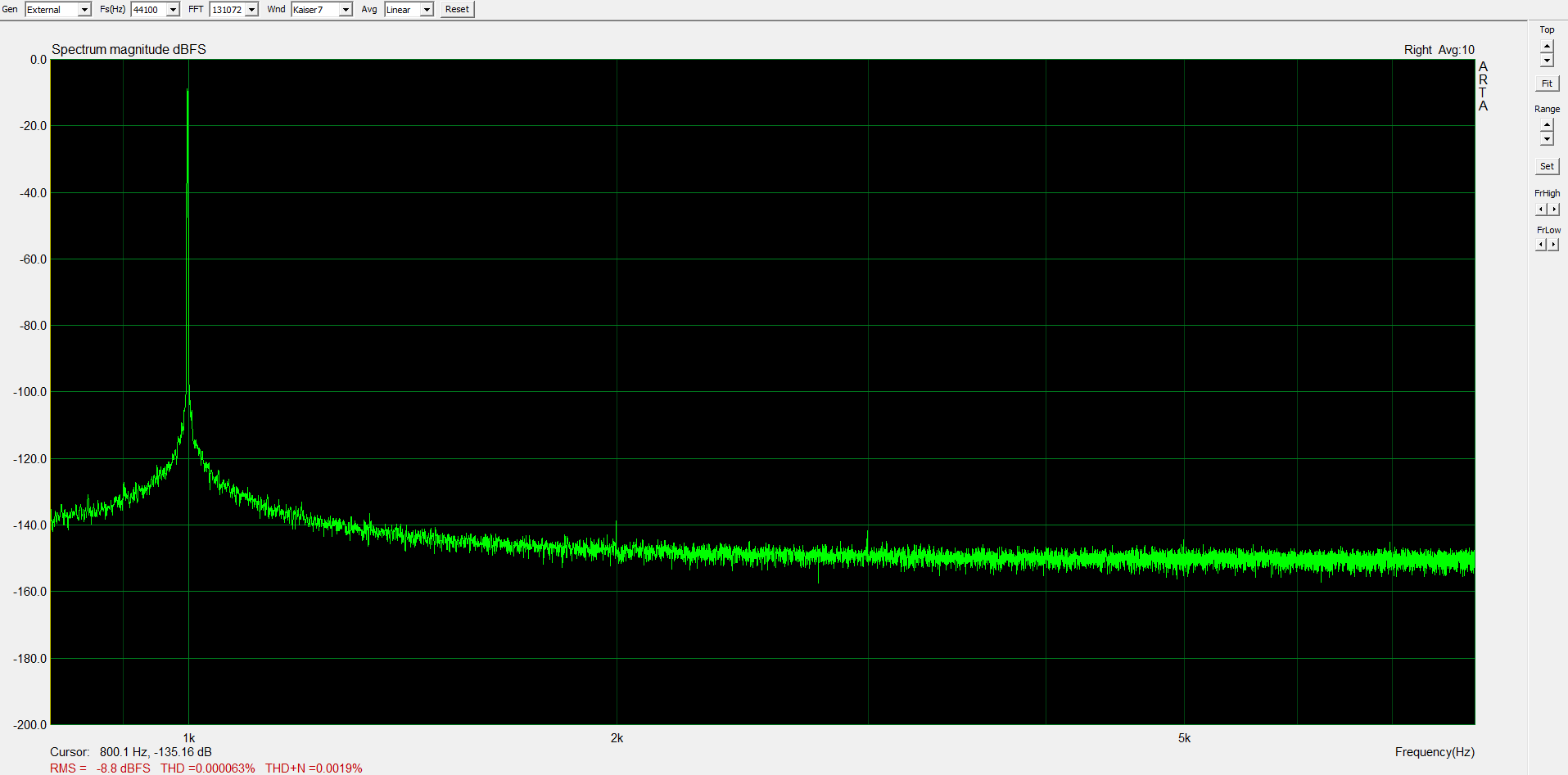

When using this interface with a juli@ soundcard the 1Vrms out @ FS really puts a limit on the usable dynamic range. So I removed D10/D12 so I can get a larger output voltage swing before clipping. (I will probobly increase the diode stack to still get protection just at a level more suitable for the juli@)

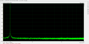

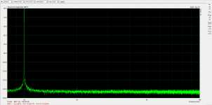

Unfortunately this puts the meter out of range but look at the performence I get when measuring one "mikevich" <0.00001% 1kHz oscillators of ebay
This is with the soundcard interface at the 200mV setting and the oscillator set for about 0.6V
