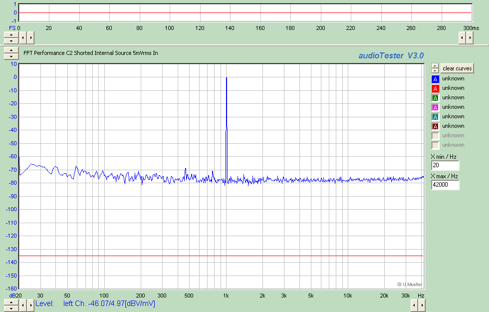

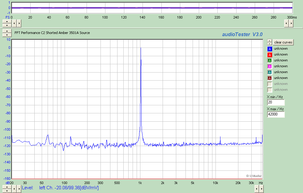

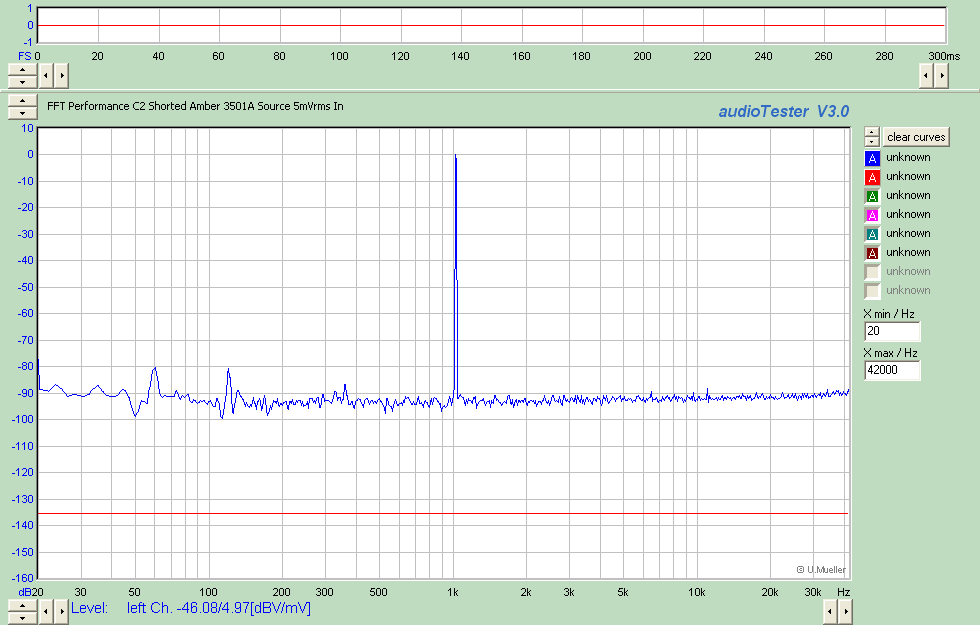

If you are having hum problems with the sound card interface and you are not deliberately using the input as a differential amplifier try shorting out C2. The acquisition below was done at 100mVrms from an Amber 3501A with output in ground mode, and the input floating. Levels are calibrated.
Note DC on the ground will cause meter errors since it responds to DC.
My interface is fully shielded, I have installed clamp on ferrites on the audio cable and usb power cable, grounded the shaft of the range selector, and selected the best driver and receiver chips for lowest thd. I have also installed 0.1uF ceramic caps in selected locations. I have determined that the charger that came with my Samsung Galaxy S III smart phone is significantly quieter than the usb power even with the ferrites so I have ordered one of those.
The clamp on ferrites greatly reduced the common mode conducted noise from the PC. Previously the meter and indeed external meters indicated at least 7mV of noise which made setting low output levels impossible. (I'm designing a bunch of phono stages) The ferrites fixed this - now the meter indicates 00.0mV when no signal is input even on the 200mV range.
Based on the way the circuit is designed I recommend using floating mode only on the 200mV range with generator in ground mode, I still get much better results on all other ranges with the input grounded and the generator floating. Note that I can now get good results on higher ranges even with low amplitude input signals - that was not the case before.
Edit: I've added two graphs with the system acquiring 5mVrms input signals. And yes the Amber 3501 is extremely quiet - overall substantially better than the generator in my set up. (Note the consistent level of hum spectra relative to the noise floor at both 100mV and 5mV with the 3501A as the source.)
The sound card is an M-Audio 24192 running at 96k and 24 bits.
