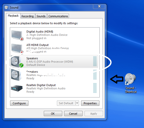

If I understand you correctly, you want to use the EMU 1212soundcard also as the "default" soundcard for your windows (so you here sound like windows starting up and new email sound).
This is not recommended, because Windows WILL interfere with your measurements, and you cannot use ASIO drivers (Windows need Wave drivers, ASIO is not supported).
I use the integrated soundcard of my PC for Windows sounds, and use the EMU 1212 exclusively for measurements.
I have attached 2 sessions for WAVE configuration. With these you should be able to hear windows sounds (take the 48Khz version).See also the sreenshot for the Windows 7 sound config.
It is recommended you load the ASIO config (files in previous post) if you want to do serious measurements.

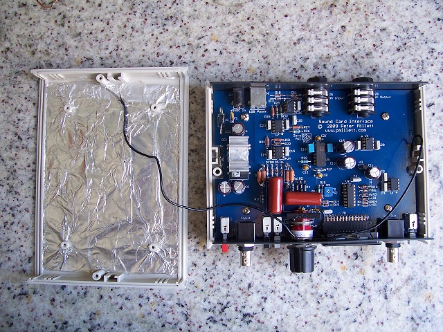

I was disappointed that the self stick mu metal sheet I got at a surplus store wasn't sticking very well. Corners had lifted, so I had to break out the aluminum duct tape which has some kind of freakishly strong adhesive on it to hold the mu metal down. I didn't want an shorts on the board!
Then, after I plugged it in, it wasn't working and investigation revealed that I'd put one of the opamps in backwards! Ack! That chip is now ruined since it still doesn't work after putting it in the right way (and it gets warm....). So, yet another order from Mouser.... sigh.

OK, what in the heck kind of adhesive sticks to these plastic boxes that Pete spec'd for this interface? I'm getting really pissed off that nothing seems to stick to the plastic on the inside. Even my super sticky aluminum foil REAL duct tape didn't stick. Do I have to epoxy the mu metal to the box? This is ridiculous.
I think I used rubber cement to attach the mu-metal.
The edges keep curling up on me. I'm worried that it will short something on the board. Thanks for the tip.
I had similar problems with the foil I used - I finally ended up covering the problem areas with electrician's tape - no problems at all in the several years since I built it.
