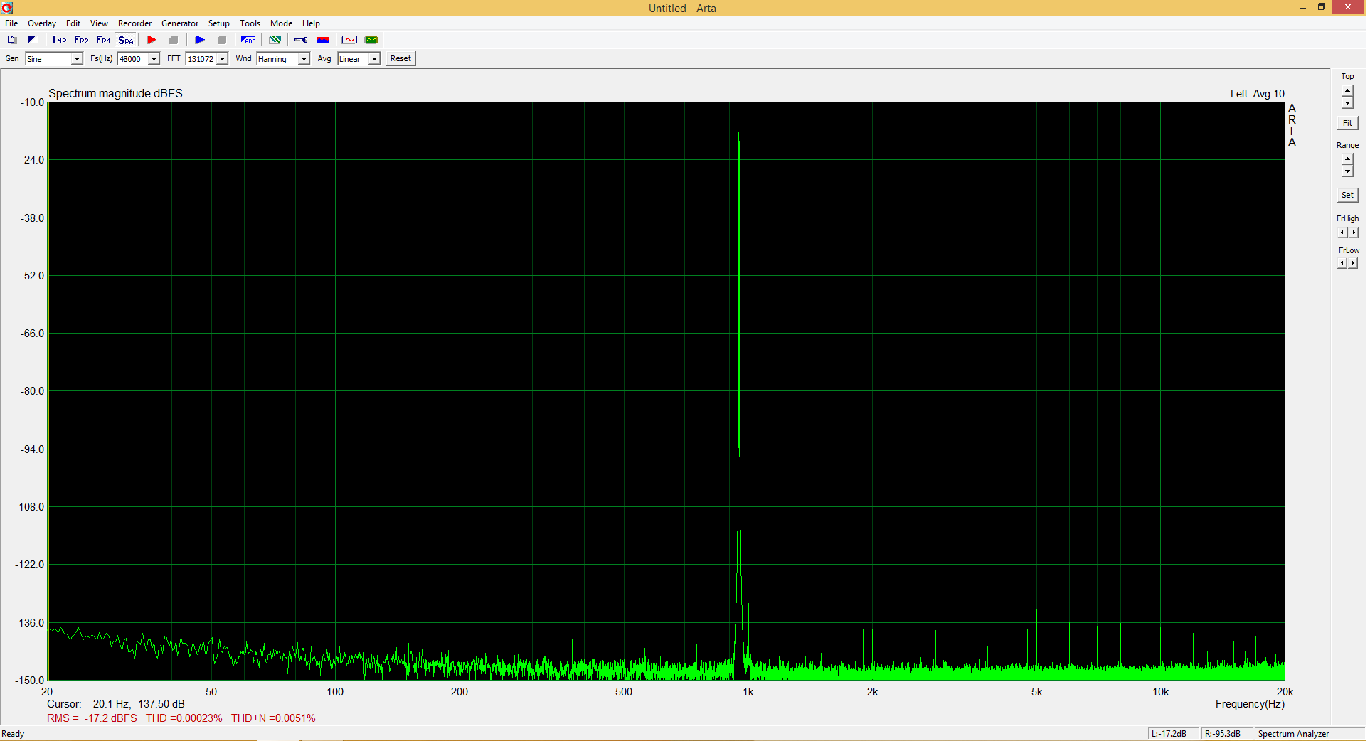

I recently completed a soundcard interface, thats been on the slow burner.
Works nicely but I see an annoying 1KHz (and harmonics) when not enabling any signal through arta, weird, seems to come from the soundcard.
Measuring THD on a 950Hz fundamentals gives very nice results (Juli@ soundcard + some changes to the interface)
See attached THD plots.
Some additional filtering + shielding and it achieves 0.00018% ( ~115db) at 1kHz @ 2VRMS .. with some averaging
