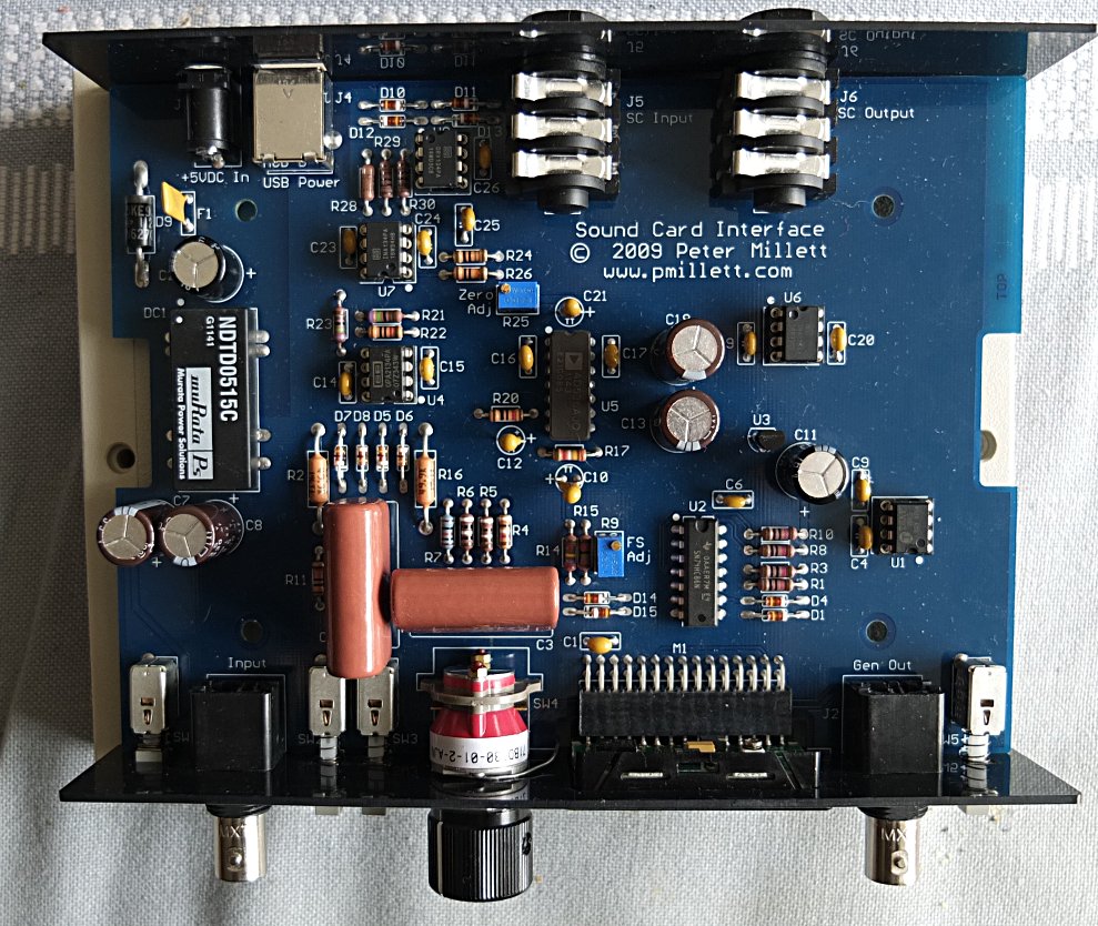

Could you post an picture of the inside of your box?
Andrew
Hi, AndrewL,

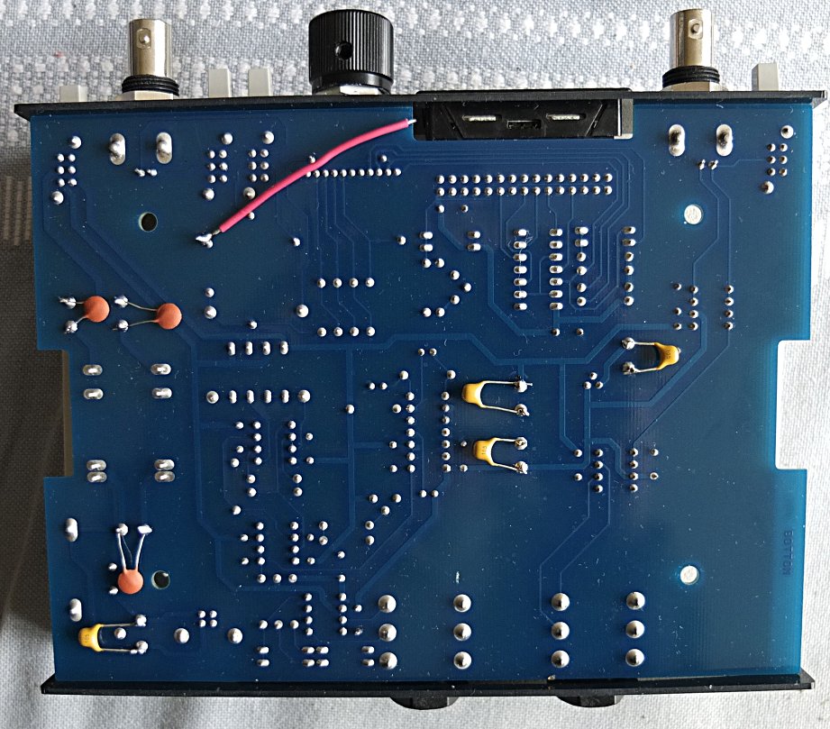

Here are the pictures of assembled PCB.

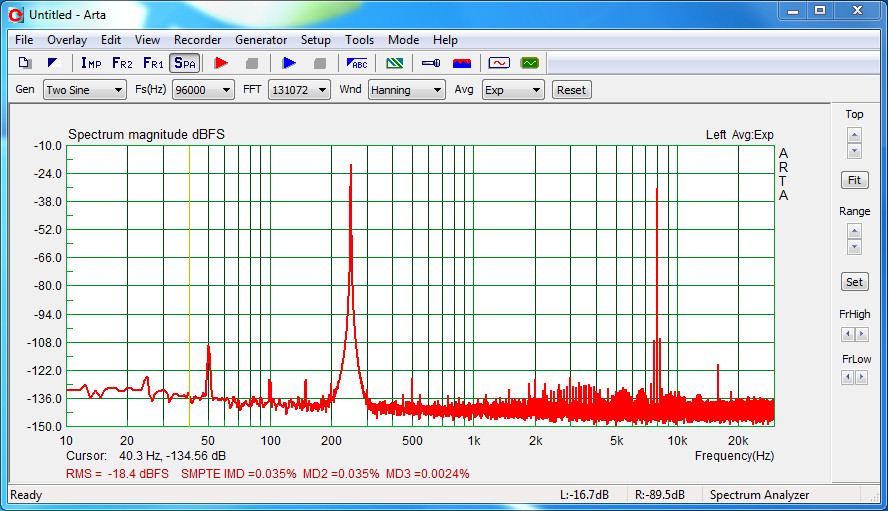

Additionally, as many forum members suggested, I grounded shaft of rotary switch, 50 Hz noise went down by -4dB. Closest ground point is R11 (see red wire on photo).
Test in loopback mode (input and output connected together on 33K resistor terminals), 1.9V sound card out, 96KHz, attached.

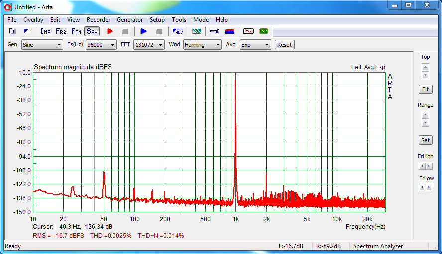

I would like to add a not to ESI Juli users. Although sound card itself is very good, its seems it works better (in this particular application) in 96KHz, not 192 KHz mode. I don't know why, I suspect high-frequency noise picked up by SCI.

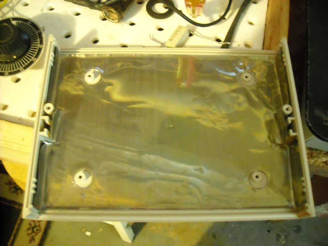

So next step will be to building foil shield inside plastic box.

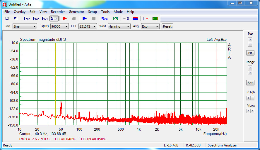

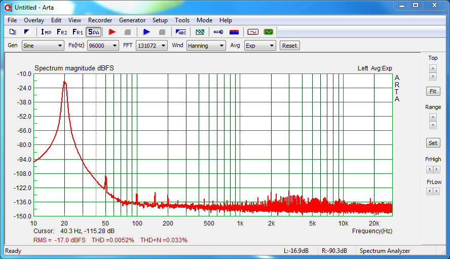

At a glance, precision looks very good (0.0025% THD, 0.014% THD + N @ 1.9V/1KHz), but it is actually not so. Due to the noise (or some other reasons), it is not possible to precisely measure THD at small signal level, e.g. 20mV, and precision at 20 KHz limited to 0.05%.
I'm attaching tests in loopback mode, 20Hz - 1KHz - 20KHz, 1.9V output from ESI Juli (balanced connection), 96KHz sampling rate.

A better choice for shielding is Mu Metal (I used UltraPerm) instead of Al foil. Al foil will work as an electrostatic shield, but not a magnetic one. Ultraperm is available from the usual source (ebay) at a reasonable cost.
Just be careful with Mu Metal shield. You don't want to bend it or the stress reduces the permeability from the annealed state. It cuts with a heavy pair of scissors.

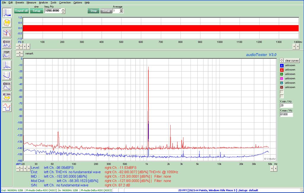

They have done so for a long time, if you use a calibrated reference to establish absolute levels.
What's the noise floor of your setup? I haven't found a soundcard that was better than the stuff I'm trying to measure. Even the external soundcards typically available aren't all that clean. Most are something like -110dB or so at best in a loop back test. I would think good instrumentation should be much lower than that.
Depends on bin size and frequency, but the PCI card I have (nothing exotic) gives me -155 to -160dB relative to full scale. Knock off 8dB or so for ref to 1V.
Of course, you can put a low noise amp in front as well. for measurement of very delicate signals.

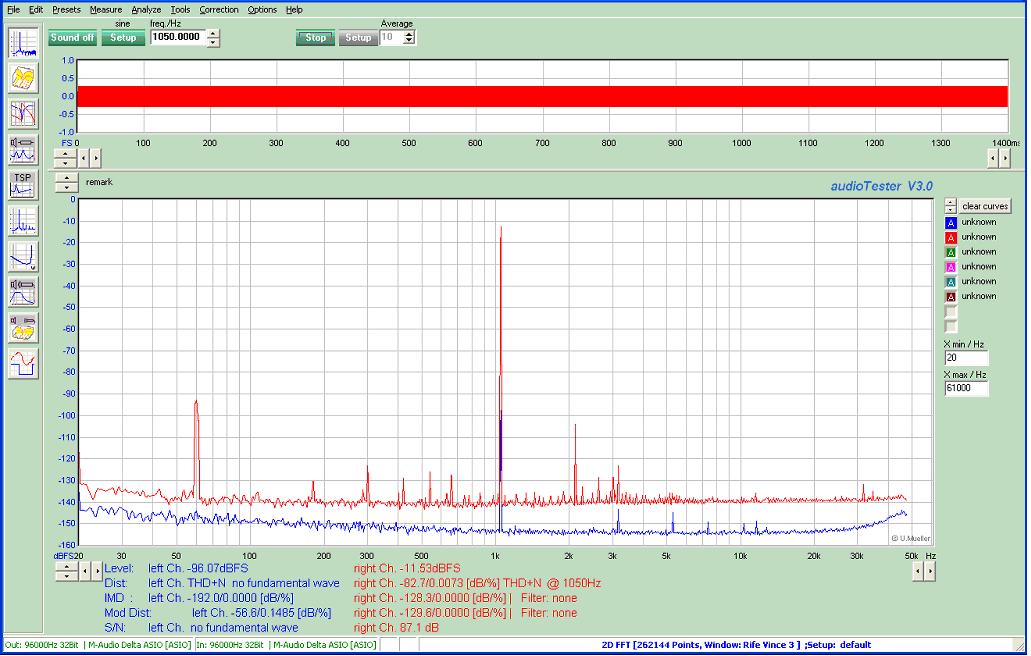

I actually got 20dB reduction in Float mode vs 16dB in Gnd Mode. But this is all relative, and not with any real cal standard so take it with a grain of salt.
You don't even have to install the Mu Metal to see the effect, I just cut the sheet in half and made a sandwich with the interface and I saw over 10dB reduction.
