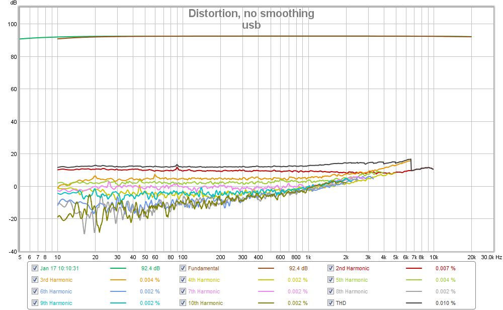

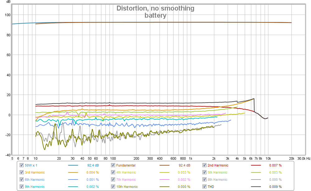

got the bulbs in.. did some tests of an amp... battery powered vs USB powered.. makes a decent difference.
attachment.php
attachment.php

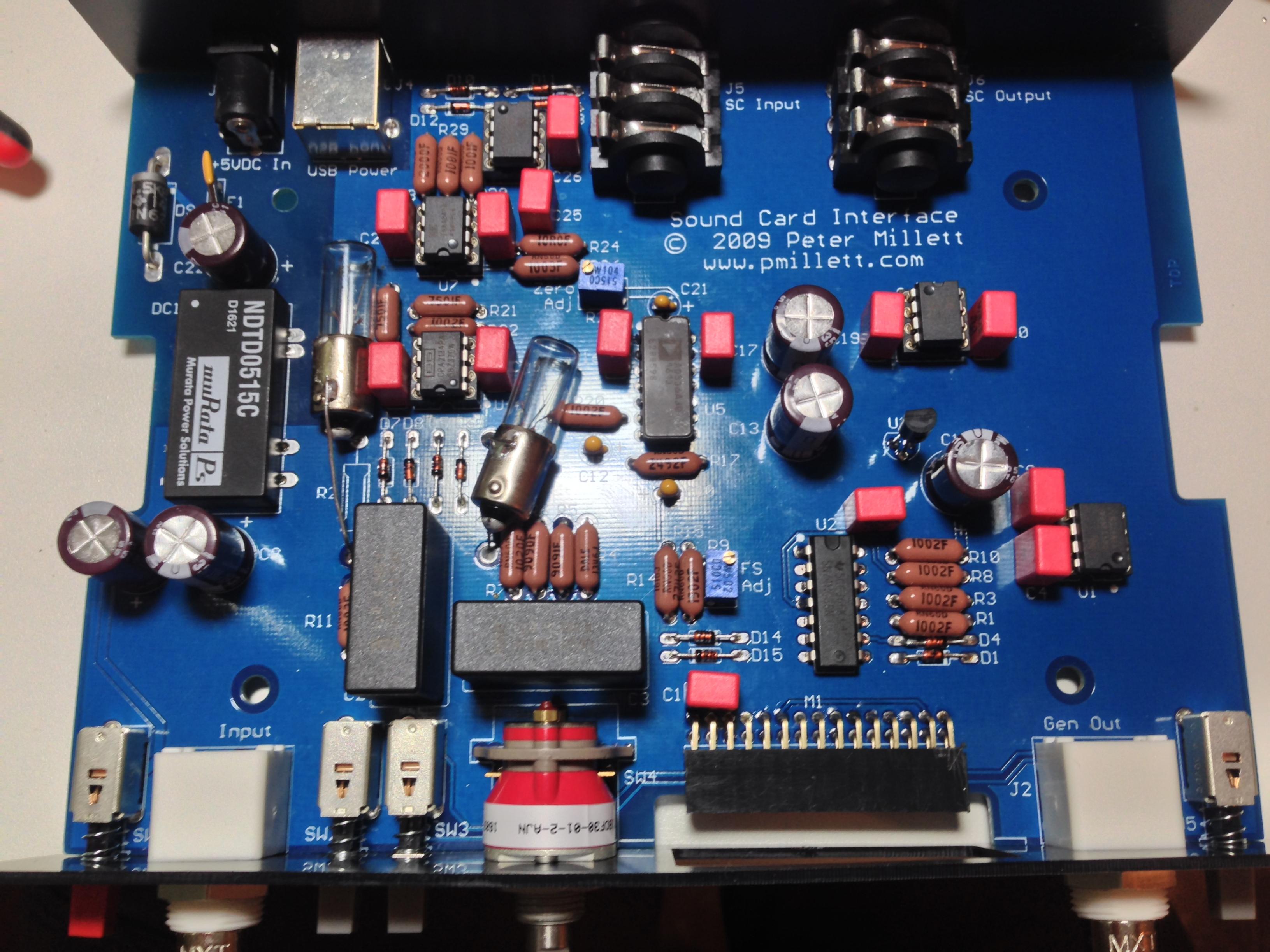

Hi Tazz your results are fantastic, can you please elaborate on the mods you've made and the pictures that you've posted; like what have you soldered onto the underside of the 6mm sockets etc. I've recently finished one of these interfaces and I'd like to get it performing as well as yours.
I think what's soldered on the back of the pcb, under the 6mm sockets, is shielding. But I'm not sure where the RFI filter capacitors he mentions are located. I'm trying to get a handle on everyone's enhancements for Pete's SCI before I start mine.😉
There's some RF energy eminating from the INPUT of the DC-DC converter -- I posted on this 2 years ago -- you can eliminate it by using a small value choke on the input lead -- if you're using Pete's board you could replace the fuse with a choke.
Can you cut the trace between F1 and D9 and solder a small 12uH choke on the bottom side of the board to replace the cut trace?
I ordered this inductor from Mouser.
