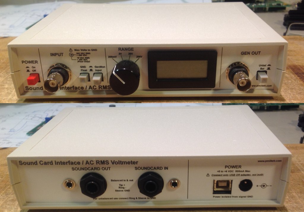

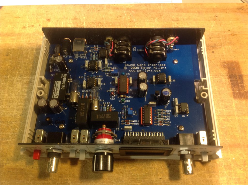

An other interface is born. A few simple mods/changes were done: DC input choke to remove DC/DC converter RF, light bulb protection at the input instead of the 2W resistors (see this thread for details) and added 1/8 stereo jacks in parallel of the 1/4 jack, for better compatibility with my own sound card. Thanks again Mr Millet for this great design!

I suggest that instead of removing D10/12, D11 / D12 be replaced by a string of 1N4148 diodes the number of is suitably selected to put the protection limit closer to the full scale voltage of the soundcard YOU are using.
Note: I got better THD (flatter increase) vs frequency by using THAT parts for the line recievers/drivers) (see posts a few pages back)

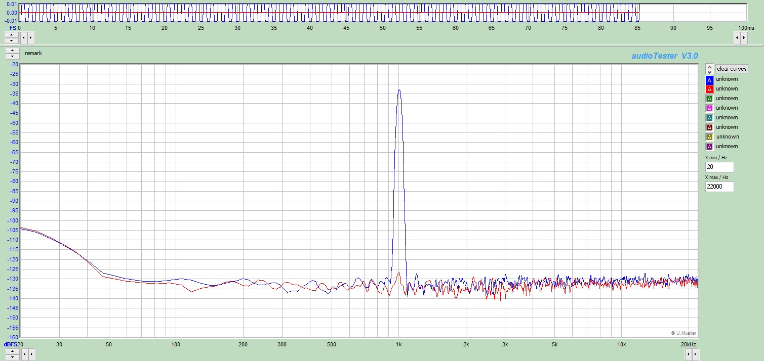

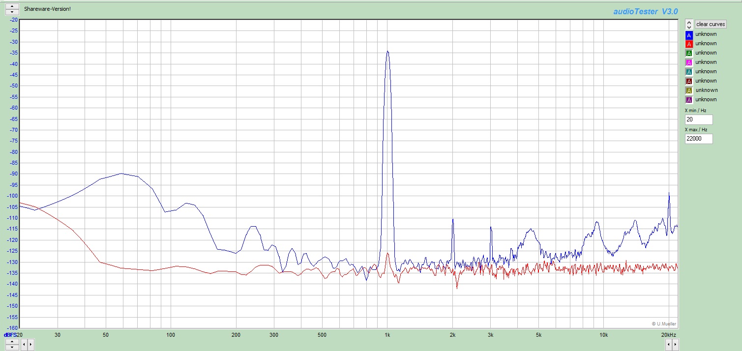

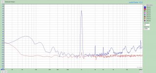

Be warned I am a complete newbie at this. I'm looking for feedback on my first couple of measurements... Do the results look valid?
The first is a Petes interface hooked to a Focusrite scarlet 2i2. The 1k tone is generated by the computer using audio tester. Voltage out was 4.4vac
The second is a 1k tone generated by my phone playing through an old hafler amp. Same test set up same voltage.
I hope to get more comfortable with using the computer to do measurements so I can properly set up my newest 4D32 tube amps.
Thanks,
Evan

Trobbins, I wish I could answer intelligently. I really don’t know. I’m having a hard time getting my head around this whole thing. It sems simple on the surface ... inject a signal ... look at the output... but as I actually try to get meaningful information out of the computer I am running into a lot of things I don’t understand.
Not related to your question. When I use the gen mon feature on Pete’s interface I can output plenty of voltage from the computer. This is how I generated the first plot. But when I try to use the Soundcard to drive the amp I’m testing I can only get about 300mv
I need to ponder and play with this quite a bit more

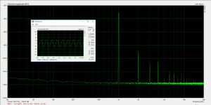

Soundcard interface setup with Juli@ soundcard and ARTA
I recently completed my Soundcard Interface. It went together perfectly and it was a pleasure assembling it! I earthed the selector switch shaft and lined the box with mu-metal both as suggested earlier in this thread.
It appears to work fine testing with a signal generator and DMM. I don't have an oscilloscope at the moment so I can't be absolutely sure.
I'm trying to use the Soundcard Interface with a Juli@ sound card and evaluating ARTA for simple amplifier frequency response and THD/spectra measurements.
Not understanding how to use ARTA could well be my problem here.

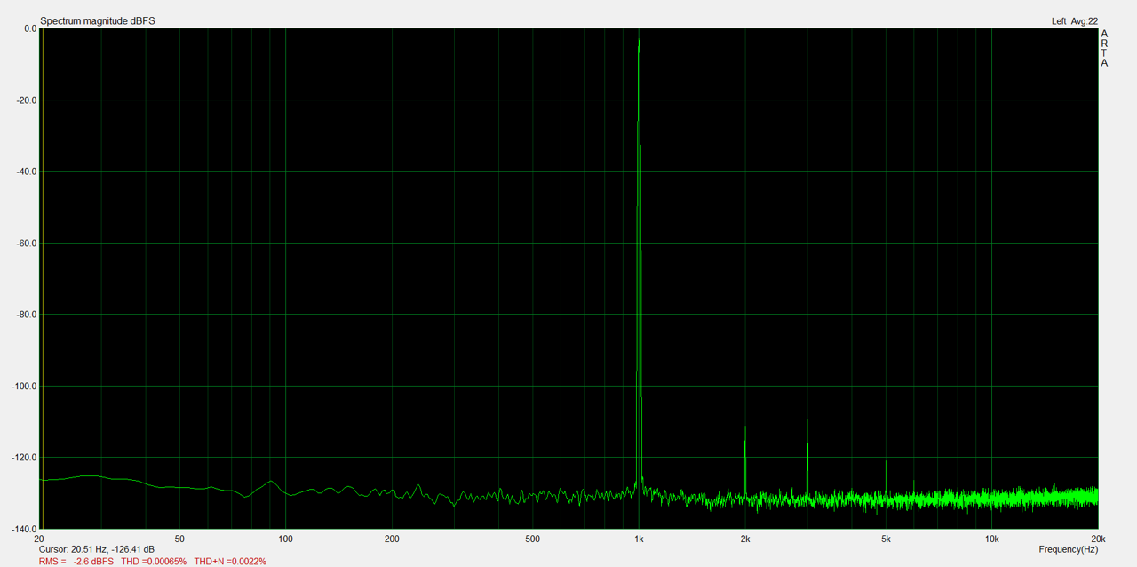

I've attached the loopback spectrum.
Looks good and can be improved significantly by reducing the level.

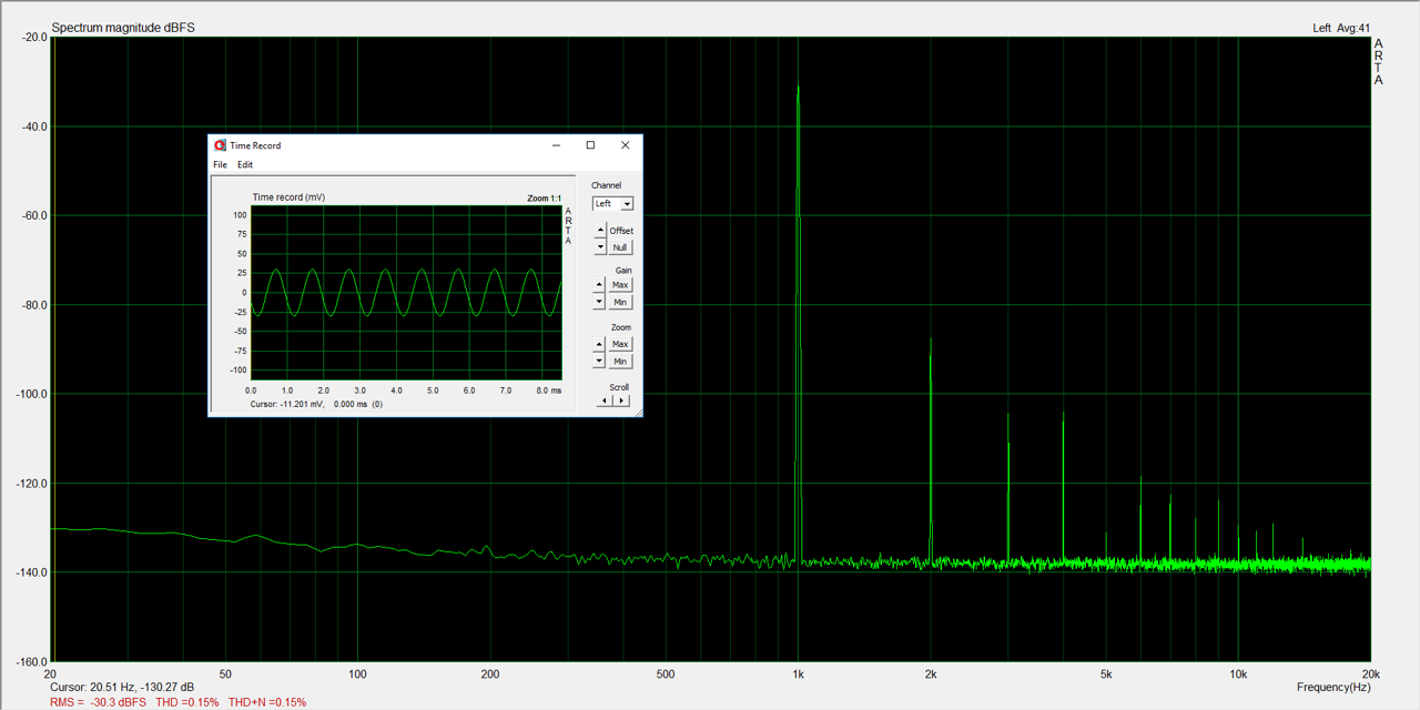

If I connect-up the soundcard with the right channel as reference and select "Gen Mon" to link the sound card output to the soundcard input I should be able to measure the contribution of the soundcard interface as many others have done on this thread.
I had to reduce the input level to -12dB avoid clipping in the Time Record window. I've attached the result and as you can see it's relatively poor with THD of 0.1% and THD+N of 0.11%. At least the background noise is down to 140dB and there's no peak at mains frequency.
Any suggestions as to what I'm doing wrong here?
Thanks.
Looks very typical for Juli https://www.diyaudio.com/forums/equ...ensation-measurement-setup-4.html#post5584954
Look at the card diagram. The monitoring feature feeds incoming data from inputs to output mixer, not the other way round.

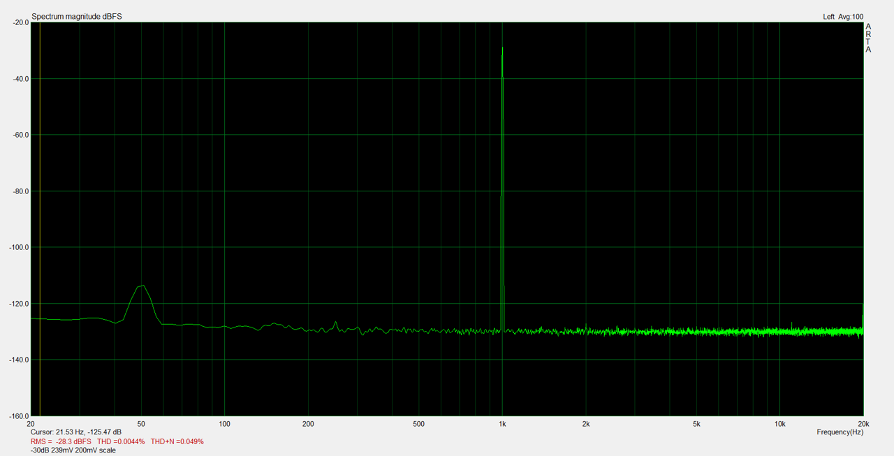

Success!
Now that I better understand how to use ARTA I'm getting similar results to others.
I just need to see if I can reduce the 15dB mains bump. Interface is currently powered from a computer USB port. I thought earthing the switch shaft and mu metal shielding top and bottom would fix that.
