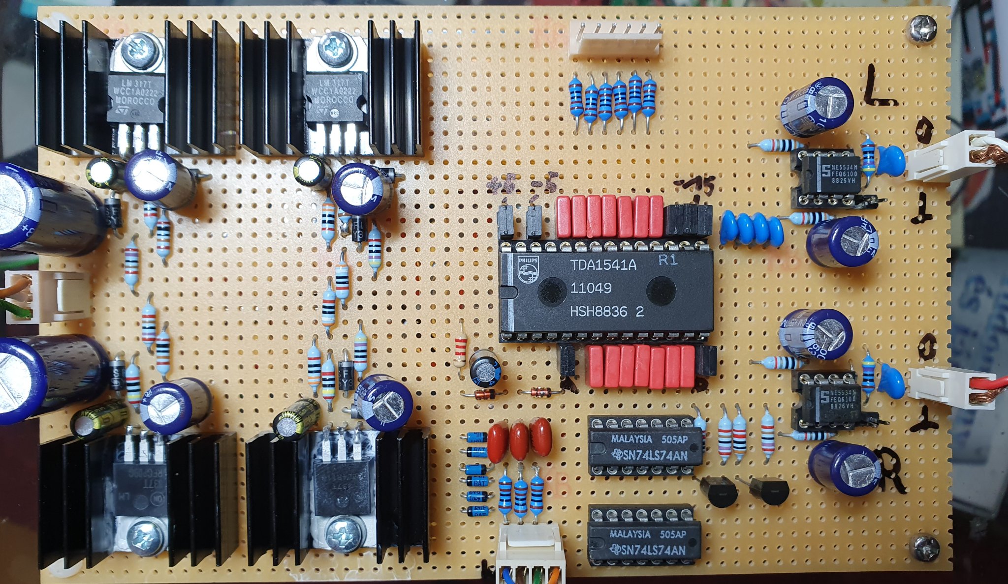

hum forget the agnd to dgnd ic pins to planes conection I asked above in order to make it quiter between digital and analog part of the dac chip.
It's HF so it's obvious the current flows through the least impedance/inductance path, so will spread to the most adjacent layer of the digital pin connected plane.
Maybe better just to connect each pin where it belongs directly 3D (back to back diodes or wire if used between them, tht cap 3D connection above the ic (antenna?)) if at the next power pin of the ic. Illustration: DGND to 5V with a cap.
I was naivly thinking enlarging the loop between the two pins will lower the stray capacitance and also because the added inductance (despite being low cause one plain layer used just for each pin before they meet to the starground for the classic method with as last layer of the star ground vias a plain Vref layer) acheives some filtering of HF digital towards the AGND pin. But it would just enlarge the loop. So better to connect them near the "true" Ref (-15V/+5V...).

Nah, use C0G for ceramics. You can easily place 0.1uF (or even 10nF) C0G SMD capacitors below the TDA1541 to -15V to deal with the VHF disturbance's on the DEM Filter pins.

Alas, lcsaszar measured the actual currents and showed my analysis to be incorrect.
So everything is back "wide open". And I was wrong.

no more -15V main decoupling ?! I still do wonder why the 14 DEM were going Back to the Agnd pin in the orthodoxal canon ? If not -15V then they should be see the DGND pin 14 first ? How funny, 14 DEM caps to Pin 14 ! Philips Easter Egg ! Then AGND and DGND layers only met near the PS with the two piggy backed diode ?
It is possible the shematic of the Guy you worked on is non accurate ! Alas the Philips scanned paper sheets are not going back to the surface !
No, that stays. Only the separation between AGND and DGND is affected.
Yes, so I really appreciate @lcsaszar work.It removes a lot of guesswork.

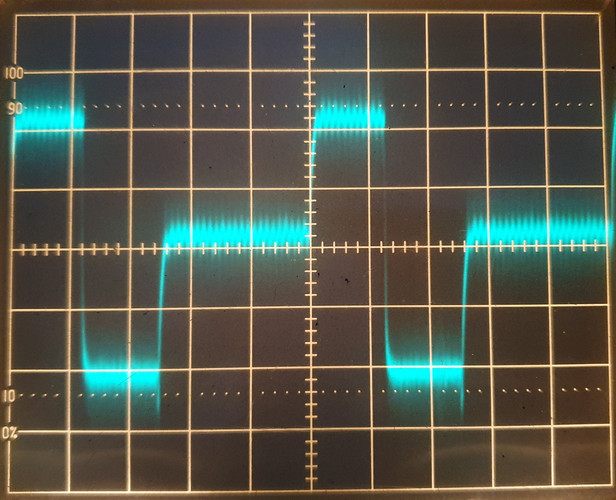

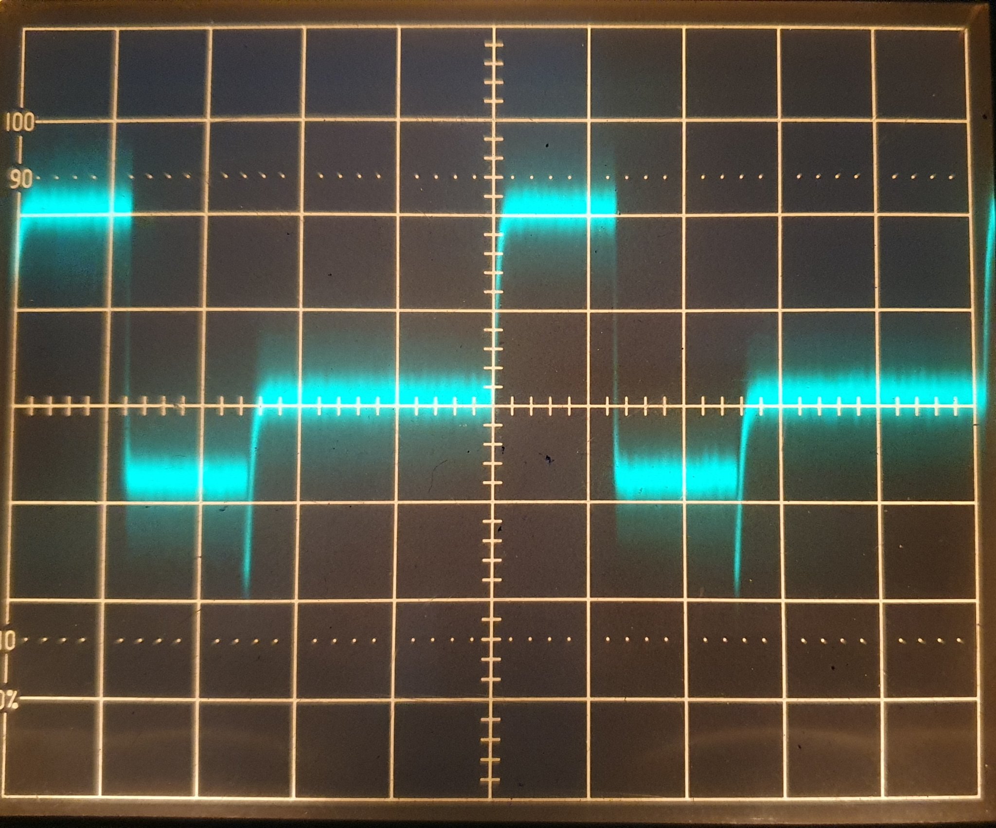

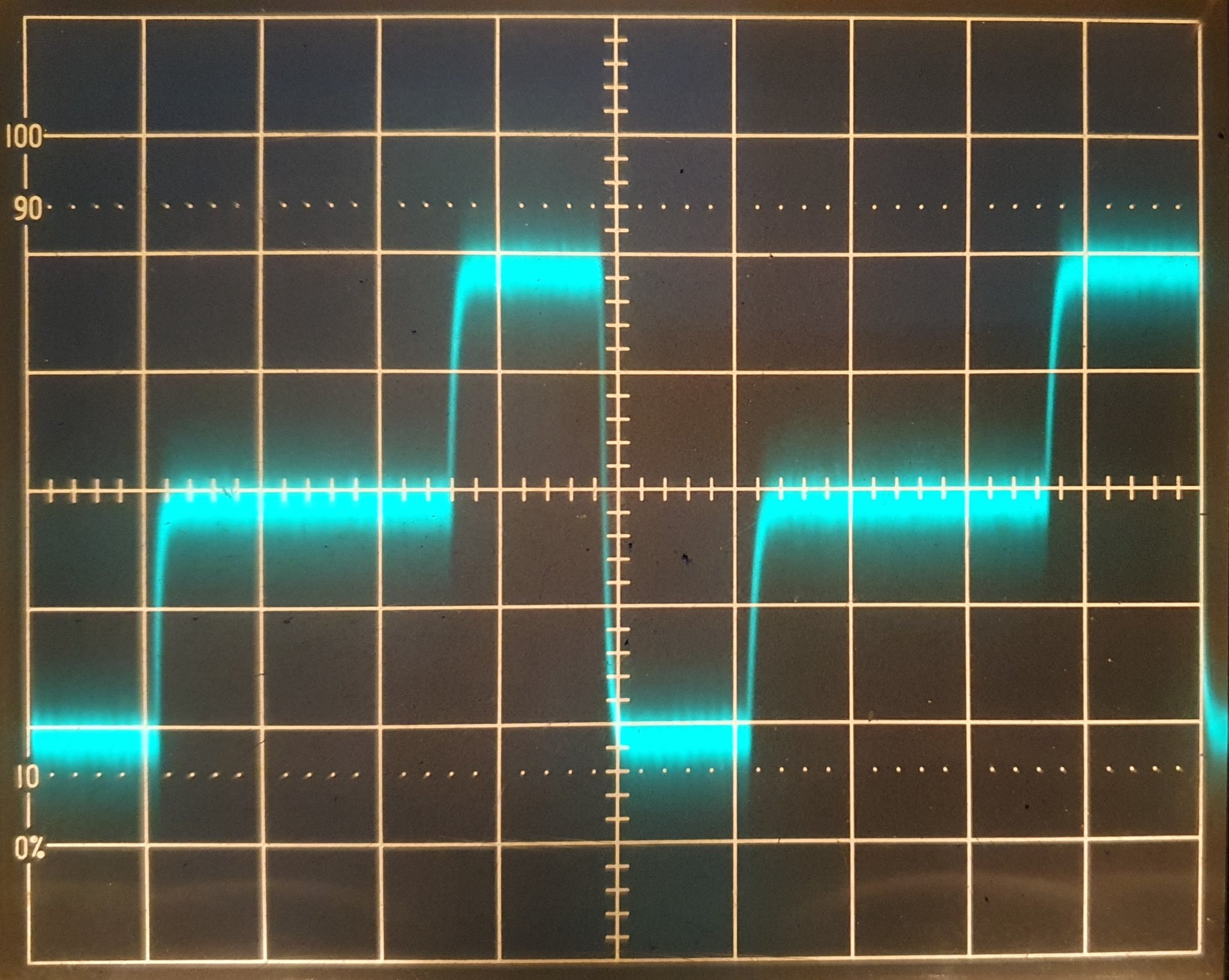

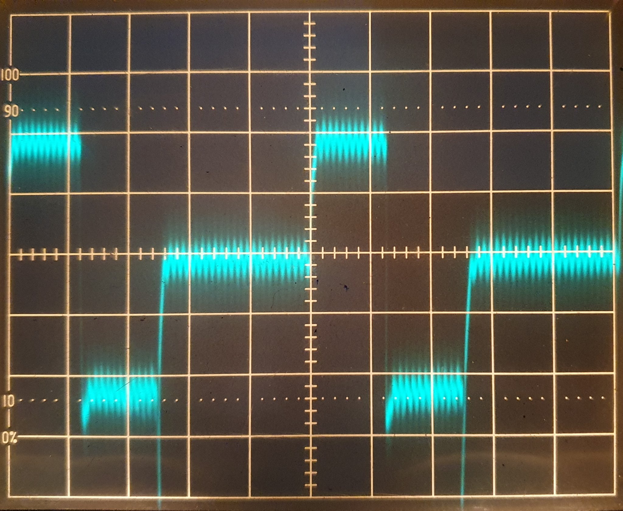

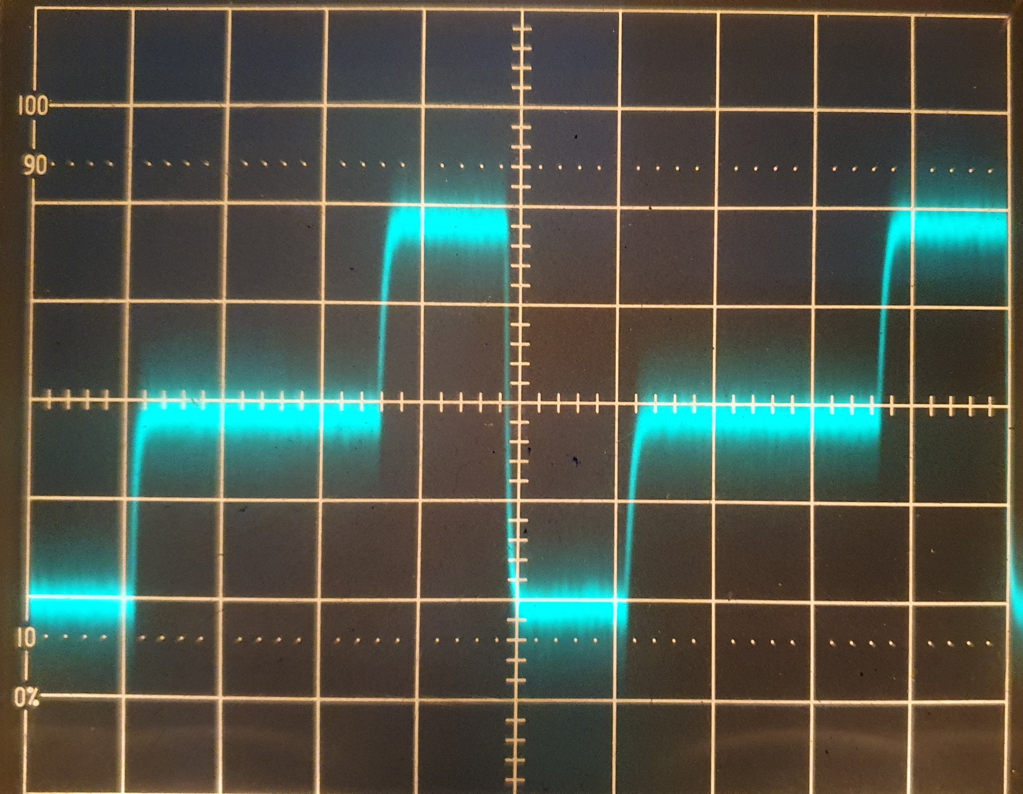

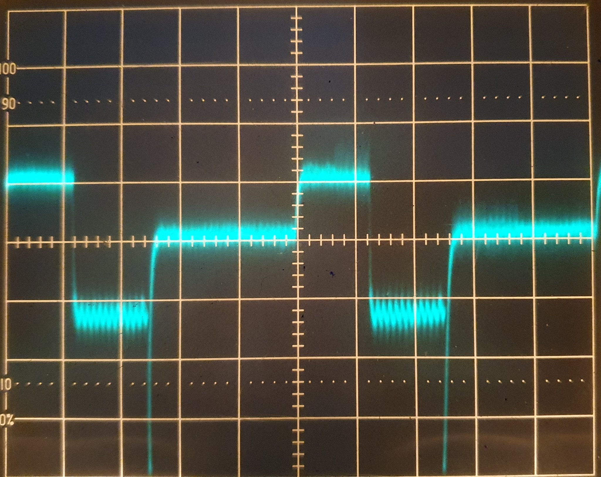

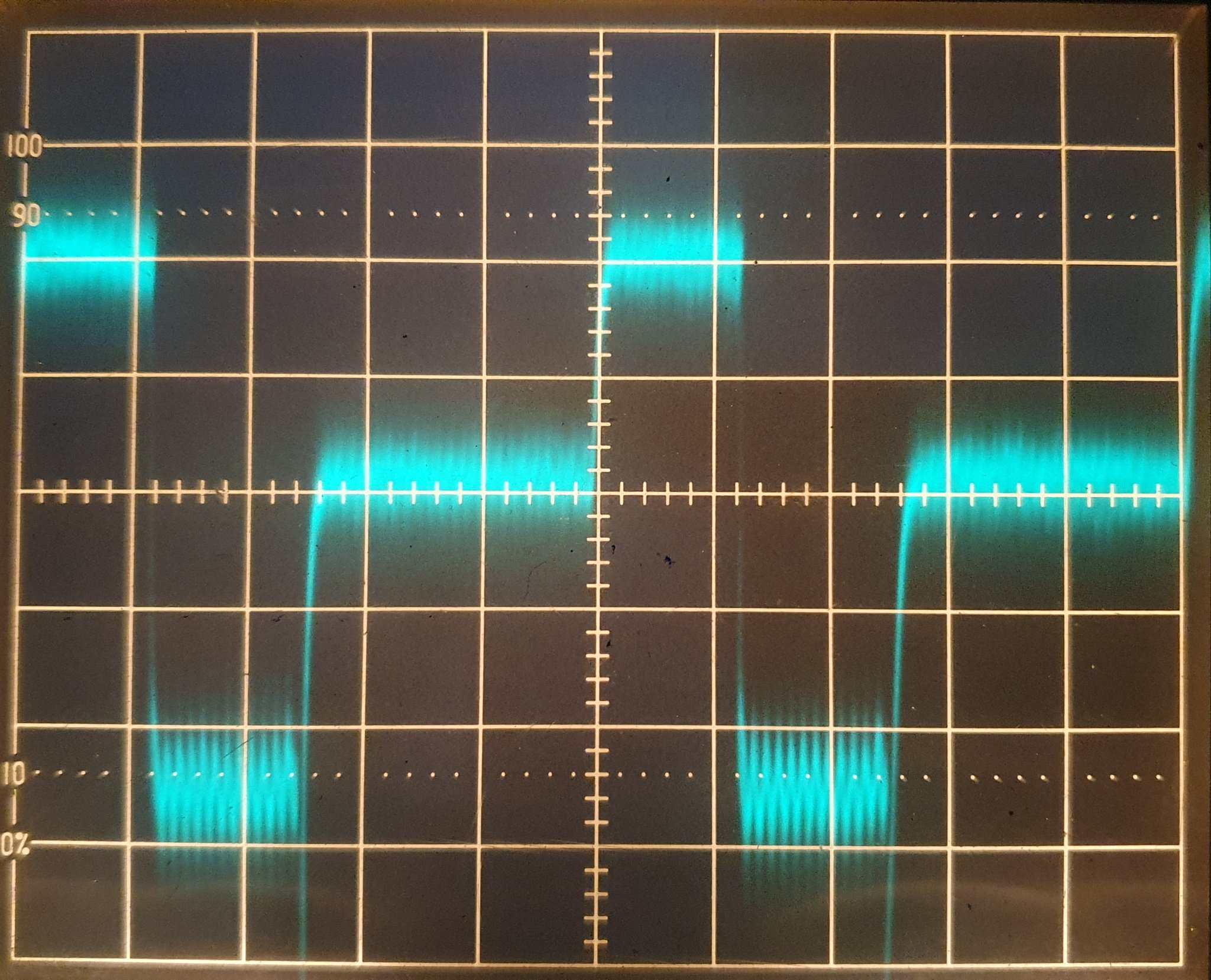

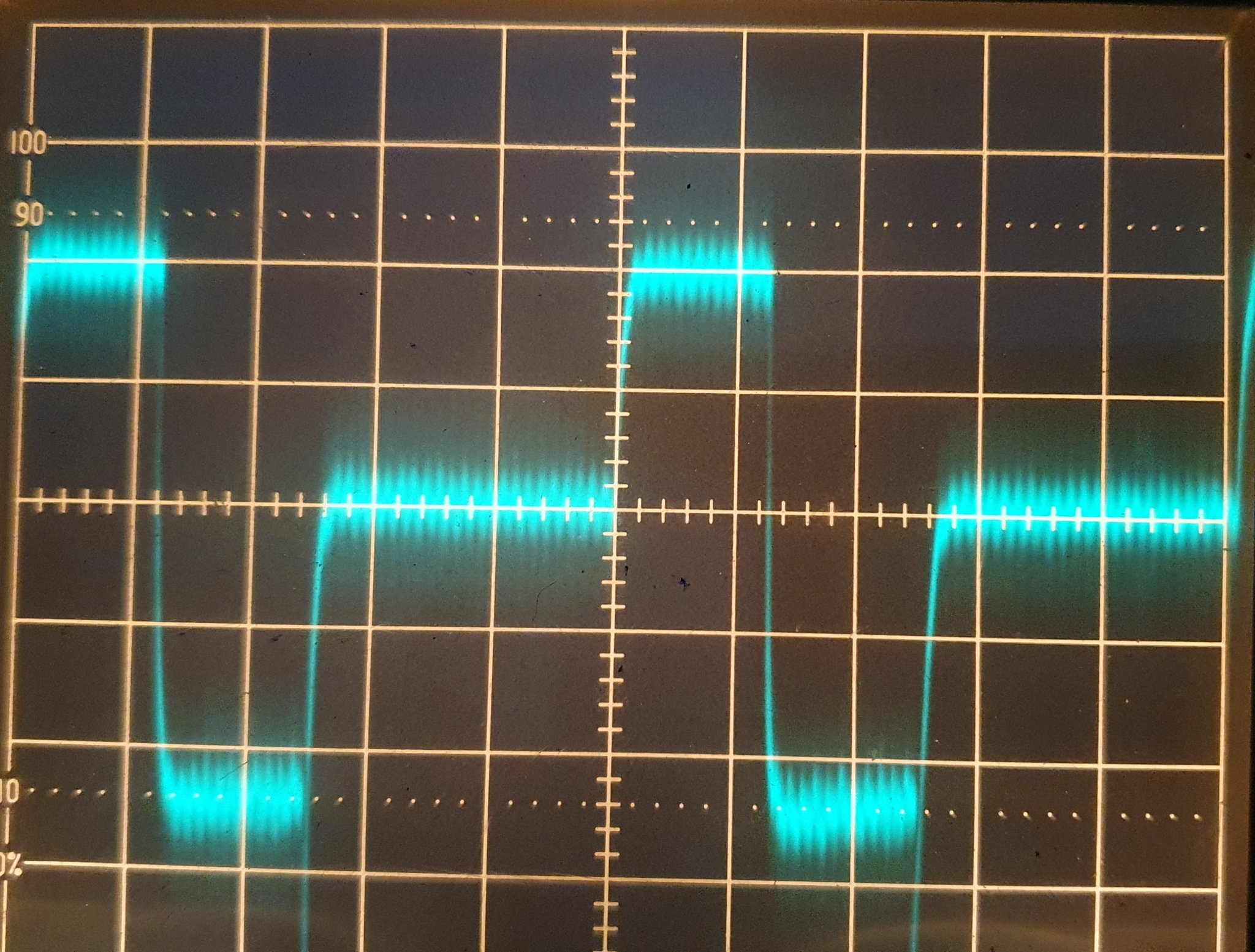

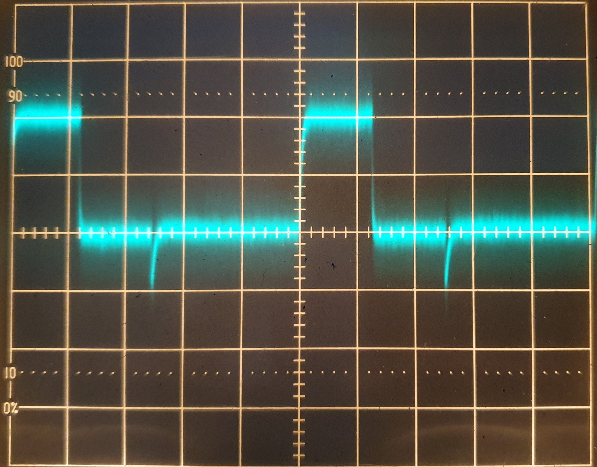

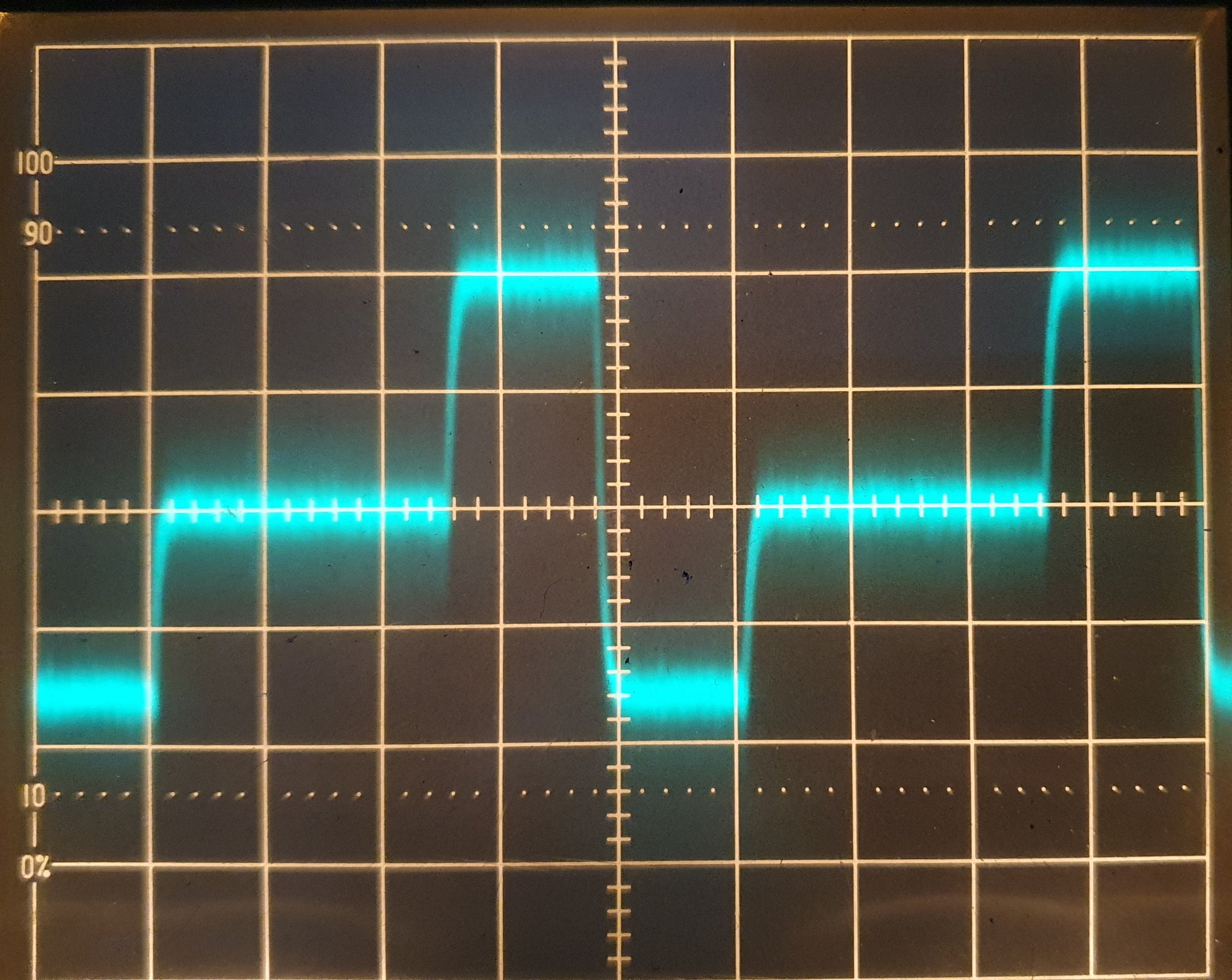

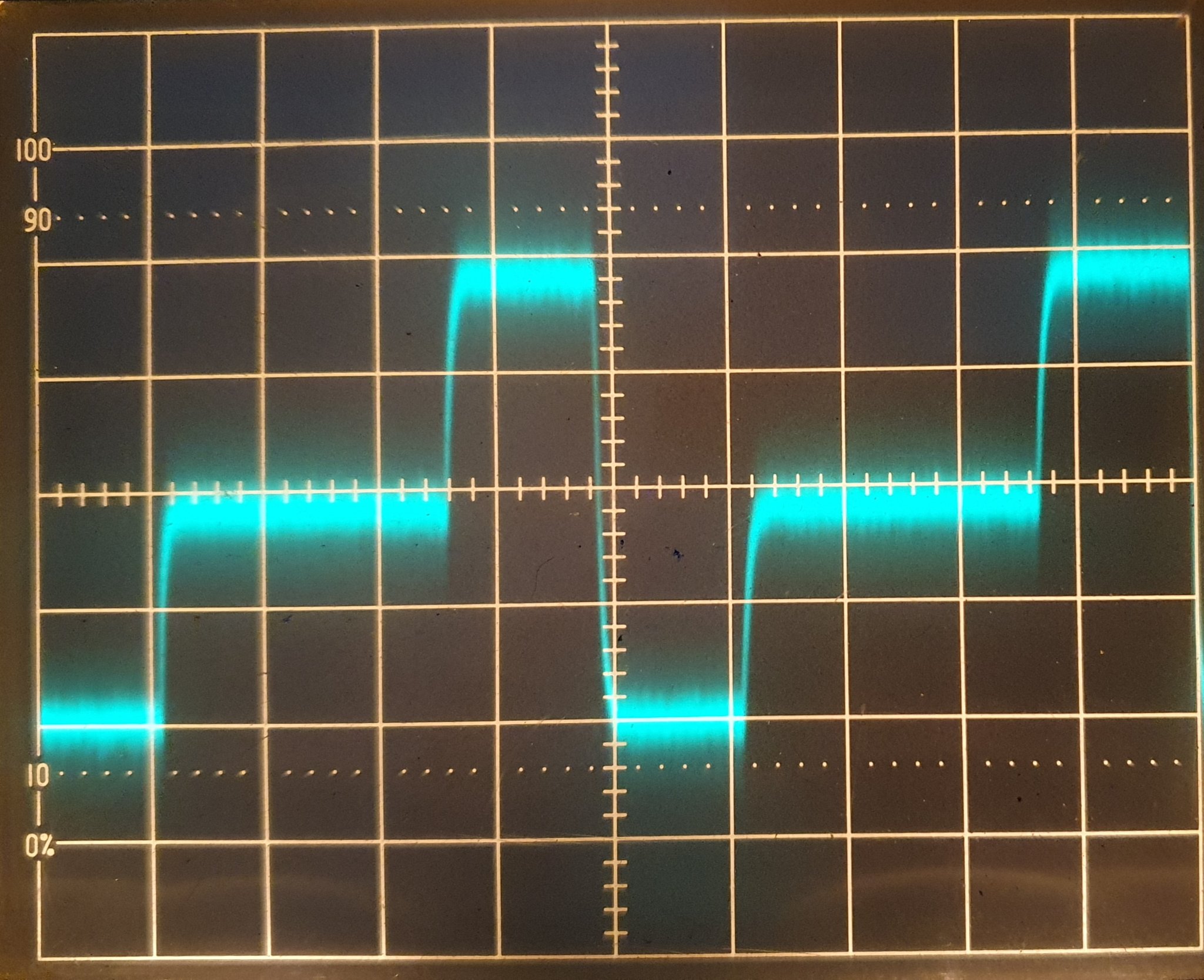

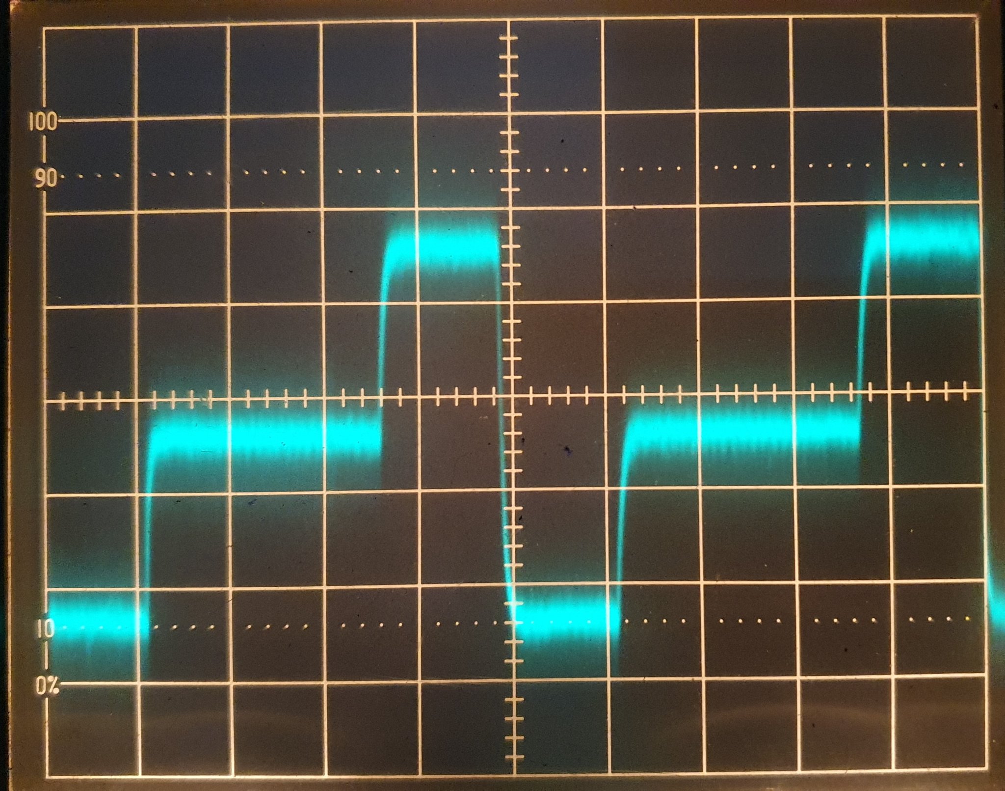

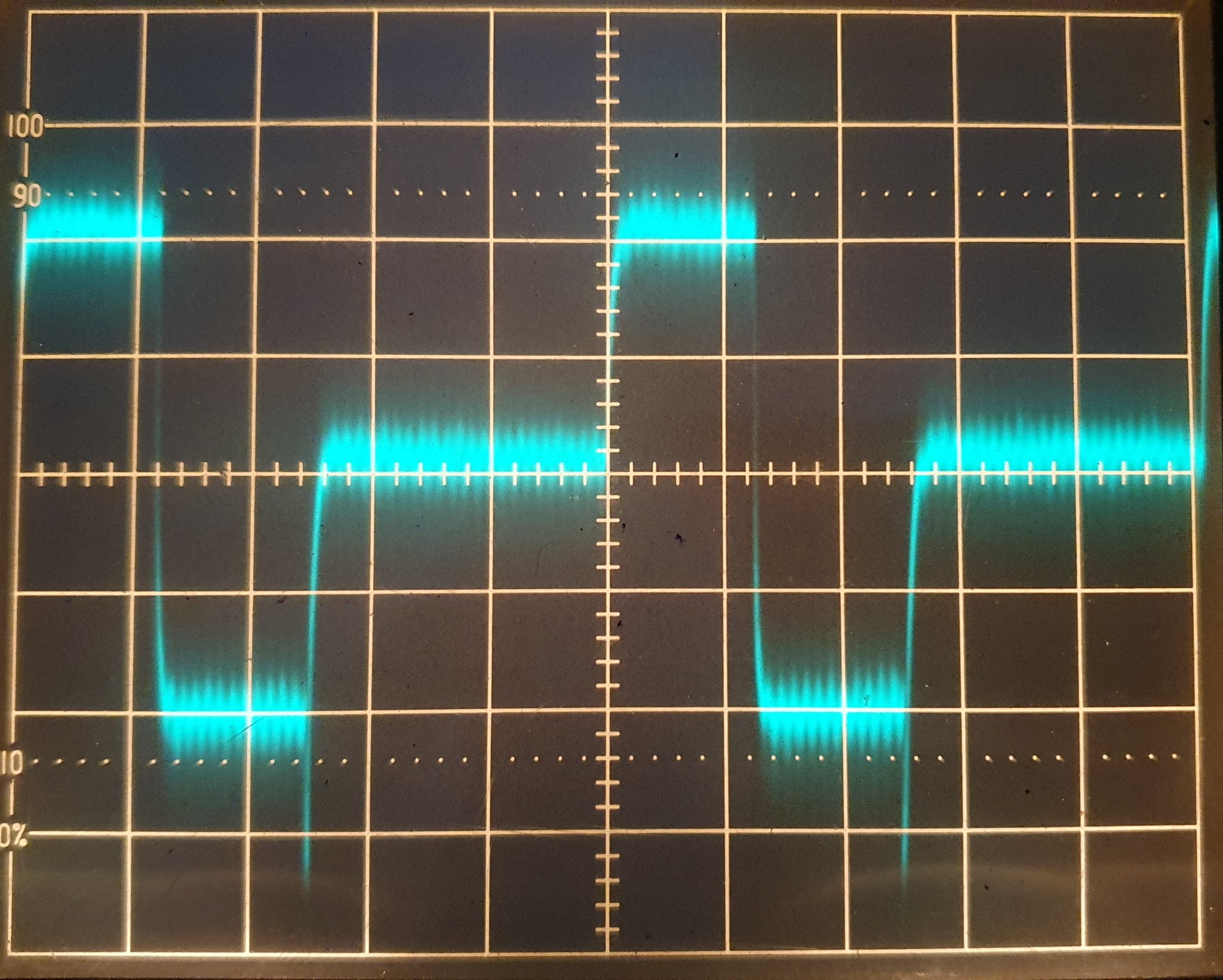

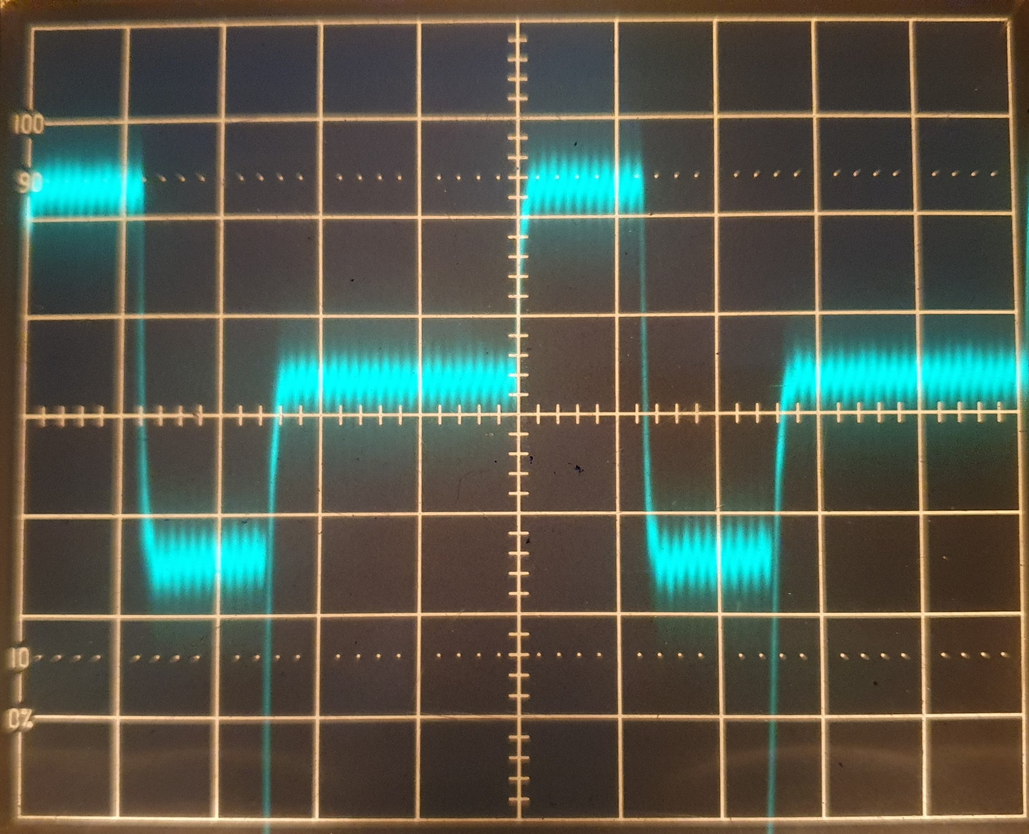

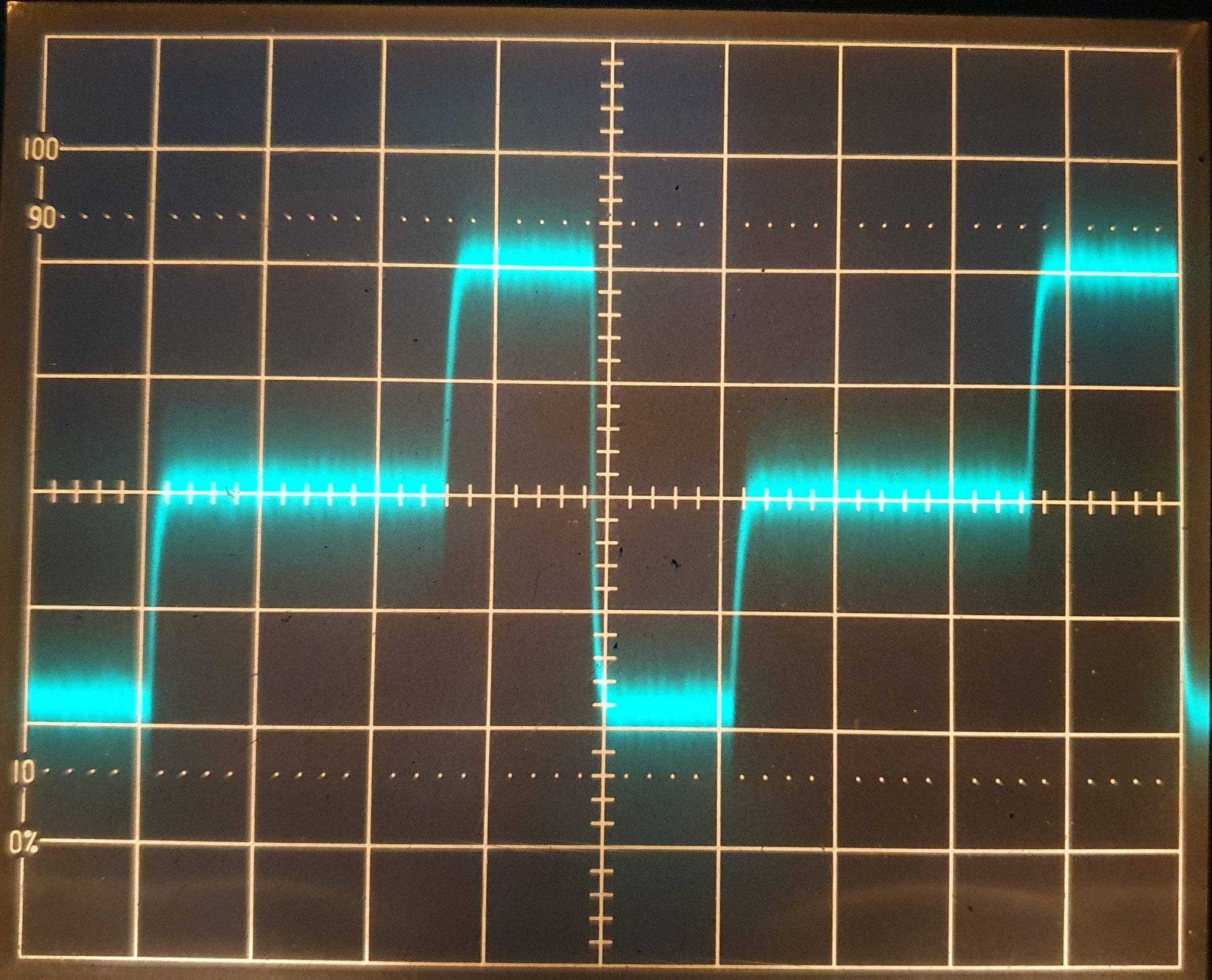

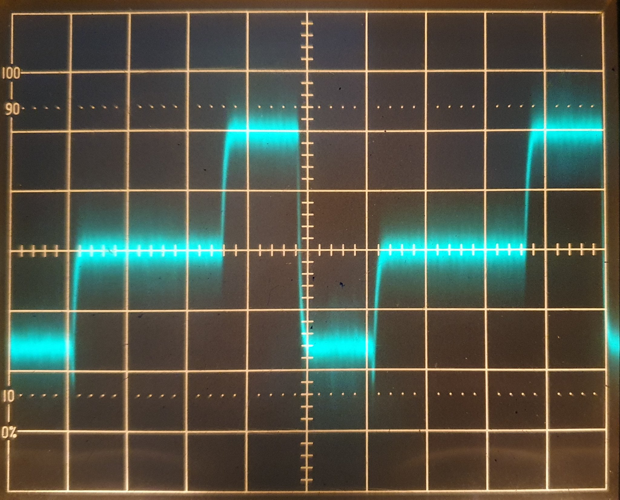

Attached photos from the oscilloscope screen, bit transitions visualized.
0111...1111
1000...0000
1000...0001
0111...1111
1000...0000
1000...0001

Note the ugliness of bit #8 and bit #9.

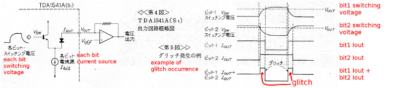

I guess somehow the bit transition "down" is messed up, but why?
And is this one IC (possibly out of normal spec) or architecture specific?
Do you know this:
Nakamichi has a patent on this.
