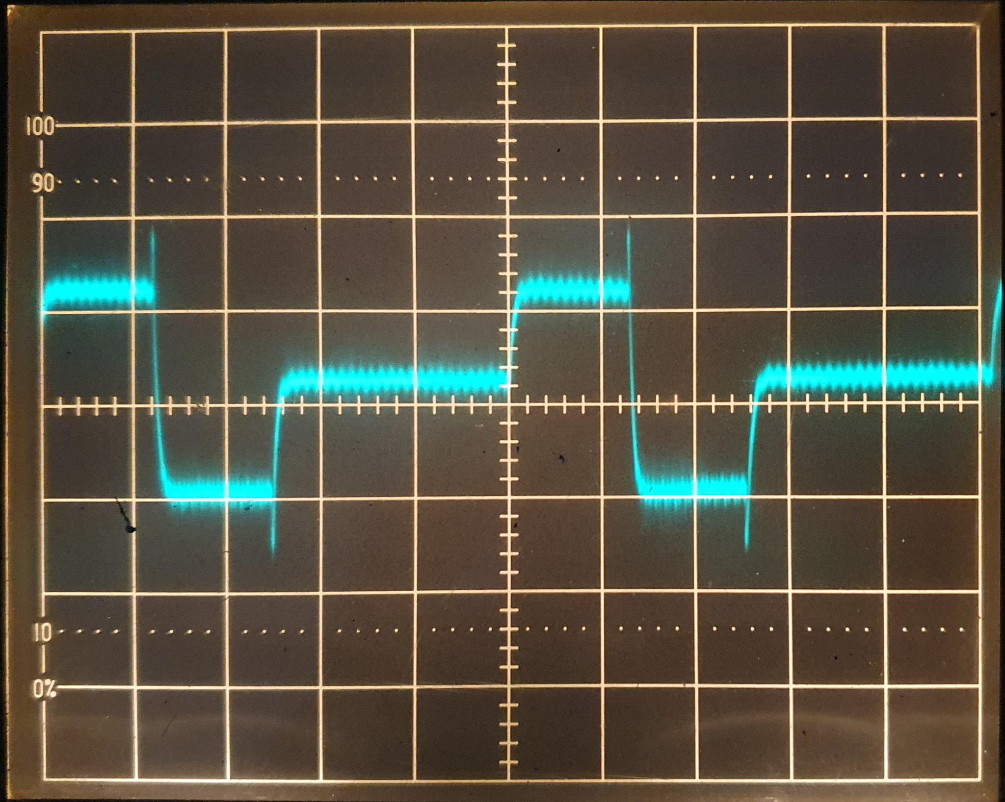

Just to be clear, this is Bit 8 ONLY switching, not LSB and other bits switches off and Bit 8 switching on and Back?
Yes you are right, I forgot about it. Compensation works only at the DEM decoupling pins, i.e. bit #10 to bit #15. It does not work for bit #9 either.
We have to accept that R1 chips are what they are.

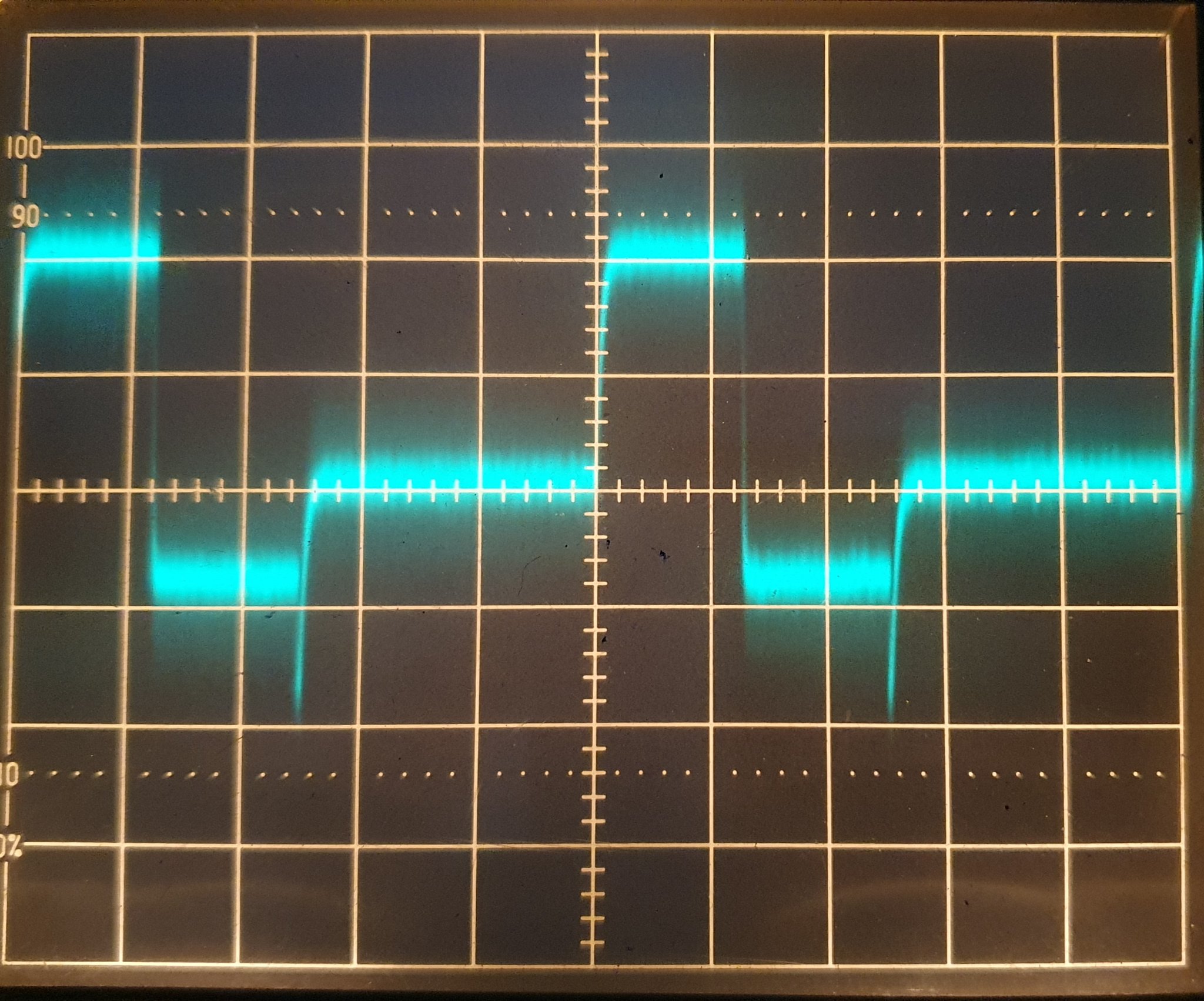

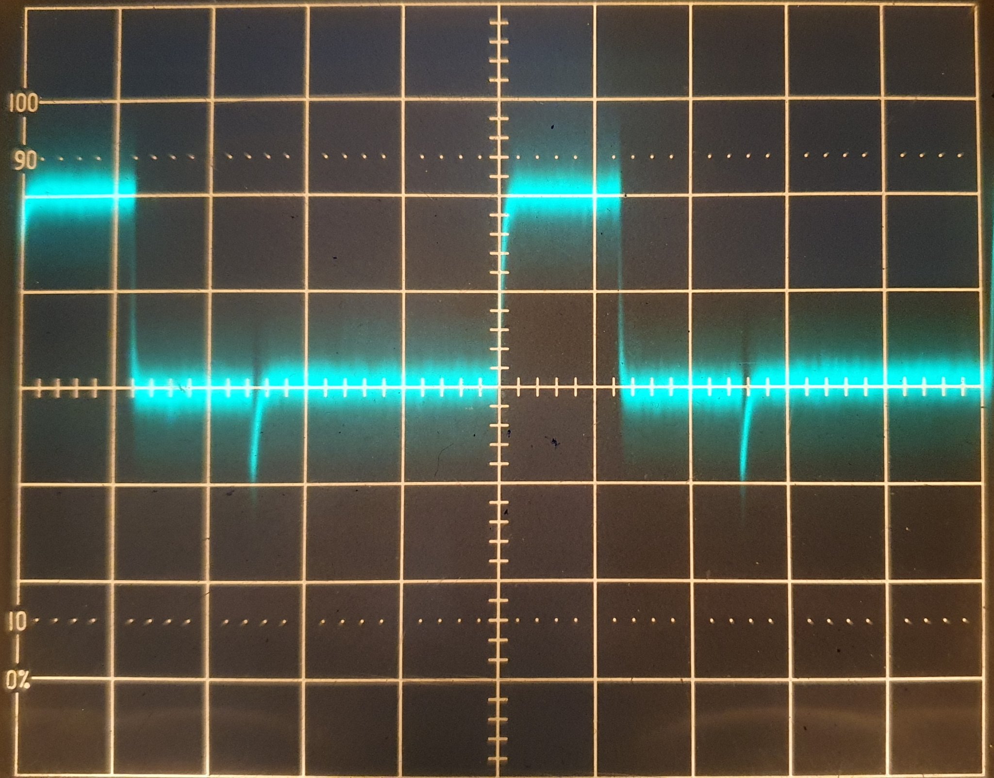

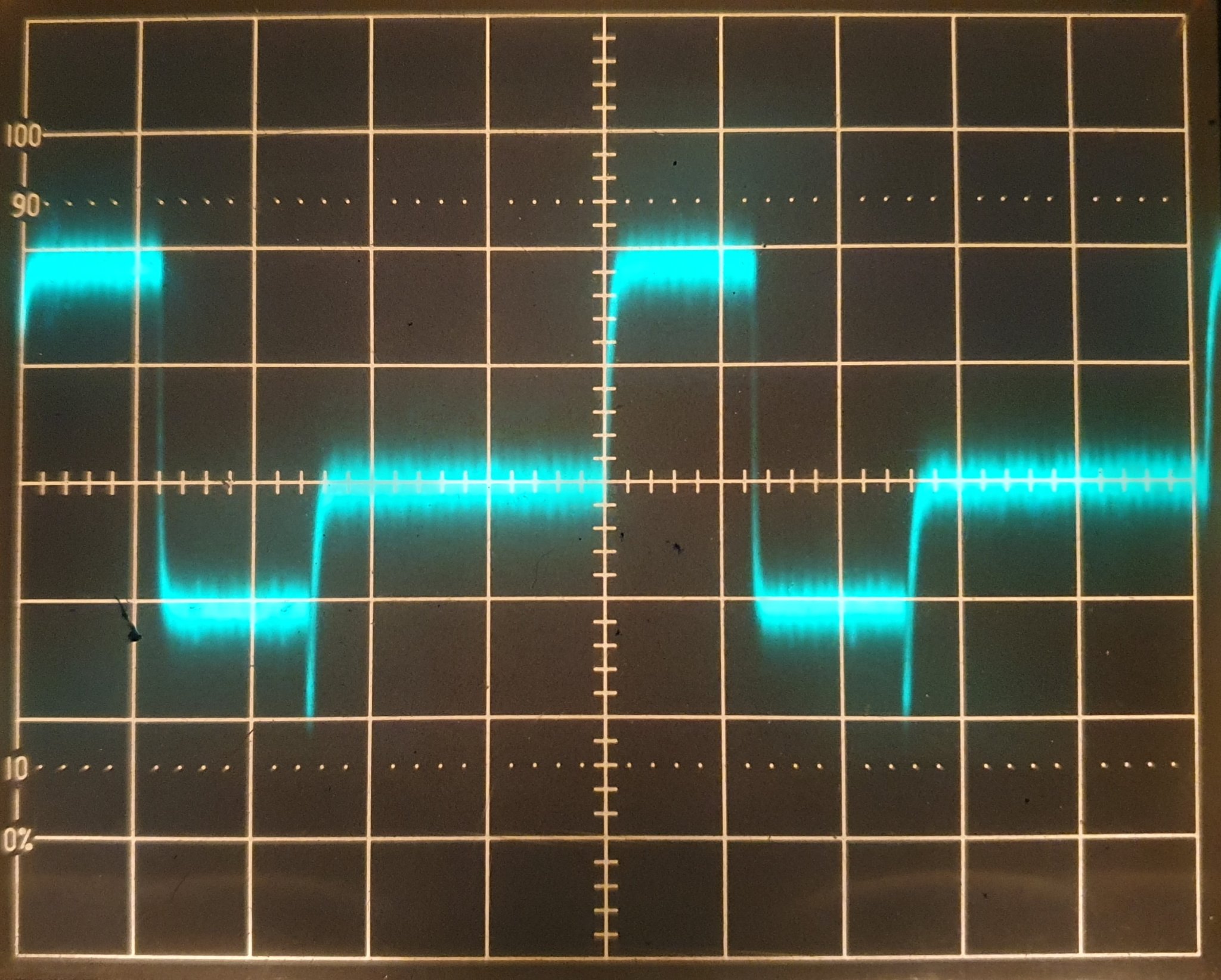

Bit #8 switching:
0000000001111111 (12 samples)
0000000010000000 (24 samples)
0000000010000001 (12 samples)
repeating ad infinitum.
Bit #8 switching:

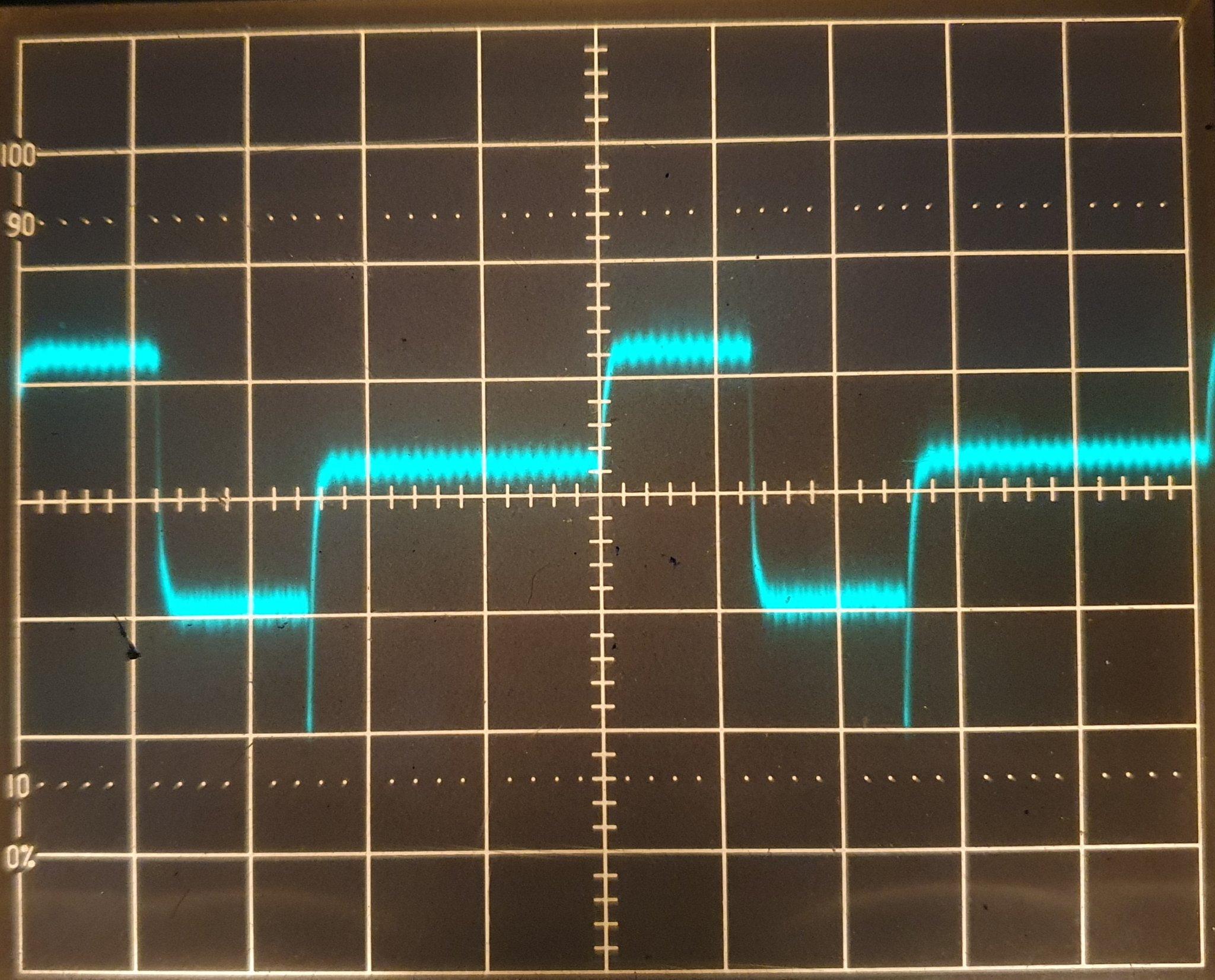

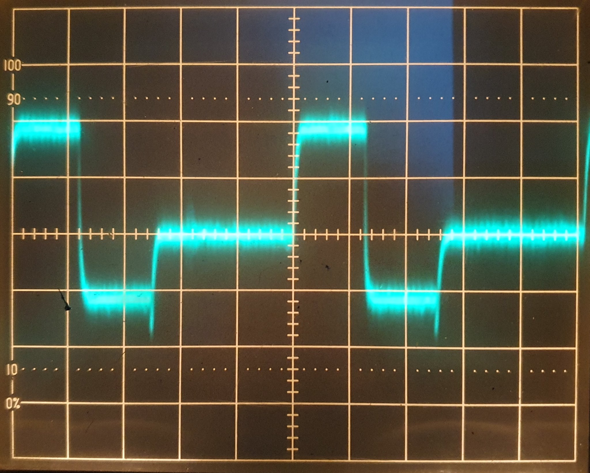

Allow me to translate for the hoi polloi (e.g. me) who are a bit thick and slow.Bit #8 switching:
We take, in the post with many pictures, each given bit and switch the data +/- 1 LSB around this bit being on.
So normally we expect clean step of +/- 1LSB.
For whatever reason, we have two bits that show a behavior that is erroneous.
Now, to me this almost looks like a defective die.
As if somehow the LSB's in one bit are partially and in the other near completely shunted away. Maybe a bit switch being triggered erroneous?
Like here, I may be wrong, that looks like the LSB trying to switch to add to the bit and failing to turn on?
And here:
The glitch is almost as high as the LSB should be, but it is clamped by something else.
I'm not an IC specialist, but to me this doesn't look like "differential nonlinearity" but bad silicon.
It may have been graded R1 with a small defect (someone barfed on the wafer in the Monday morning shift and didn't quite wipe the wafer clean enough) that over time turned into a hard fault.
Anything affecting not the LSB would have probably been permanently recycled.
I'd be interested how a good normal (not relaxed spec) new or lightly used chip looks like.

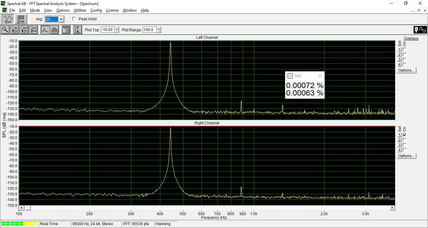

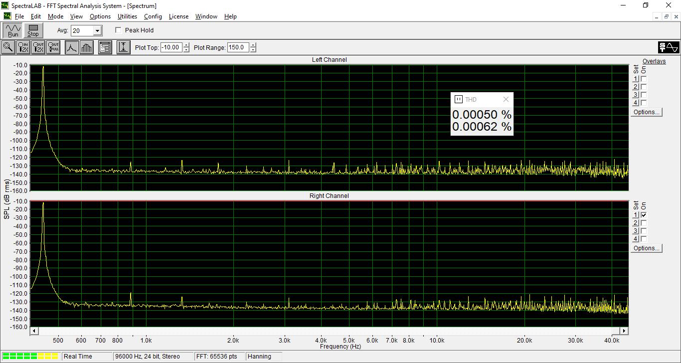

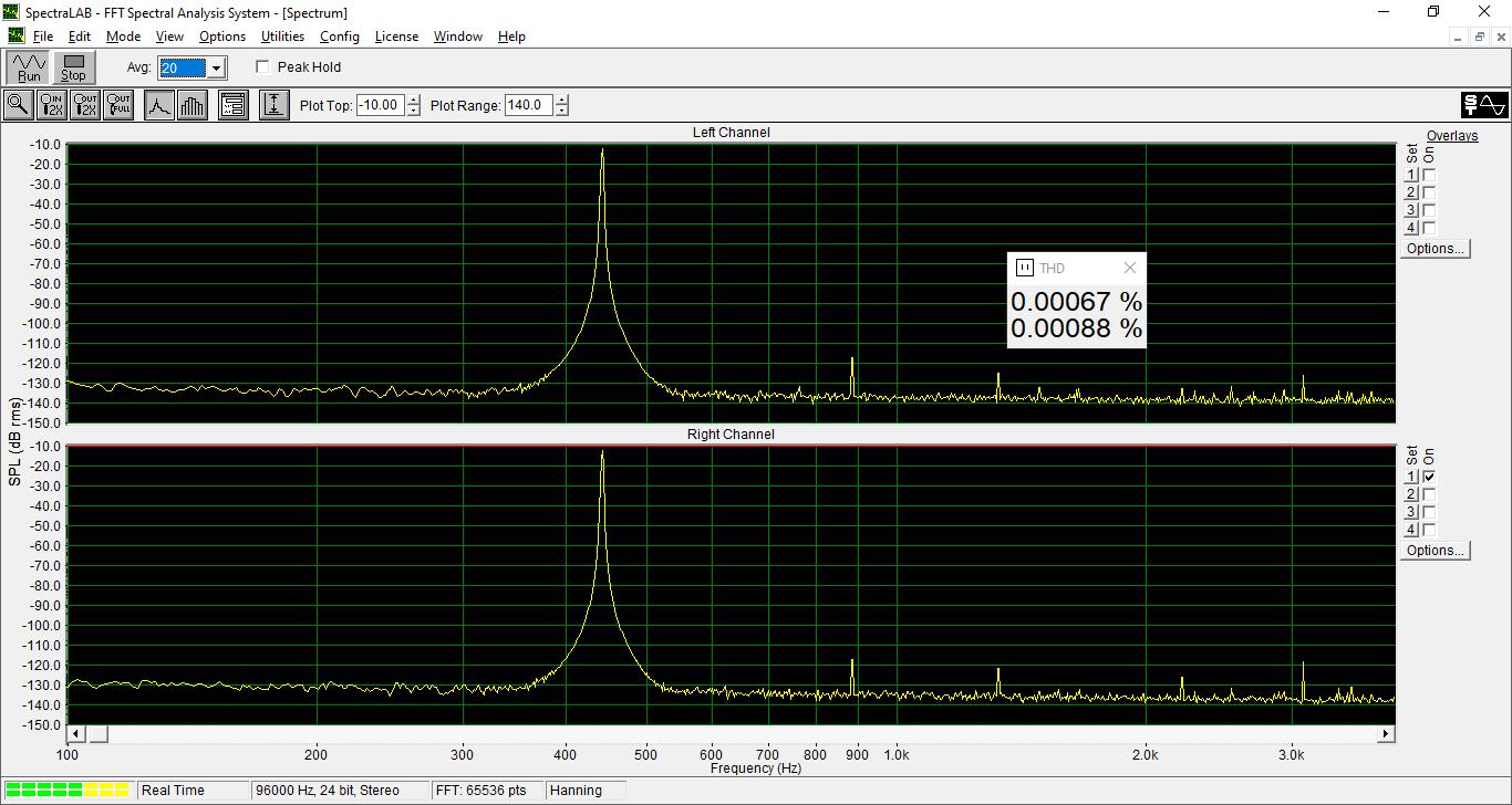

The interesting thing is that the error does not show up in full scale test. The THD is still 0.0005% in both channels.I'm not an IC specialist, but to me this doesn't look like "differential nonlinearity" but bad silicon.

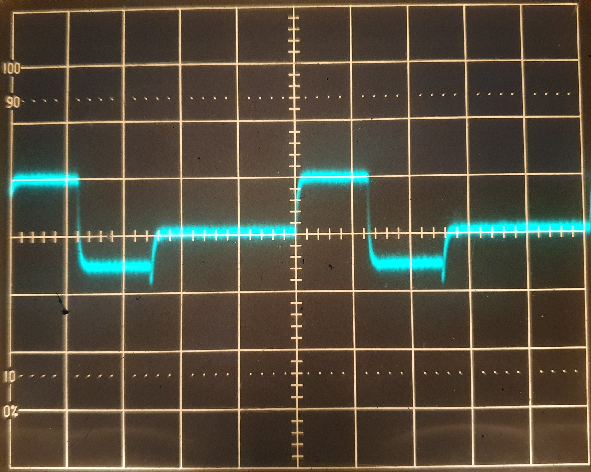

Anyway, what we could see here is 1 LSB error, i.e. within spec. Monotonicity is still maintained.
The attached picture is 1/2 LSB error (bit #8, plain chip).

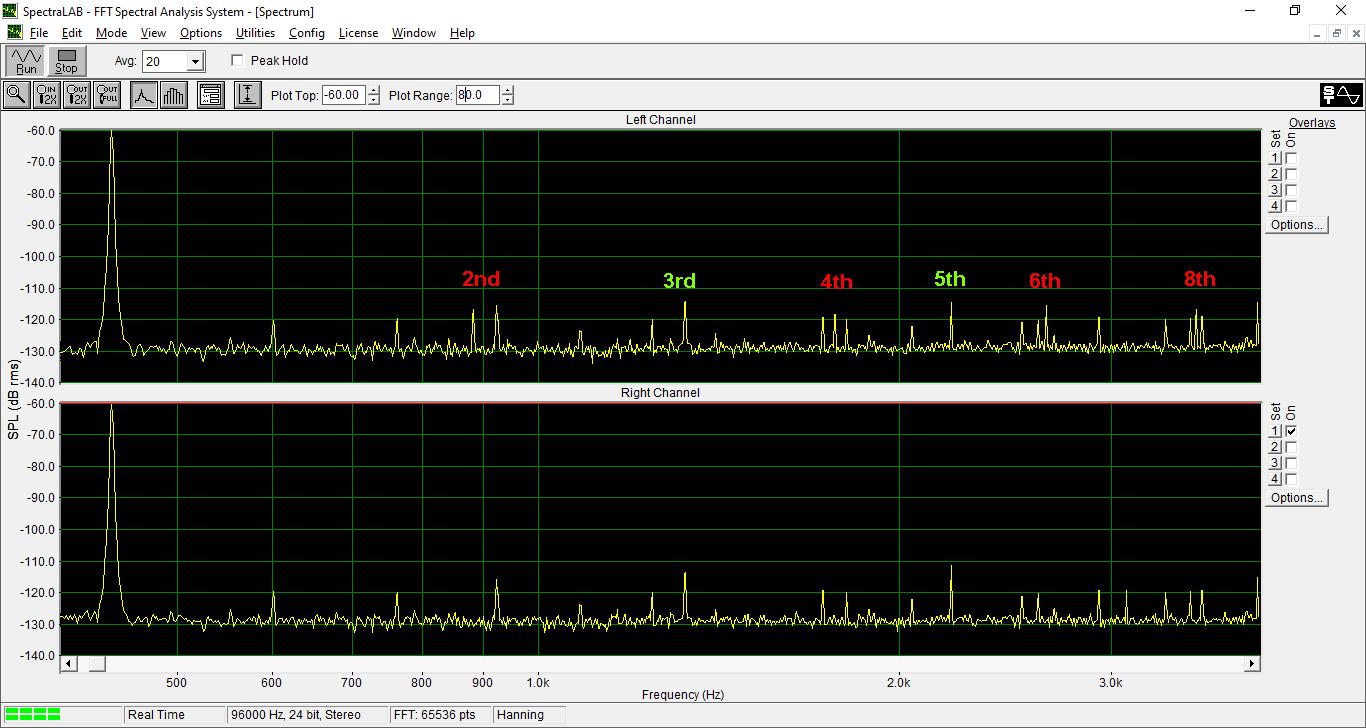

I added the offset part to my little test board, Right channel. It is interesting, the 2nd, 4th, etc. harmonics can be nulled out at low level (-60 dB). There was no measurable difference at high level. I measured about 50 mV offset, but this is not very sensitive.
I don't know how audible is this.

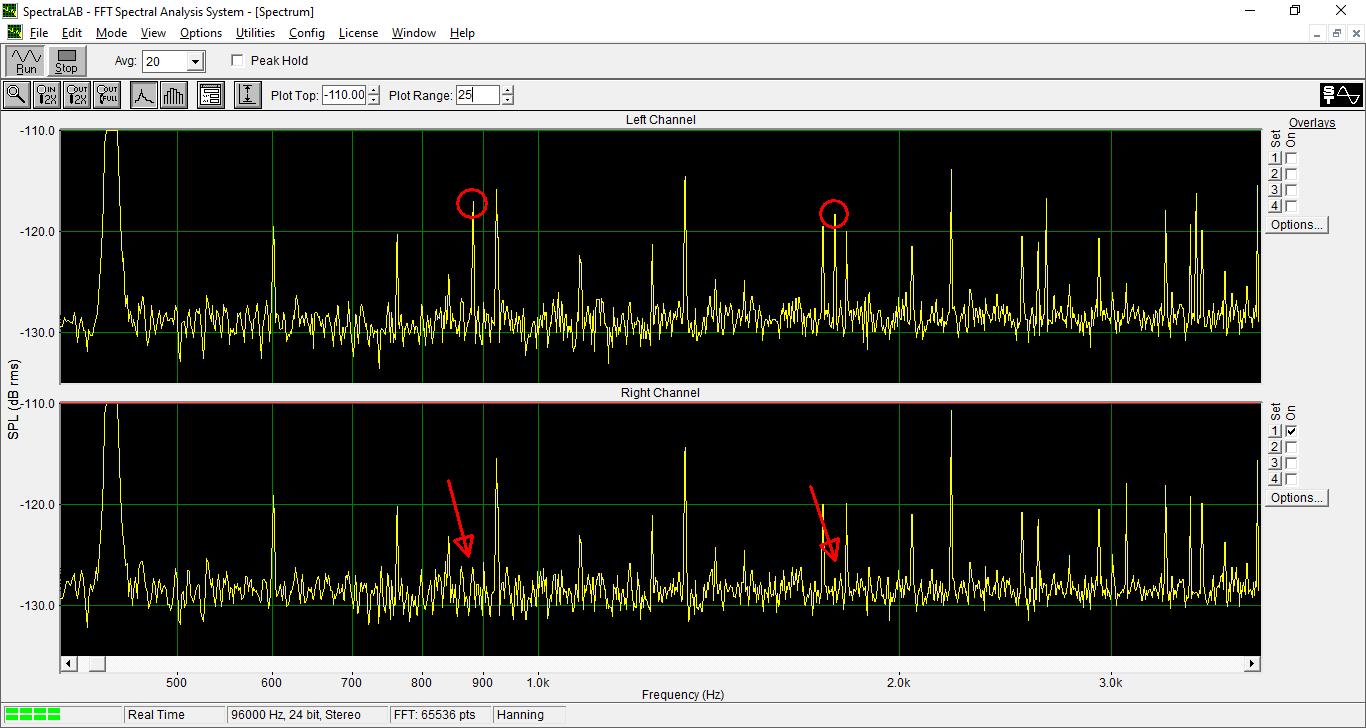

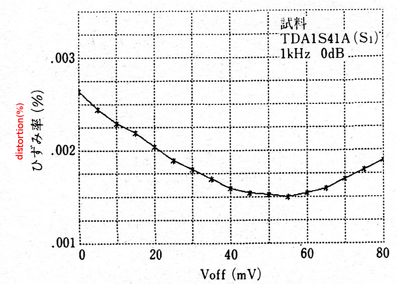

... and I know why and how it works. Voltage on the + input of the opamp 45.5 mV.
Can you try 3.3...10nF from AOL/AOR to dgnd?. and I know why and how it works. Voltage on the + input of the opamp 45.5 mV.
You mean AOL/AOR to AGND? I added 4.7 nF between the + and - input of the opamp, it did not make any difference. L ch without capacitor, R ch with capacitor. -60 dB and 0 dB. Gain reduced by 10 dB at full scale measurement, to avoid overloading of the soundcard. The glitch amplitude did not change, either.

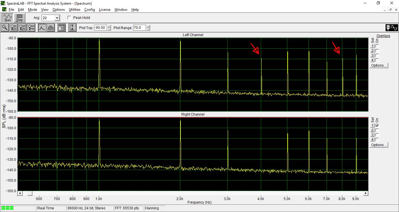

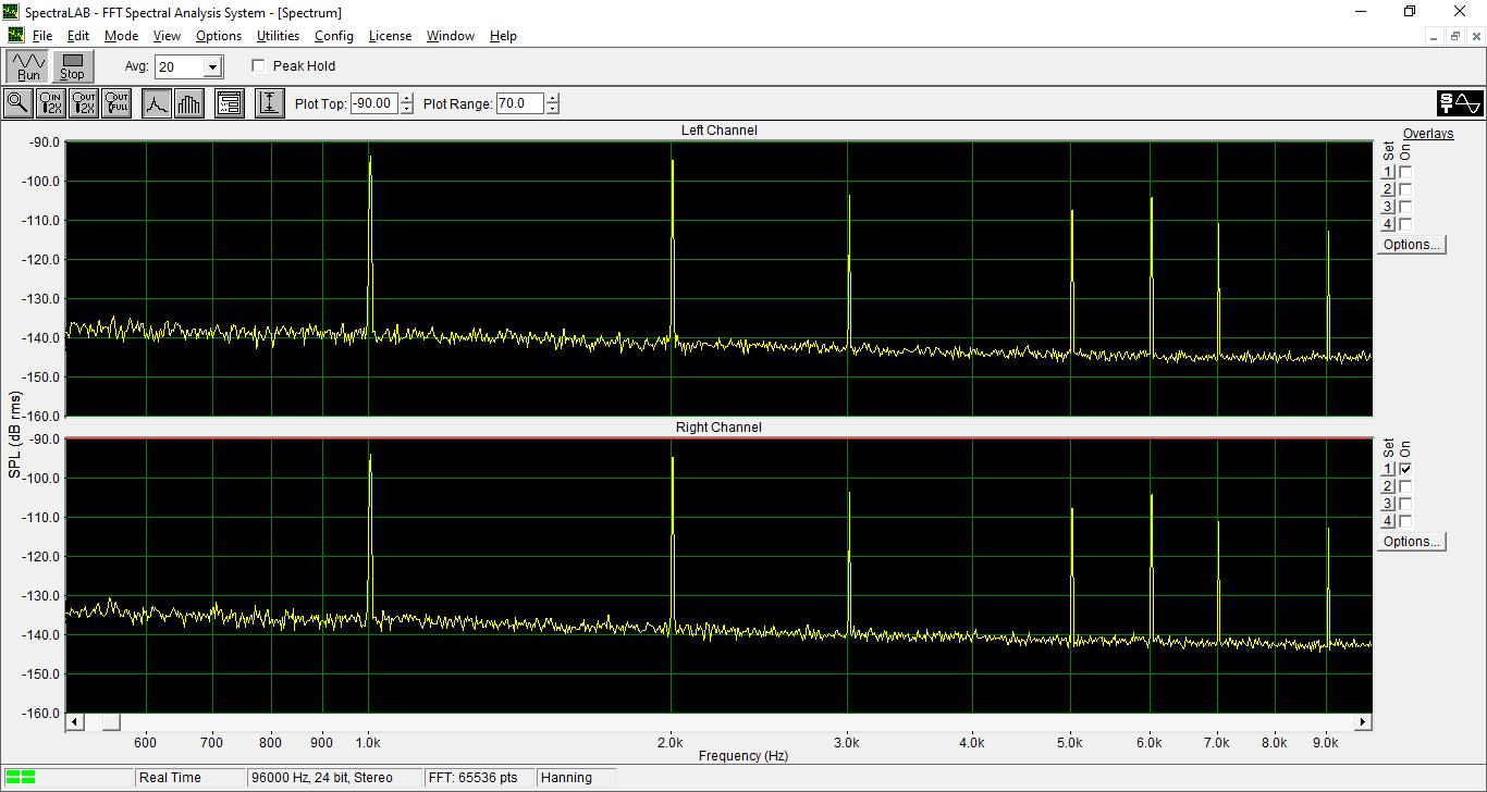

Here is the spectrum of the stepped test signal (like in post #95). Upper (L ch): uncompensated, lower (R ch): 46 mV offset on the + input of the opamp. There is nothing to compensate up to bit #5. Glitch occurs from bit #6 and up, the glitch amplitude (and energy) is increasing at higher bits. The spectrum line at 4 kHz and 8 kHz is the indication of glitch. Attached is bit #0 with no visible glitch and bit #15 where I could sharply null out the 4 kHz spectrum line in the R channel.
Ok.
The lower trace looks a little cleaner, is that "with" capacitor?
