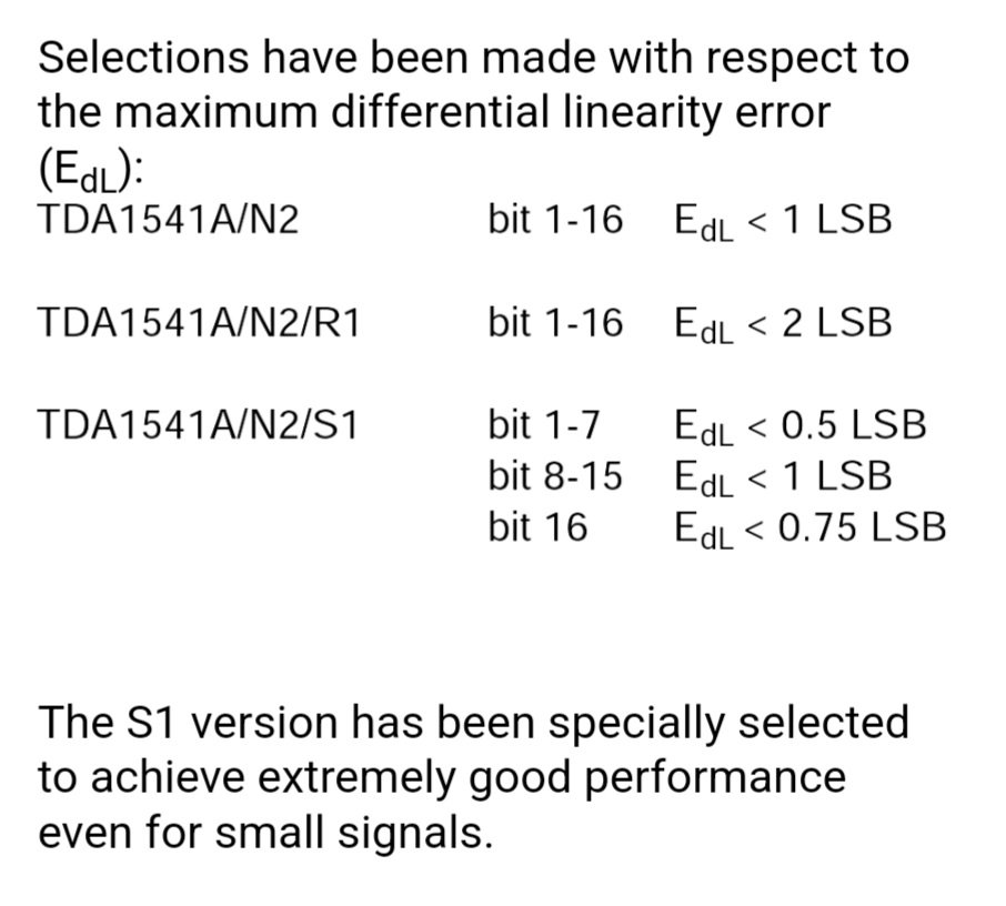

It sounds reasonable. However, there are still audible differences between R1/plain/S1 and Philips/Taiwanese chips. My hypothesis is that the difference is due to manufacturing variance that results in DNL (and INL which is cumulative DNL).Anyway, the data sheet specifies maximum differential linearity error for the various grades.
Philips' numbering is bit 1-16, my numbering is bit #0 (LSB) to bit #15 (MSB). It does not matter.
Could it also be affected by variance in materials used to make the Dac chip ? Sort of like difference in sound between E capsIt sounds reasonable. However, there are still audible differences between R1/plain/S1 and Philips/Taiwanese chips. My hypothesis is that the difference is due to manufacturing variance that results in DNL (and INL which is cumulative DNL).Anyway, the data sheet specifies maximum differential linearity error for the various grades.
There are not (excluding R1, I never tried), IME, if the surrounding circuitry is designed competently.
I tested this both measured and listening with the AMR CD-77.
There plain, S1, S2, and different origin IC's perform identical enough to not indicate any reliably measurable differences (AP2 SYS2322 Dual Domain) and audible differences were at the very limit if any.

This is good news. BTW, what is S2? I mean is there any Philips ducument about it?
R1 - marked, "relaxed specification"
Standard - no markings
S1 - single crown marking
S2 - double crown marking, e.g. in DA-12
No idea on documents.

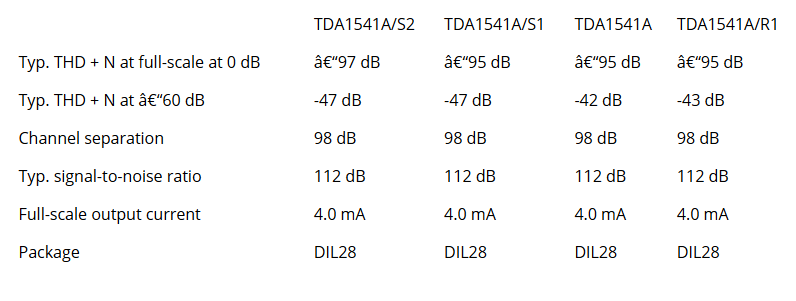

OK, but what are/were the selection criteria for S2?
You tell me. All I know they were real, I saw a few in original gear.
I suspect anything that measured even better than S1?

Google gives this:
https://www.dutchaudioclassics.nl/philips_tda1541-s2/
So slightly lower THD @ 0dBFS.
Thor

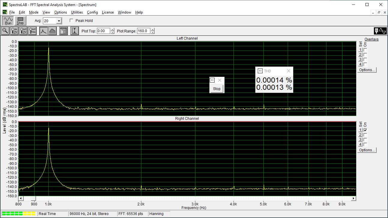

This is roughly what I measured, although THD instead of THD+N.
-95 dBFS would be 0.0018%
-42 dB would be 0.79%
I measured THD:
0 dBFS - 0.0007/0.0007% (L, R)
-60 dBFS - 0.38/0.29%
I measured THD:

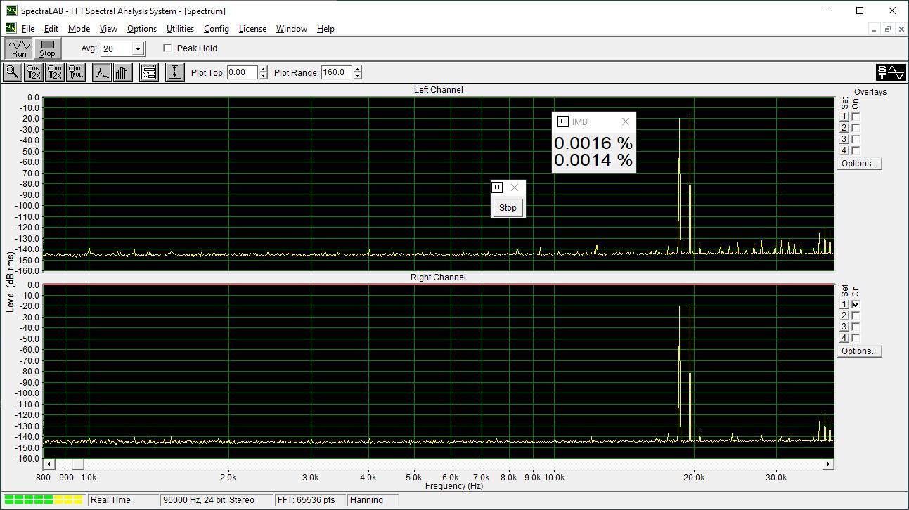

New THD measurement baseline
I just modded my soundcard, a Sound Blaster X-Fi HD (SB1240). Replaced the ADC CS5361 to pin compatible CS5381, the input opamps MC33078 to OPA1656 and bypassed the ISL54405 analog switches. See loopback measurement @ 200 mV input signal attached.
That a whole lotta zeros....
