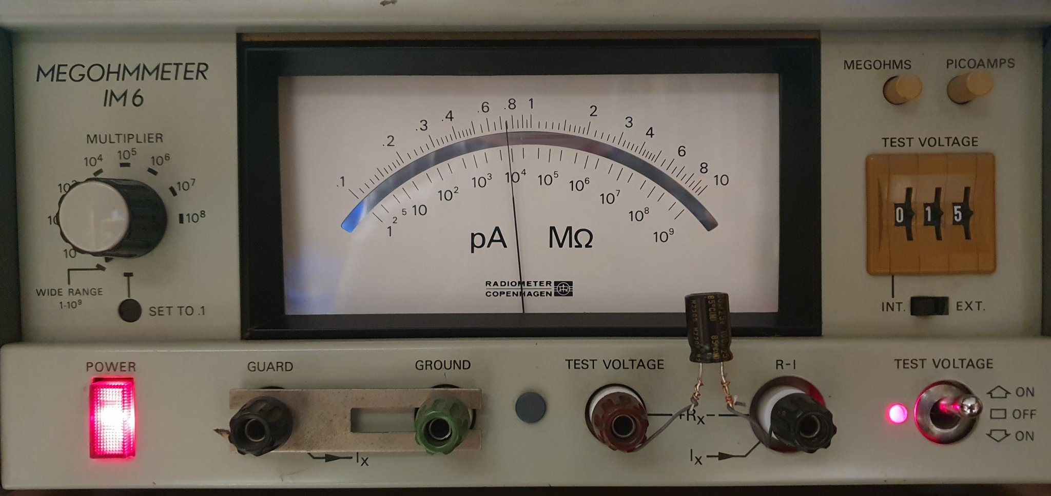

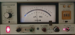

I measured the leakage current of Nichicon Muse UKZ (black with golden letters) 100 uF/25 V after 1 day formatting. It was between 1 and 10 Gohm. UKL is even better. Compare it to 10 Mohm that I used, the leakage of this capacitor is 1/100 to 1/1000 less, I think it causes negligible DNL error.
Measuring tool was a Radiometer IM-6 Megohmmeter, it can measure down to 1 pA or up to 10^9 Mohm.

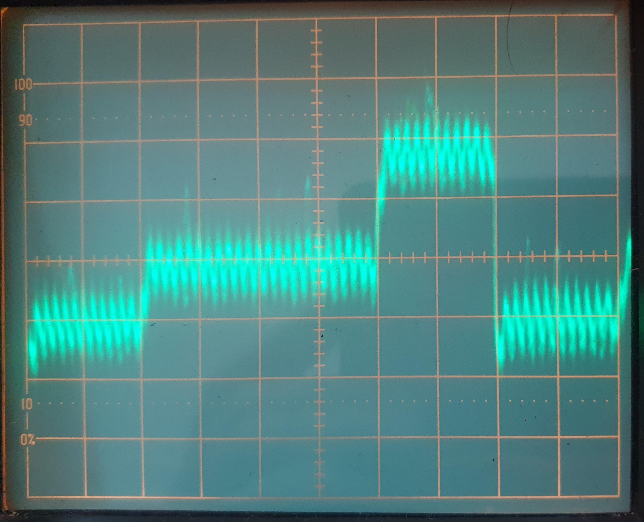

Here is an 1/2 LSB DNL @ bit #10, and the resulting spectrum. Left channel, 0.3% THD. The step signal is 12 samples 0x03FF, followed by 24 samples 0x0400, followed by 12 samples 0x0401. That is 1 LSB change around Bit #10. 1 LSB is 2 vertical grid.

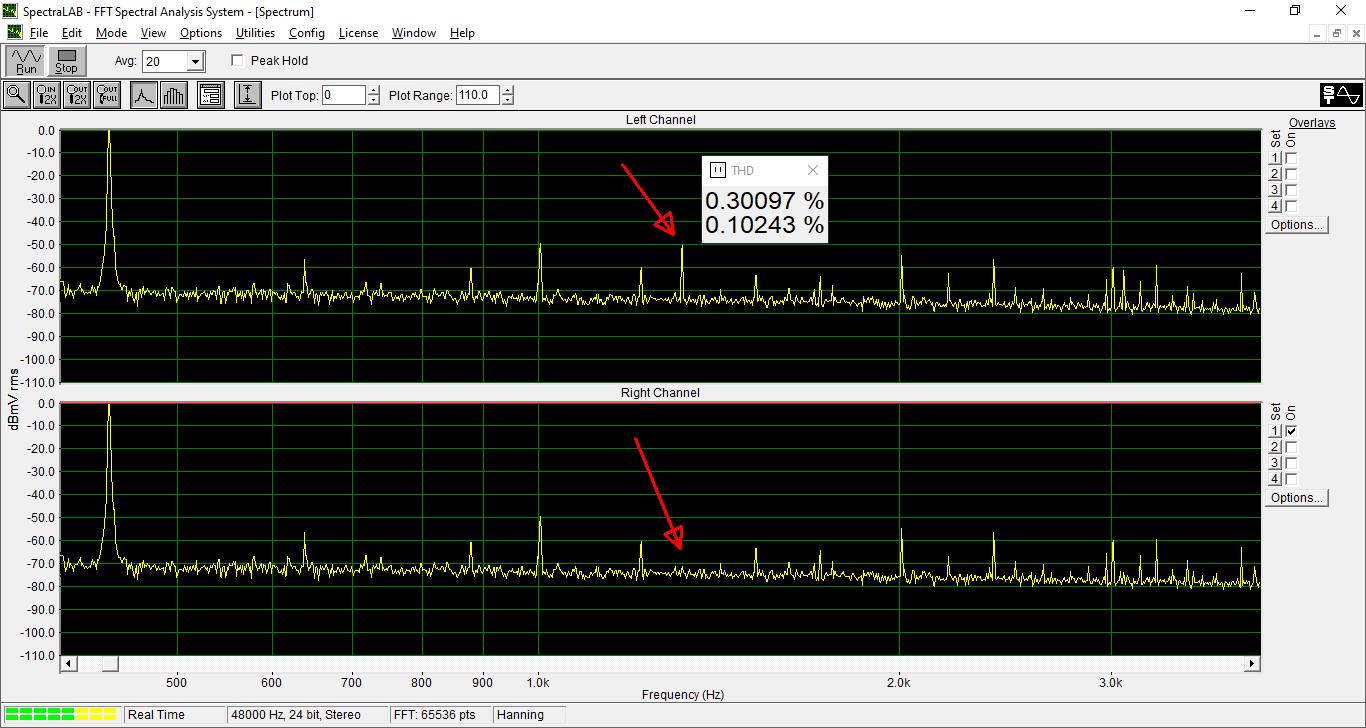

I misadjusted the compensation so that Bit #10 is 1/2 LSB less (1 grid instead of 2) than the cumulative Bit #0 to Bit #9 (they are all 1s, then they change to all 0s and Bit #10 turns to 1, that is the 24 samples plateau). The spectrum is again the 6 least significant bits holding dithered 400 Hz sine, shifted by Bit #10 DC level.
Right channel is OK without compensation.

Hi, the leakage should be very close what he measured for the other UKZ. Most difference between the 3 voltage familly is the angle of tangeant loss, then inductance due to the different leads spacing and form factor & casing due to the voltages ratings.
It is set by the Test Voltage, i.e. 15 V.What's the voltage across the cap when you're measuring 1G?
Wrong , UKZ 100 uf 25 v has 25 uA leakage , UKZ 100 uf 50 v has 50 uA leakage

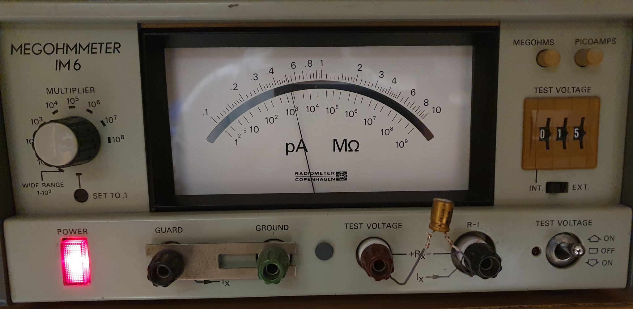

UKZ 100 uF/25 V. Nearly 10 Gohm, let's estimate 7.5 Gohm. Bigger size than UFG (not UKG, it' a typo). 15 V / 7.5 Gohm = 2 nA.Sorry, I haven't got any at hand. Here is a Nichicon UKG (Fine Gold) 100 uF/25 V. A bit more than 1 Gohm.
There might be sonic differences, but I don't think it is due to leakage caused DNL. In any case, if in doubt, a film capacitor is a safe choice.

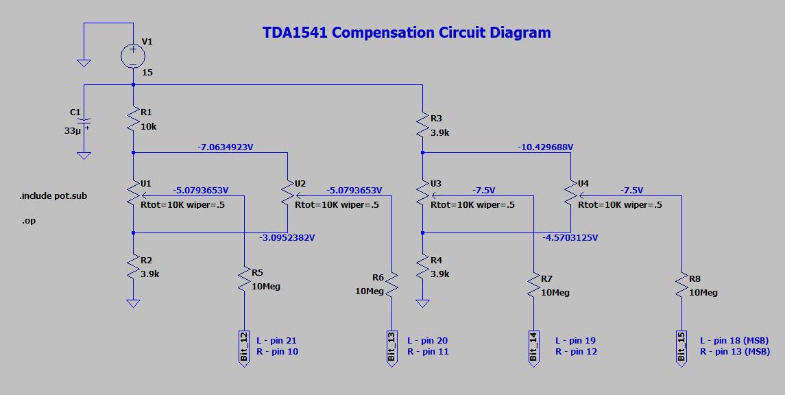

This is the compensation circuit. I measured the THD at Bit #10 and Bit #11 and found that the compensation did not bring much benefit (just like at Bit #9), so I omitted that part.
How to use it?
Send an I2S data stream that represents a -60 dBFS sine, dithered with triangular probability density function of 2 LSB, digitally shifted according to the bit to be compensated. For example, at Bit #12 add 0x1000, Bit #13 0x2000, Bit #14 0x4000, Bit #15 0x8000.
Measure the analog output of the DAC with an FFT analyzer. You will see the fundamental and the 2nd (and 3rd, etc.) harmonics.
Connect the compensation circuit to pin 10/21 (Bit #12) only. Dial in the lowest 2nd harmonic, it should disappear in the noise.
Next connect the compensation circuit to pin 11/20 (Bit #13), leave also Bit #12. Find lowest 2nd harmonic.
Do the same for pin 12/19 (Bit #14), leave the previous bits untouched.
Finally connect pin 13/18 (MSB, Bit #15), compensate for lowest THD.
I used removable jumpers for connection the relevant pins, starting from Bit #12, always adding the next pin and compensating, ending with all four jumper set, finishing with Bit #15.

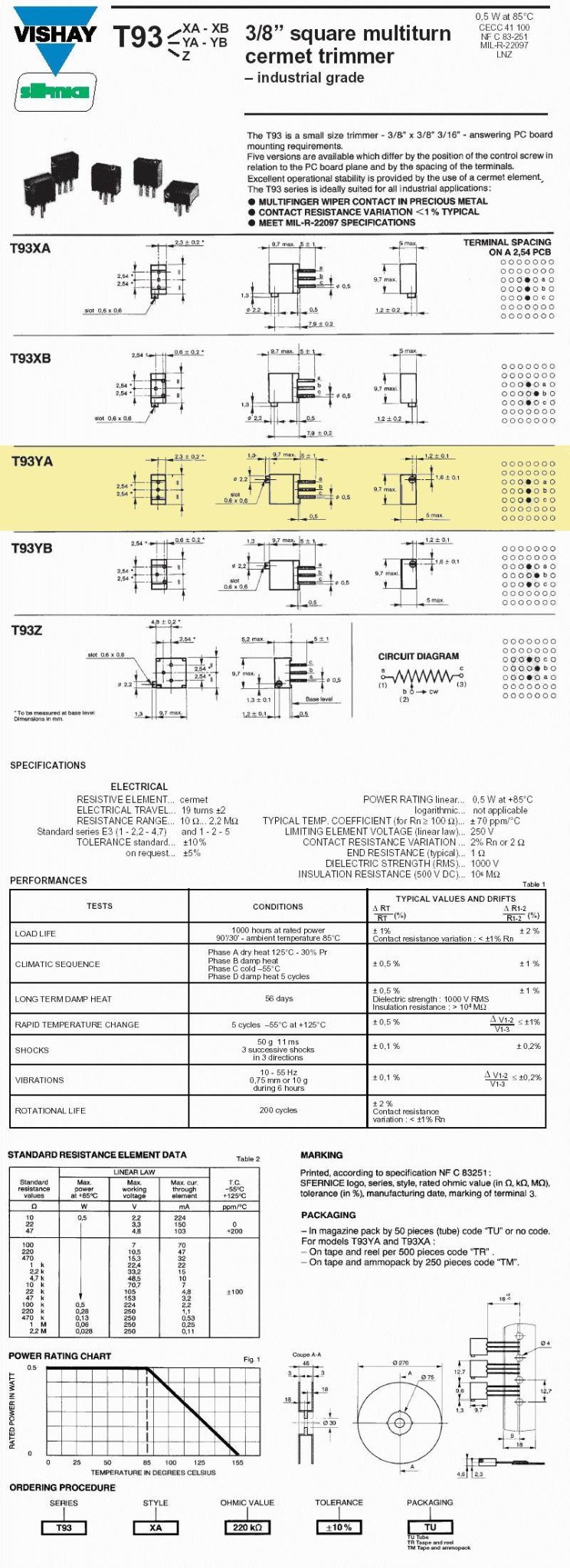

Cermet wont work for the job , I have use them for the 2 mA biais at the TDA output , result is not very stable , the one who would work are the Vishay 1280 G series but they come at 30/40 euro each , you'd better fit some UKL caps on your board , as you said before they have negligible DNL error
not to mention the cost of the 8 highly stable résistors you need
Thanks for the advice on the trimmer choice.
