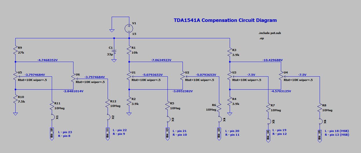

Hi you've gotten me very curious about this circuit. Kudos. I've been playing & tweaking my AyA for years.Compensation circuit diagram.
Its on S1 chip & wondering if further improvement can be had. So your saying to apply null only at these 8 pins
with a -15v supply. What about the bypass caps, does it stay or removed. Thanks again for sharing. Btw I've tested
The compensation circuit is an add-on. The 10M resistors go directly to the DEM filter pins, the capacitors will remain as they are.

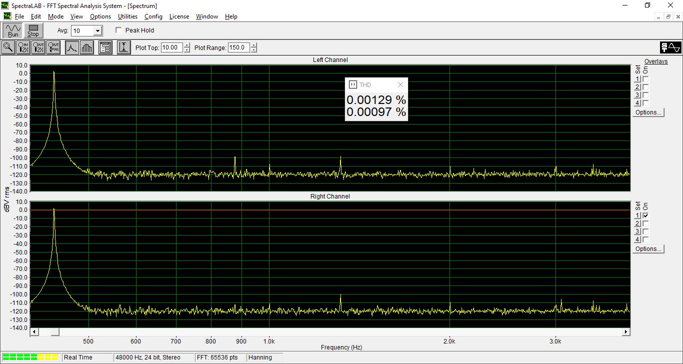

Sorry I dont, in terms of SQ it is immediately obvious but after burn in, leaps even further.@sumotan, Do you have FFT measurements of the KZ setup it will be interresting to see how they behave in real life
you just have to try it
After any change in my setup I normaly make measurements before listennig session to avoid bias of any kind
good measurements are not straight to great sound , but great sound never comes from bad measurements 😉
the UKZ 100 uf / 50 v are to big for my board , but if I will try I will post measurements for you all 🙂

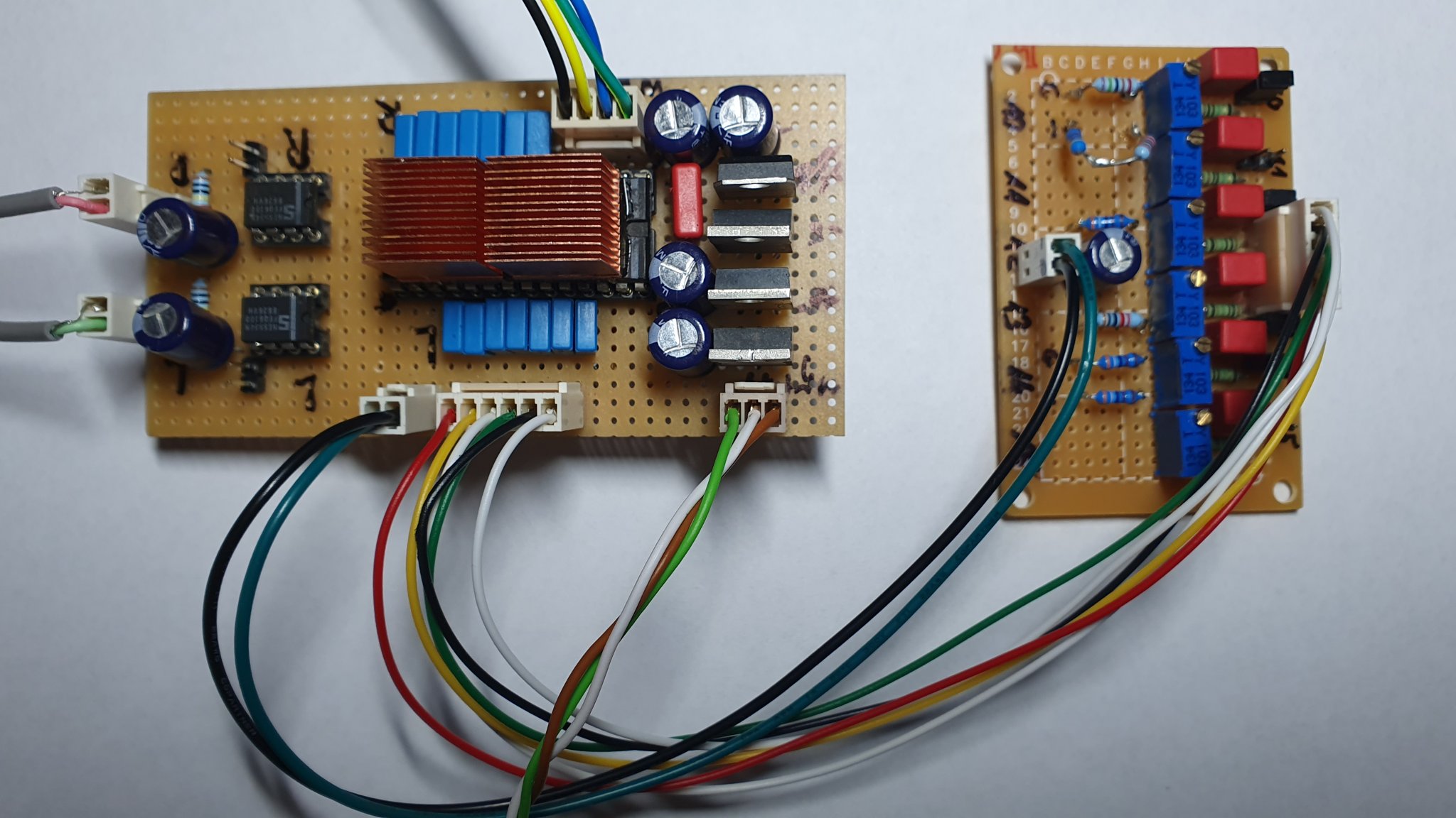

If you want to compensate all 6 bits, here is the full diagram. X1 to X6 are removable jumpers.

I can assure you it is not sensitive to EMF pickup. One side of the 10M resistor goes to a relatively low impedance point, the wiper of the trimmer. The other side with the long wire goes to the decoupling capacitor, which is again shunting any RF and mains pickup.Why would it be cost prohibitive Fabrice. It's just trim ports & resistors.

The -15V is available at pin 15.

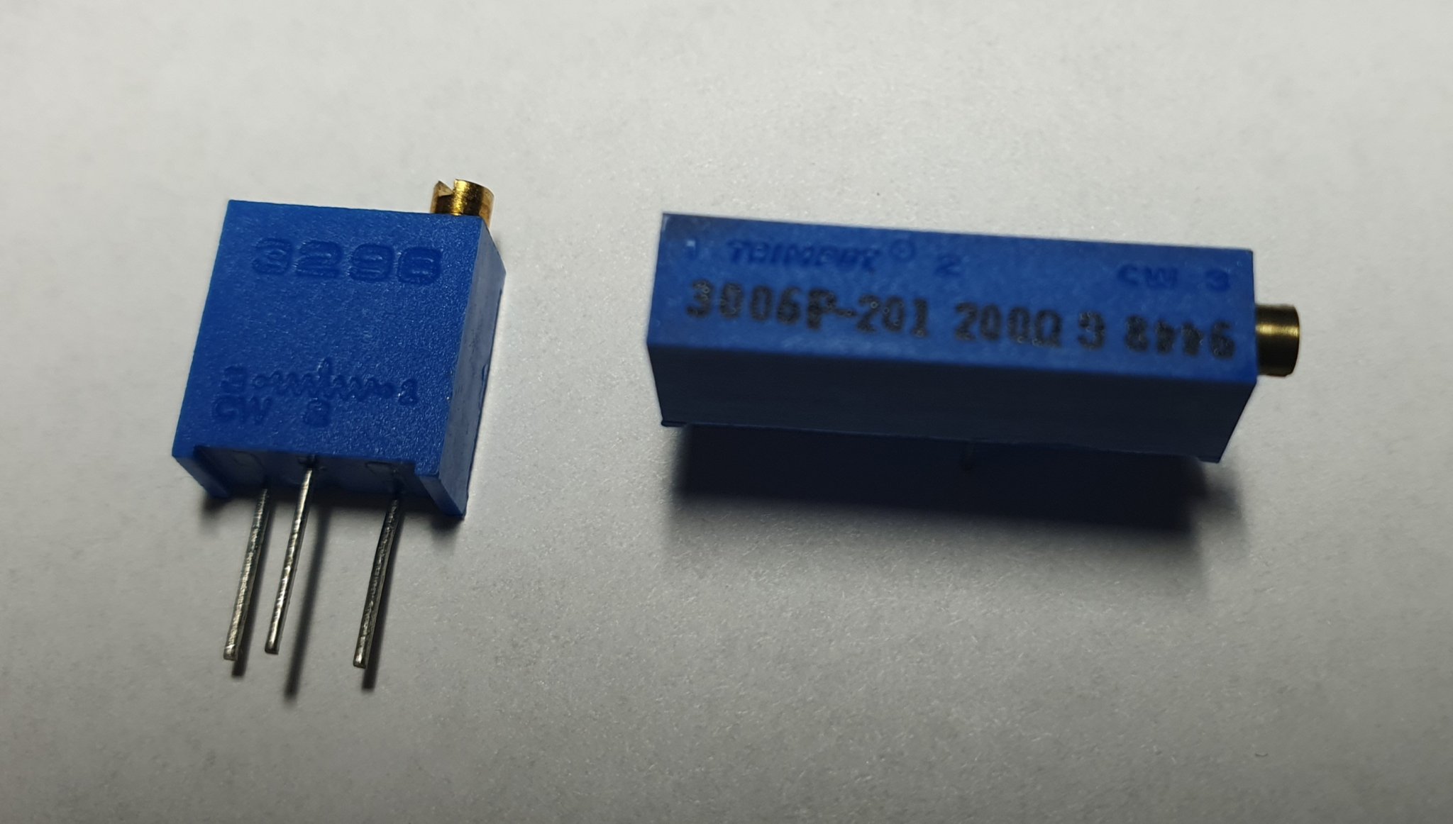

I haven't found any stability issue with Bourns 3296, the horizontal type should be good, too.
https://www.bourns.com/pdfs/3296.pdf

There was a warmup period, after that distortion was stable and low.

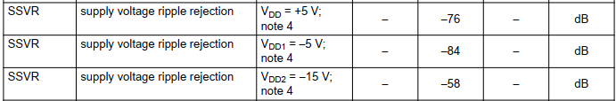

-15V still has around 60dB ripple rejection.
So 1mV noise between AGND & -15V translates into around 1uV output noise re 2V or -126dB.
So we want quiet supplies but no need to to chase 1nV|/Hz.

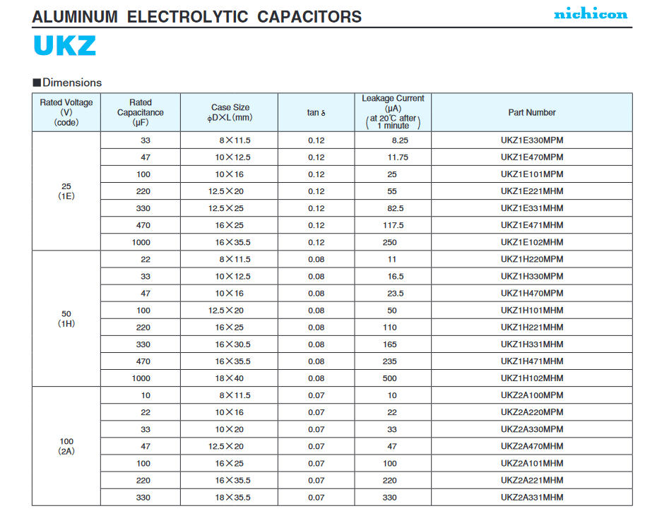

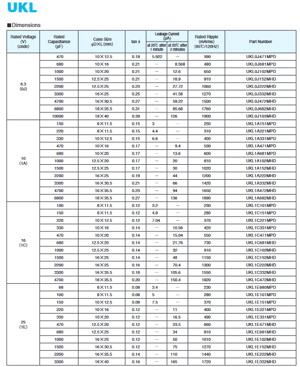

In the UKZ 100 uF value: The 25V has the lowest leakage. The 100V the least ESR but that is of a less importance here for the 14 DEMs.
Just story to show something big !
Yes I noticed too but please be careful: the leakage current of a capacitor is defined as the current flowing while Rated Voltage is applied accross the terminals.
In the same time, we know that leakage current increase with applied voltage!
So the difference You perceive in the datasheet is that the higher voltage units are tested at... higher (rated) voltages!
I bet the reality is instead that at the same test voltage the higher rated caps would show nicely less leakage current..
Ciao, George
Ciao, George
Inductance, won by the 25V/50V VS the 100V (for UKZ for whom who like it) due to the non usual bigger space pin of the 100V at Nichicon.
UKLs have of course very low leakage but even lowest inductance choice. I surmise we have to choose the UKL 16V cause in 10V the first value is 150 uF. A pity we have not more value choice at 10V (DEM is 7V around with normal conf, then T. gave the V values with its screen cap by cap DEM pin.
