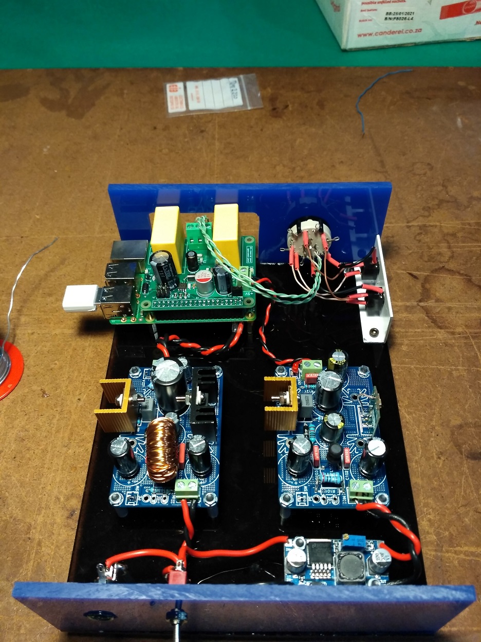

And this is how my DAC looks now in a very basic open enclosure. I have two outputs - one to my main amp and one to my headamp. But for me it is not about the looks or the enclosure - but the sound. I still love the sound!

Hi twocents, nice work there! Can you explain a bit more about your PSU setup? I see two JPS64 boards (XRK's design?) and a little boost module in the case. How is the noise performance? Also curious if you have compared the SQ of the RPi stack with your earlier Amanero-fed setup.
My setup has changed slightly since the last photo (in the post above) and I would not know how good/bad (or noise free) it really is – I cannot measure it or compare it to something else. I am not so clued up on low noise, linear vs smps PSUs. I simply used what I had in hand, and yes, I use two JPS64 PSU boards which I got as a generous gift from member xrk971. In fact, I received so many generous gifts for this project, including the HAT DAC board from Matt Garman, the Raspberry Pi 2B and the TPS7A4701 LDO from fellow audio friends. The Low-Noise PSU boards can be ordered here:
GB for Simple Cap-Mx Regulated Low-Noise PSU
And one can play around with different regulators using this board.
The little booster board in the photo is actually a DC-DC step down converter I used initially for testing before the PSU boards were up and running. It serves no purpose here and I have since removed it. I now have the the two Low-Noise PSU boards, each one fed from its own smps as follows:
Samsung 14V 1.8A smps -> PSU board with a LT1085CT-5 regulator and larger 2A inductor -> Rpi (via the GPIO pins)
Netgear 19V 1A wallwart -> PSU board with a TPS7A4701 LDO regulator -> HAT DAC board
Using this setup with my PCA headamp it is absolutely quiet- no hint of any noise on full volume. This DAC sounds best with this Class A amp and headphones. Absolutely gorgeous.
With my ACA + Aksa Lender preamp this setup is also dead quiet, but with my TDA7297 amp + B1 buffer I have ground loop issues and lots of noise.
Because I use such a mixture of different kinds of smps supplies to power each component, I have found that ground loop issues (or noise) are a result of this mix, since some supplies have an earth connection and some don’t. I am seriously planning on building an AC Filter, more info here:
