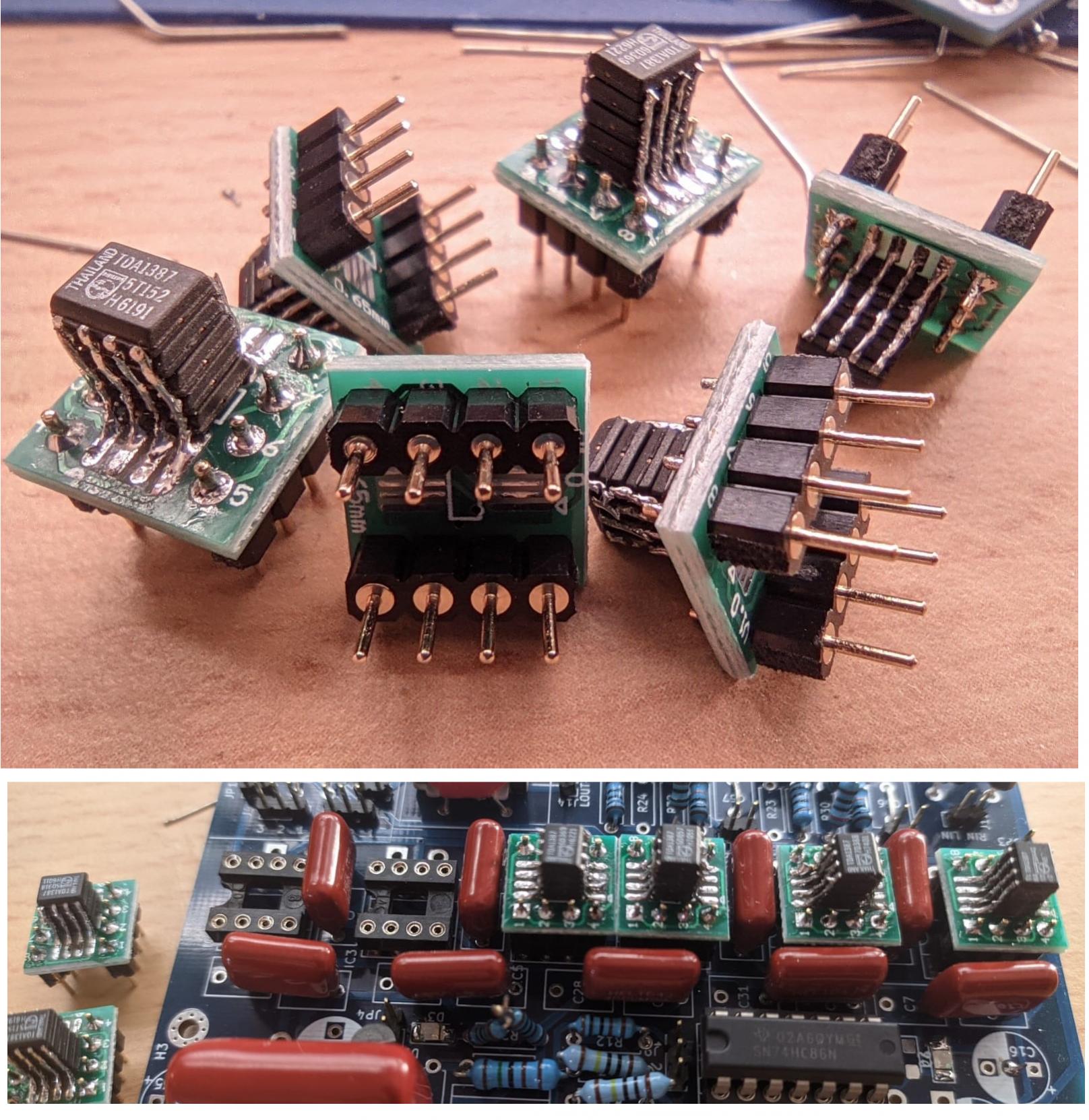

I did a tda1387 design with this sort of "quick release" system where you can have banks of tda1387 piggybacked, and just plug them in and out of sockets (if you want to experiment or change number of dacs or one goes bad of the bunch you can quickly get it out), so you're then working with dip and dont have to unsolder anything. Not sure about lead inductance or if you even gain that much in practice, since if you change the number of dacs other design parameters also change, this one has 30 converters. But i thought it was interesting anyway 😉
This dac is a pure test platform which is why i have not posted anything else yet. I am courious to compare with abraxalito's kubelik which is on the way.
(LCSC part numbers for the socket and pins are C9742 and C72129 if anyone is courious)

Those stacks look totally awesome! Have you run into any issues with decoupling so far?
How does it sound with 30 chips? I'm super-curious! Also - what's the I/V stage?

No issues, but the film caps i ended up using are physically a bit larger than the ones i planned to use when designing, but these ones have ESR under 0.1ohm, and i can just alternately solder them on the upside and bottom side of the PCB. The other film caps fit perfect but 1.1ohm ESR, the same as some original WIMA 100nf's i have.
Will test out all sorts of I/V's (passive, discrete, tube, opamp...) with it but still missing some components to complete everything. Building Jung/Didden super-reg as well to power everything so i guess im not done yet or come to some conclusion. Also built a TDA1541 dac, more stuff to compare to as i will test concurrently. More to come next week!

I have mounted the 1387 x 8 module on an RPi HAT protoboard. I used DIP pin sockets for the module (two rows of six), in case I needed to remove the module and get board access in a design change. I also plan to use sockets for the IV resistors and the Vcc cap (from stellarelephant), which I think is an excellent idea for easily swapping out critical parts. I am currently using an RN70 metal film IV resistor, and I have acquired some metal foil resistors to try (Vishay RNC90). The only downside with sockets that I have encountered in the past, is that they can develop poor contact in time, and potentially generate noise. Coupling caps are 10uF CRC polycarbonate (definitely off board, too large for board mounting), but I would also like to try others that I have. I am still not using any output low pass filtering. I am using a China LT1963 7805 module mounted to the HAT on the 5V rail (with a filtered 6V SMPS), with added electrolytic caps, since the ceramic caps on the module are inadequate based on my read of the data sheet. I think the LT1963 sounds about as good as the slightly modded China Jung/Didden-esq board that I have tried.
