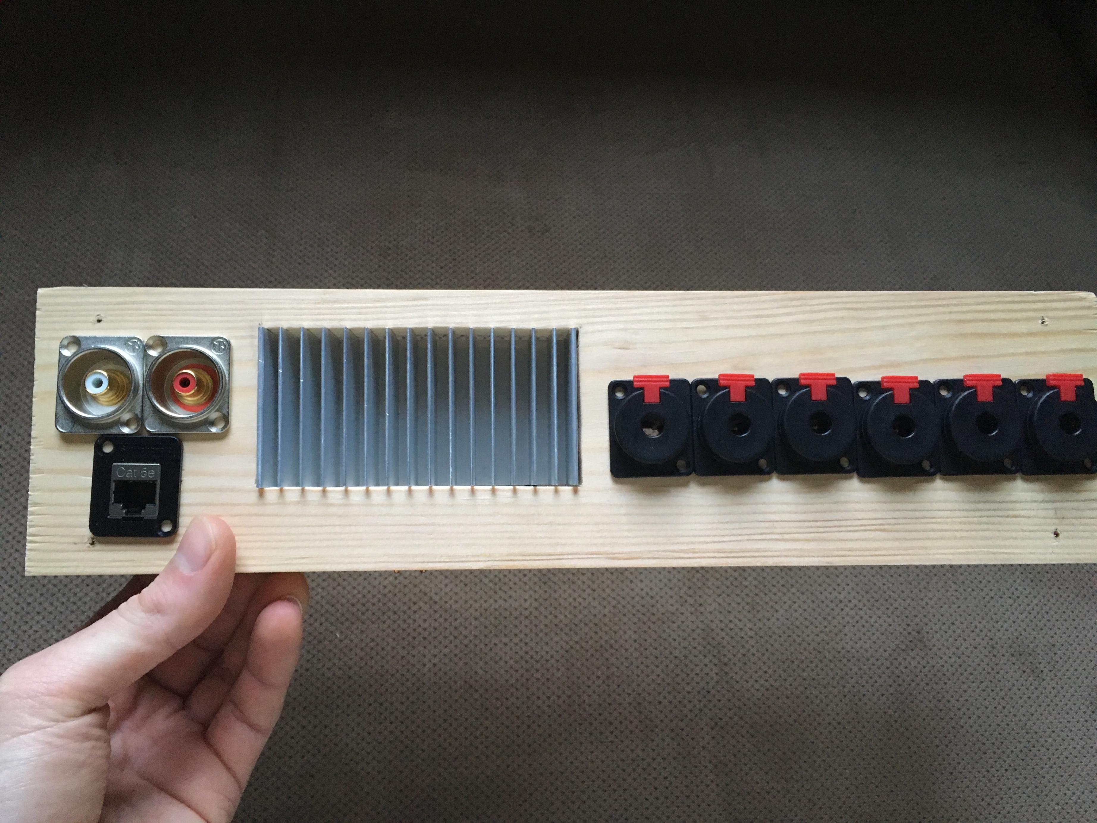

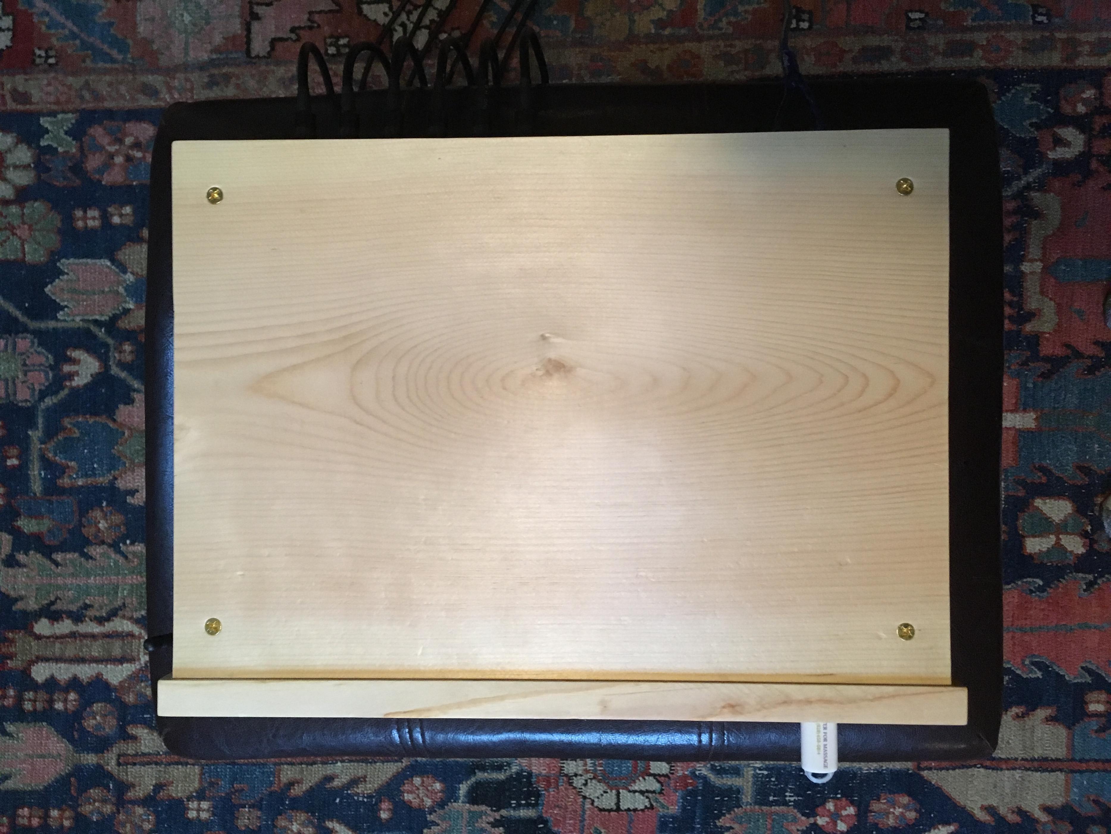

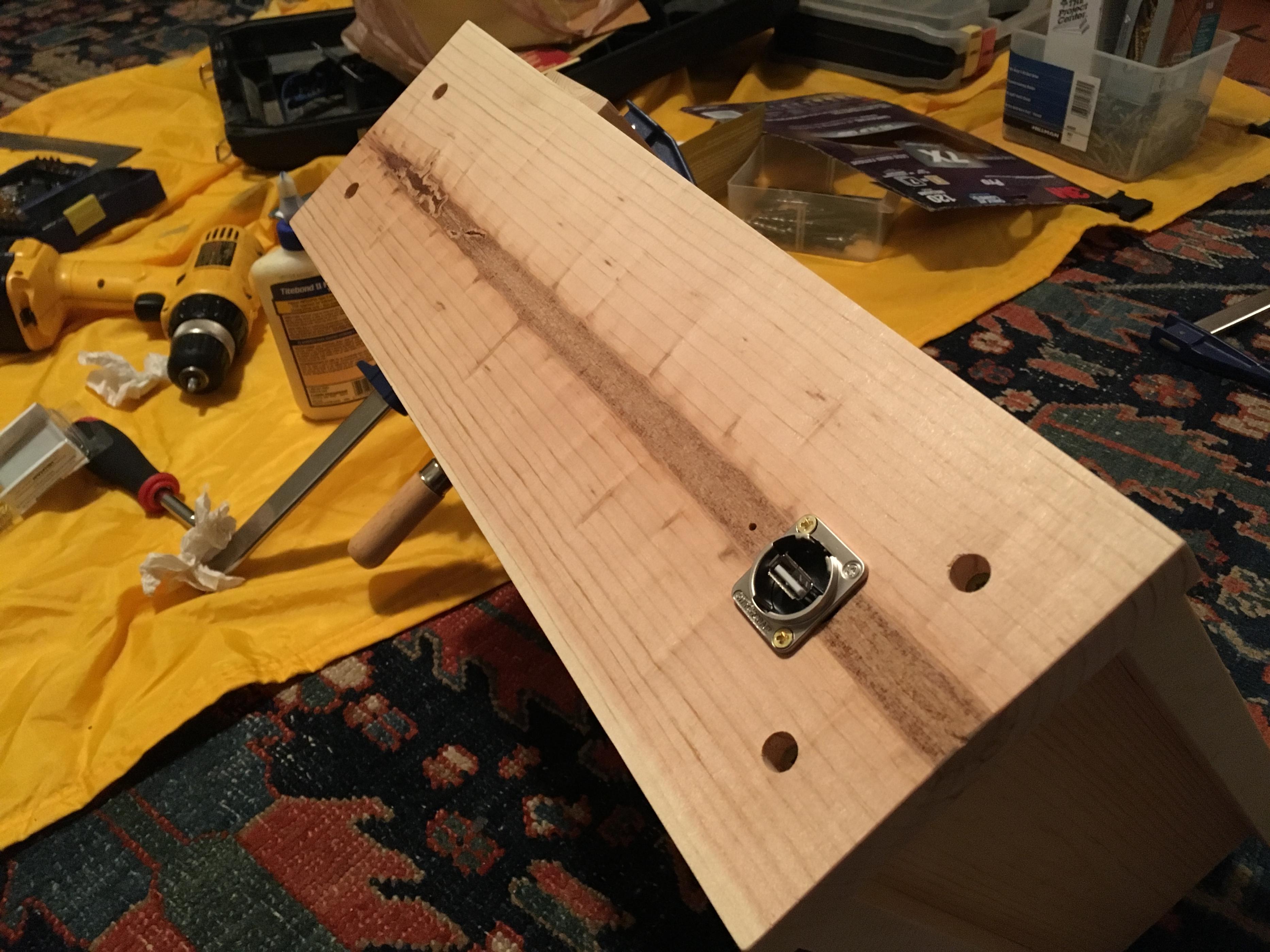

Finally began building a case for my Garman DAC RPi player. Lots of fun with the Forster bits and jigsaw today.
All the 1/4" jacks are for isolated DC feeds coming in from separate Jameco linear supplies. The heat sink is for the LT3042 board that feeds the RPi.

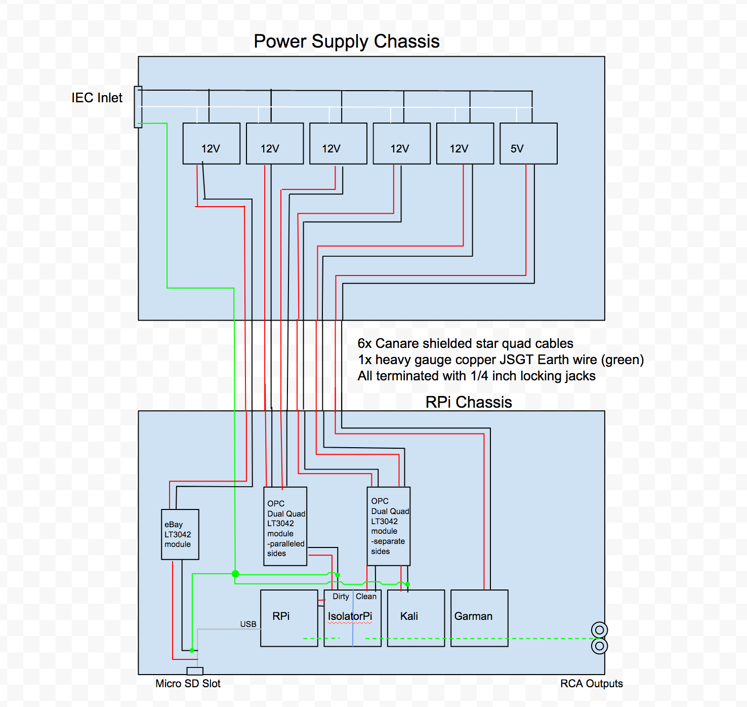

Yeah, it's ridiculous. Here's the diagram of the power and grounding scheme for the various boards inside. Only change to this is that I won't actually be using a dedicated cable for the JSGT earth cable. That seemed too extreme...my power cables are all Canare TRS with an unused shield, so I'm just going to use one of the braided copper shields as the earth wire. A very patient friend schooled me on star grounding for this project 😉.

Haha, the diagram is helpful, to visualize the insanity, haha.

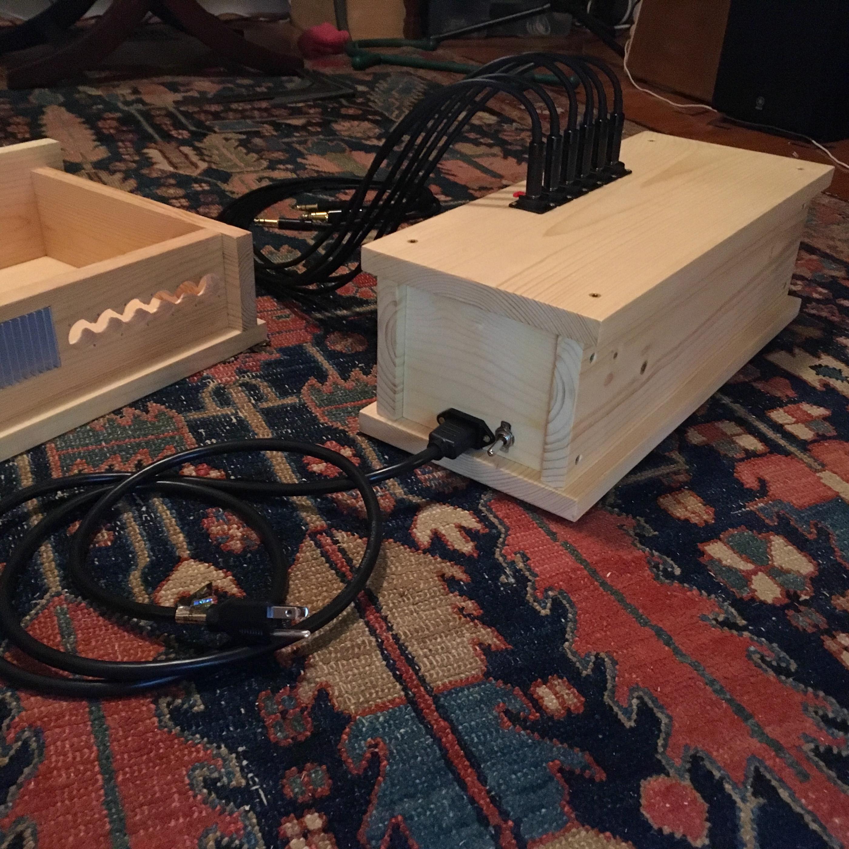

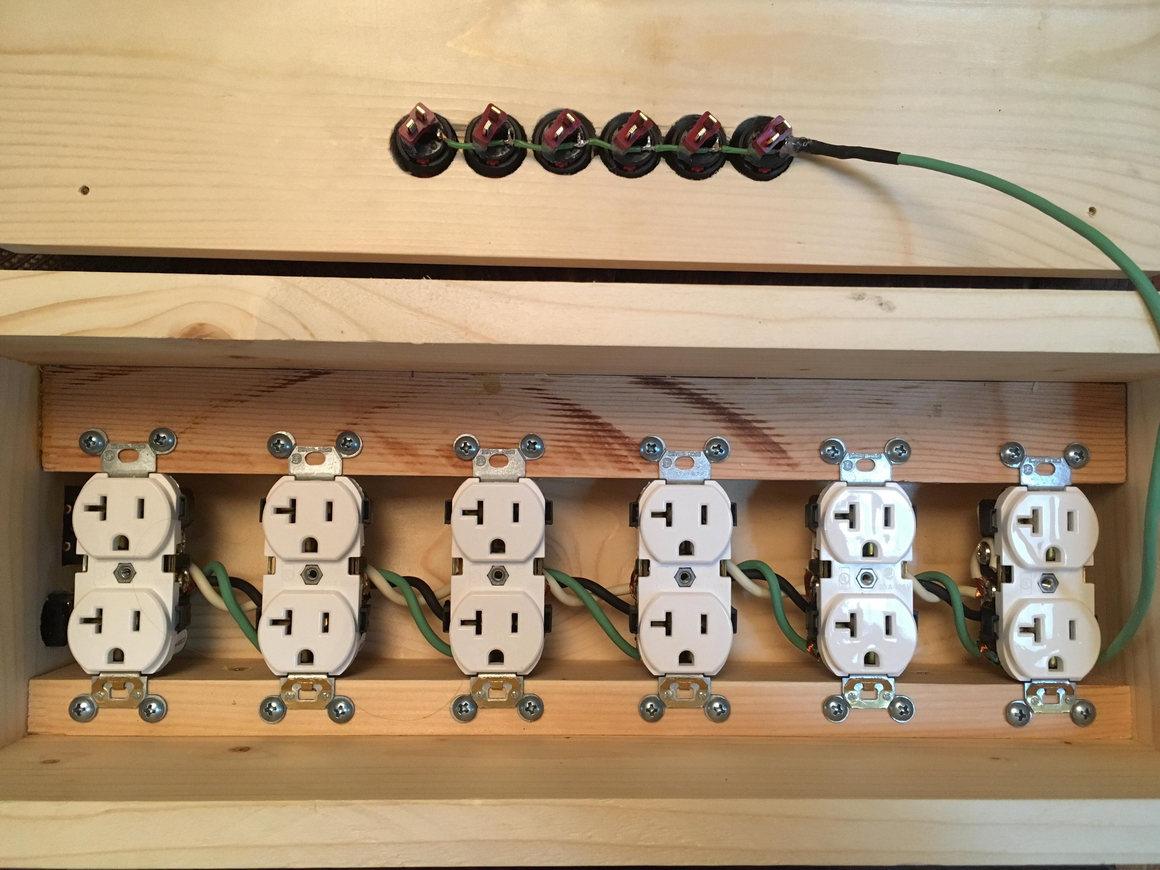

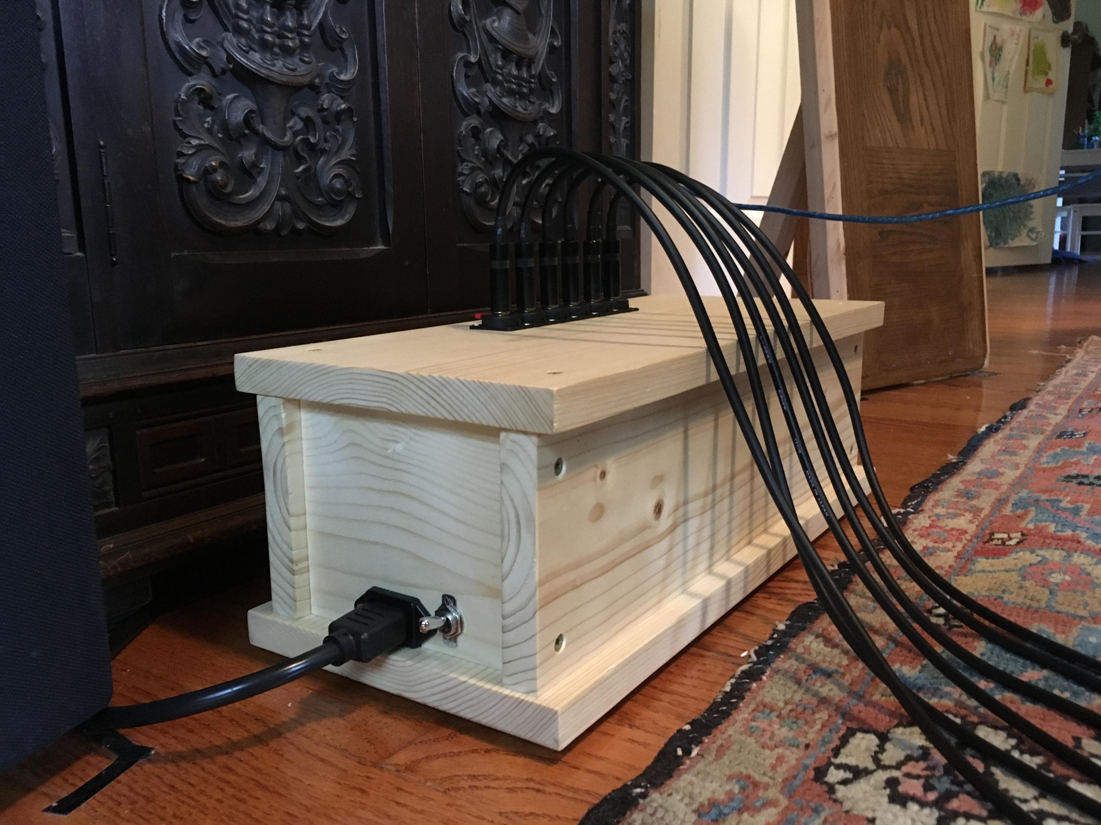

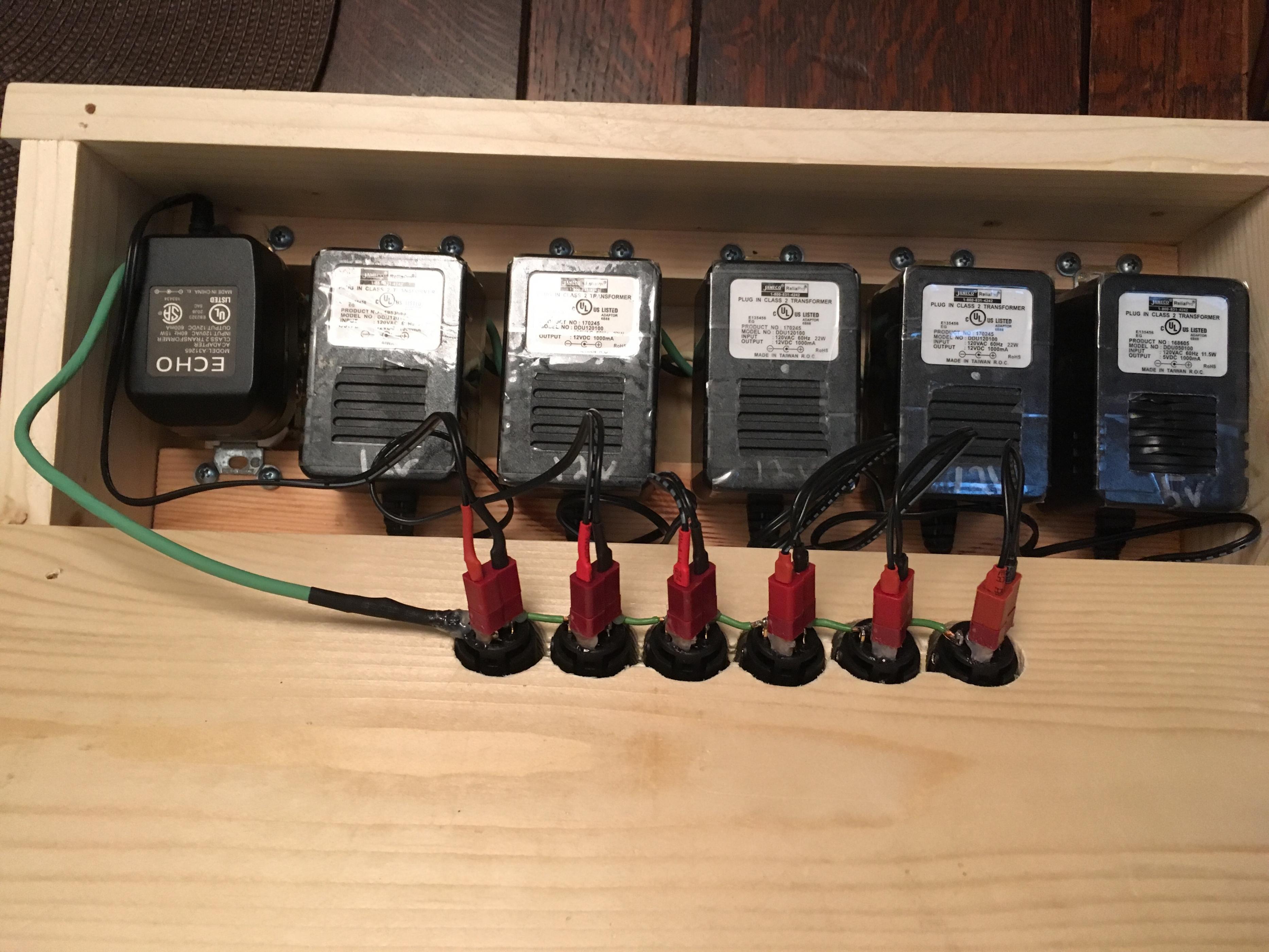

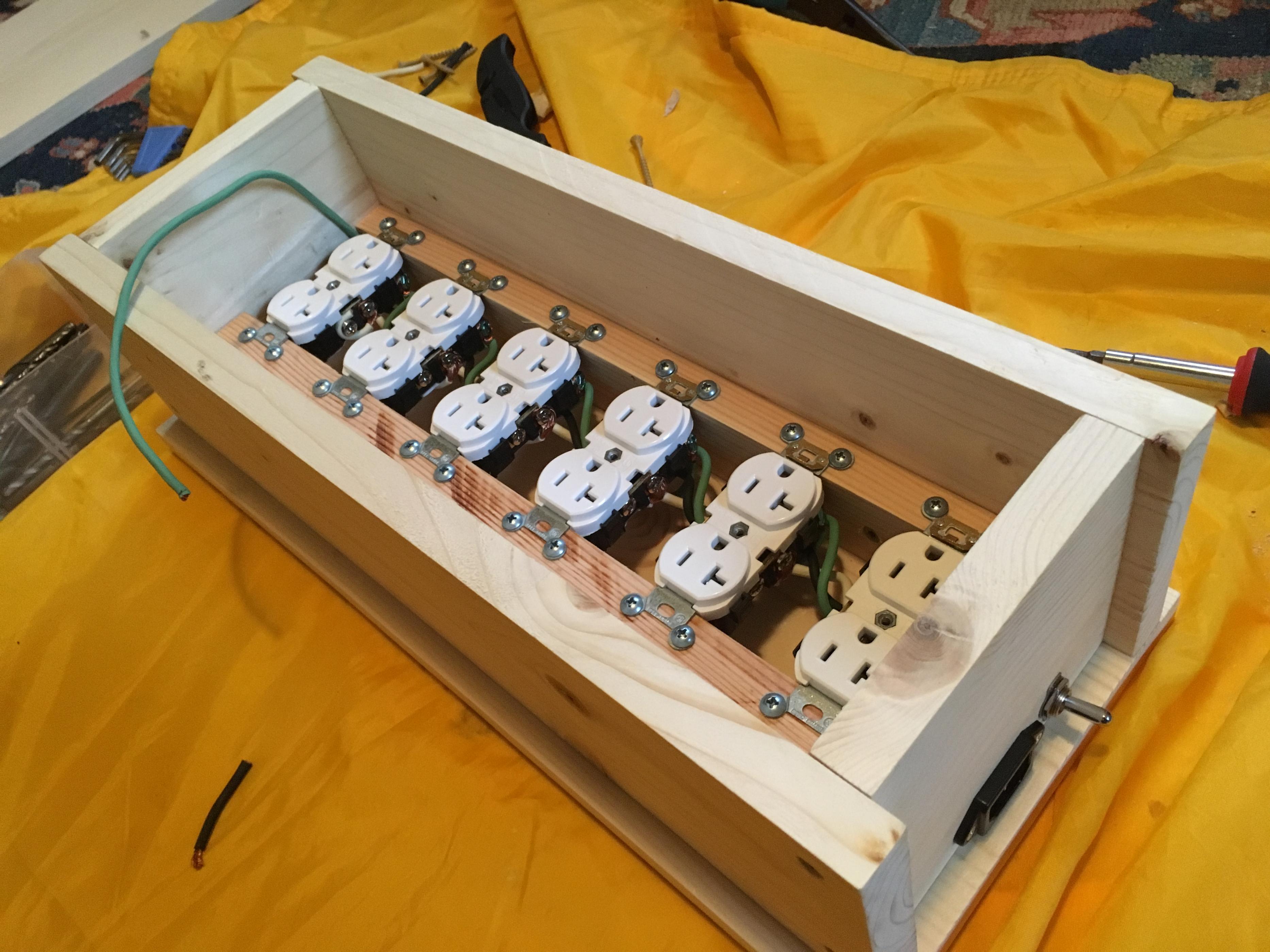

Made some progress on the separate PSU box today. Its a glorified power strip for plugging in all my Jameco wall warts, with an IEC inlet, switch, and 6x 1/4" jacks in the lid for DC out.

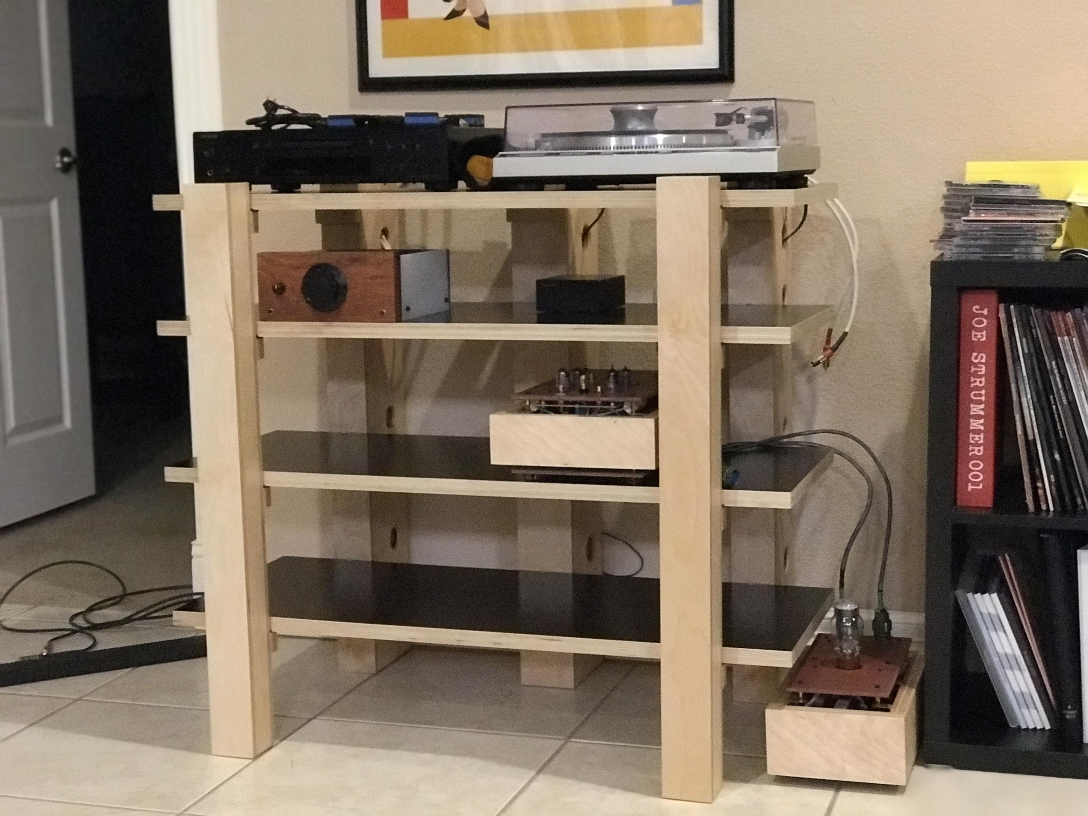

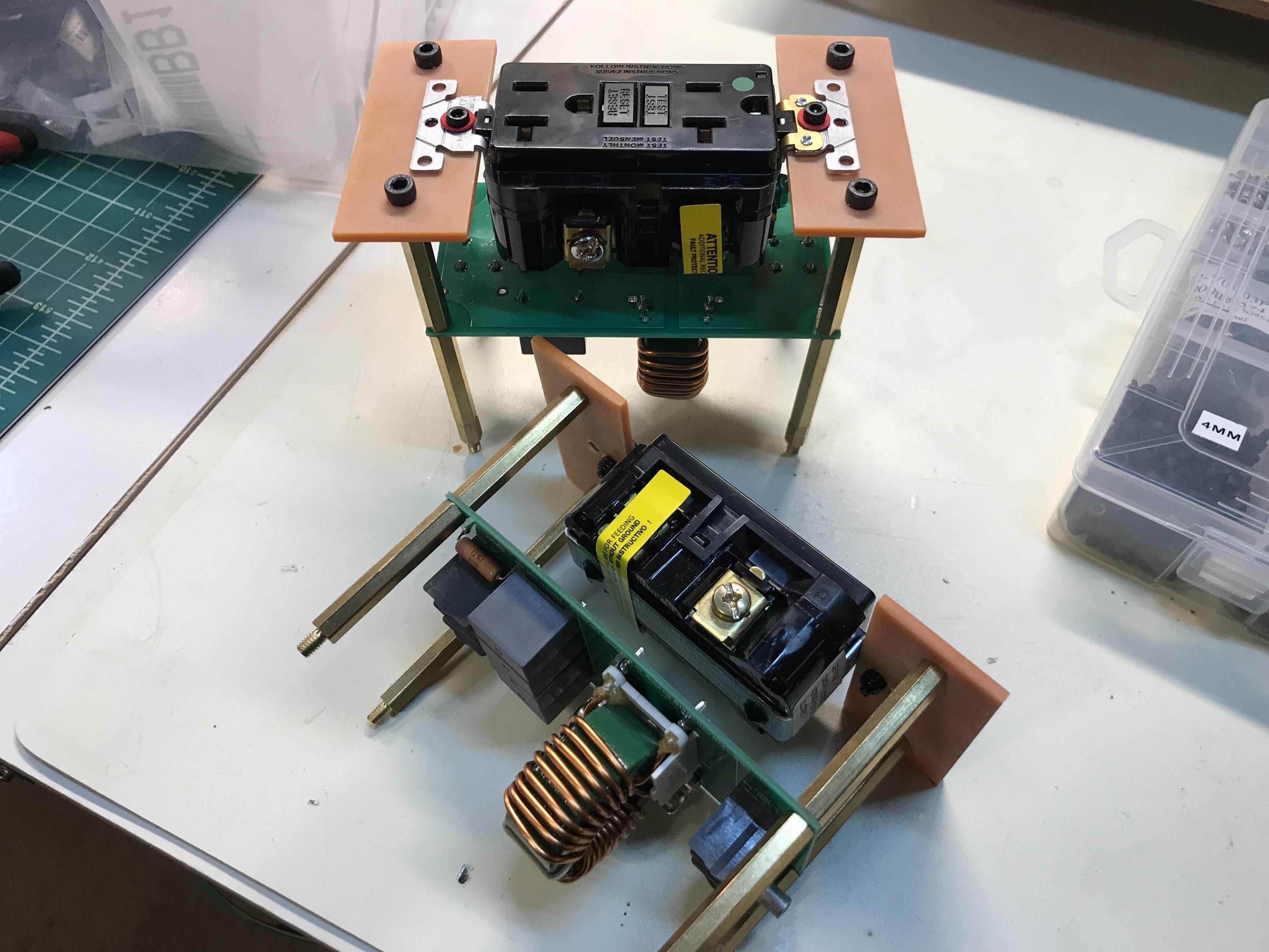

Have you seen the fofelix power filter group buys? I bet you could fit one in there. I've built a few of them, and really like them. My new equipment rack is going to get a pair built in to the bottom, when I get off my butt and knock that out 🙂

Nice. That filter looks like something that could go in the wall, too. I tried a simple CLC filter in front of my old power strip for this DAC, and couldn't hear any difference. Which surprised me...because I can clearly hear differences between power supplies. Maybe I have clean AC?
You might, I sure as heck don't. 🙂
I think it would fit in a big duplex box in the wall, not sure about cooling requirements. I can't remember off-hand.

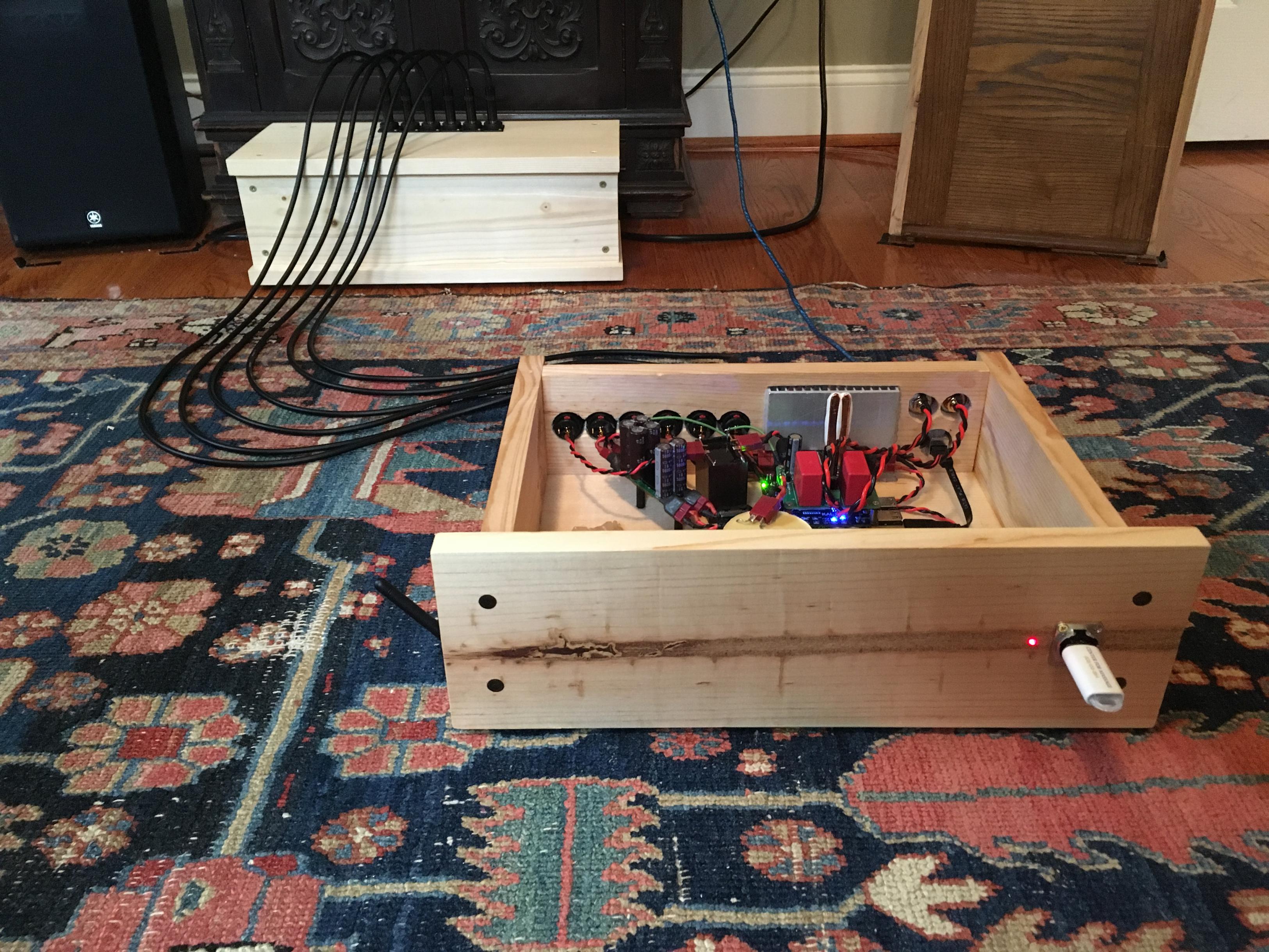

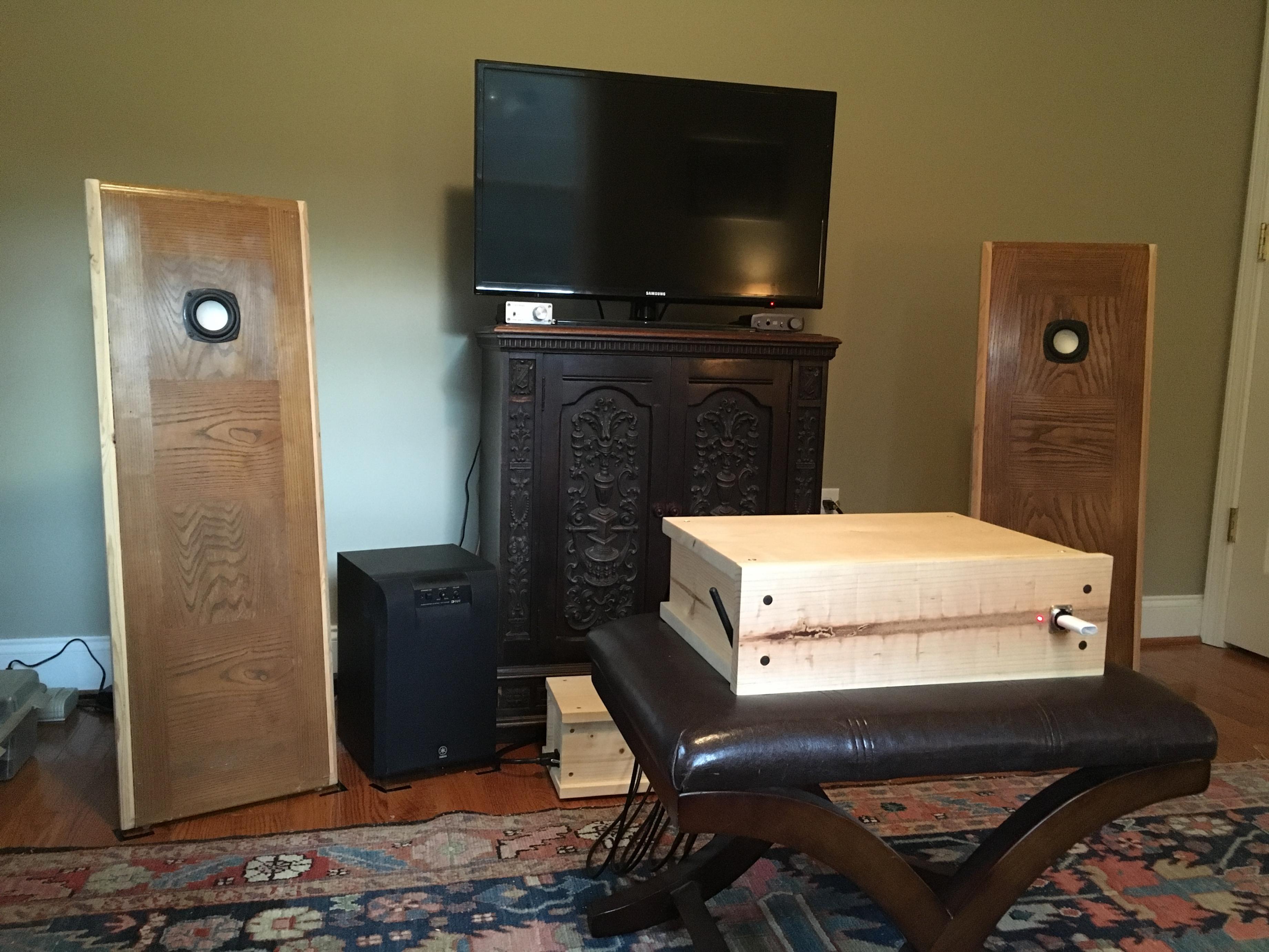

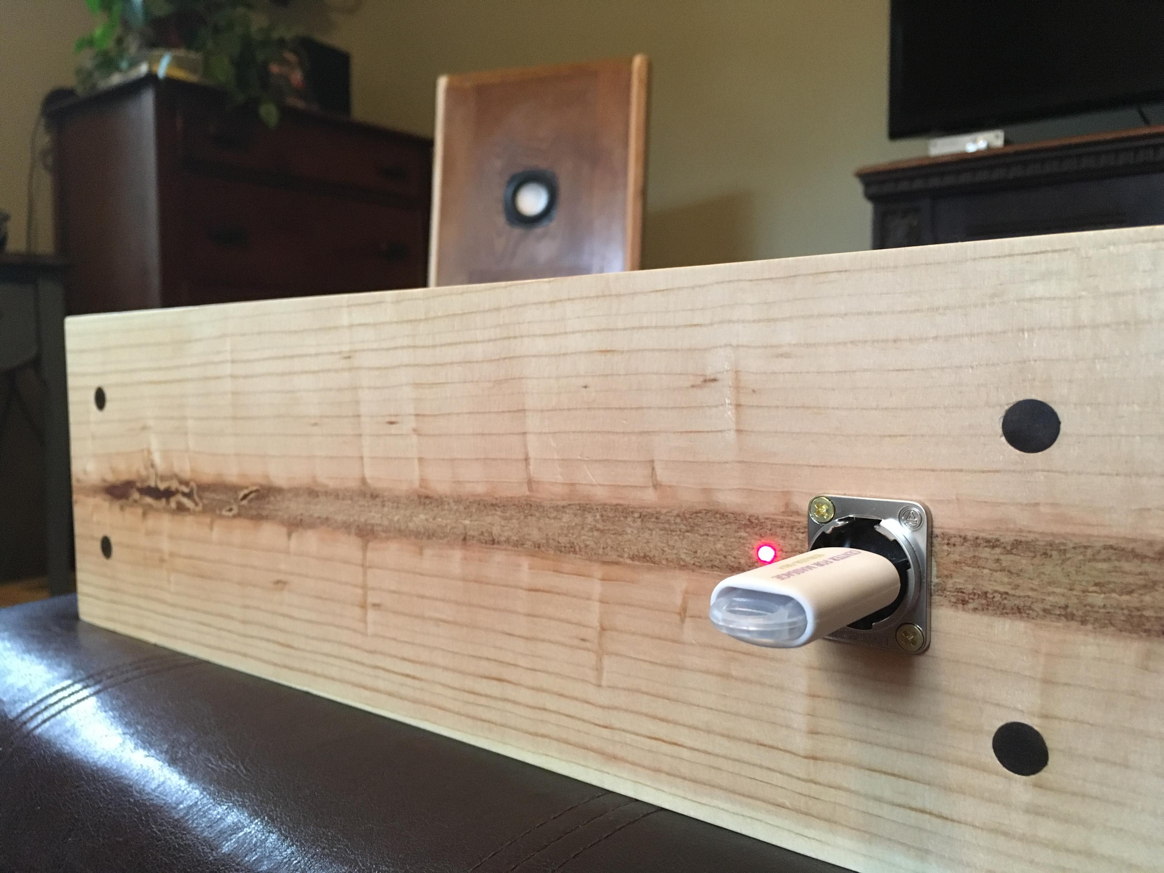

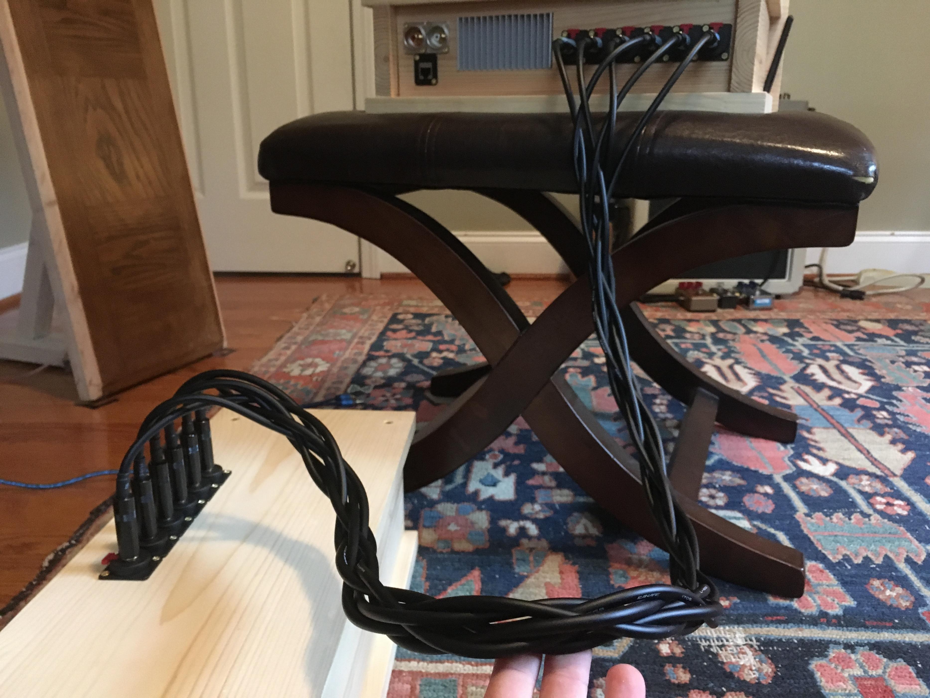

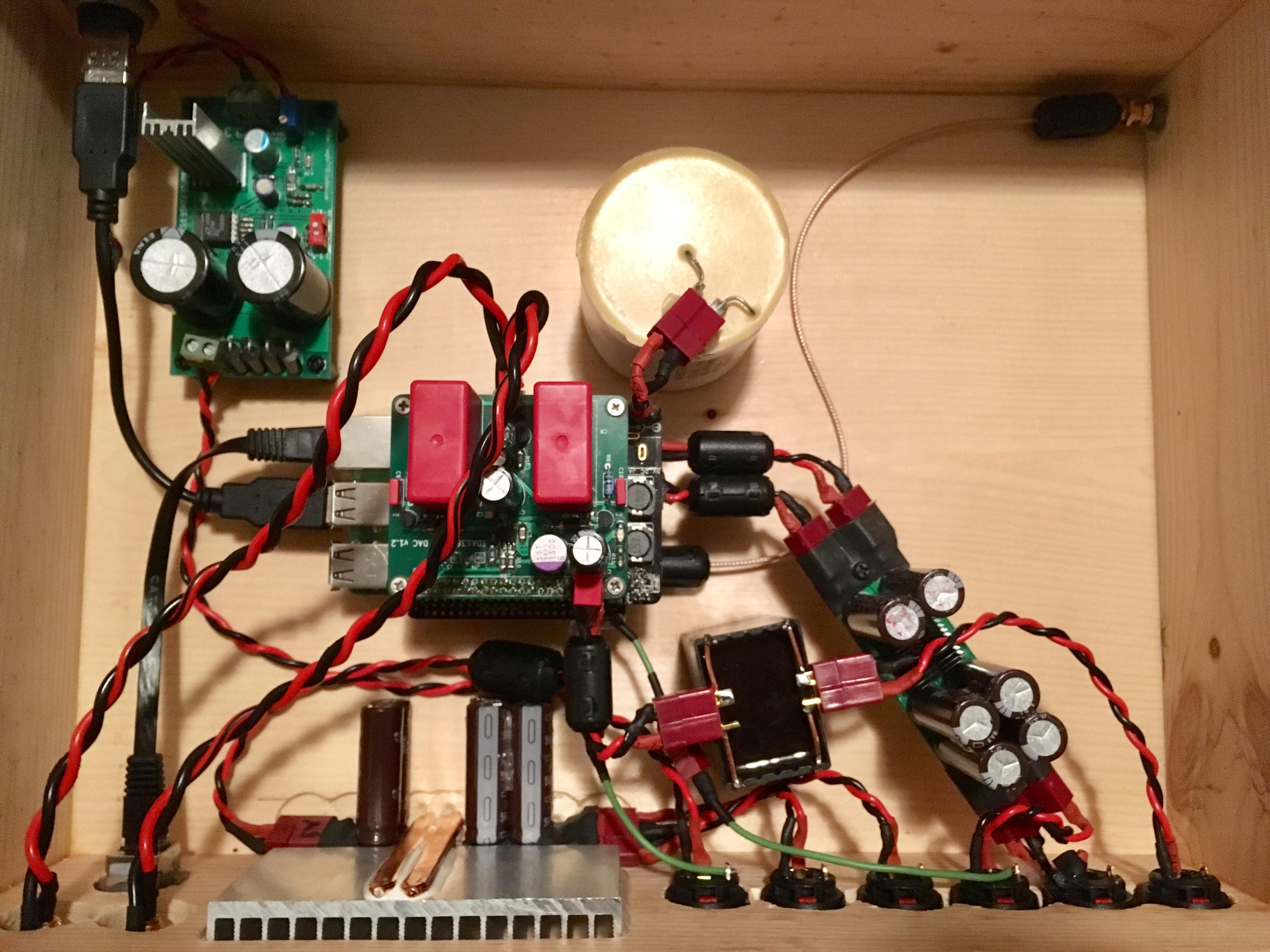

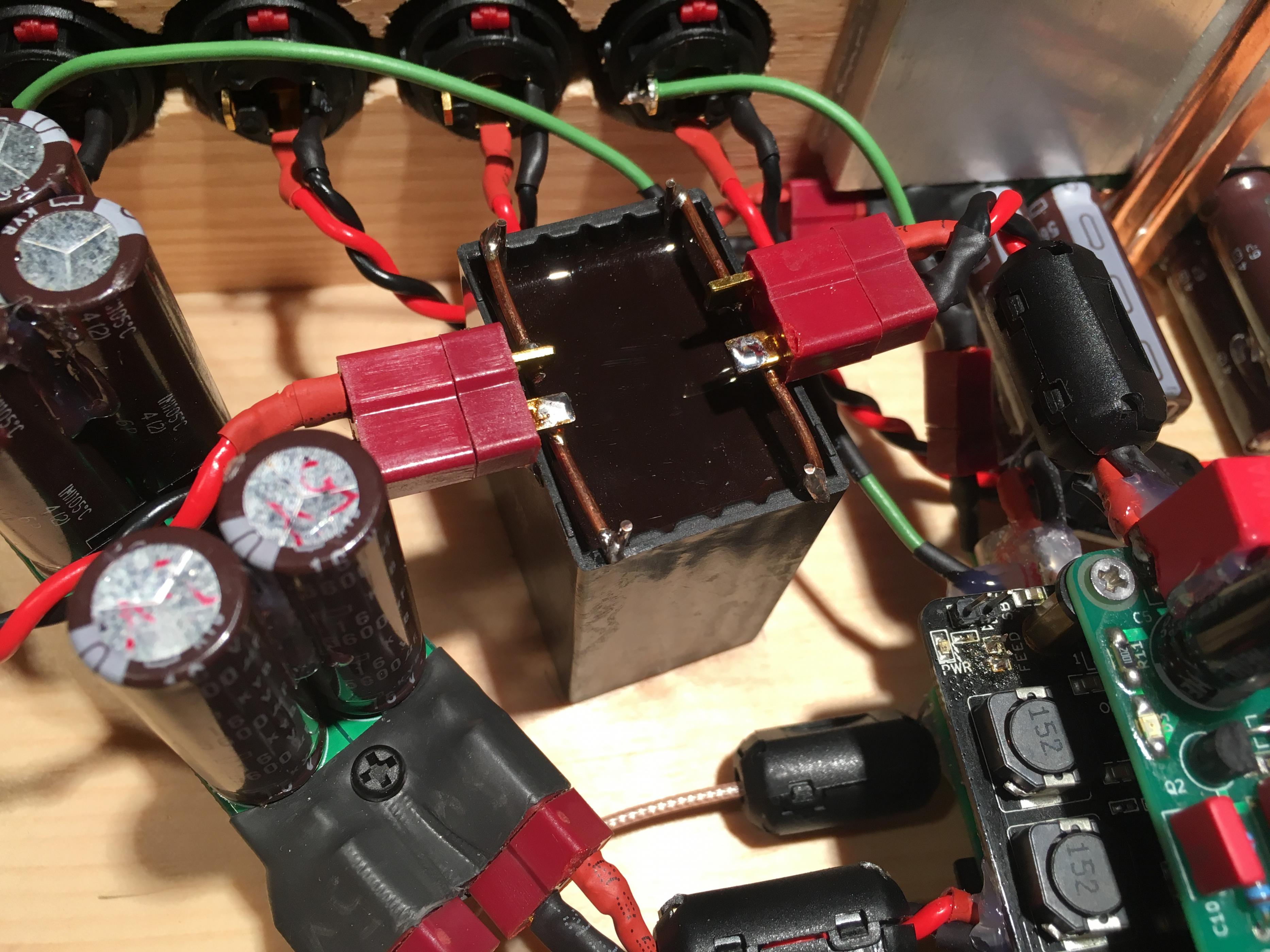

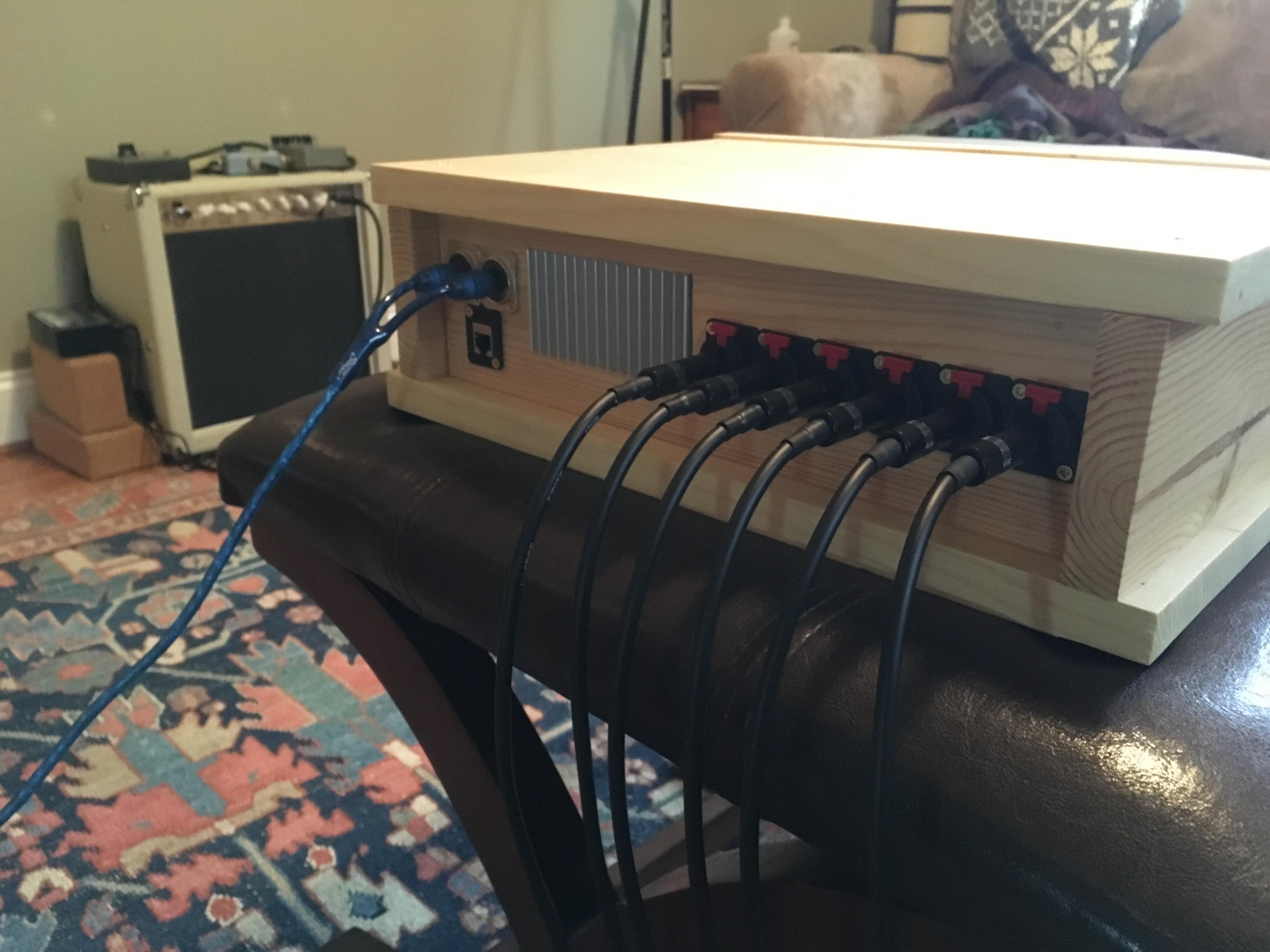

The power box is up and running. I drilled a few ventilation holes just under the lid on the back. I am using these high current model aviation "Deans" connectors (which Greg Stewart turned me on to) for linking the wall warts to the 1/4" jacks, and I will be using more on the RPi end. I love the easy-swap modular nature of the RPi as a music player, and I'm extending that theme to the power components as well. Perhaps I'll attempt a six strand round braid to tidy up the cable bundle? Hoping to stuff the player box tonight.

That looks awesome! Plus I love that I can see your Monoprice guitar amp in the background of one pic. 🙂
Since your enclosures are wood, have you thought about lining their interiors with something conductive, like copper tape, and routing that to earth? Unlikely to make an audible difference, but the shielding might give you some warm fuzzy feelings.
Thanks, Matt! I have indeed thought about copper foil lining. As is, the output is very quiet. The transformers are a few feet away now, and the RPi is modified with an external antenna. I also have ferrites clipped onto every power lead just before the load. And yet...that extra bit of "warm fuzzy feeling" always beckons 🙂 I still have to finish building up the newest revision of this DAC, for instance! But I think I'll rest on my laurels a few days, first. 😀

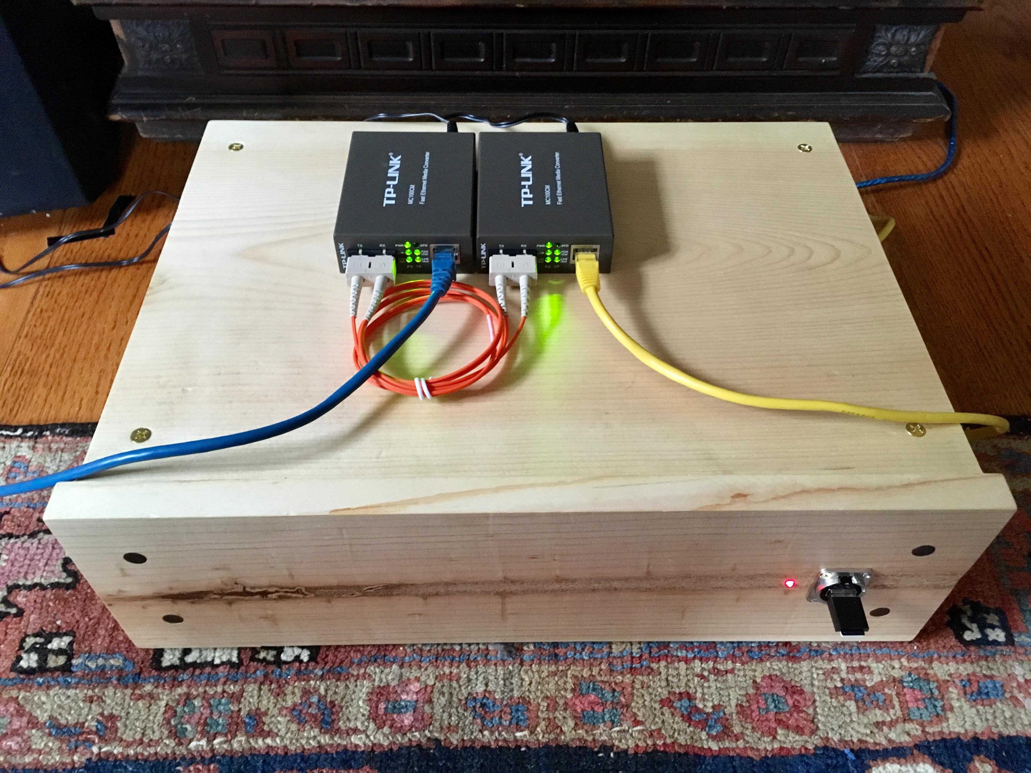

Greg Stewart has kindly provided me with a pair of fiber media converters to test with my system. I've just hooked them up. So I'm now listening for a difference between a direct wired connection to my router and an optically isolated connection. If there is one, it is subtle. 🙂
