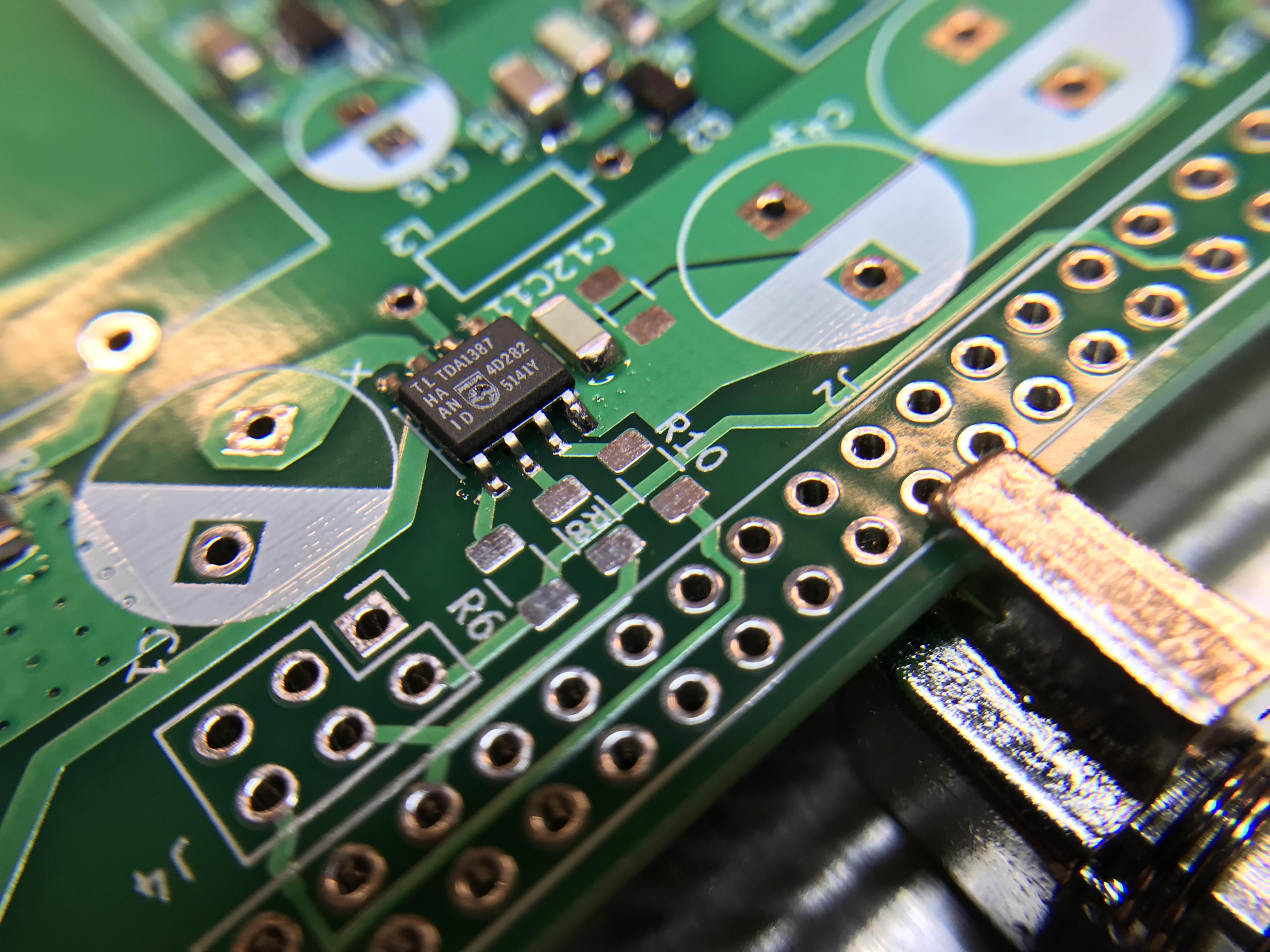

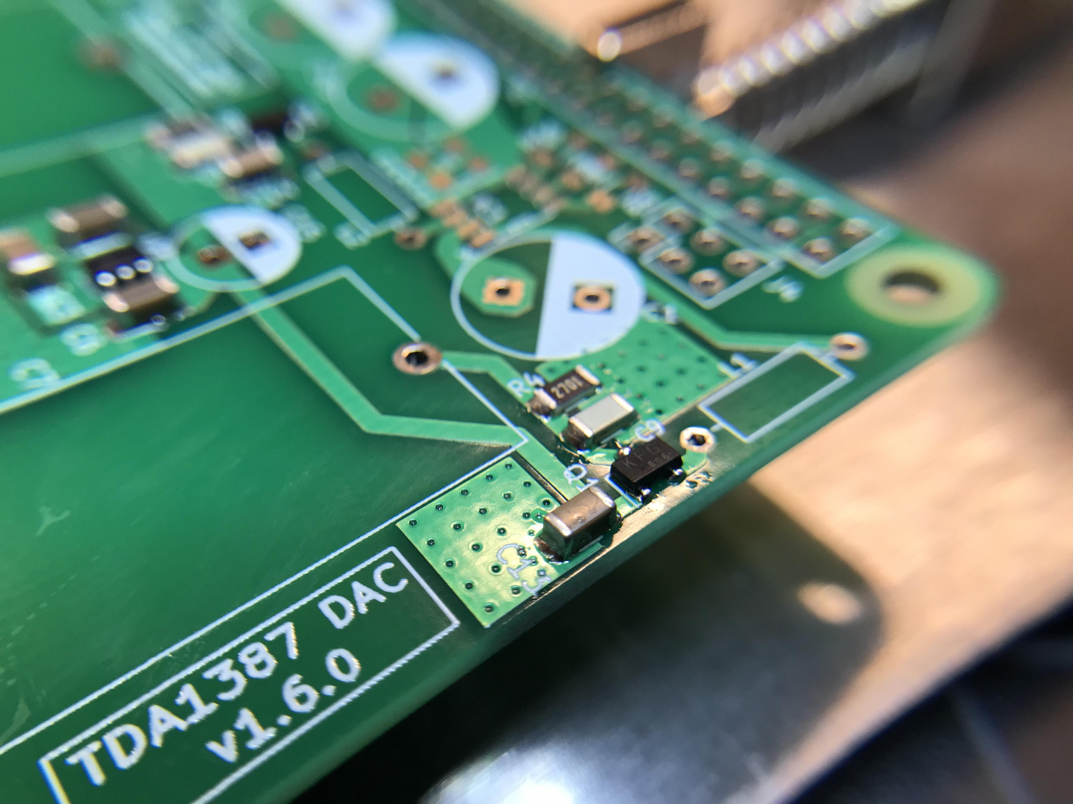

Some good news - I finished populating my board last night, beating pcgab to it.
The bad news - only the left channel is working. I quickly hooked it up to a Amanero for testing. I strongly suspect the problem lies with Q1 - one of the J327s. I had a bad feeling after soldering this component. Any ideas how I can trace or confirm this fault?

Problem solved! Thank you very much abraxalito for your advice. I actually found two dry joints on the right channel. All is good now and I am absolutely ecstatic.

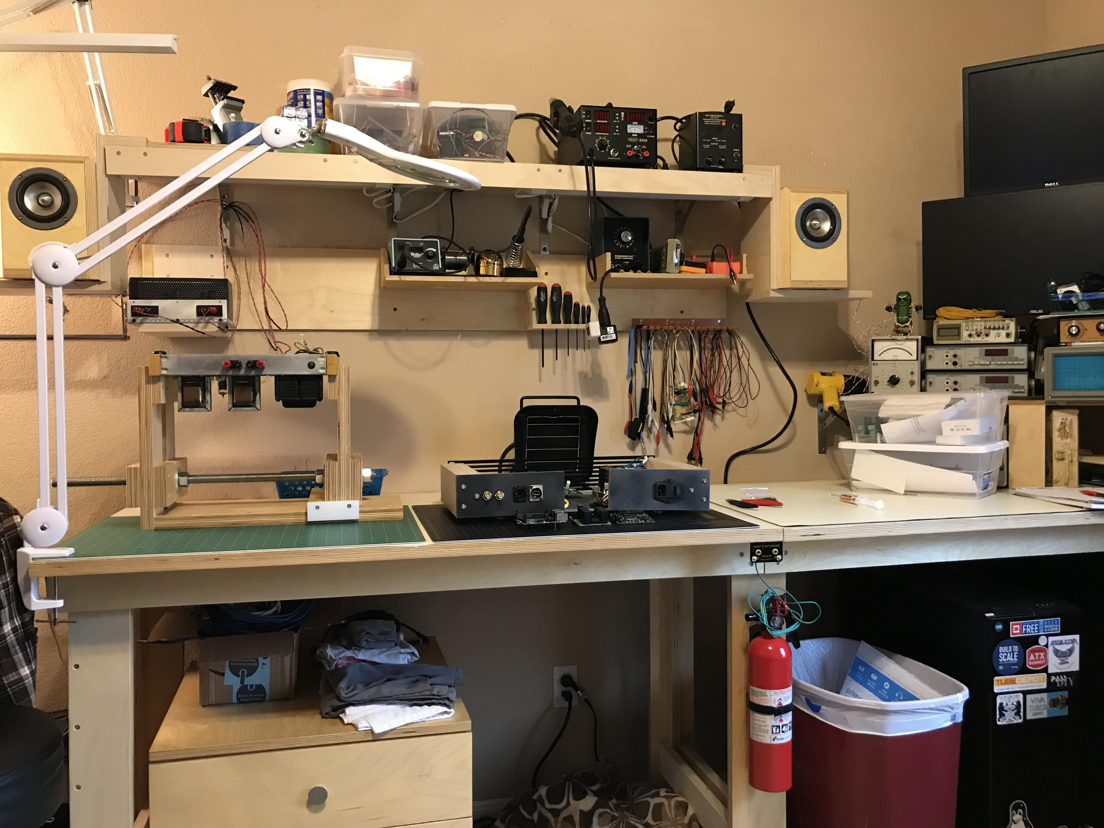

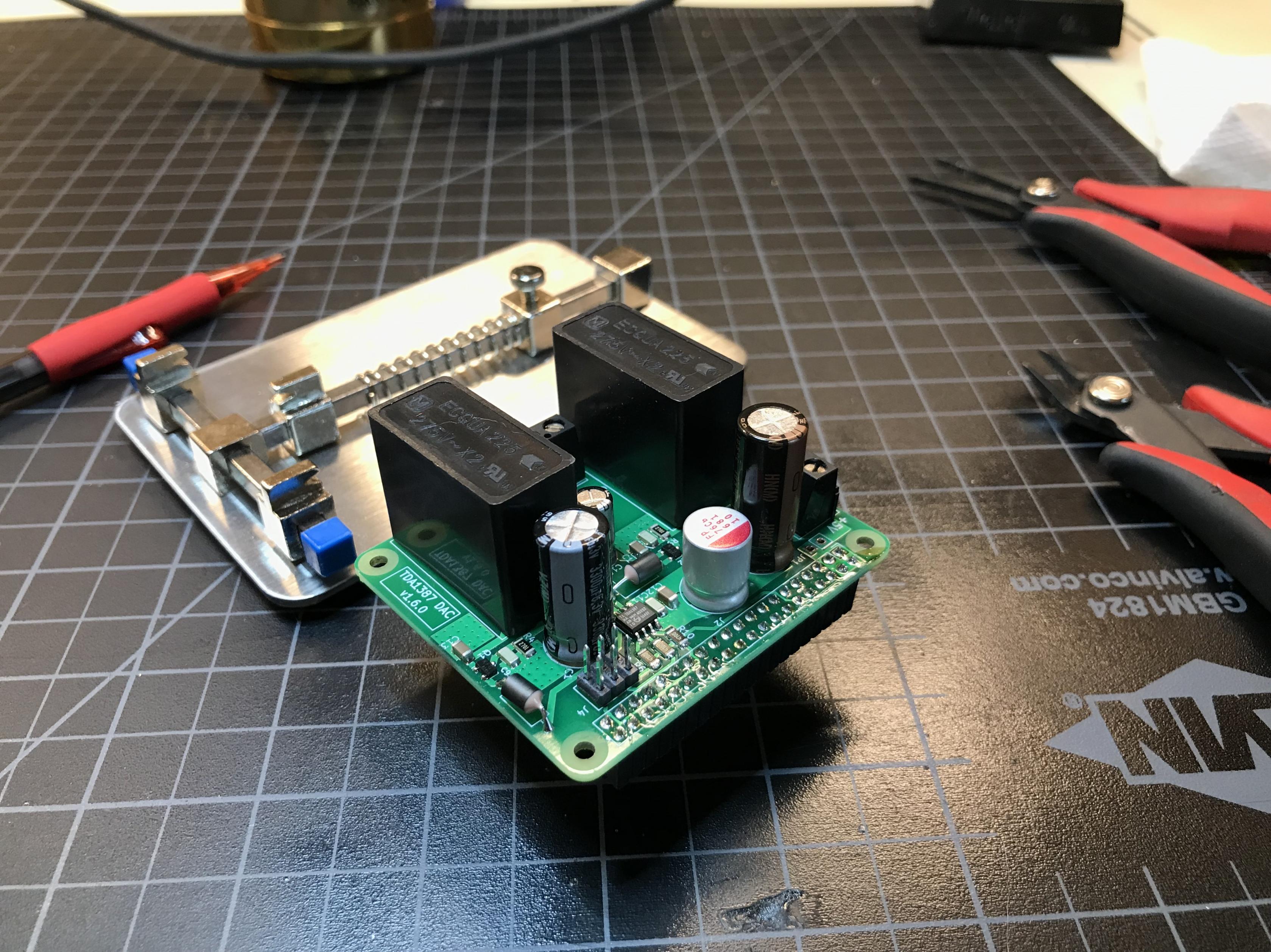

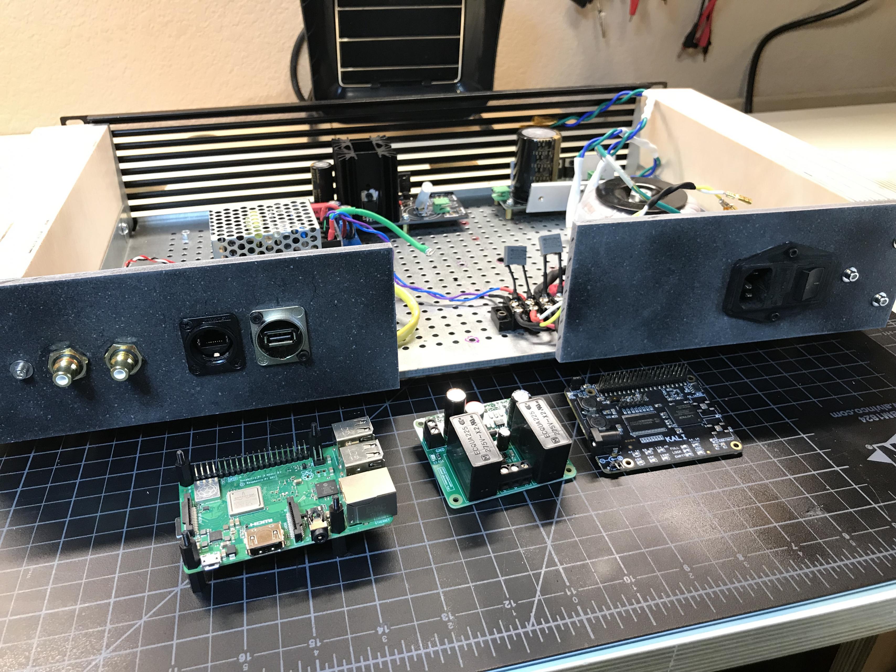

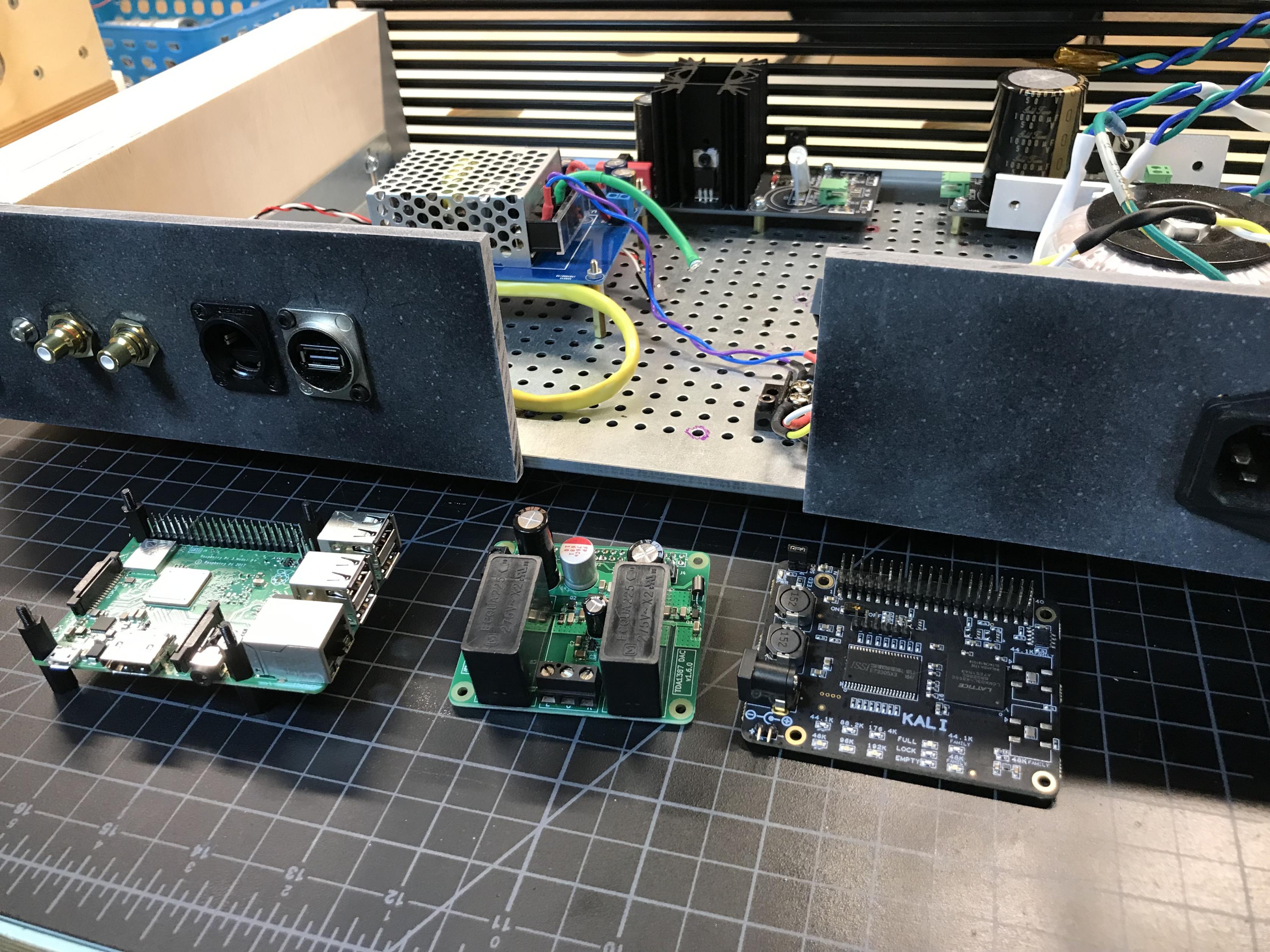

Twocents motivated me to get mine built today.
Hopefully I'll get time this week or next to get it set up in the prototype chassis with my pi 3b+, kali, and separate, regulated power supplies.
Very excited to start listening!
Gable

Twocents, congrats! I really love the sound Matt's original 1387 hat over headphones. I look forward to your impressions of the imaging over speakers.
Gable,
Your chassis looks very nice. Cool that you have preserved all of the Pi's connectivity options. Are you going to include an antenna for WiFi, or will you strictly use Ethernet? I have modified the 3b+ with an external antenna and can post details and pics if anybody is interested. I even have a few leftover U.FL sockets and shielded antenna cables to share...
I hope to start putting together a Digikey cart for this project over the weekend...

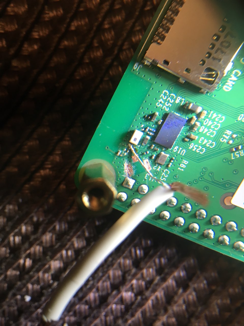

As for the Raspberry Pi antenna mod, here are the links that I used myself to get going:
DIYA Member Bvlabs posted some great pics and a link here.
and
This hackaday tutorial describes the mod well too.
Scratching the mask for mounting the U.FL socket is easy. The zero ohm 0201 resistors, however, are on the verge of invisibility. You only have to remove one of them to break the connection to the on-board antenna. You could reuse it to make the connection to the new socket, but it was so infuriatingly tiny, I just threw it out and used a single strand of copper wire to go directly from the vacated solder pad to the socket terminal. My phone pics aren't great, but here they are.
If you aren't using an isolator in you Rpi stack, you WILL hear more WiFi noise leaking into your audio than you did before...for me it is roughtly 2-3x as loud, and I am only using a 3dbi antenna. With an isolator, it is completely gone--just as silent as before the mod. I plan to take the isolator out at some point and see what a ferrite snap bead can do on its own...

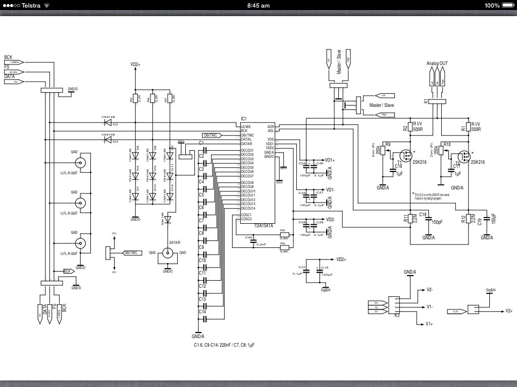

I like the transparency and simplicity of ground gate current buffer used in the Red baron TDA 1541 board.
Will it work if I attached the output from TDA 1387 to 2SK 216 circuit posted below ??
Is there other alternative to 2SK 216 ?
Sorry, previous post was the wrong schematic. (Previous is the balanced RPI Hat.) Here's the right one!
Moderators, please feel free to delete the previous post.
I refer to the schematic for version 1.2.
