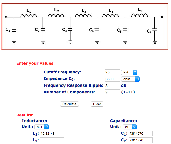

Those filters in that calculator are 1st order - very gentle filters. So a single RC or RL. In practice no-one is likely to use the RL version (except perhaps some devotees of inductors in RIAA networks). For DAC filtering I feel 1st order filters are woefully inadequate.
There is a calculator for LC filters let me find it : Chebyshev Pi LC Low Pass Filter Calculator
OK, I used that calculator you just linked. Still curious it doesn't have any Resistor as in your previous drafts in this thread. In any case, here's what I came up with, does it make sense?

It makes sense from the component values point of view. However you've chosen 3dB ripple which I think is a bit of a bumpy ride for audio. Also this calculator assumes equal input and output impedances (you've entered 3500ohm) but in the case of a DAC filter the input impedance is very high (100s of kohm). So if you want to design your own DAC output filter with the passive I/V after the filter you'll find it unsuitable. But if you put the I/V resistor in parallel with C1 you'll do fine. Then you'll find you need 3500ohm on the output which gives too little voltage....
Btw I didn't mean to suggest by linking that LC calculator that it was going to give you a DAC filter like I designed for you. Its just as an example of LC filters.

I need to go have some more reading. I don't understand what ripple means in the filter (I used -3dB as seen somehwere else) and where those other numbers come from (ie I thought TDA1387 single chip SE was outputting 3.5Kohm, not 100s of Kohm).
Sorry, obviously my fault / lack of knowledge, you're being very patient.

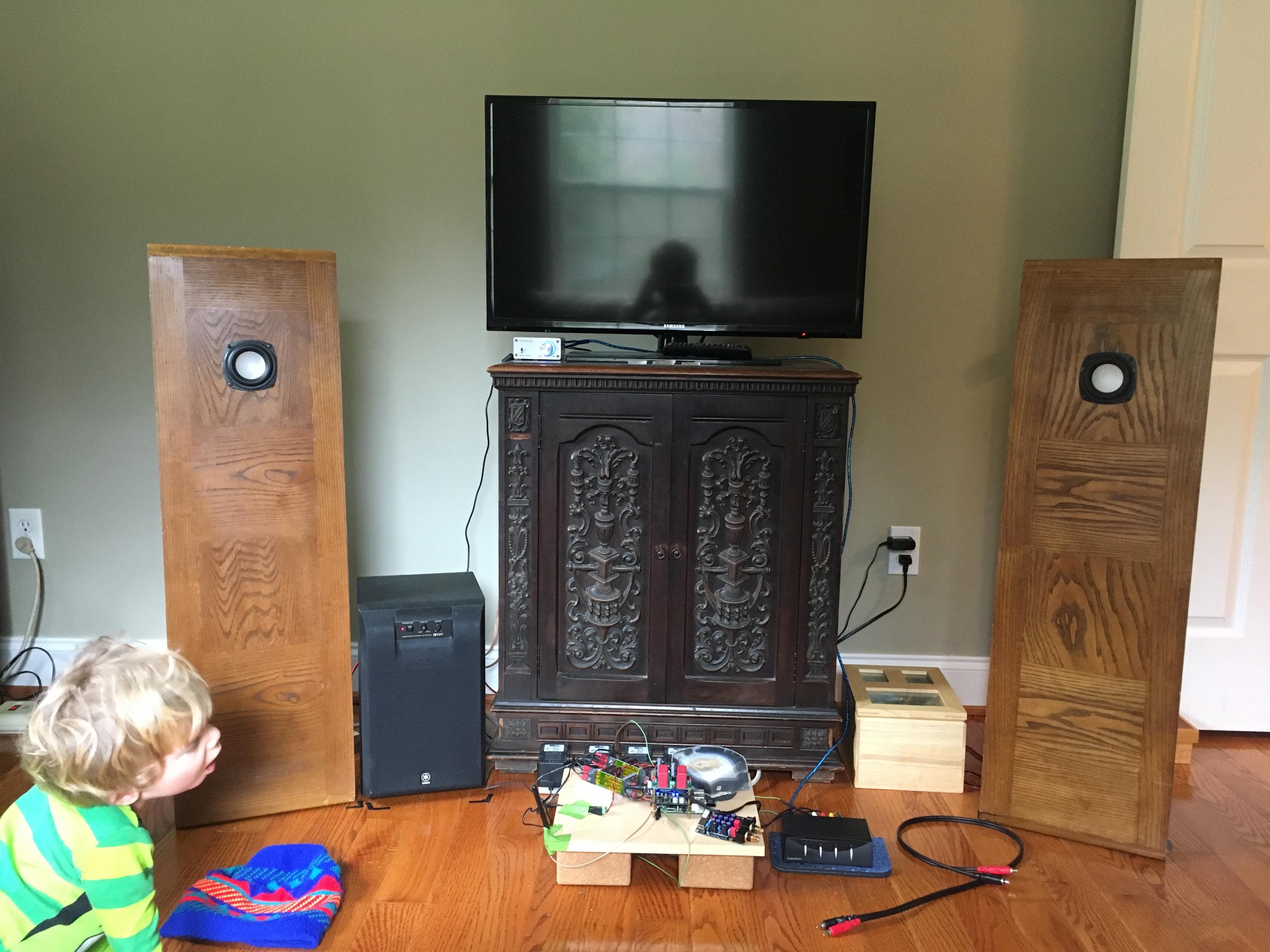

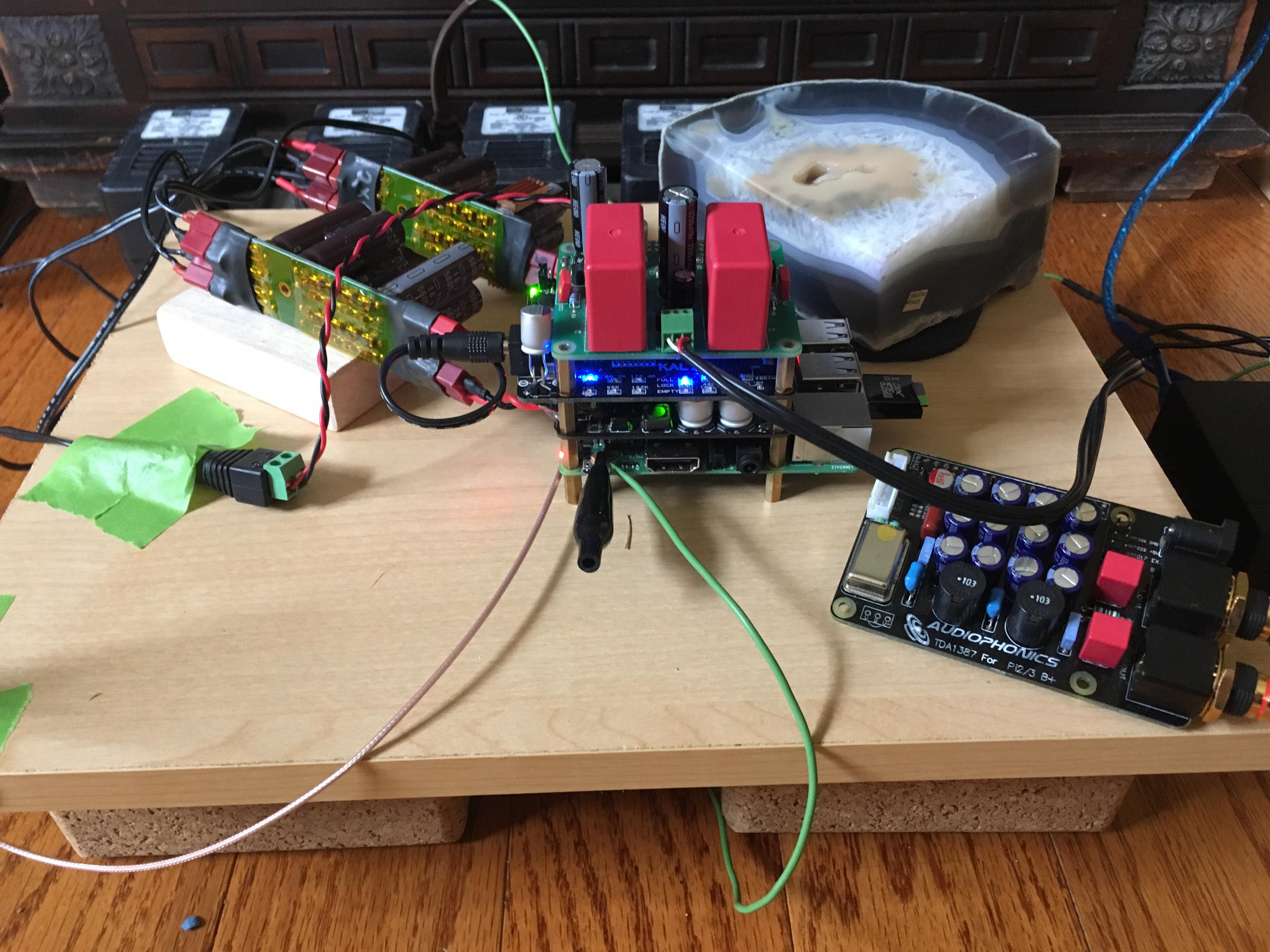

I have worked hard to make my RPi a quality I2S streamer, and auditioned many different DAC hats along the way. For a while I thought my favorite DAC might be the Audiophonics 1387 board. Nope. Once I got these simple DIY speakers set up for optimal imaging in my new listening room yesterday, there was no contest. Matt's RPi DAC v1.2 just beats everything else I have tried for realism. I would describe it as a sense of perfect focus. Approved by my 2-year-old son, too. 🙂 I need to get in gear and build v1.6!
