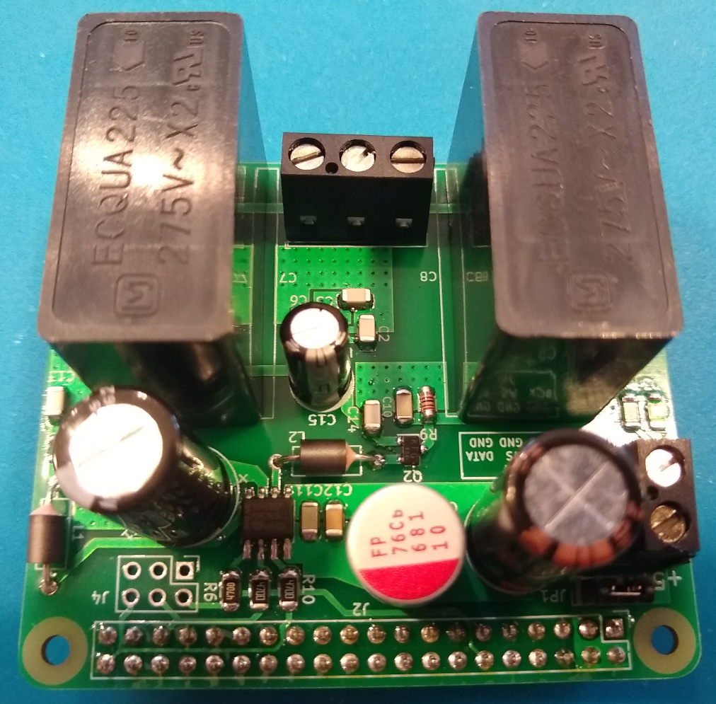

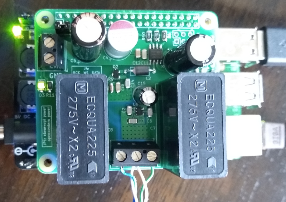

tda1387 RPI HAT DAC v1.6
Finally! Here is v1.6 of the single-ended tda1387 RPI HAT DAC. I designed this back in the beginning of September, but due to part shortages and general lack of time, only now was I able to actually build up the prototype. Good news, it works!
Differences from previous version(s):
The pictures shown here are of the first build, which worked without any debugging! Listening to it now as I type this message.
As always, I have a few bare boards available. They are free, you just need to cover shipping.
Attached are the schematic, BOM, Gerbers and KiCad (v5.0) files. Please let me know if you have any questions!

Congrats on another success, Matt.
Happy to see bigger terminal blocks! The old ones were a bit small...worth the upgrade for that alone Power jumper will be super handy, too. But yes, it seems that any audible differences will be due to the new precision voltage reference. Very cool. How's it sounding?
Also, what VRMS does it output?
I don't think the I/V transistor changes the output at all, so I believe the VRMS calculation is the same as for a passive I/V single-chip tda1387 DAC.
Yes! I can't tell you how many times I cursed myself for using those tiny terminal blocks on the earlier designs.
Listening impressions? Compared to the front v2 for instance?
I think it sounds good. It's been way too long since I've listened to the front-end, so can't compare to that. There's still a tiny audible hiss if I put my ear right on the tweeter: that's what I was hoping the precision voltage reference might eliminate, but no such luck. Otherwise, I think it's mostly on-par with the other designs. Though right now I'm running it from RPI power, I haven't yet listened with independent DAC power.
