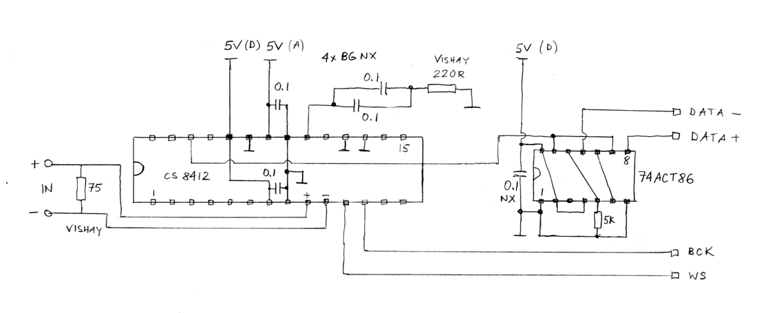

If so, I'd be very interested to know the specifics of points 1 and 3. The closest schematics I've seen are those from Peter Daniel for his "balanced" TDA1543, see posts 5 and 6 on his thread.
I am attaching his diagrams for the sake of making comments here easier:
Problem with that receiver/signar splitter is, if I'm not mistaken, CS8412 would not accept I2S.

There's a schematic for my latest TDA1387 implementation on my 'lingDAC' thread. In that I use a 74HC86 in a similar manner to how Peter Daniels has used his 74AC86. But there are a few differences which I'll highlight here.
First, 74ACXX devices are simply way too fast for this application. Speed in CMOS logic brings noise (ground bounce) and noise is one thing we wish to minimize in the digital circuits of a DAC. Hence for best results use a logic family with sufficient speed but no higher, and here that's 74HCXX.
Second, its not necessary to run 74HCXX at the full supply of the DAC chip (6V in my application). Higher supplies for 74HC brings faster speed - here slower is better hence I run the HC86 at 2.5V provided from a TL431. The logic swing needed by the DAC chips is even lower than this so I can't see any downside other than the need to protect the inputs from over-voltage by series resistors. Which would be used anyway by a prudent designer.
Next I run all the I2S signals through the HC86 - this is not just to control noise but also to reduce skew between the various signals. Peter Daniels' implementation of only running data through the AC86 gives him the flexibility to create a switchable inverted option (via the 5k resistor) which I've foregone. Choice of a much faster logic family means his skew is much reduced anyway.

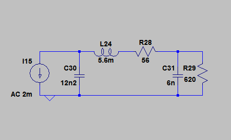

As to point 3 it really does depend how far you wish to go. Are you up for winding your own coils or do you prefer to stick with off the shelf inductors? Also are you up for stacking DACs (means placing them effectively in parallel) to give yourself more output current, hence more flexibility in the filter design?

OK understood, makes sense to use a slower XOR.First, 74ACXX devices are simply way too fast for this application. Speed in CMOS logic brings noise (ground bounce) and noise is one thing we wish to minimize in the digital circuits of a DAC. Hence for best results use a logic family with sufficient speed but no higher, and here that's 74HCXX.
OK understood, makes sense to feed it less V.Second, its not necessary to run 74HCXX at the full supply of the DAC chip (6V in my application). Higher supplies for 74HC brings faster speed - here slower is better hence I run the HC86 at 2.5V provided from a TL431. The logic swing needed by the DAC chips is even lower than this so I can't see any downside other than the need to protect the inputs from over-voltage by series resistors. Which would be used anyway by a prudent designer.
Here I'm struggling to understand both approaches. I think both aim at reducing skew between signals (why?). In his, he has the "flexibility to create a switchable inverted option" (why?). Sorry for such newbie questions, I really wish to understand better in order to learn.Next I run all the I2S signals through the HC86 - this is not just to control noise but also to reduce skew between the various signals. Peter Daniels' implementation of only running data through the AC86 gives him the flexibility to create a switchable inverted option (via the 5k resistor) which I've foregone. Choice of a much faster logic family means his skew is much reduced anyway.
PD doesn't send the control (CK, WS) signals through the logic. So the data signals will be slightly behind (in time) those control lines. Using an AC86 keeps that excess delay minimal (single digit nS) - hopefully short enough not to impact operation. Using an HC adds significantly more delay so its best to delay all signals the same amount so their relative timings aren't affected. If one got behind others the DAC might not operate correctly.
We can still add in the phase invert function but it means adding a further inverter - either a stand-alone one or a whole extra 14pin package.

Here's a rough first draft of the filter - I've not factored in yet how the 6n capacitor is created, nor included the specific inductor DCR.
From a quick look on Mouser the best choice for the 5.6mH is going to be Fastron : 07MFG-562J-50 Fastron | Mouser

Noted, not so expensive either.From a quick look on Mouser the best choice for the 5.6mH is going to be Fastron : 07MFG-562J-50 Fastron | Mouser
