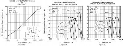

Here are the relevant charts from the datasheet - 15, 31 and 33 - bandwidth should extend to roughly 10Mhz as a voltage follower and output impedance will be in the very low mR range, if not quite uR. I think I'll try it with no output capacitance at all at first and see how well I can avoid any stray capacitance/inductance. Unfortunately, I've spent so long investigating this I have no time left to build it this weekend :-(

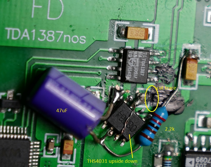

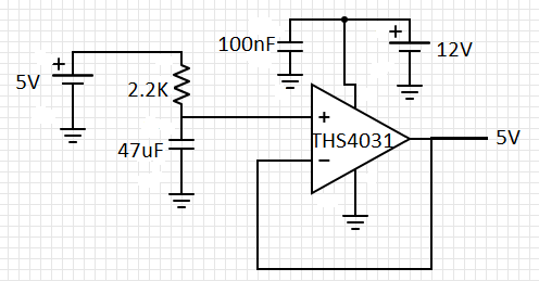

late night, early rise... and I got it built after all. It didn't take long - removed the ceramic decoupling cap on pin5 of the TDA1387, cut the power trace, fit the THS4031 upside down to minimise stray capacitance... etc... and it works well. It's hard to be specific about sound changes without A-B comparison but it seems to have better definition. I think it's worth doing. There's no capacitance on the the output of the THS4031 and the trace between it and the TDA is less than 1cm. Pin6 of the THS, output, has been bent so it sits on the pad where the ceramic was. The THS stays cool, as does the TDA - no more than 8degC above room temperature. There's no signs of oscillations etc. The attached photo was taken before the power connection to 12V so you can see connections - after the 12V power is connected, there is a cap over the top of the THS which obstructs the view of connections. The black paint screens the copper that got exposed when I cut the trace. And yes, I noticed the little blob of solder near the OP42 only after I took the pic ;-)

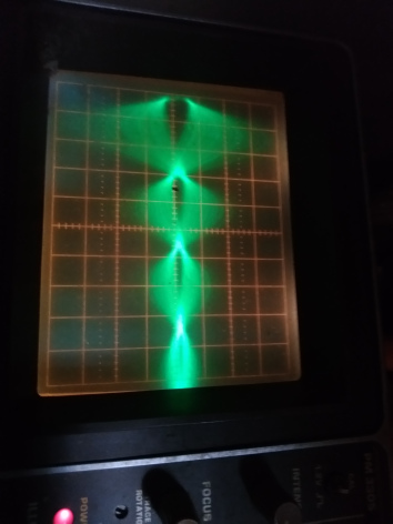

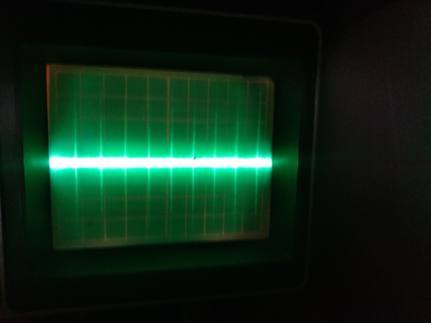

Put it on the scope - that monster MHz wave has gone and now I can see there are sharp faint 40mV spikes at 44KHz (playing 44KHz tunes at full scale output) and the spikes themselves are a 2.8Mhz decaying ring that modulates from 0 to 40mV with the music's amplitude. There's no oscillations on the power rails and overall, the output is looking much cleaner. I'll see if I can reduce the noise further with pF caps on the DAC output and in parallel with the I/V resistor. That's about all that's left to do now anyway.
And it's done! 220pF Wima bypass on the 3K I/V resistors sounds fine. Actually sounds better than the es9018k2m... pretty impressive given an almost 30 year gap in tech between them. Here are the scope pics from earlier. I expect they would be better now but whatever. The 44KHz noise:
2.8MHz noise

Yes, that filter needs a low leakage cap but the Oscon is the only small 47u I had so I didn't even think about it ;-) I'm not sure I'd actually hear a difference though - I cannot hear any background noise at all. Maybe just squeeze out a little more resolution. Anyway, it should be quite easy to replace so thanks for pointing that out. I have yet to finish the buffer op amp resistors so I'll replace the Oscon when I do them.

Yes - that's Wordpress' security. Sorry. Here they are as attachments. Not great and arguably would still create audible IMD, but much cleaner after fitting the THS4031. The MHz noise coming out of the IC went from a constant 400mV to an output modulated and decaying/ringing 40mV peak to peak
