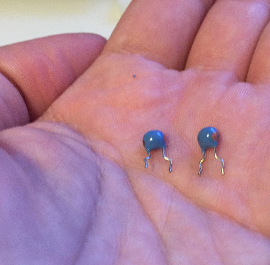

OK I'm salvaging like crazy. Will show my complete ignorance now, hope you bear w/ me. Is there a way to know the value of these kind of caps below?
Thank you
No numbers? No idea, sorry.

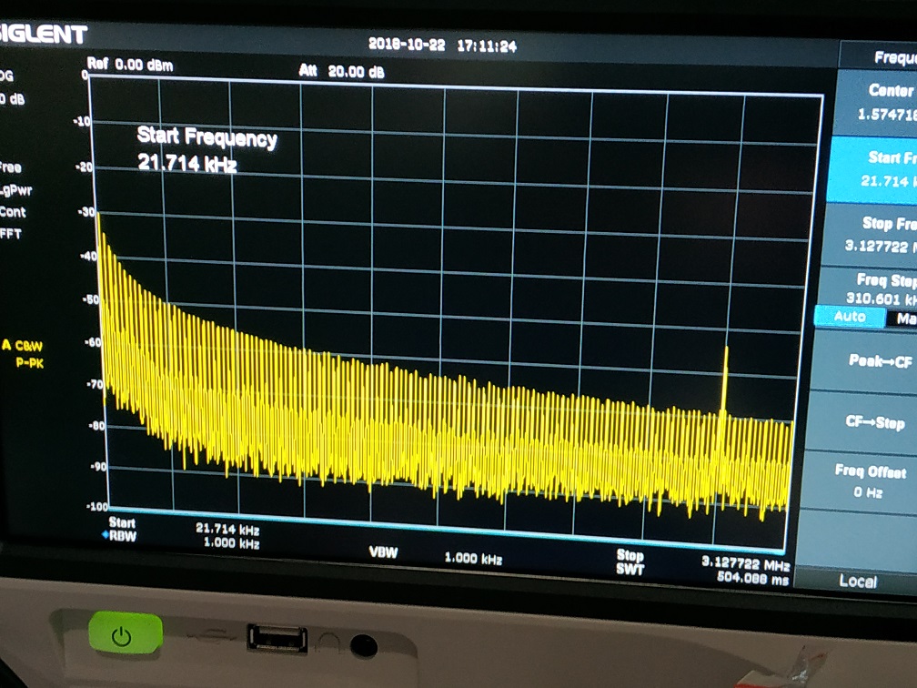

Its a Siglent SSA3021X. Here's the first picture of it in action. The plot is directly out of one channel of a TDA1387 on my lingDAC's DAC board. The analyser input impedance is 50ohm and the current swing is 1.2mA p-p. The DAC's playing back an 11.025kHz sinewave at full level and we're looking at a frequency band from 22kHz to 3.1MHz over which the signal level has dropped about 40dB. The peak near the far right end turns out to be from the BCK (2.82MHz).
Nice tool :) -30db to -70db with a -55dB hump at 2.8Mhz.... my high frequency bump was double that at 5.5MHz, which is higher than the chart shows.... good to see no other major bumps but I still wonder what, if anything, lurks higher nearer the DAC f clock. More to the point - the chip needs filtering on the output pins

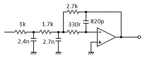

I've got a hypothesis that the DAC IC in this little (I think he must mean gentle) giant doesn't like a "big" poly 2.4nF cap directly on its pins - I've removed it and will try smaller values of silver mica. It also doesn't like an I/V resistor over about 3K. I tried up to 5.6k but got tiny amounts of faint distortion on the quiet decay of cymbals etc.
The best sound I've got so far is changing the buffer into a third order filter like the attached (it was second order with a gain of -1.6), with no cap on the DAC IC and a 15pF bypass on the 3K I/V resistor. I've run out of small pf caps so I've ordered more and will keep testing. The extra 1k resistor fits where the grey ac coupling cap was originally. Also, I forgot to edit the pic to show that the op amp +ve input is not ground but has about -0.85V input, so the DAC is DC coupled with 0.something mV output offset, into a DC coupled headphone amp driving HD650. This avoids "signal degrading coupling capacitors" as Ti Kan says on his AMB website.

Going through basic SIMS, trying them out, listening, putting it on the scope...

If we add DC, then, in addition to the same voltage on both inputs, we also want similar current on both op amp inputs. The inverting input of my current set up has 2.7K on the input and 2.7K in the feedback loop and this is dropping -1.7V (a 3K resistor sets I/V output at -1.7V, and the buffer output wants to be trimmed to 0V, with 5.4k in between). That's about 315uA I think. Using the -12V rail as my source for the non-inverting input's -0.85V (pin3), I should have 38K as my pot. Actually I have a 10k pot and a 10k resistor for 20K, so I'll change them. I'll put 2.7K between pin3 and gnd with a 1uF filter cap in parallel, and use a 10K trimmer (set to 5k) and 30k resistor in series between -12V and pin 3. So 35k (+/-5k) goes from -12V to pin3 and 2.7k goes from pin3 to ground, with a filter cap of 1uf. I hope that's right - it's early and I need coffee.
I'm using a Fluke DMM and pretty much any DMM that can read mV is fine to do this job, but of course, the more accurate the better. Worth measuring the resistors too or using 1% or better. Lifting the op amp pin3 up to disconnect it from ground without damaging the op amp leg is the trickiest part of the job to me.
