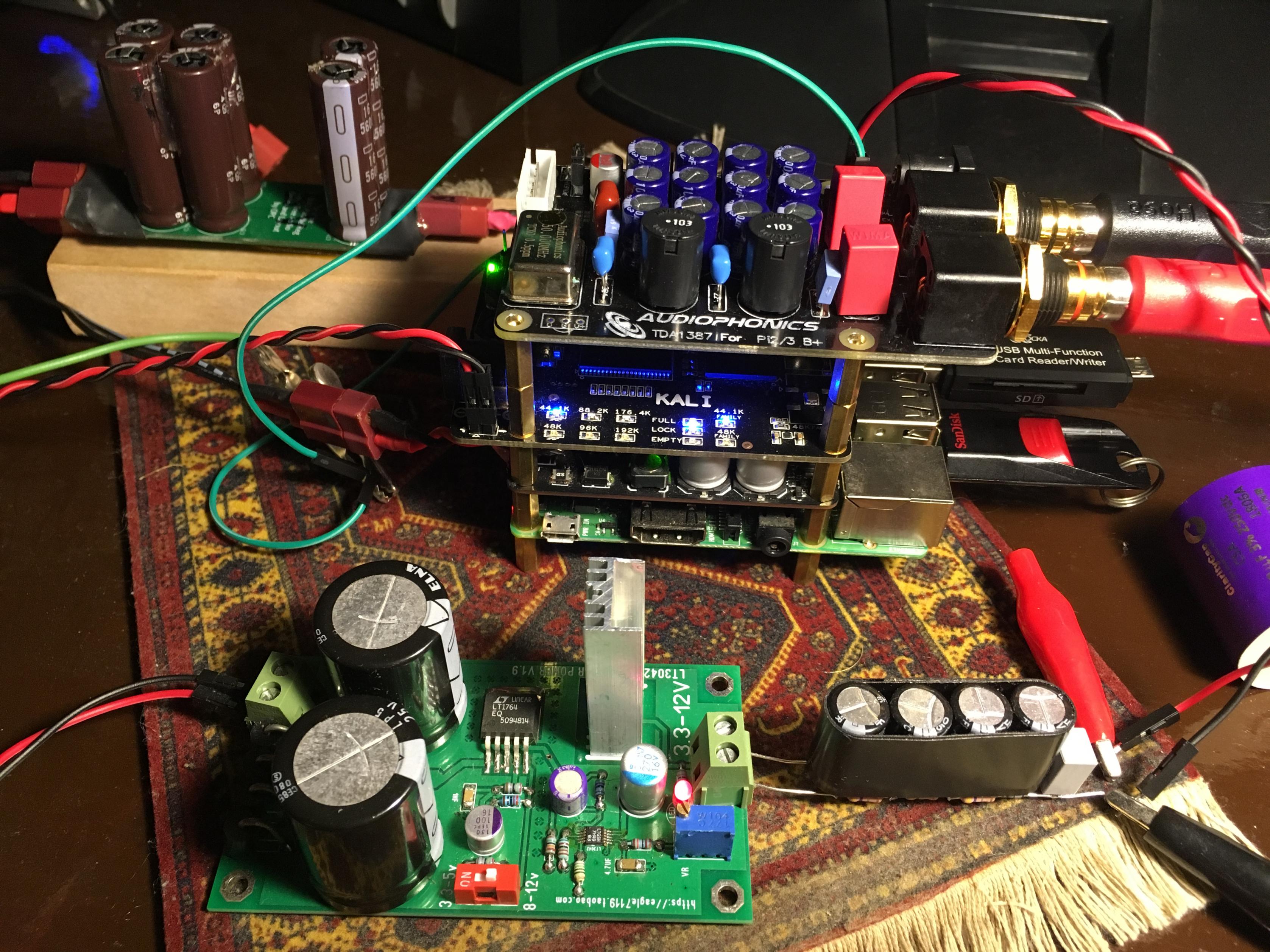

Sort of OT, but since we are sharing different 1387 boards, I have to say that the Audiophonics board sounds remarkably good. I pulled the Nichicon ES output caps and after trying the usual suspects, settled on some 0.33uF WIMA MKP4, which made a big improvement. They are in parallel with the input caps of my amp, otherwise I couldn't get away with such a small value. I am also using a new OPC regulator to feed the Pi courtesy of Greg Stewart. The detail is great (maybe 8x chips really does help?) and tonality is full and vivid...very satisfying.
I don't think it's offtopic, IMO anything tda1387-related is fair game in this thread.
I've always been curious to try that DAC. I have more tda1387 DACs than any sane person needs (though I suspect Abraxalito has me beat!) There is a very similar one from TeraDak. If you haven't already, take a look at this thread, Improving passive I/V for Pi dac 8 x TDA1387. That's about the TeraDak model. But if you take the time to back out the output schematic for your Audiophonics, there's a chance it might be similar to the TeraDak. If so, that thread demonstrates that the stock output filter may not be optimal.
Don't you mean that your DAC output caps are in series with your amp's input caps?
What is the board on your stack between the RPI and Kali?
That's IanCanada's IsolatorPi. To my ears, it makes the Pi a much better player.

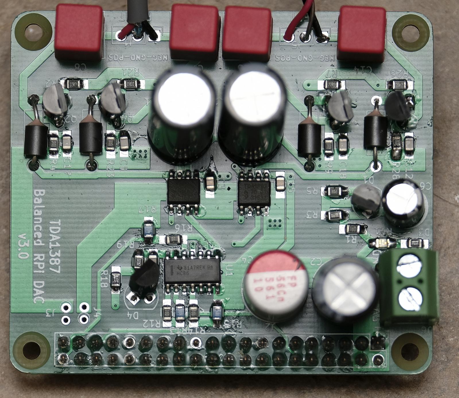

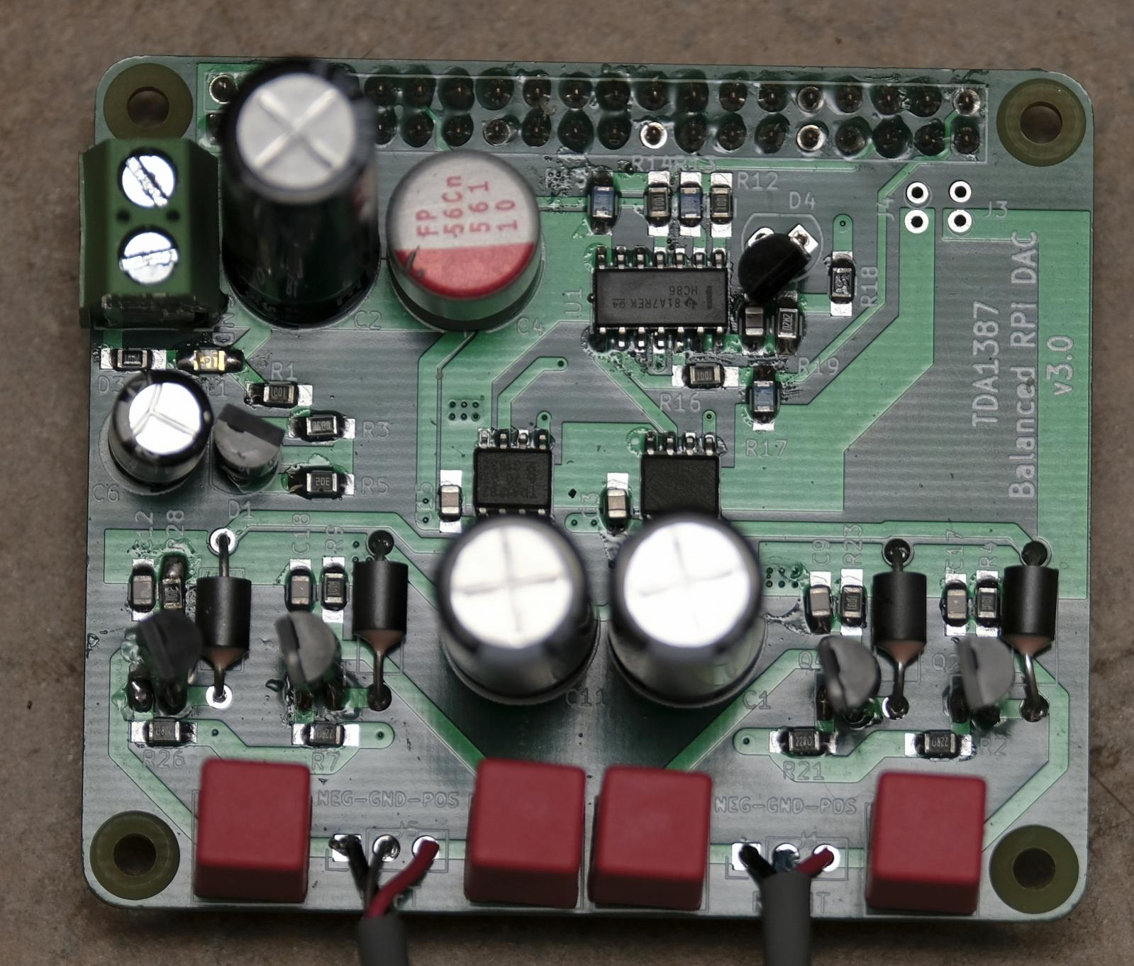

A bit late to the build. Anyway finished a TDA1387 balanced DAC. I am using a Pi 3. Volumio is the software I have been using on a Pi, Kali, Piano. That combo works well together.
I am having no joy with this build. I am guessing I may have soldered the ICs incorrectly or overcooked them on the hot plate. Also, when I configure Volumio it asks for which DAC is installed. Quite a few listed, so perhaps that is also a problem.
I have attached photos in showing how the devices are mounted. The first photo closest to the 40pin has them all right reading. Second photo is from the output side.
Any thoughts appreciated.
David
