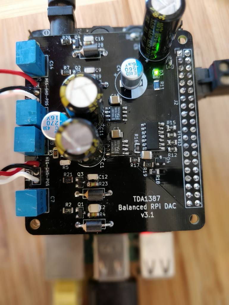

Thankfully I won't need to cut the fat GPIO power trace at top left since I already have made provision to send dedicated power to the board by NOT stacking the board atop my Pi stack and instead using GPIO jumpers for I2S and with power jumpers going to separate PSU.
Ahh, yes, an even simpler solution that doesn't involve physically altering the board!
I WILL try my hand at cutting the middle trace to get a dedicated 5V feed for the TL431 and I/V transistors (option #1). I will be using another one of Greg Stewart's modded Jamecos. Greg actually has the DAC for audition at present, so it'll be a week or so before I am able to try this.
Actually, perhaps a better approach is to simply remove R1, replace it with a through-hole resistor inline with your discrete supply's positive lead. Then you don't have to cut the trace on the board (you're "implicitly" cutting it by removing R1). It's easier and cleaner to re-solder an SMD resistor than to repair a cut trace IMO. That's a 1k resistor, which is a super-common value.
I have an LT3042 module that could be used to drop a 5V Jameco to 2.8V, for option #2 down the road. It isn't the best sounding regulator module in the world, but if it is superior to the TL431, perhaps it would give another SQ bump.

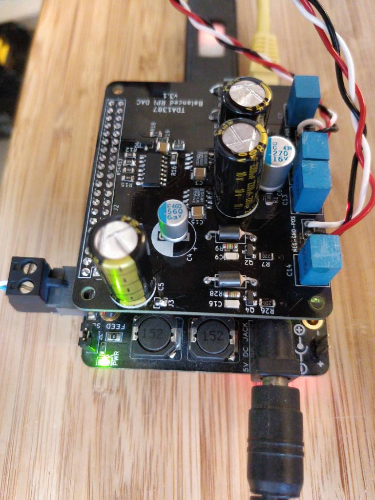

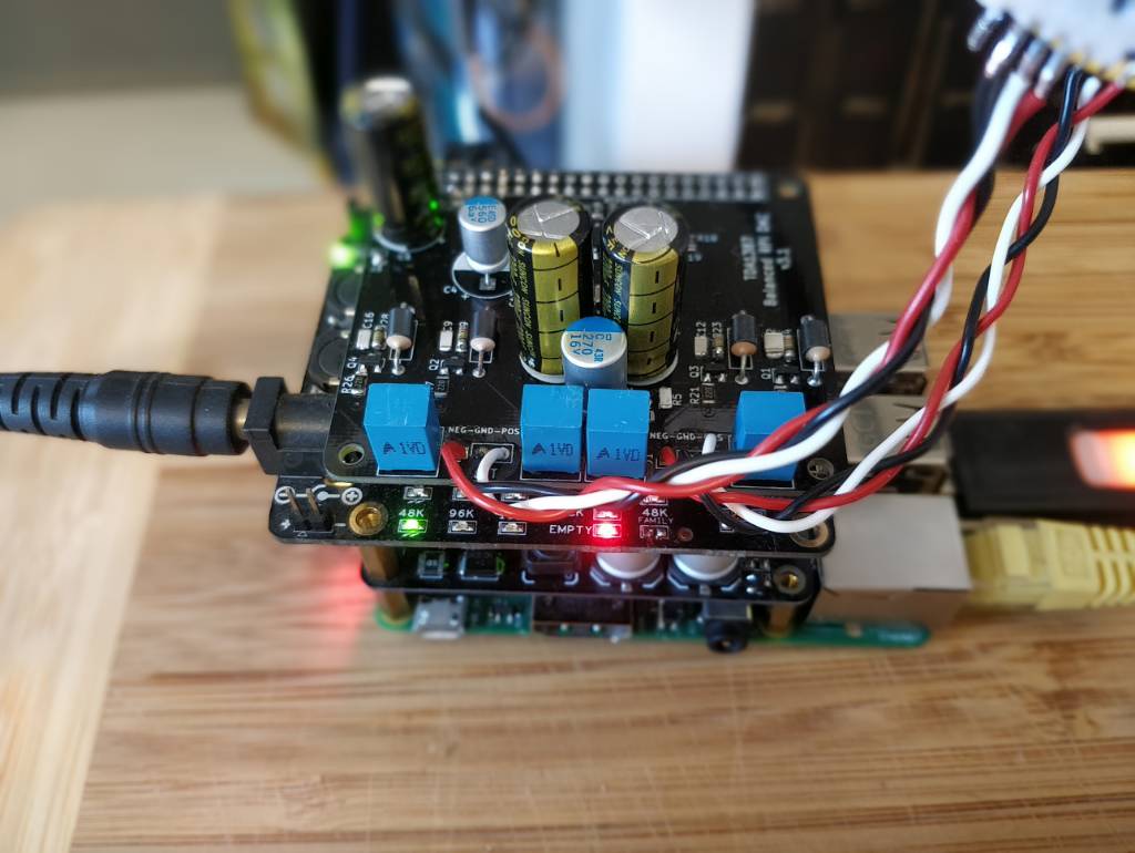

Hi matt,
Just want to thank you for very good and very musical dac!
The SQ is Pleasant to the ear, warm and soft.
I can listen to it for hours and really enjoy it.
My setup is pi>IsolatorPi by ian>kali>balanced tda1387 RPI HAT DAC
Feed by linear power supply based on lt3045
P. S i didn't hear hiss sound from the dac, that you mentioned before.
Thank's again,
Yos.

Yosyos - that looks great, thank you for sharing! To my knowledge, you are the first person to do your own fabrication and assembly (at least, I think you are the first to talk about it). I'm also delighted to hear you are enjoying it.
Thanks again, and hope you continue to enjoy it!

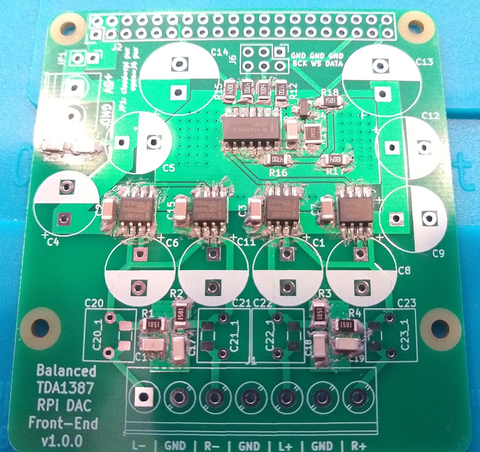

So if I wanted to try powering the digital and analog sections of the 1387 Pi Hat DAC with two separate 5V PSUs, is there a spot on the board where I could cut traces to isolate the two sides?

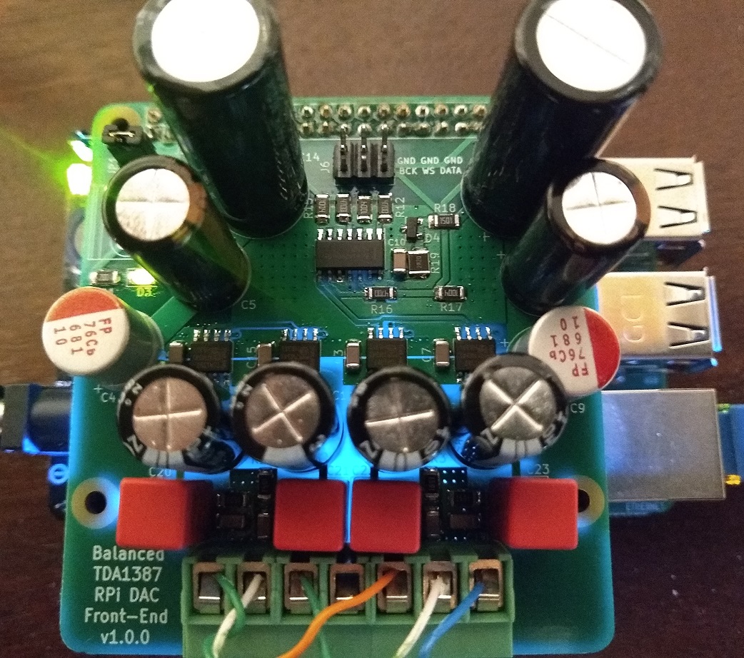

You got me thinking about this a bit. Came up with yet another revision to the board. Still in the "just thinking about it" stage, but I added some tweaks:
- Added a jumper to use RPI power or external 5V
- Replaced TL431 with LT3045 for IV transistor supply
- Added filter caps in front of IV transistor
- Extra filter cap in front of tda1387 chip power supply
- Added 2x6 pin header for I2S, now can easily be used as a standalone DAC
RPI DAC / Front-End v1.0.0

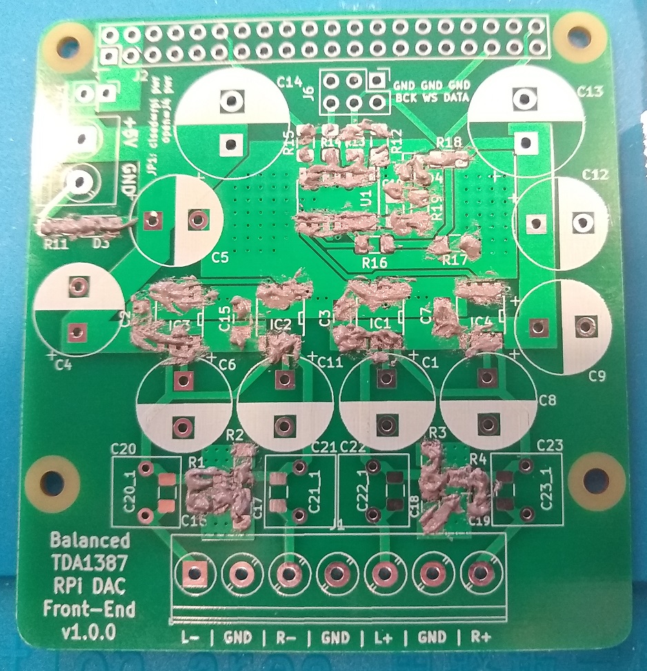

A couple pages back in post #219, I mentioned my next iteration on simple tda1387 DACs: an RPI HAT and/or standalone front-end. Features:

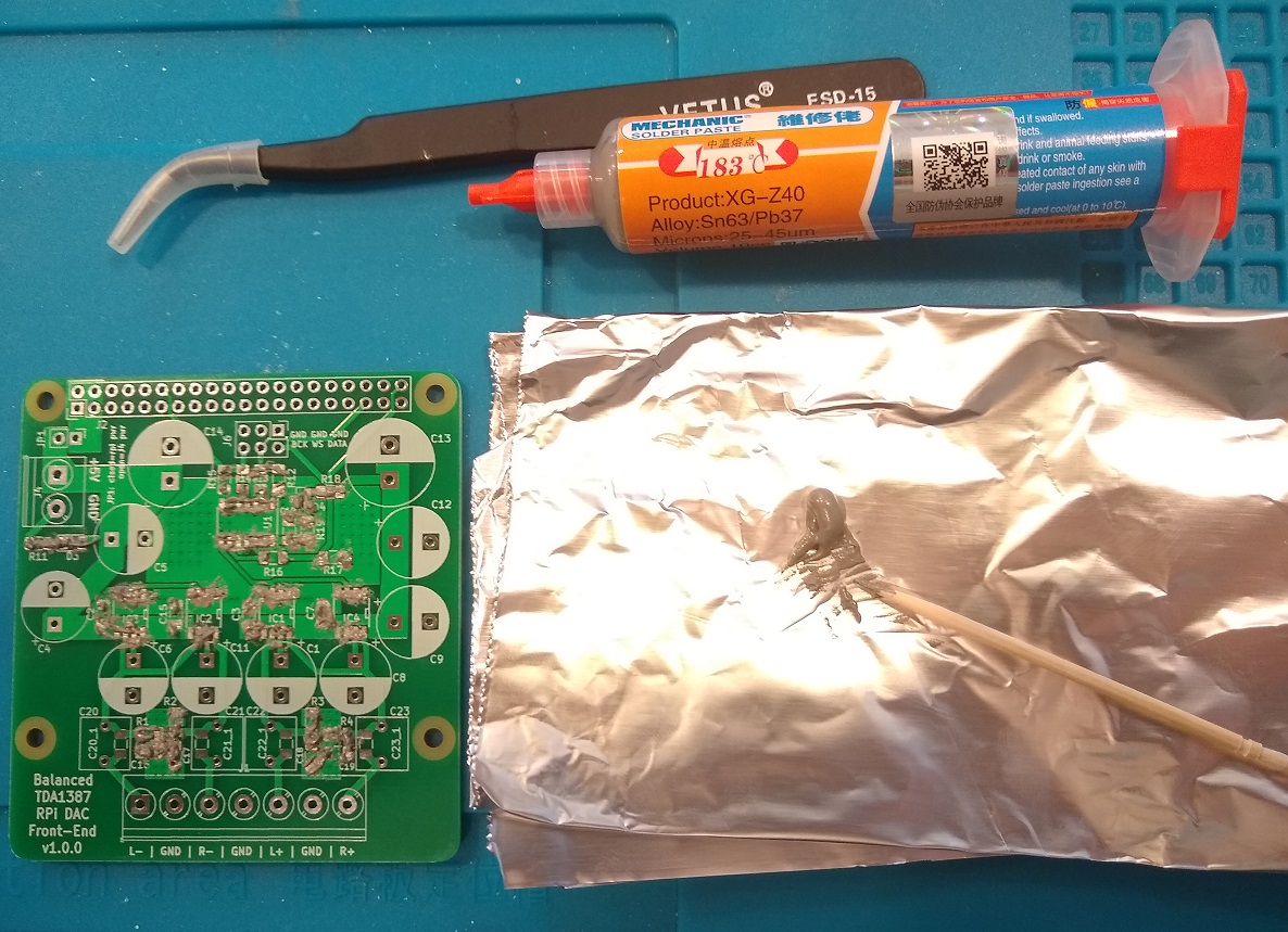

Once again I used my simple stovetop + skillet method of doing the SMD soldering. I included pictures of that process for a little mini-tutorial:
01 - Tools of the trade: Mechanic-brand XG-Z40 solder paste (ebay), precision tweezers, toothpick.

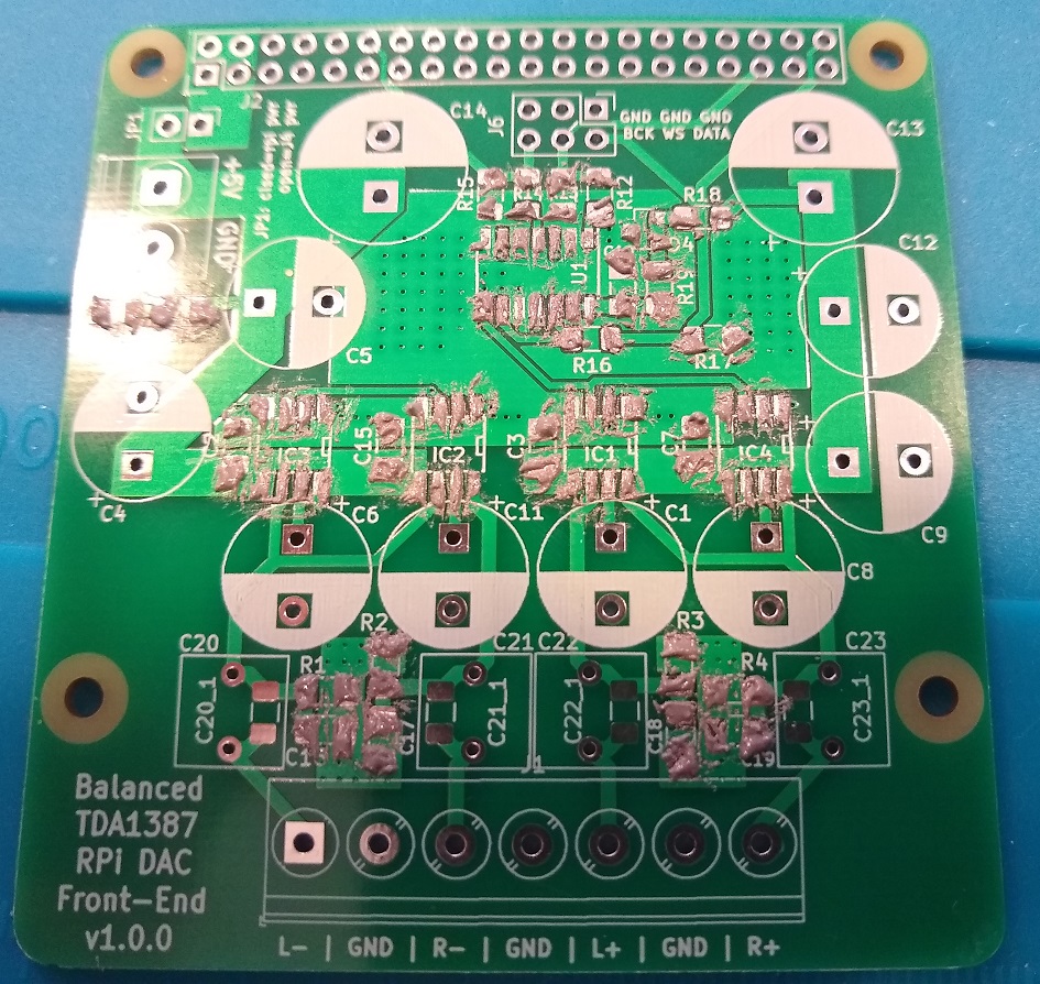

02 - Initial "painting" of solder paste on all solder pads; this isn't pretty, just a first step towards getting initial coverage.
03 - Cleaned up solder paste. What's interesting here is that these photos act as somewhat of a magnifying glass. The solder paste looked pretty neat to my naked eye, but now that I have large hires photos, I can see it's not that neat. Anyway, this is the most time-consuming step. You definitely don't want too much solder paste, as that inevitably results in solder bridges that are a real pain to clean up. I liken this step to painting a wall in your house: the more time you spend on prep, the better the job goes. At a minimum, I try very hard to make sure there's only a very thin coating of paste on IC pin pads; i.e., the smaller and more closely-spaced the pads are, the more care needs to be take that there's not too much solder paste.
04 - Components placed. Pretty easy with the precision tweezers. Just double- and triple-check that the right components and correct values are being placed (rework sucks!).
05 - After the "reflow", i.e. after being cooked on the skilled. I basically turn the heat to medium, let it heat up a while. Then I place the PCB on the skillet and crank the heat to max. Now is the fun part: the solder paste will melt, and surface tension pulls it all in neatly, and even tends to square the parts a bit. Once all paste has turned molten, I give it another few seconds, kill the heat, and remove the board from the skillet. After it cools, I do basic sanity checking with the multi-meter. I look for unwanted shorts and continuity where expected. See where I circled pin8 of one of the tda1387 chips? Even though that solder joint looks OK, it was actually fairly dodgy and not giving good continuity to the solder pad. A quick touch-up with the soldering iron fixed it.
(not shown) - Solder all through-hole components. I try to start with the smallest/shortest components, and work up in size.
06 - Playing sweet sweet music! Everything worked on the first try. I tested each single-ended pair of outputs individually first. I always use a low power amp and cheap speakers for the first power-on. Once I saw everything was working as expected, I then wired for differential output and moved up to my semi-decent basement amp and speakers. I like to let things like this run continuously for at least 24 hours before doing serious listening. I mainly want to ensure that any potentially marginal solder joints have a chance to show themselves and/or see if the design itself is prone to an early death.
(Actually, on the very first power-on, I had no sound. I was like, what the heck? But then I realized my amp wasn't plugged in!)
- 2x2 tda1387 DAC chips in balanced config (using HC86 to invert I2S DATA signal)
- 5mm pitch screw terminal for 5V power or power from RPI via jumper
- Simple passive I/V or simply omit IV components and have a direct current-output (e.g. for separate I/V board)
- Massive overkill amount of pin5 (5v supply) capacitance
- 2x6 I2S pin header for use as a standalone DAC or front-end

2. The balanced hat/front-end pictured above has been playing for a while. It's "OK". The classic tda1387 "sweetness" I love is there, but my immediate impression is that it's a bit "flat" compared to all the other tda1387 DACs I've heard. IIRC, this is consistent with Abraxalito's observations of passive I/V. The other problem is, it didn't eliminate the subtle hissing I hear when used with my tda8932 amp and office speakers (in fact, it's even more prominent). I originally thought the single transistor active I/V might be to blame, but clearly that's not the case. So now I need to build a real I/V stage for it!

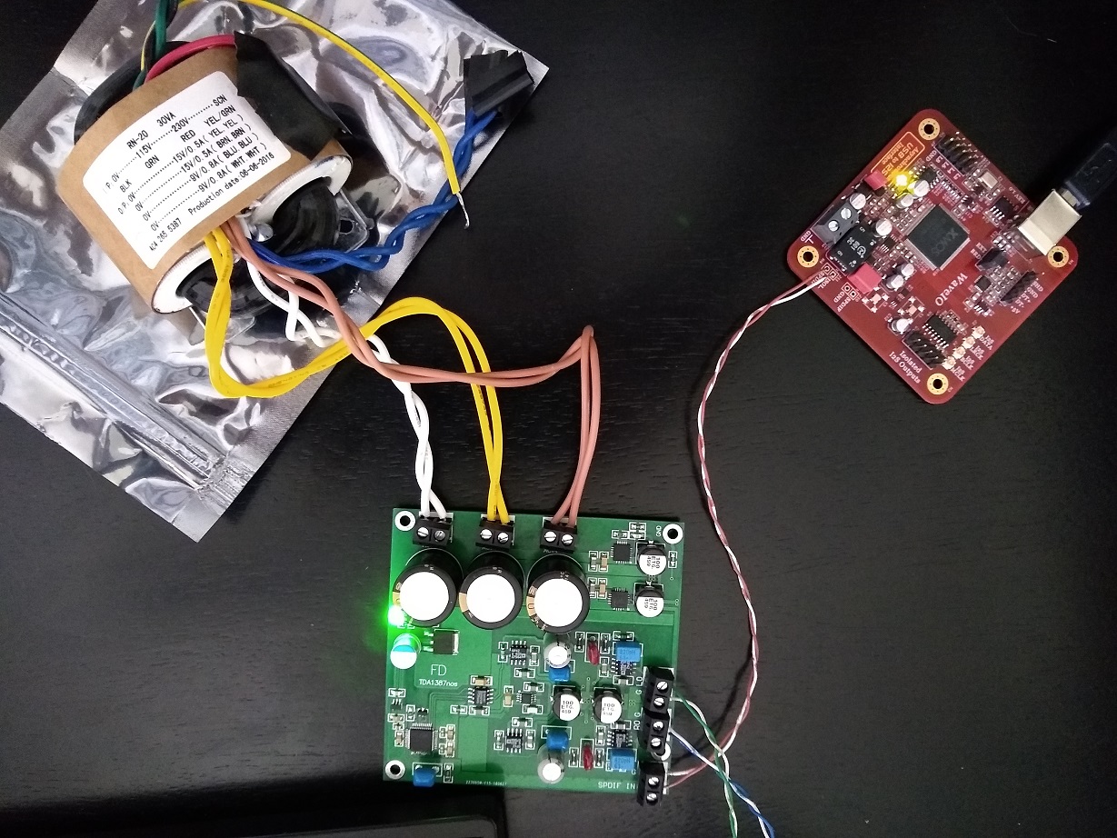

I received this a couple days ago, just now got it up and running. It's SPDIF input (technically I could solder I2S wires directly to the tda1387 pins, but not ready to take a soldering iron to it yet). So I had to find my WaveIO USB to I2S/SPDIF board that I've never used. (I do have a cheap RPI SPDIF HAT on order.) Currently just powering the WaveIO from USB.
The "FD TDA1387nos" board has two 14-16 VAC and one 7-9 VAC power inputs. I'm using a 30VA R-core transformer with two 15V/0.5A secondaries, and two 9V/0.8A secondaries (one of those is taped off).
Everything fired up nicely on the first try! I thought XMOS devices (such as the WaveIO card) required drivers for Windows, but this just worked. Playing via Foobar2000 using ASIO4ALL.
The current setup is far from optimal: over-long cheap USB cable from my PC to the WaveIO card; WaveIO is USB powered (rather than dedicated); really long RCA cables draped across my office from desk to amplifier.
Despite that, my first impression is a definite thumbs-up. It seems very "lively" and "crisp" to me. Perhaps this is what people mean when they refer to dynamics? I need more time with it to say for sure, but this definitely feels like the "cleanest" tda1387 implementation I've heard. Absolutely worth $50. Right now I'm thinking it's worth the time and effort to put into an enclosure and keep as a reference. And then buy another one for study and possible hacking.
I'll try to take some nice hi-res pics later today. But what I received looks exactly like the ebay listing pics. I had to use a flashlight and magnifying glass to read the lids of some of the ICs. In particular:
